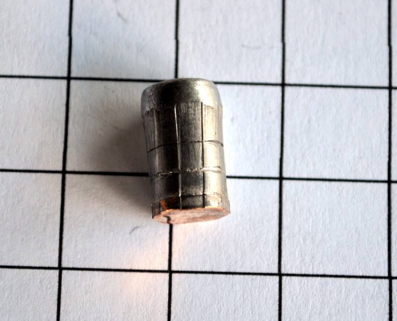

Posts: 2241
Re: Dammit!!! I need to stop looking in Gun Stores.
164 LBT.jpg (1.88 MiB) Viewed 2118 times
These LBTs are 164gr lubed with gc
Pushed hard, they penetrate 20"+ into wet newsprint, and they expanded SLIGHTLY, to 0.375" from my 6" 686

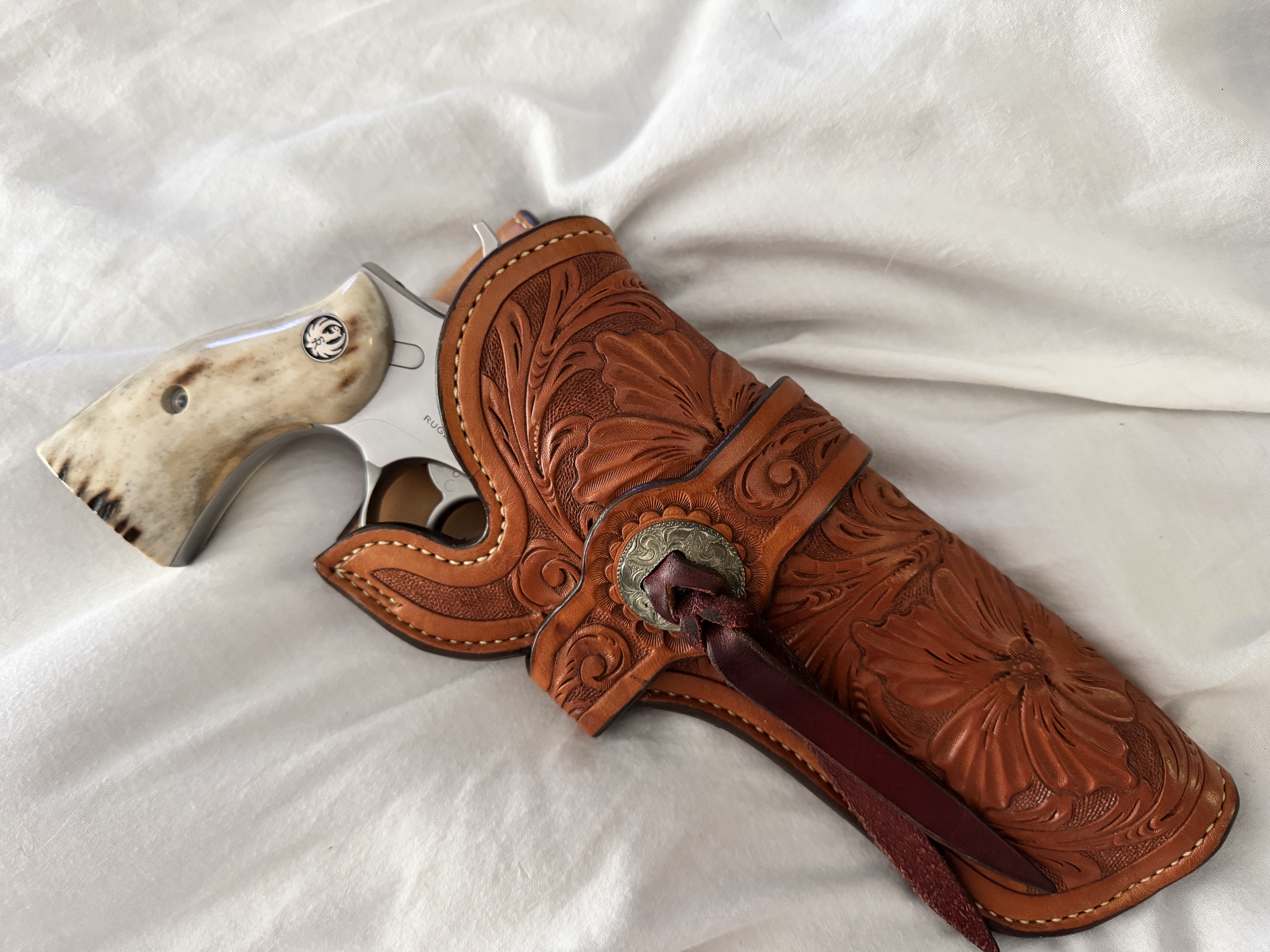

Picked her up today and to make a long story short the gun is unfired!!!
Also found a holster my old saddle maker gave me as a gift. Hand made, hand carved and real sterling hand engraved concho.
It’ll do 😁

Posts: 850
Spectacular pairing!
Posts: 4107
Thank you!

Posts: 222
That is a combination that was meant for each other. Beautiful holster!
Posts: 2241
BEAUTIFUL pairing E.❣️
