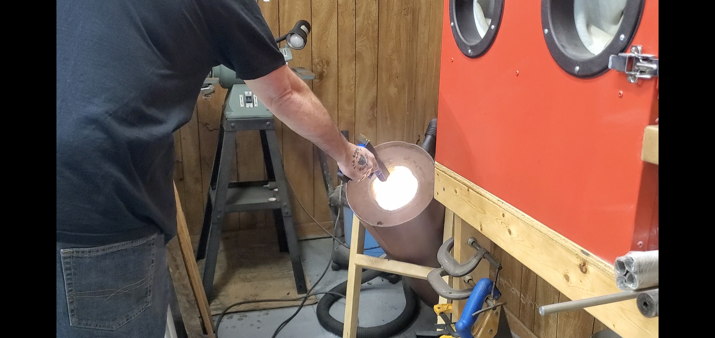

Posted: Wed Apr 16, 2025 7:07 pm
I finally got around to cutting my chamber deeper by renting a 350 legend reamer. First test fire and this thing is promising. Although I'm unable to grab a chronograph number in my shop, the recoil and fireball is substantial 😳. It's also extracting and feeding just fine. It reminds me of shooting a Coonan 1911 in 357 Mag.

Posted: Fri Apr 18, 2025 4:18 am
Another update:
I have an average velocity of 1582fps. My buddy has been helping me with load development and according to the minimum and maximum he suggested, I'm still .2 grains from his recommended maximum using Longshot so I can probably get to 1600fps (I'm guessing here)
I don't see anything that would lead me to believe that it's reaching dangerous pressures and extraction is good along with the primers.
