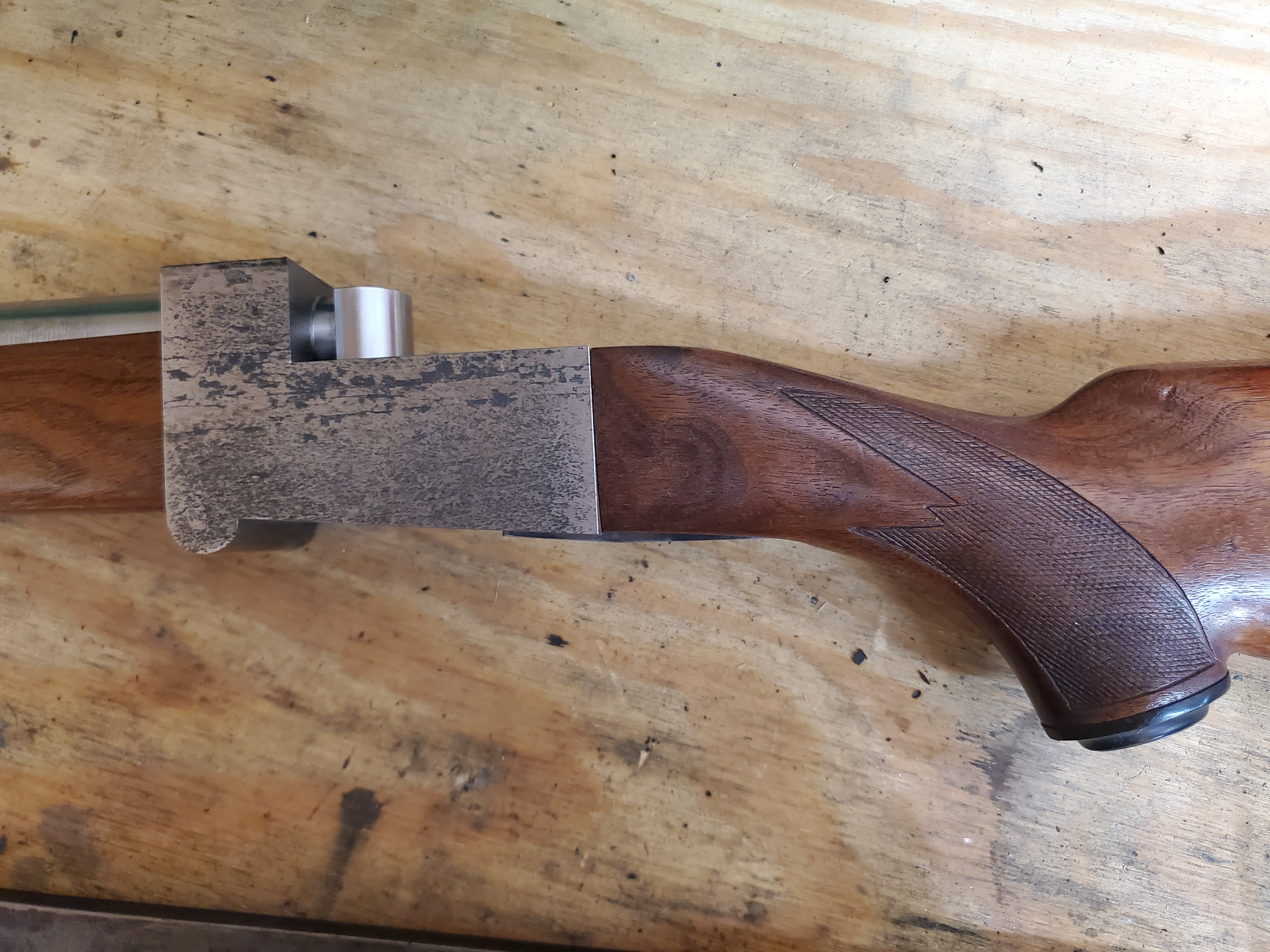

Tangs are done. The bottom is still obviously roughed out so it'll be seamless when I contour everything into the wood but the fitment is spot on. I'll also fill in the wood where the bolt handle notch is. The removable lower tang will give me a place to put the trigger, making it easier on me.

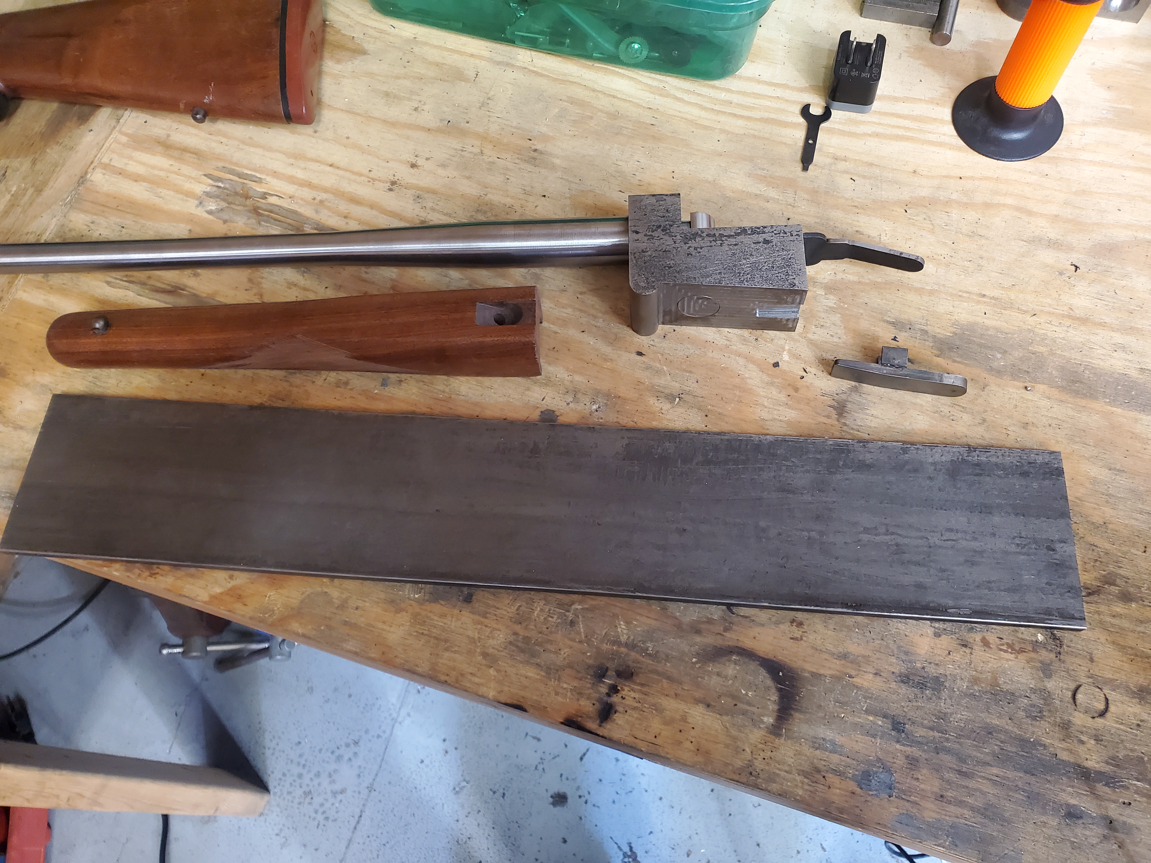

Got only a little more done. I was getting ready to order the 4140 in 3/8" thick to start on the lever until I checked my business account and simultaneously got a text message from the fraud center about weird charges (literally at the same time, weird). Some àsshole got my numbers again and charged over 1k on stupid shìt like an airline ticket and a few hundred at a movie theater in Chicago 😒. Had to go to the bank and apply for a new card and dispute charges. Been without a card since last Friday and I typically order steel online. I guess I could go down to ALRO and pay cash but just been busy with other jobs.

I'm actually about to start the CAD (cardboard aided drafting) for the shape of the lever. It'll be used to trace out the lever on this 3/8" thick plate of 4140. Depending on how I feel about the design I might post the cardboard cutout that I like to see what the general concensus is on the aesthetics of it before I commit. I've been slammed with work so this has taken a back seat.

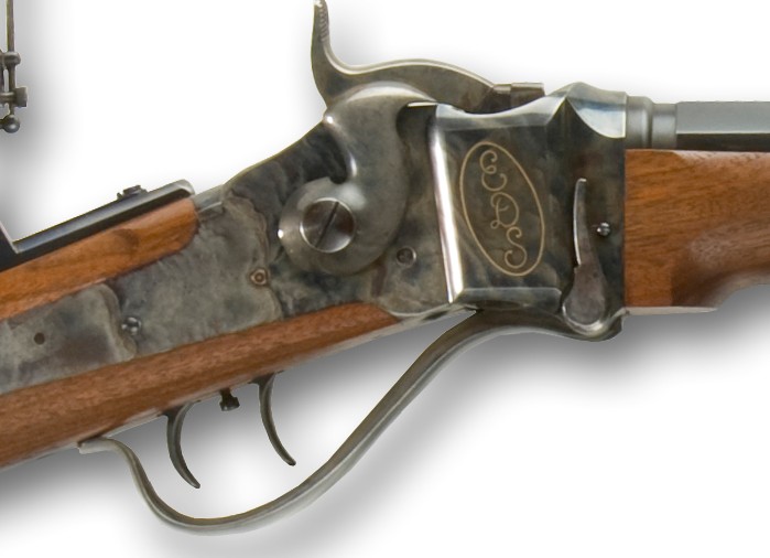

GrapeApe wrote: ↑Tue Jul 01, 2025 9:55 pm My initial thought is, "not too curly"
Second thought is something along the lines of the "Quigley" rifle.
Basically a hinged trigger guard without a dingus on the end
Still can't wait to see what you come up with :D

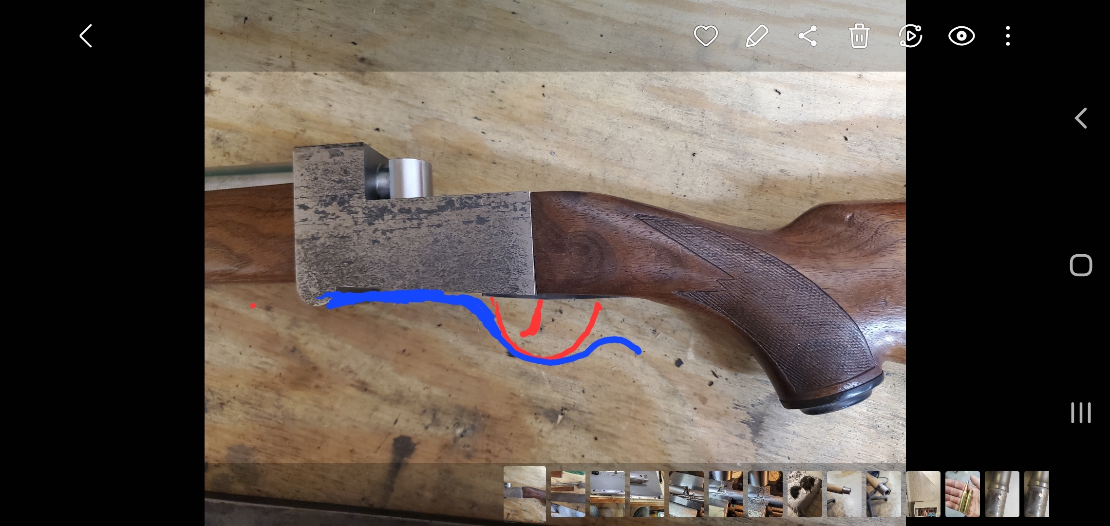

Posted: Wed Jul 02, 2025 4:50 pm
Something like this maybe?

Re: Pinfire rifle.
Posted: Wed Jul 02, 2025 8:31 pm
The quigley does away with the red part.
Terminate the blue where the red ends The trigger guard is part of the lever

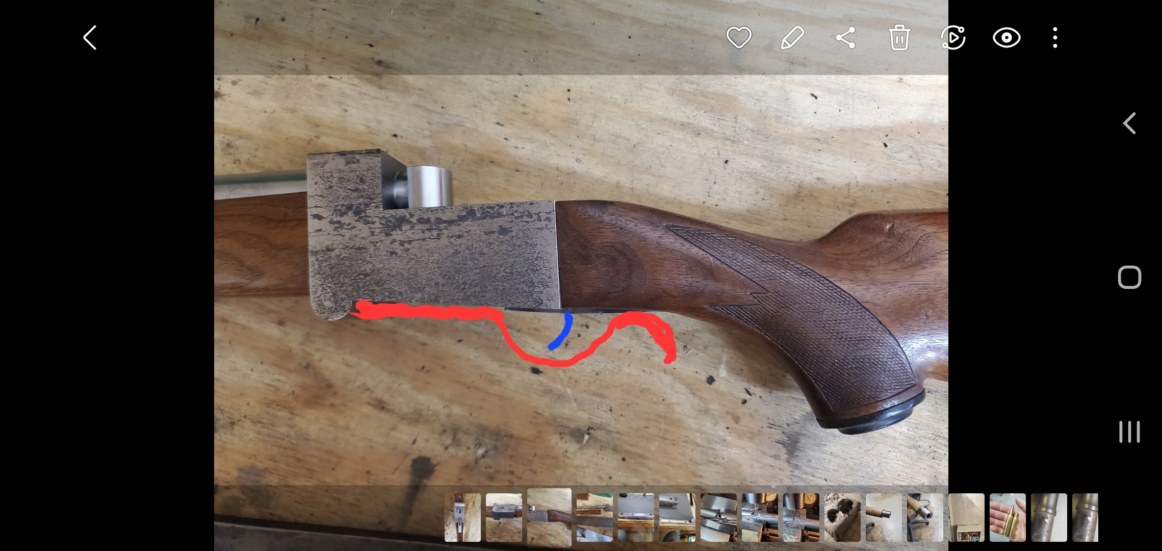

I already have the detent design for the bolt that'll also keep the lever pulled tight against the reciever and stock. Mainly went with the idea because of its ease to make.

Posted: Wed Jul 02, 2025 9:27 pm
Based off of Paul's idea. Thoughts? Keep in mind I'm trying to go for simple if I ever want to mass produce these.
