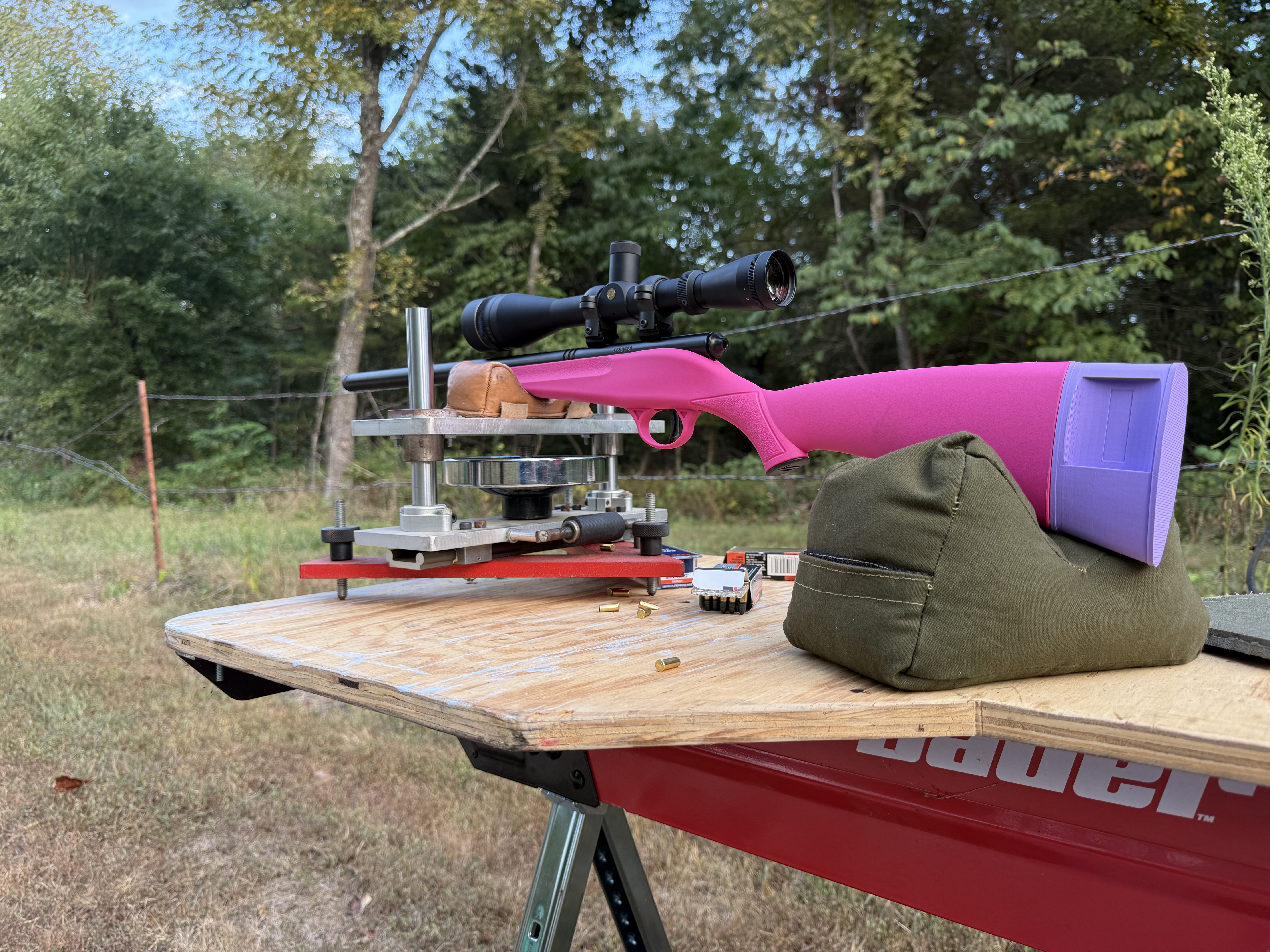

Well, there’s a dumb idea. I mean it worked, but is still dumb, and didn’t work all that well as far as comfort and technique. But I could get a little better sight picture.Wambli Ska wrote: ↑Sun Aug 31, 2025 11:14 amI was thinking about that too! I’ve never had to deal with anything that tiny . Again highly interested in how this moves along.

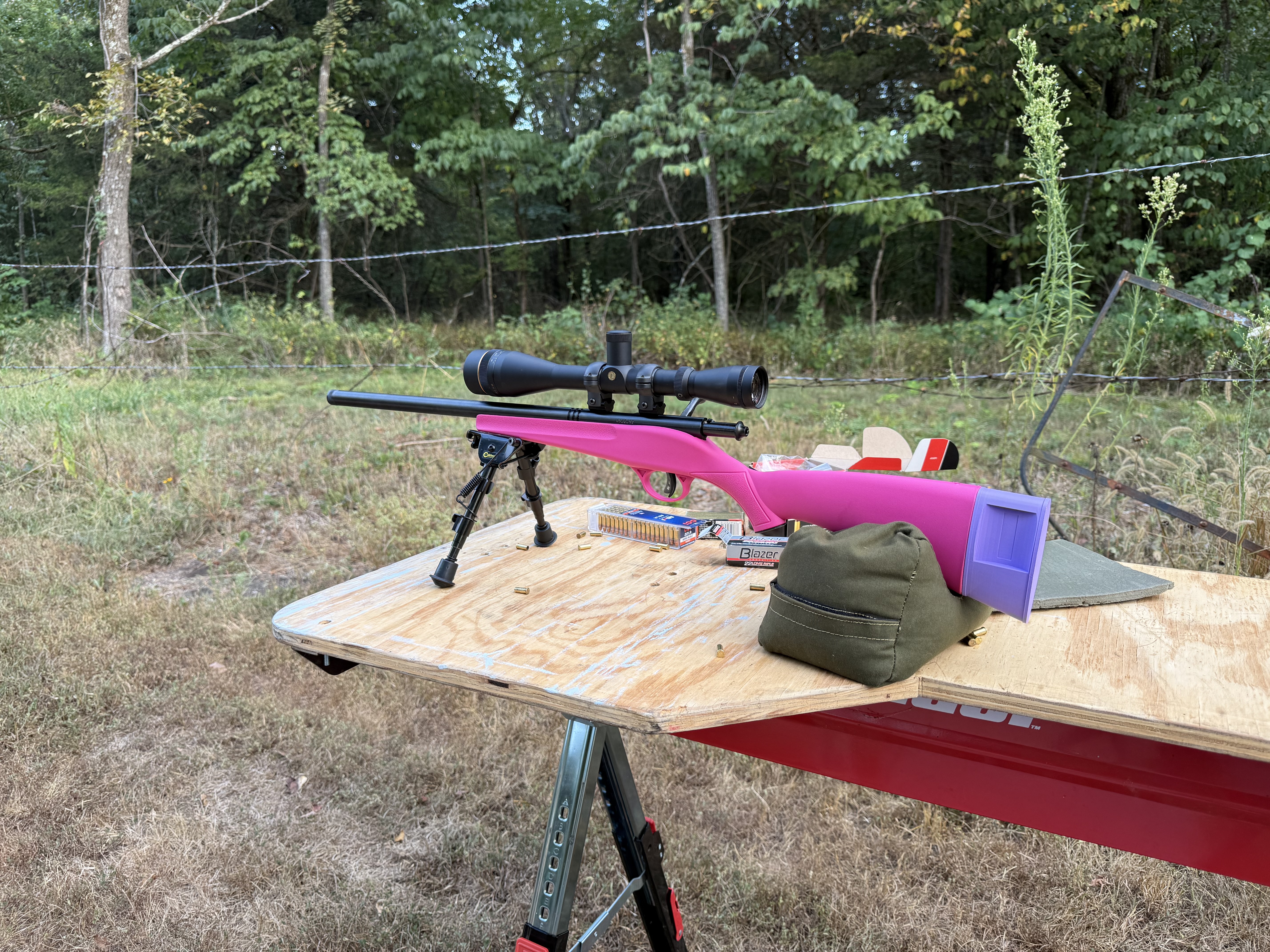

Re: New .22.

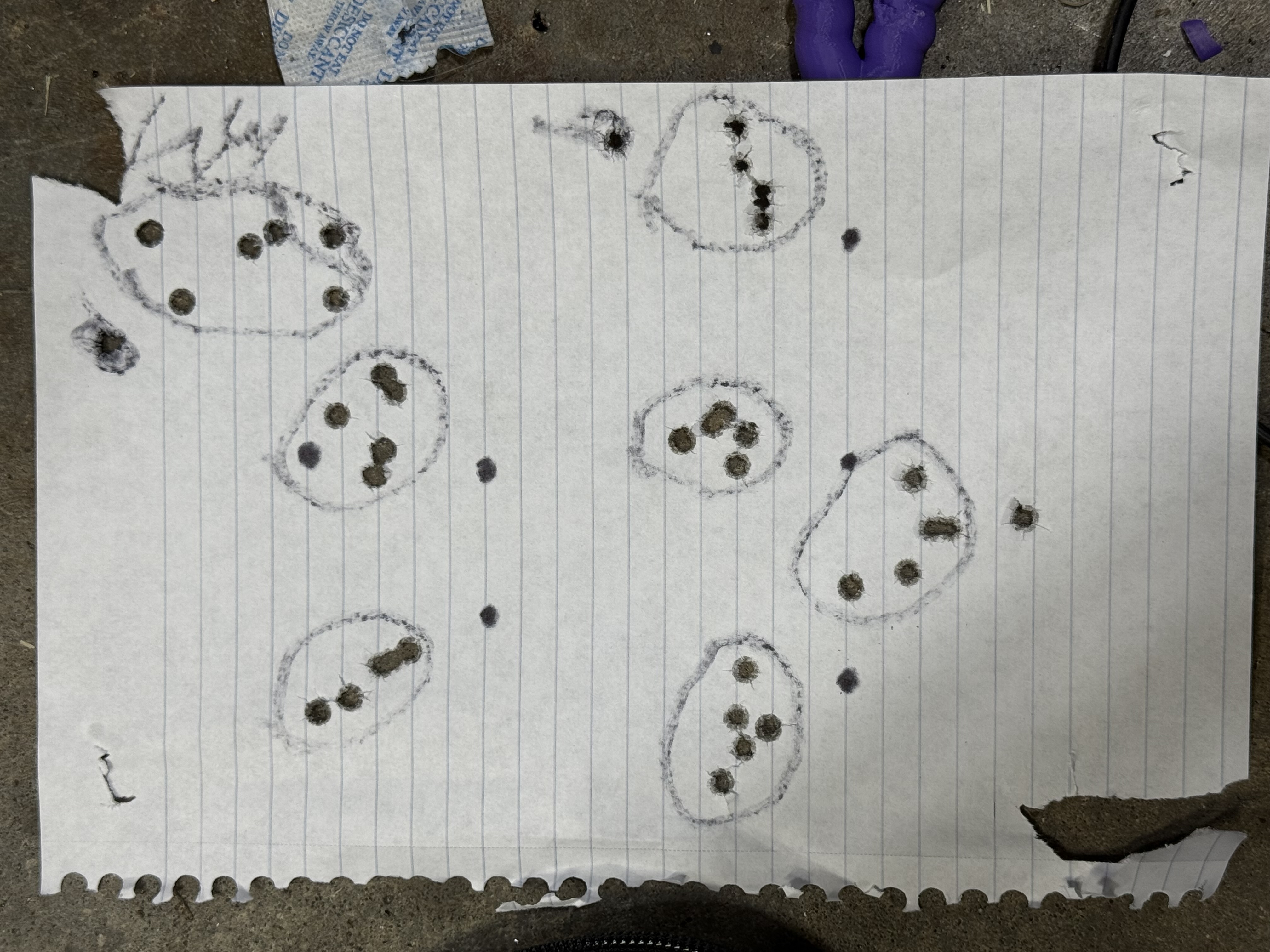

So there’s 25 yards. More than acceptable. I only tried it with the goofy rear-pod, not the normal way. Could have got it better shooting correctly.

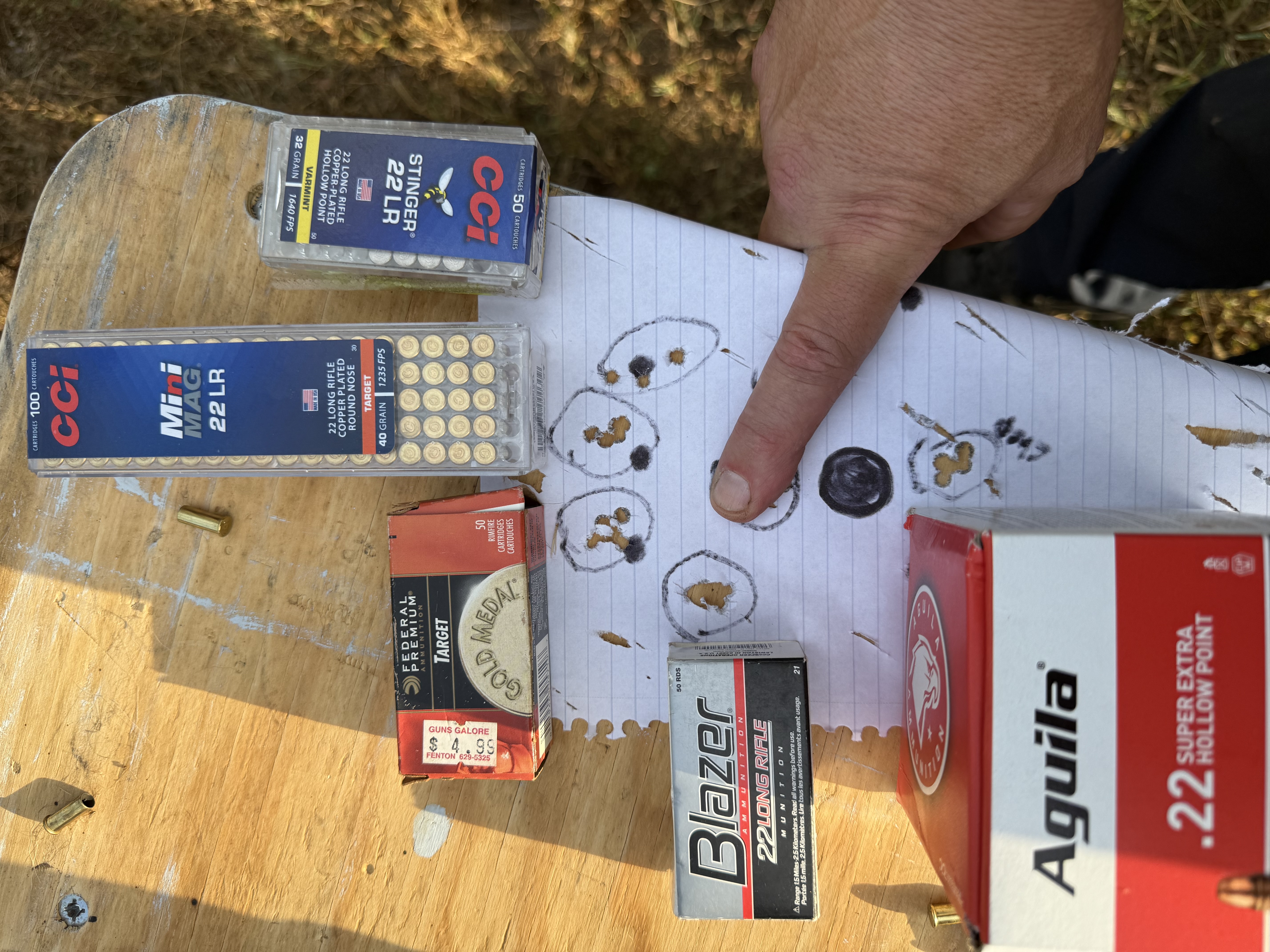

Re: New .22.

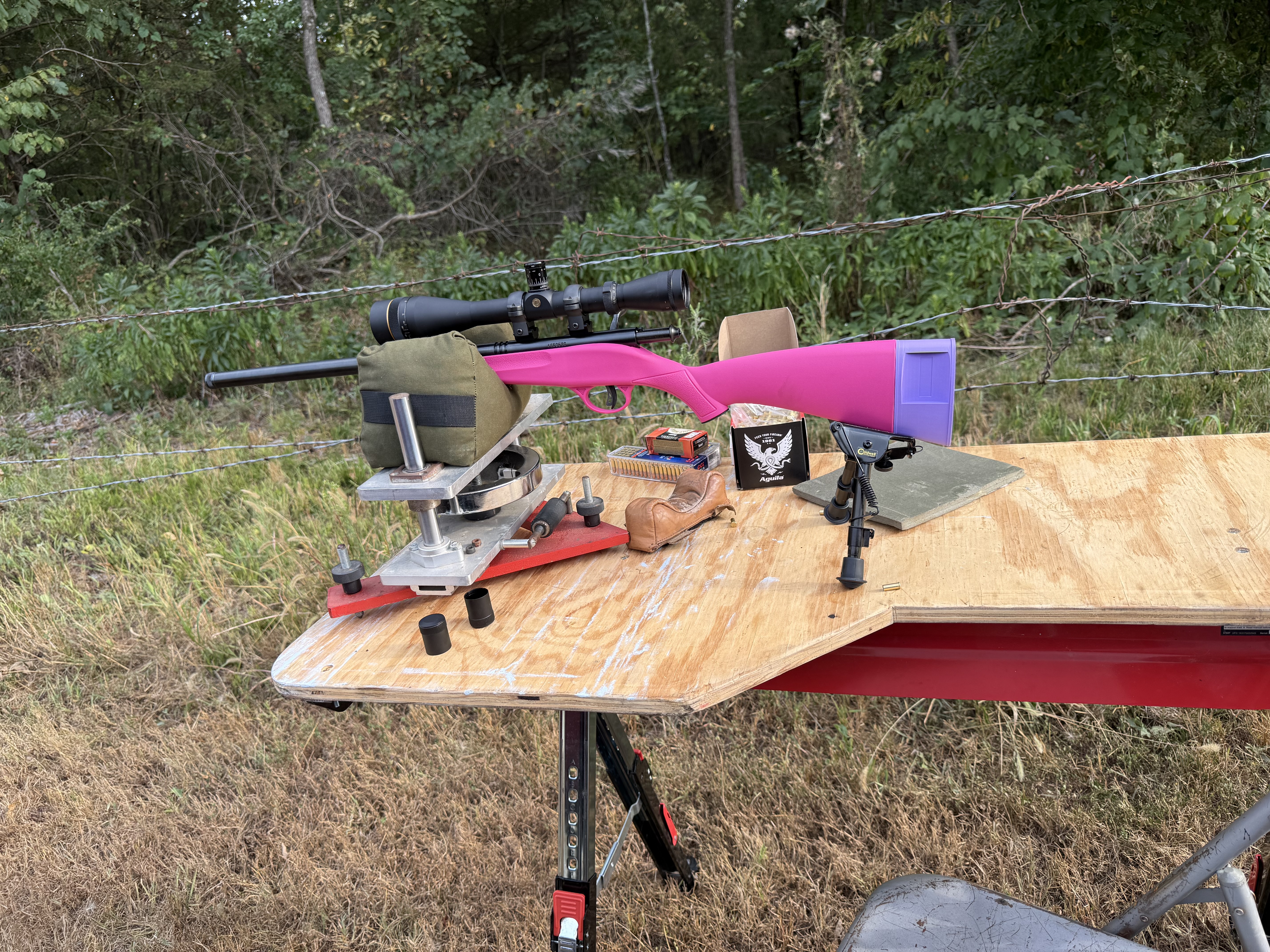

So upper right group was CCI minimag target, the rest Aguila super extra. They are about the “cheapest” .22 you can get these days. Which is awesome, cause they seemed to shoot the best. .80-ish groups at 50.
Rests were pretty much a no go, at least the front rest I had. Gun is way too skinny for the bag I have. Bipod and bag was the way. Length of pull with the extension is compact but doable. Without it would be pretty much impossible to be serious. The main issue is the scope placement, it’s as far forward as it can go with that mount. So you could somewhat comfortably settle in, then have to move your head back to get a sight picture. One piece base could help with that, but would block access to the chamber for loading. But I could always wack out a chunk of the rail to allow better access.

Re: New .22.
Overall rating? Considering what it is and who it’s designed for, 10/10. Can’t beat it for a kids first rifle. Much better than the Cricket, there’s no working the bolt and then operating a knob to cock. It works like a regular bolt gun should.
2.5 to 4.4 pound adjustable trigger. Not really creepy. While the accutrigger isn’t the best trigger, for most people who aren’t snobs and especially for kids, it’s hard to beat. Crappy triggers on guns made for kids with weak fingers are dumb. I’m going to tweak it, because I’m me.
Bolt operation is pretty dang smooth. There’s a little “hitch” when pushing it forward over the single shot feed ramp as the bolt nose pushes it down. That’s me being picky. It may get removed. I find it easier to just place the round into the chamber and run it. Removing that part would “fix” that, not too mention it’s in the way of my barrel clamp chassis idea. You can’t just toss a round in the chamber and it magically centers itself so you can close it. It needs to be in the groove on the ramp. I do prefer this over mag fed for the purpose of this rifle, and especially for kids. Unless it’s a 10-22 mag, most .22 mags, especially Savage mags are pretty meh. And you need to stop your shooting to load mags. With this I can sit at the bench with a bucket of ammo and shoot without ever breaking form. It’s very relaxing to shoot this way.
Overall finish isn’t horrible, above average for blue jobs these days. If you expect bluing from the 1950s, move along till you drop 4 times the cash. What impressed me was the interior receiver finish. VERY smooth. 10 times better than my Ruger American .308. Which is disgusting, for a $700 rifle. And better than the Ruger American .22 I used to own.
I think theirs more precision hiding within, of course ammo selection is paramount with .22s. Hell it liked the cheaper stuff better than the more expensive stuff. I don’t think the stock is limiting the potential a ton, other than of course the tiny size. It’s a pretty sturdy stock for Tupperware.

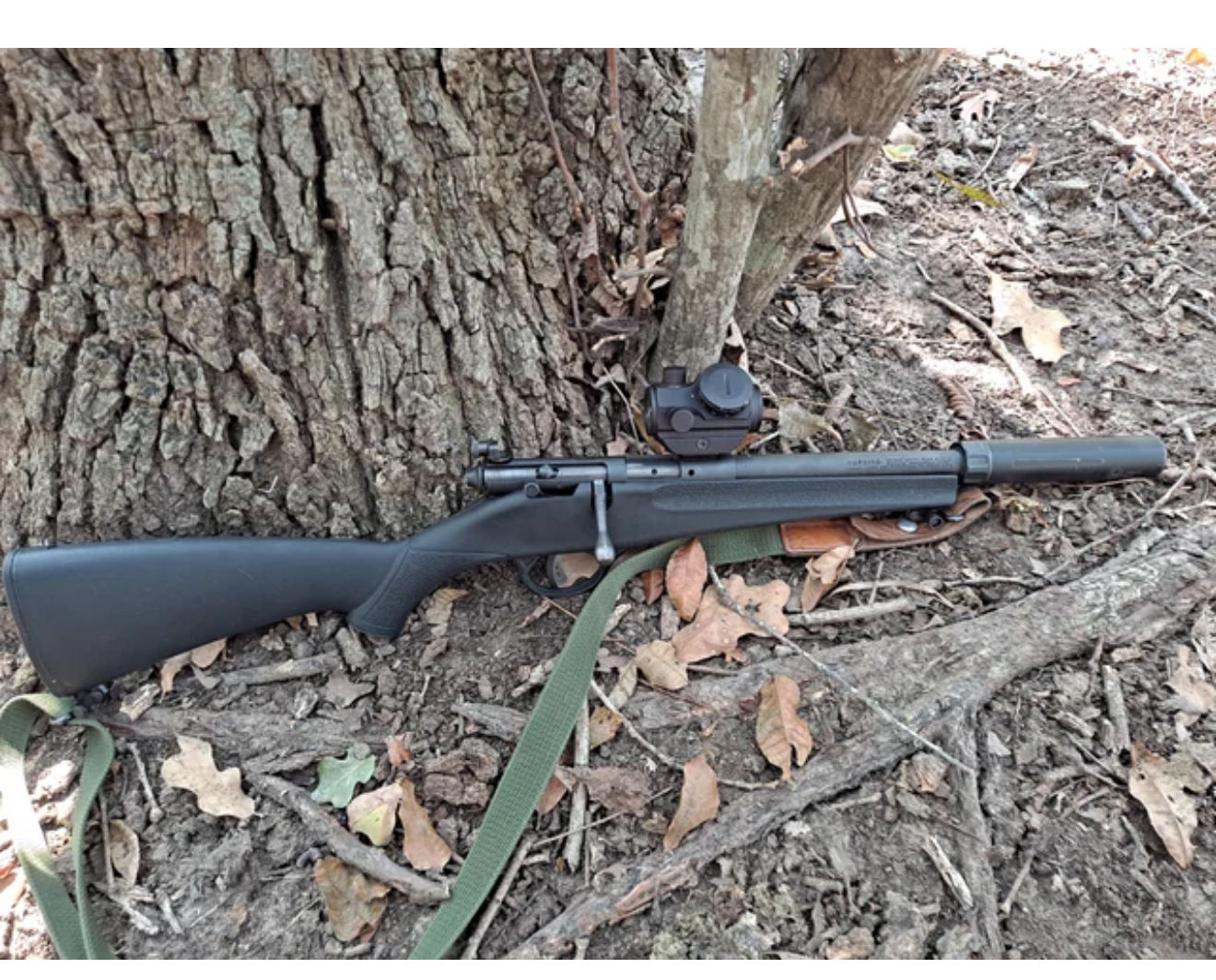

Re: New .22.

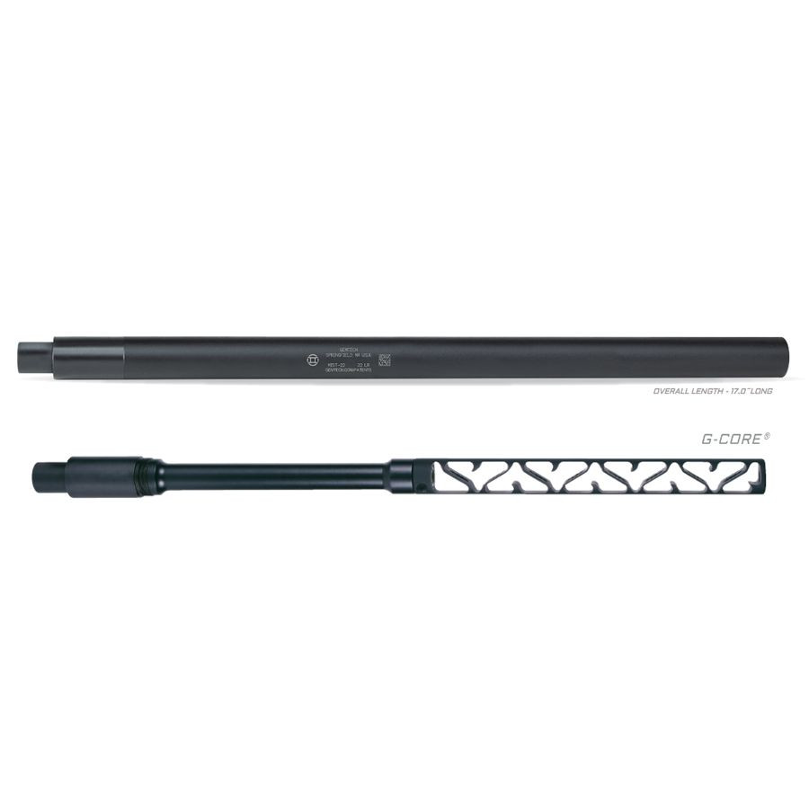

Someone already has.Wambli Ska wrote: ↑Sun Aug 31, 2025 9:39 pm I was just about to pull the trigger on a charger for a full time Jeep gun but damn this guy with an RDS and a small can might be the way to go!!! If there’s no $200 pay to play, why not cut the barrel to 12” and build a shroud type suppressor over the barrel?
You have skills………. and machines![]()
- Attachments
- IMG_4736.jpeg (1.31 MiB) Viewed 2943 times
- Posts: 4534
Re: New .22.
Yeah that but more like the Gemtech

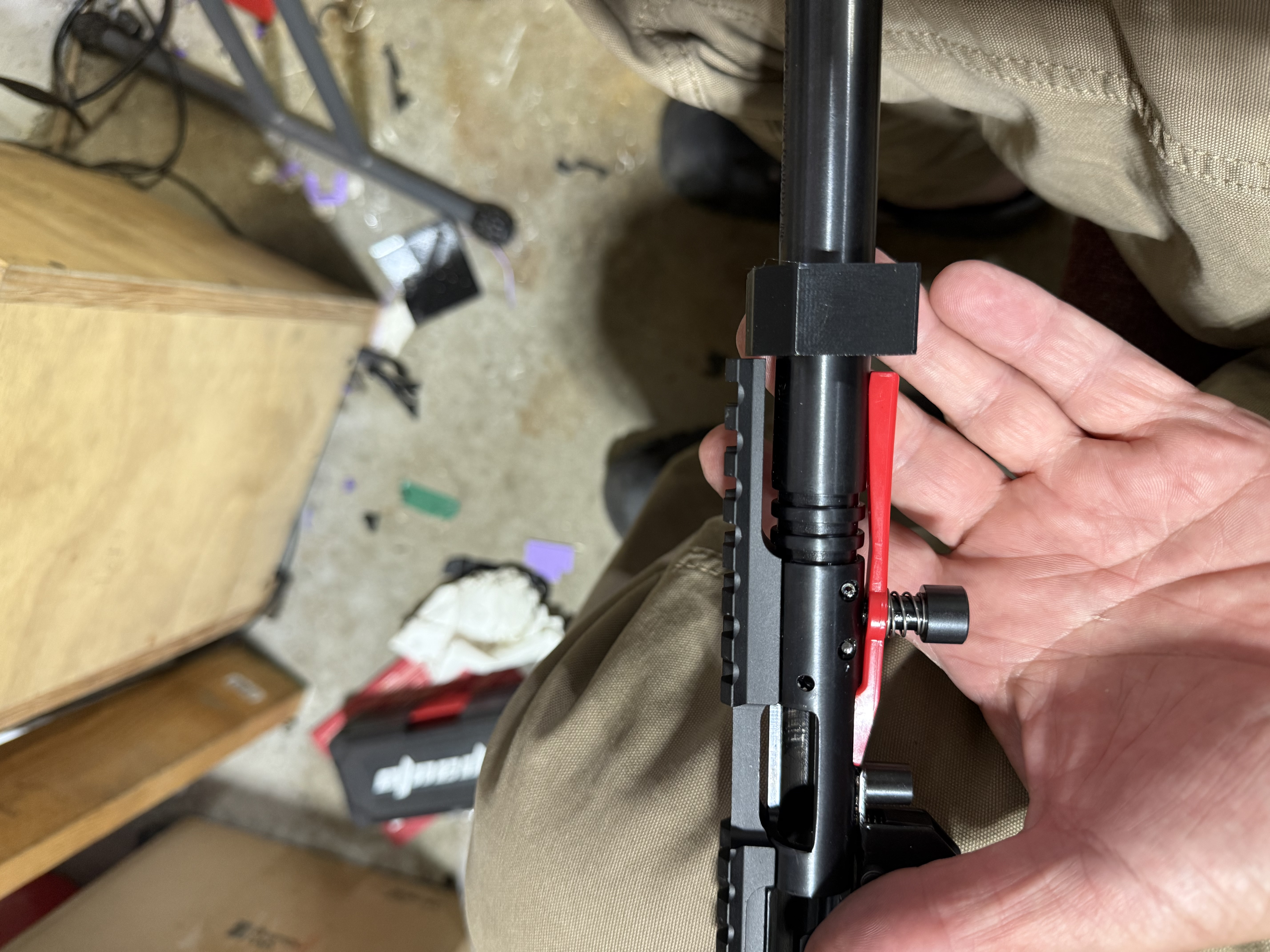

I love 3d printing.
You can draw something, have the robot poop it out and actually see and feel how it’s going to work. With zero effort.

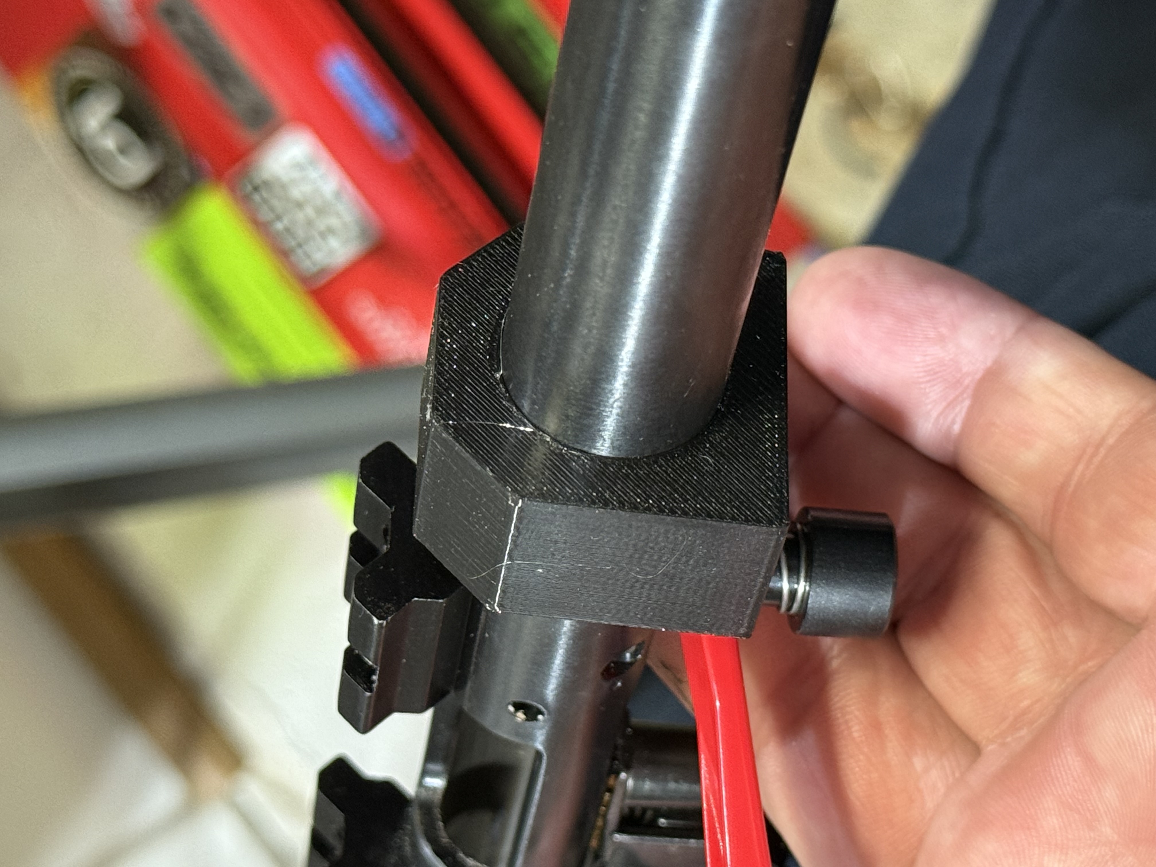

That’s what’s going to hold the barreled action to the chassis. Floating both barrel and action. That was just a size test.

Have to wait till I get my one piece base tomorrow to check some more fitment issues. My clamp could (but probably won’t) hit the scope if I’m not careful.

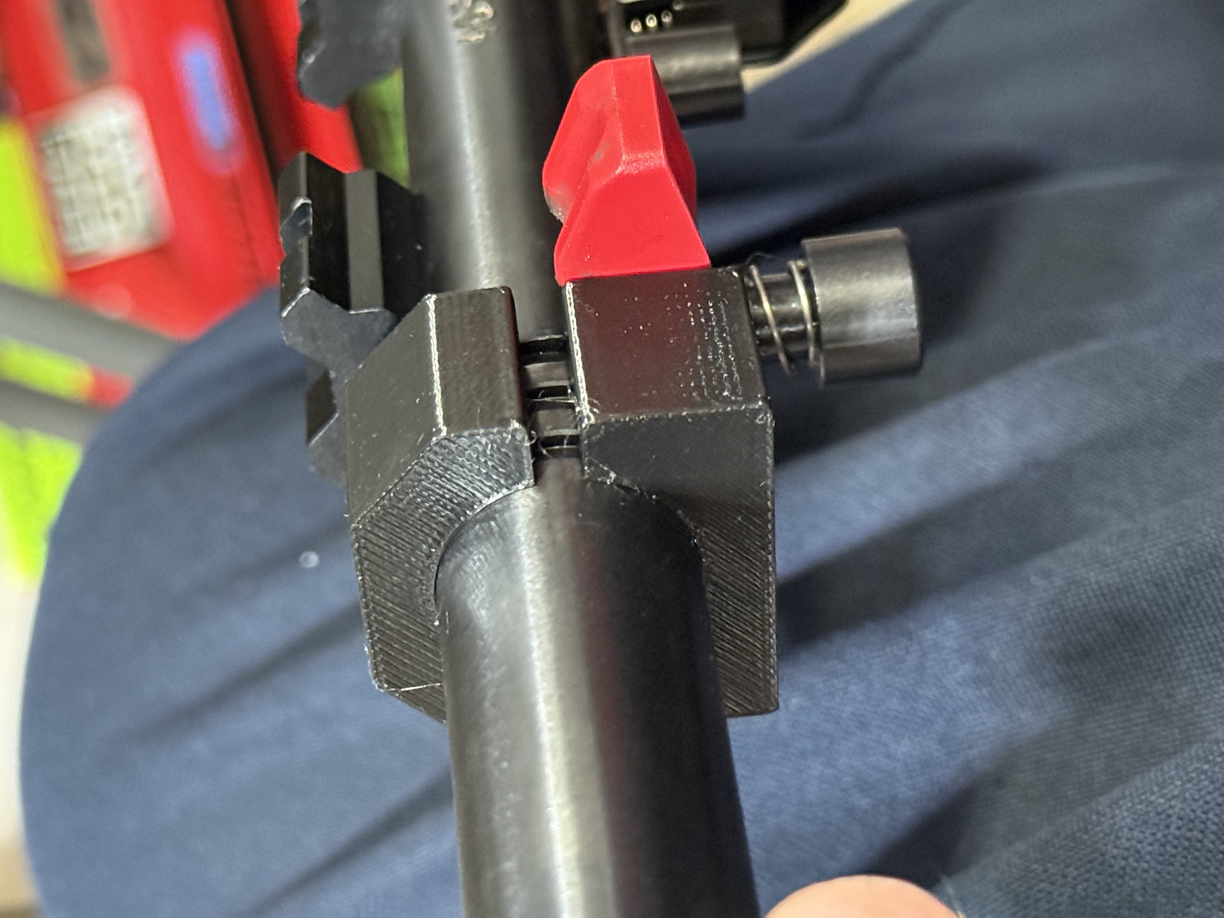

Re: New .22.
Have to push the barre clamp forward. Not enough meat would be left if it goes under the base. Upside is I don’t have to deal with the feed ramp. (Red plastic bit)
Current plan is to build the chassis, and test. If it’s not satisfactory, barrel will get pulled. Or pushed, rather. Pushed out. Cut it back slightly and rechamber. The reamer I made worked awesome on another barrel. So, it’s free to do. It will either get pressed back in, or most likely I’ll thread the action and barrel so that I can swap barrels easily at some point in the future. I’ve got a couple blanks from Tennmike, I may install one of those.
