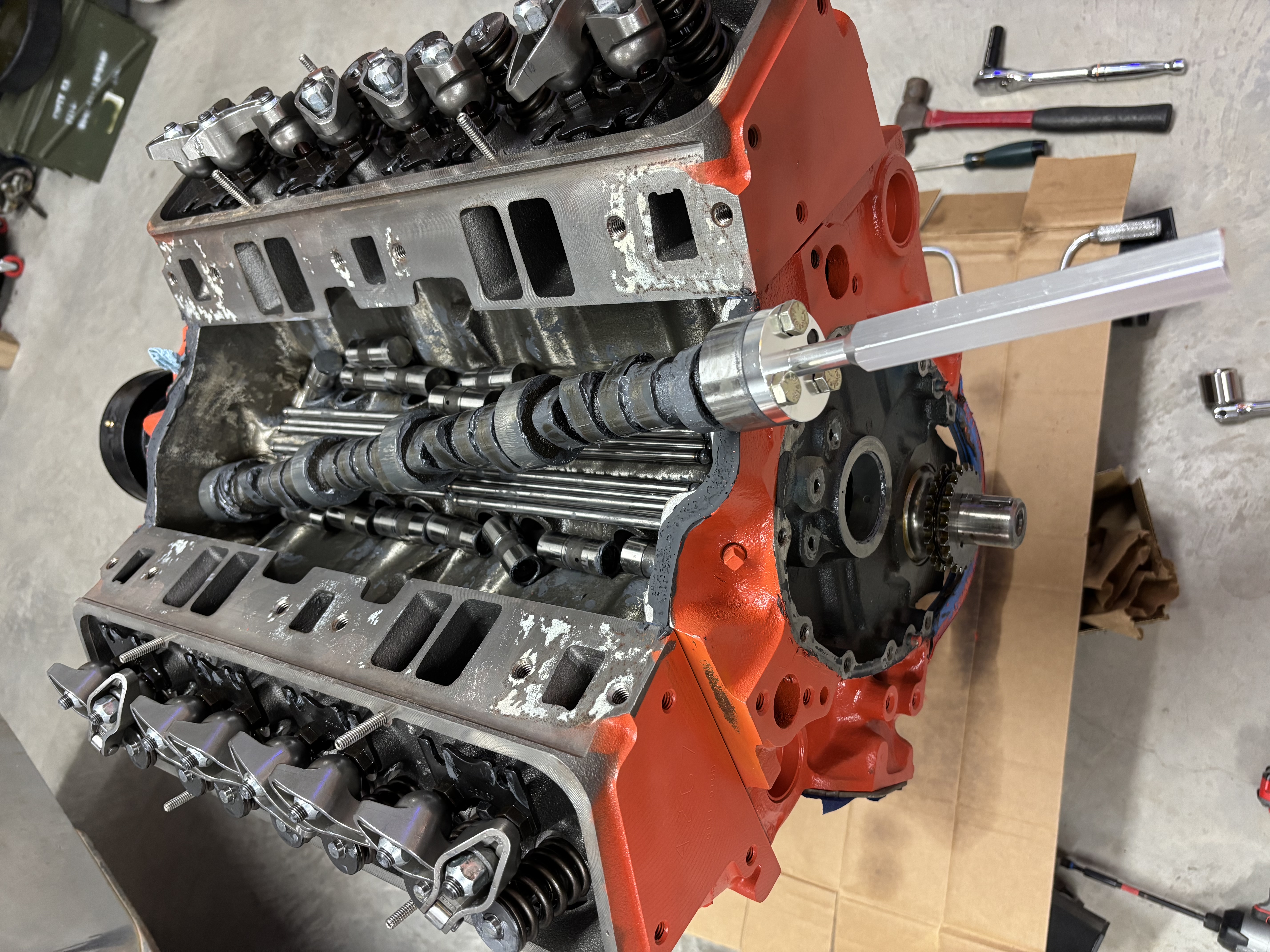

Now, many years later, I installed the cam in my current engine straight up.. they’re usually ground with 4 degrees advance in them anyway. And it’s a 400hp engine…. No need to mess around and find out.
With flat tappet cams, there’s a trend of lifter failure, wiping cam lobes out and destroying the engine. Seems to boil down to 3 things. Metallurgy, oil and break in. Cam and lifter metallurgy has gone down hill. Most common off the shelf oils don’t have zddp additives needed for proper flat tappet break in and use. A good break in oil is needed. Then follow a good break in procedure. Usually something like 30 minutes at 2000 rpm, varying rpm throughout to get oil splash on the cam and lifters.
I’m trying tech. Bought a nitrided cam and “DLC” lifters. Basically a very slick and very hard carbon coating. It wasn’t cheap. But still cheaper than a roller cam setup.
Keep these things in mind as you build your engine…

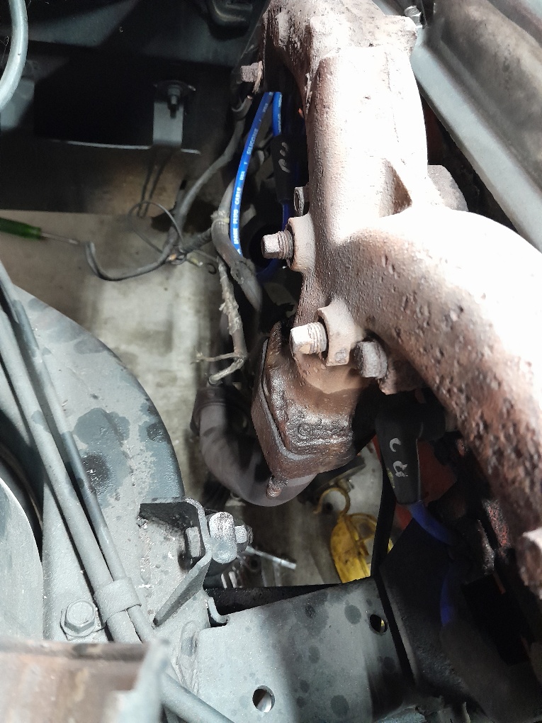

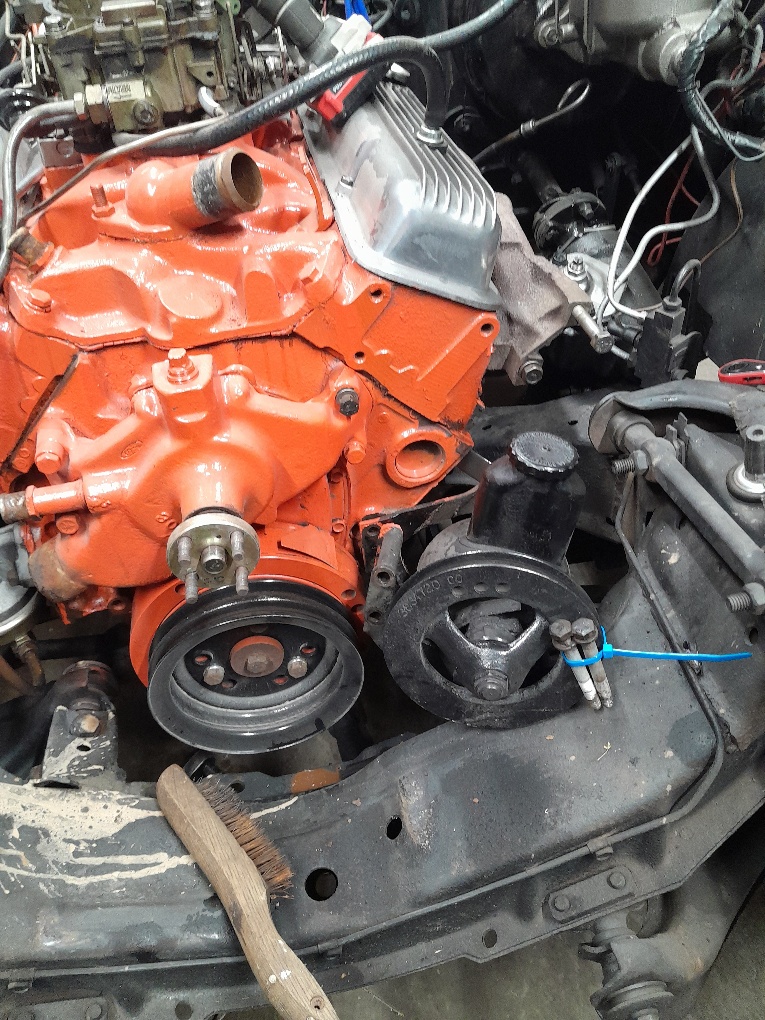

Ok, got into it after lunch again
Pwr steering off, right side pipe, starter out, fuel lines, pipe u bolts. alternator.
Little coffee break and figure out next thing.

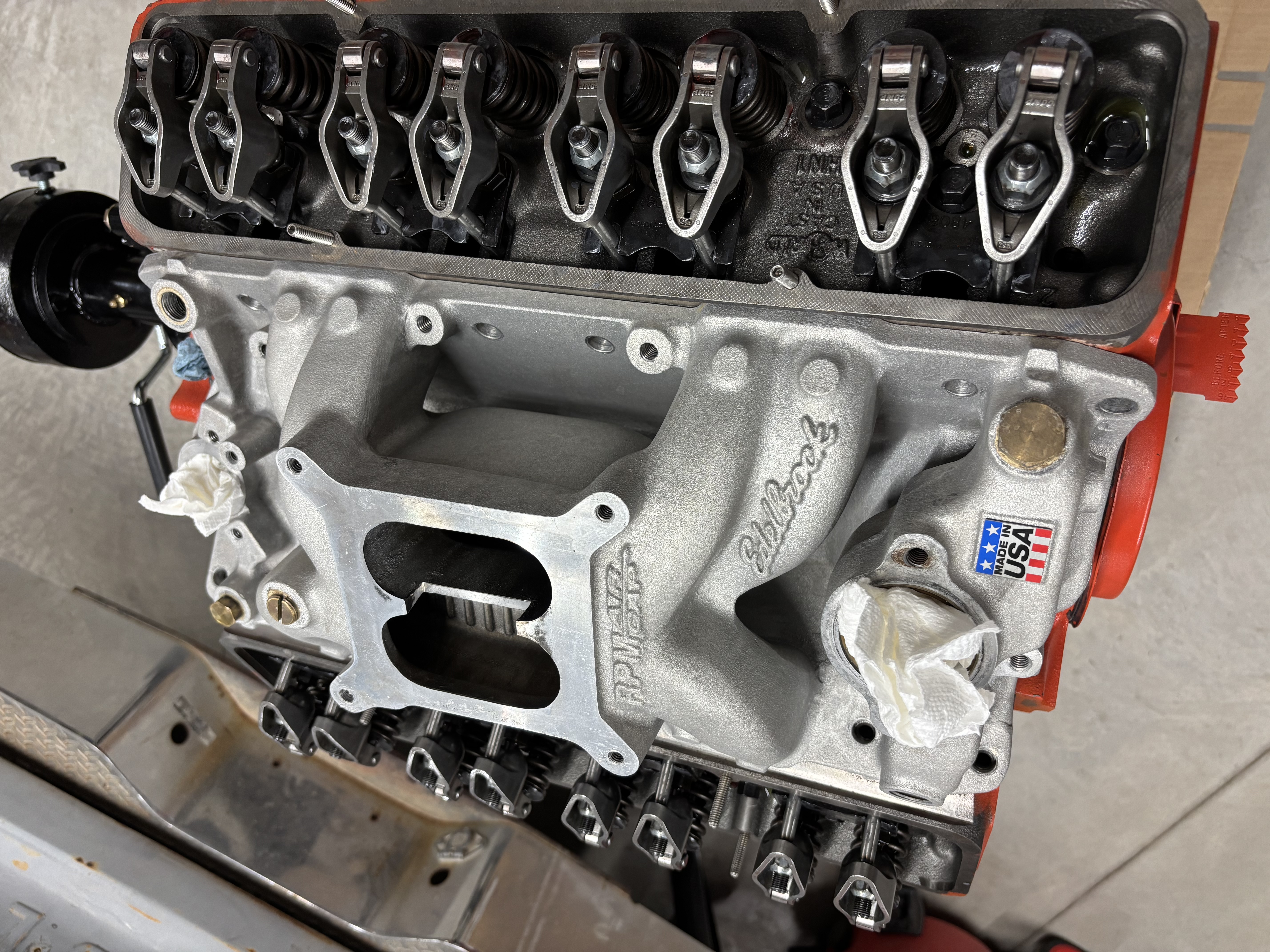

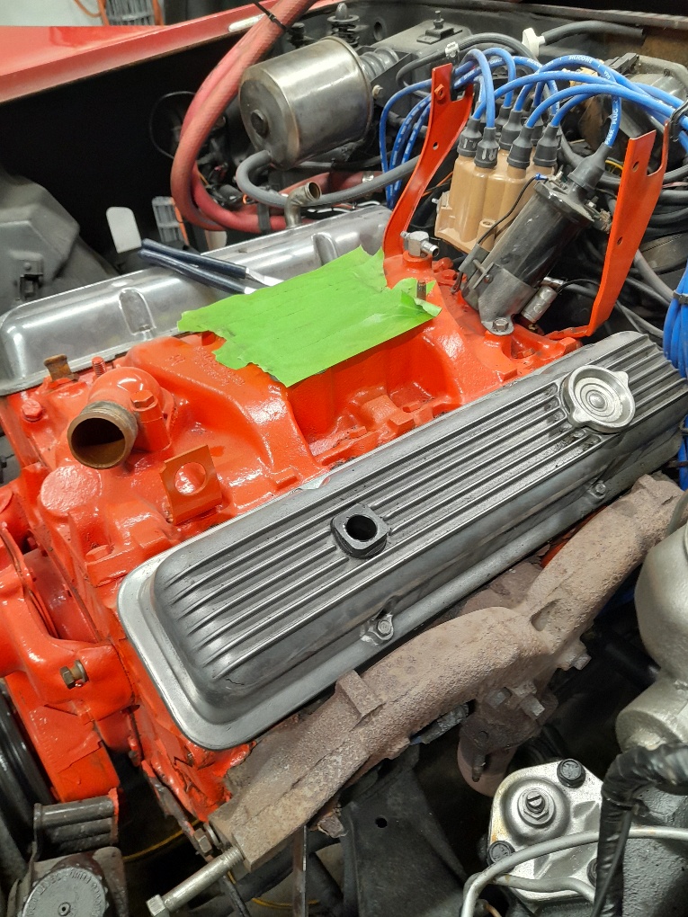

I’d be curious to know the casting number on those heads when you get a valve cover off.
Re: Engine refresh
Posted: Tue Nov 25, 2025 3:49 am
by Jay
That motor looks nice and clean. It’s obviously been apart before. At least the intake manifold has been off. Something with that kind of age, seems logical.
Re: Engine refresh
Posted: Tue Nov 25, 2025 3:51 am
Jay wrote: ↑Tue Nov 25, 2025 3:49 am That motor looks nice and clean.
It’s gots then double hump heads. Probably a 3/4 race cam. Most likely the front tire can clear a Coke can at launch.
Re: Engine refresh
Posted: Tue Nov 25, 2025 4:09 am
by Jay
CPJ 2.0 wrote: ↑Tue Nov 25, 2025 3:51 am
Yeah. That’s what made me curious about the casting numbers. There are multiple different casting numbers for the “camel hump” heads.
That motor looks very clean and somebody has been into it before. The crank pulley bolt has overspray on it and the intake was installed with RTV on the china wall instead of the rubber china wall gaskets, which should always immediately go in the trash can. Kinda makes me wonder how much freshening up that motor needs. 🤷🏻‍♂️

Cam swap.

Jay wrote: ↑Tue Nov 25, 2025 4:09 am
Enough to keep the oil inside and not passing the rings, although its a benefit during mosquito season. Its also 56 years old so it may have gone round once.
It may have been into, but it also sat. Much of the look is what to me looks like a "looks pretty" coat. Not the only thing like that.

Posted: Tue Nov 25, 2025 8:24 pm
Someone probably put hardened vavle seats in it once leaded gas went away.
Re: Engine refresh
Posted: Wed Nov 26, 2025 1:08 am
by Jay
Varmintmist wrote: ↑Tue Nov 25, 2025 5:07 pm
Rotella has the zinc in enough PPM.
Looked like a little leaking at the front china wall. Obviously can’t see much more. Very well could be a rattle can rebuild. And JBOhio brings up a great point. It’s pretty likely it had hardened exhaust valve seats put in at some point.

Posted: Wed Nov 26, 2025 10:10 pm
by Varmintmist

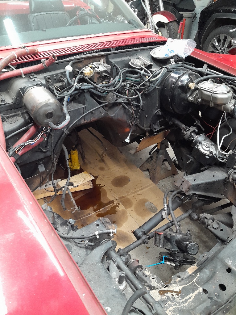

Just a bit more.
Pulled the carb and some more wires and vac off, dropped the left pipe off the manifold, then stared at the transmission for a while.
No rush, I am awaiting parts for the engine stand. I got it for 8 bucks at an auction. That and I have no idea about what I am doing makes the lack of speed OK.

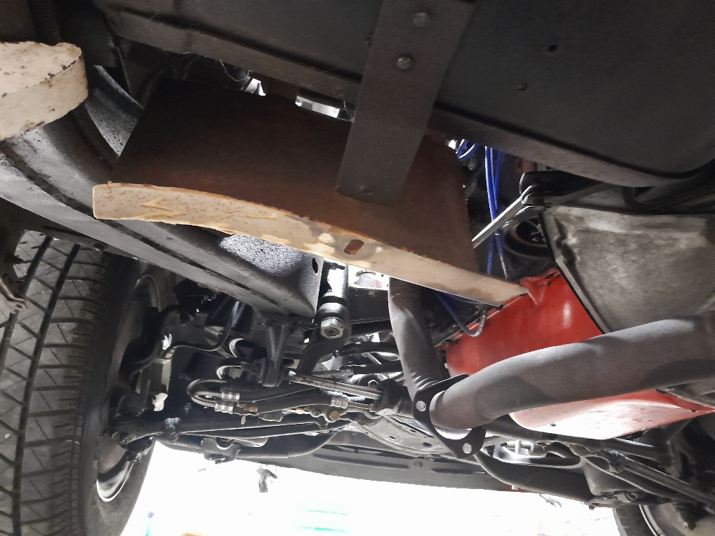

Driveshaft is off, all the transmission linkage, wires cables, got some fresh grade 8's and connected the crane and pulled the engine mount bolts, still need to pull a couple on the trans
Re: Engine refresh
Posted: Fri Dec 19, 2025 6:30 pm
by Varmintmist
Worked out this AM. Put the coveralls on, jacked the transmission and pulled 8 bolts from the transmission mount and heat shield, and away we went. Only had one thing still fastened so I did OK with merely slight blood loss. Getting a call from the rebuild shop in an hour. I know my limitations.

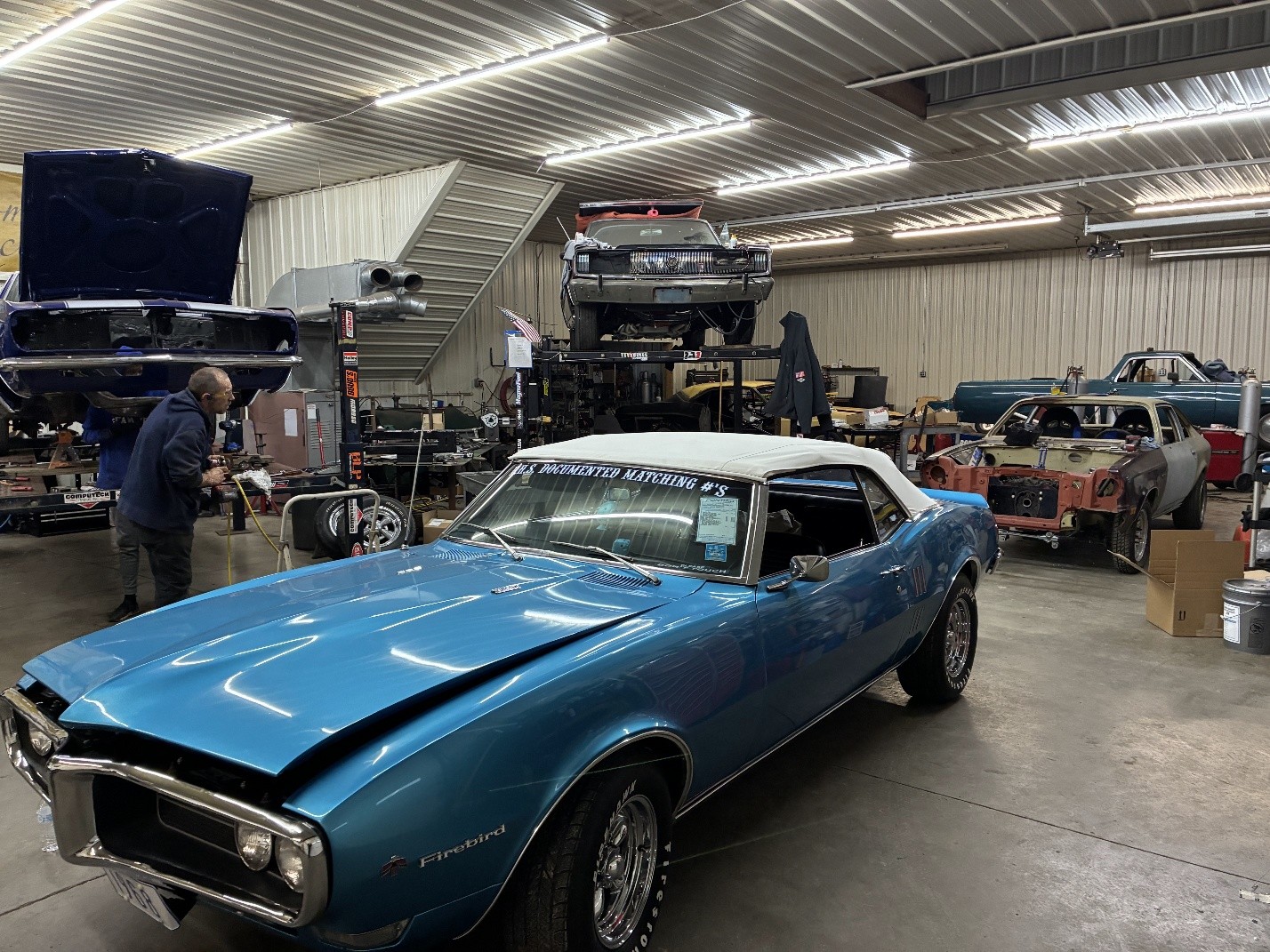

Pretty sure I have said it before, its a driver. I want it as a driver.
Mine aint real long but it has been quite productive with no complaints. Have no desire to make it bigger.
Good conversation with the shop that is going to do the work. It goes in mid Jan. He shot a pic on his way out. I think its in good hands.
