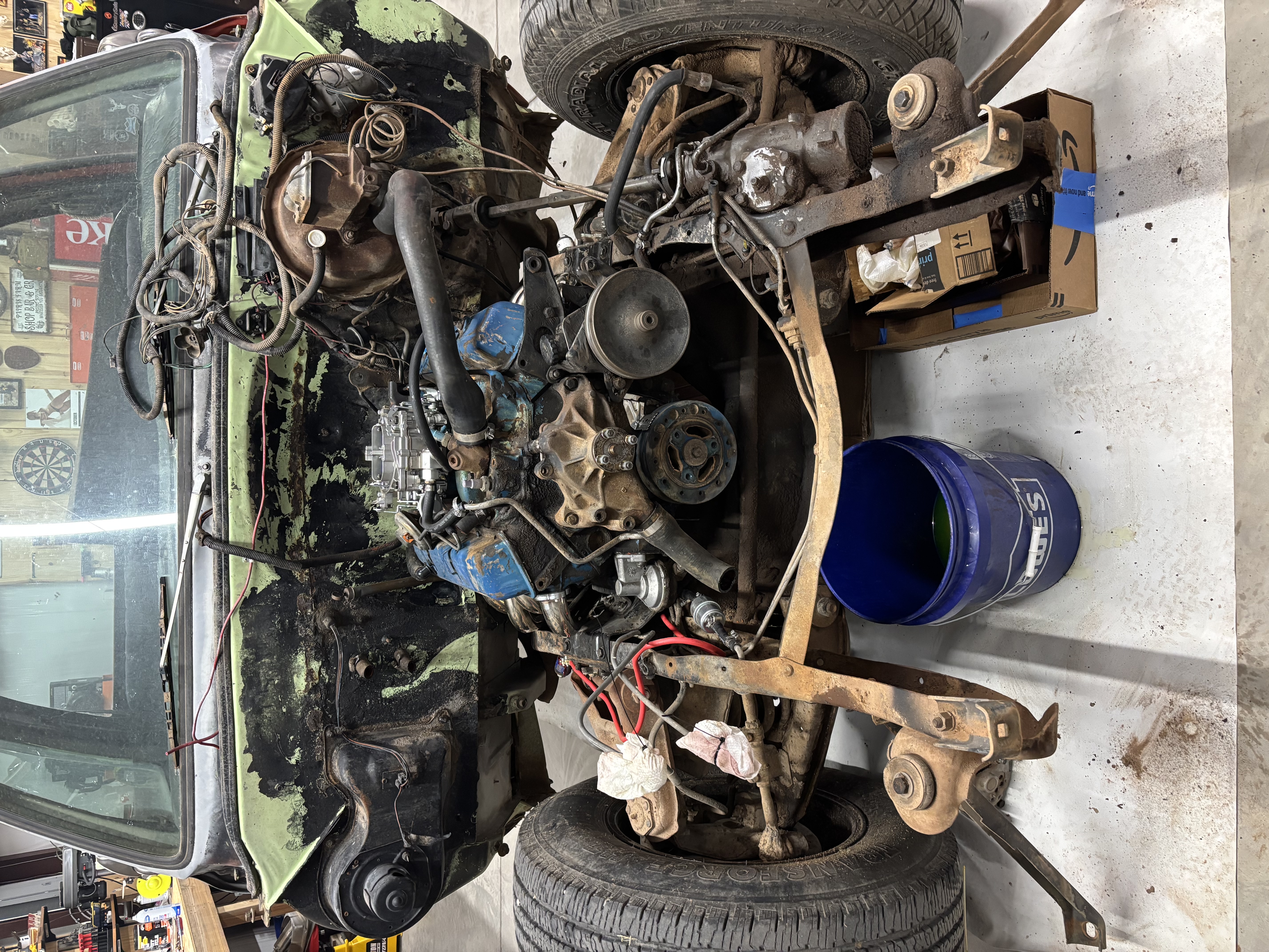

Got it up in the air and ran into the first problem. WHODATHUNKIT

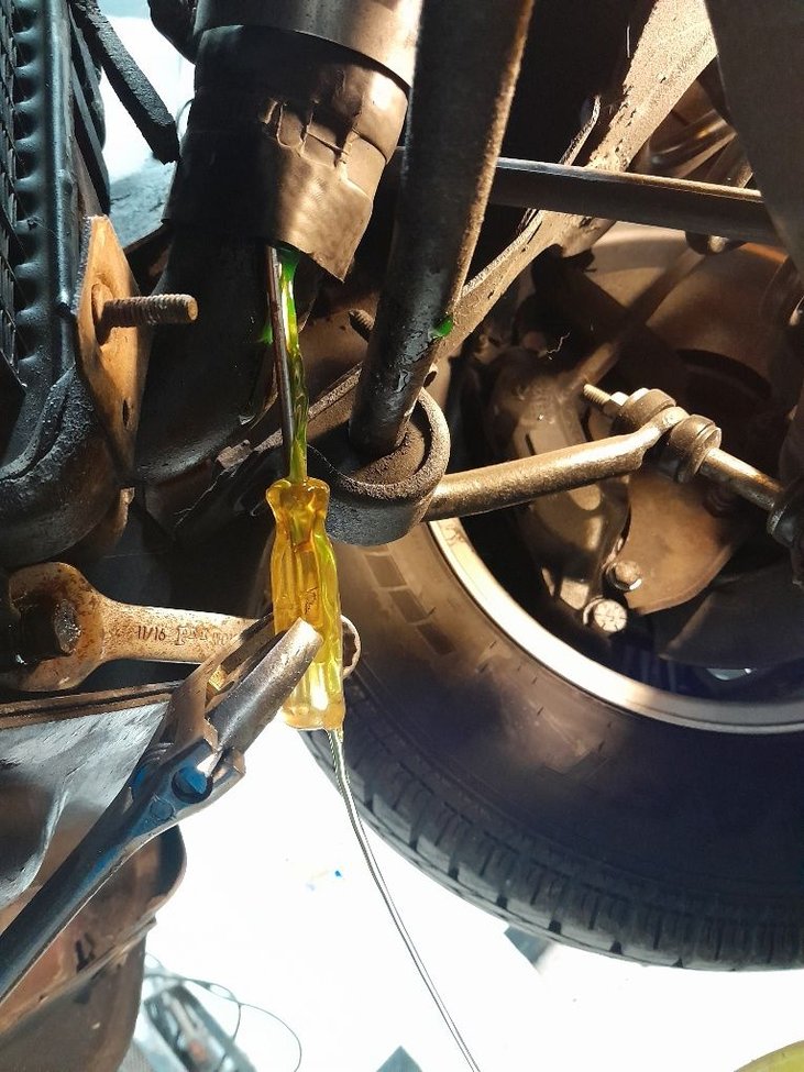

Drain plug frozen solid, I am guessing cross threaded. Even holding it I was bending the actual radiator tank itself.

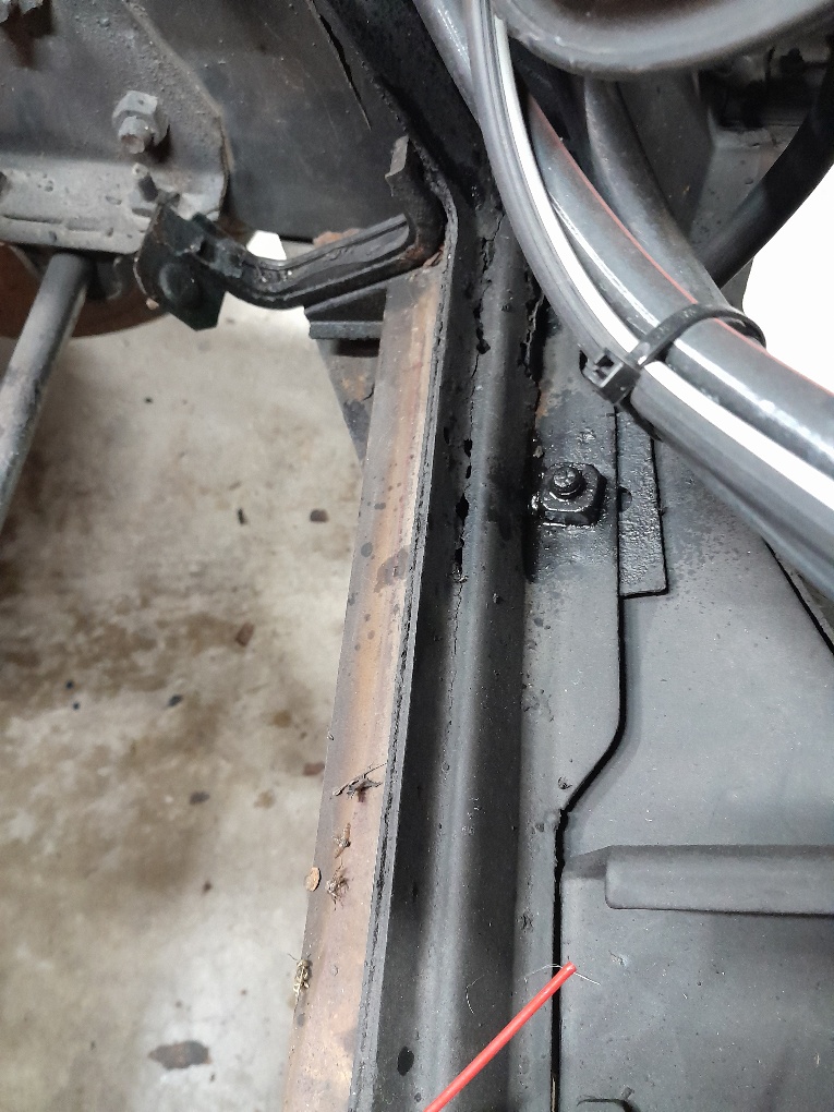

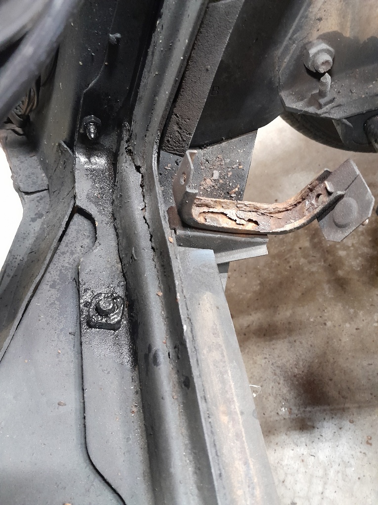

Got the radiator out, looked at the radiator support, its rotten. Not uncommon, but I was hoping...

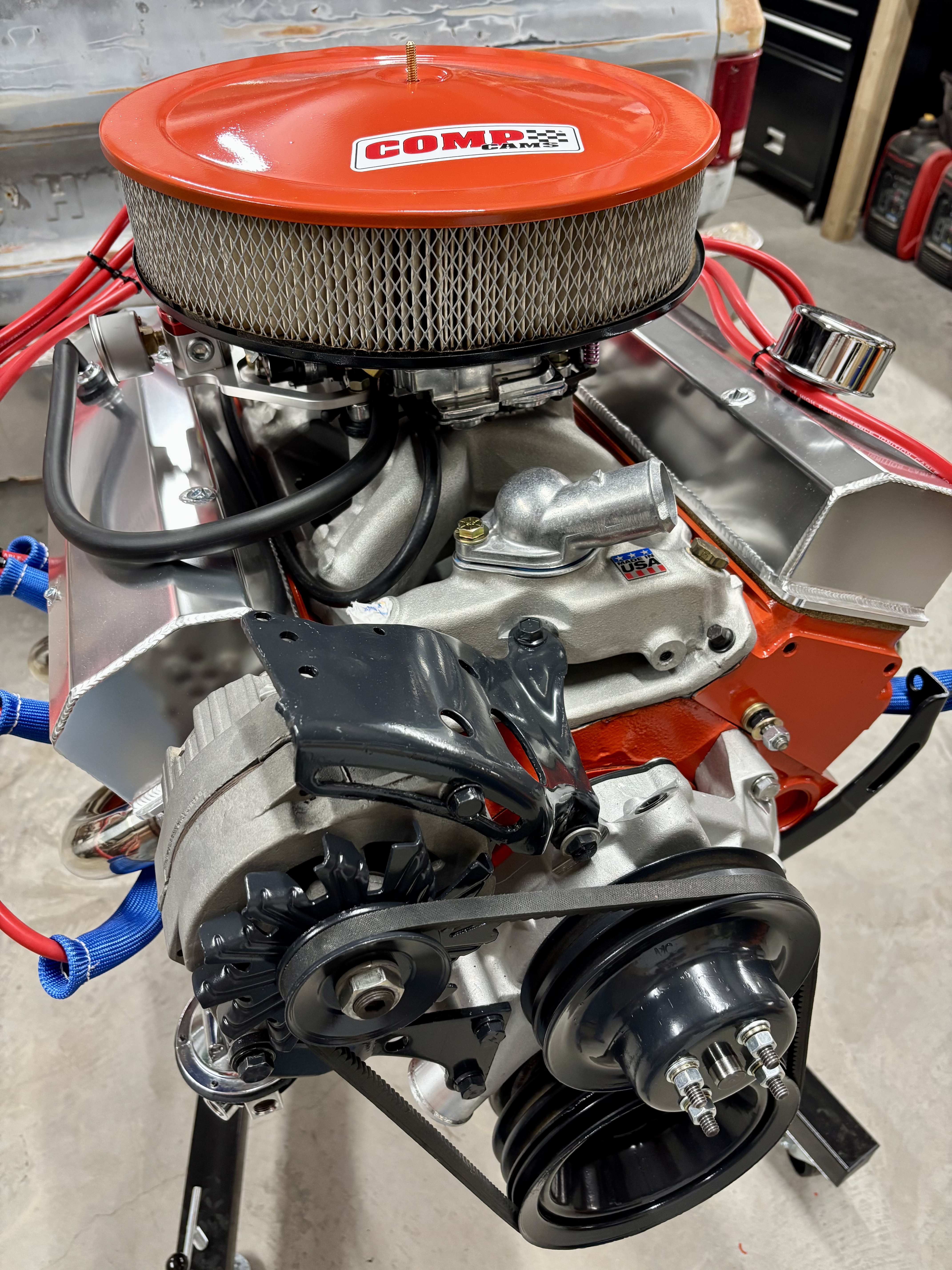

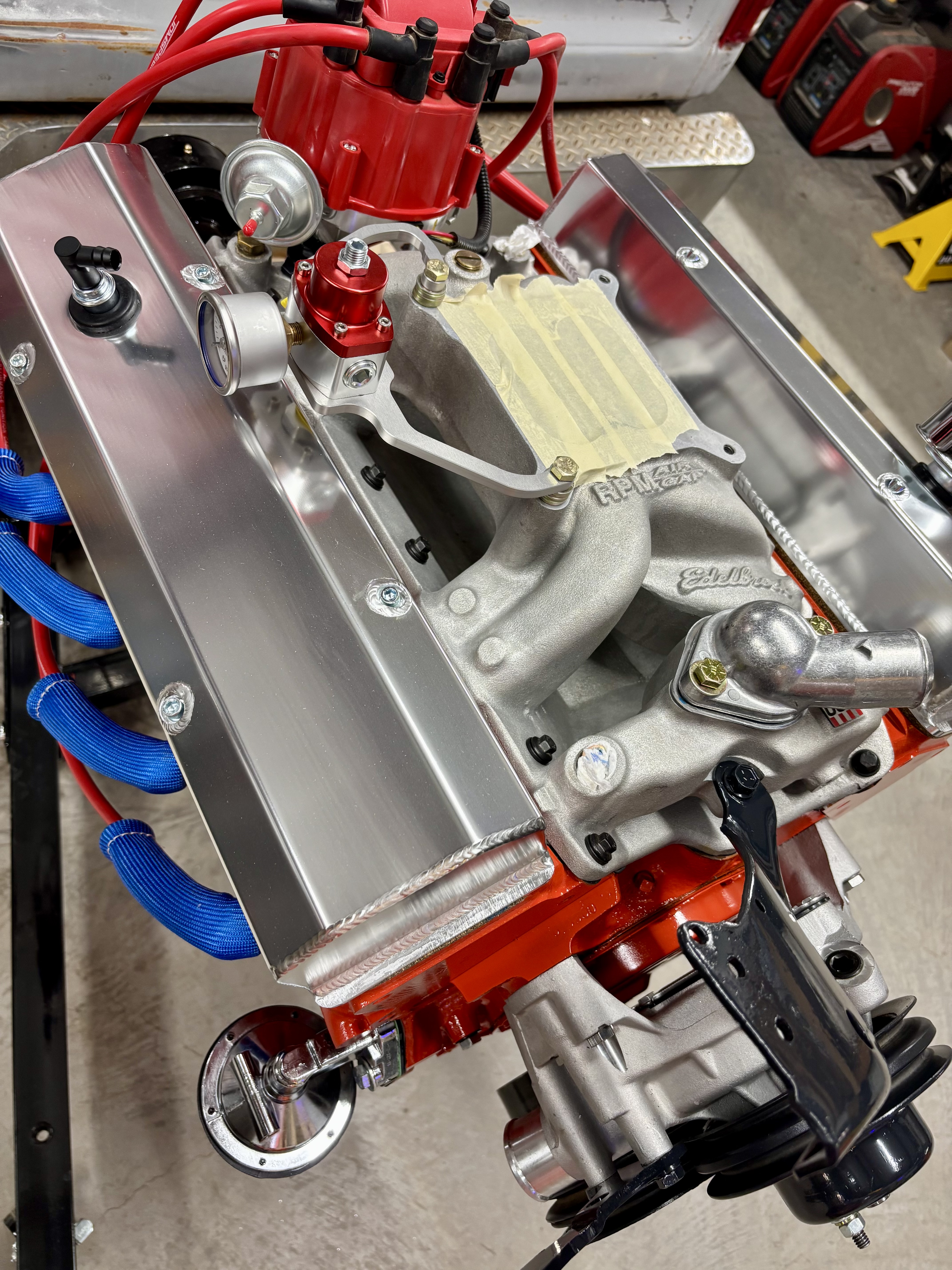

I happened to recently sell a factory GM aluminum “snowflake” intake manifold from a similar year Corvette or Camaro. I bought a newly built engine from a friend and he had that intake on it. It wasn’t what I was going for on my project and the cam in it was too small for what I wanted, so I tore it down, put in a bigger cam and lifters and an RPM Air Gap intake manifold.
355” SBC, 10:1 compression, World Products heads, Comp XE 274 cam. Nothing fancy. To go into a ‘76 Chevy C10 short bed. The original 350 in the truck was unfortunately replaced with a ‘79 smogger 305 at some point in its life. So swapping the engine is a must for performance. I’ll also be swapping the cab. It’s rusted pretty bad and has very little floor pan left. I have another cab that is in great shape and has solid floors.
