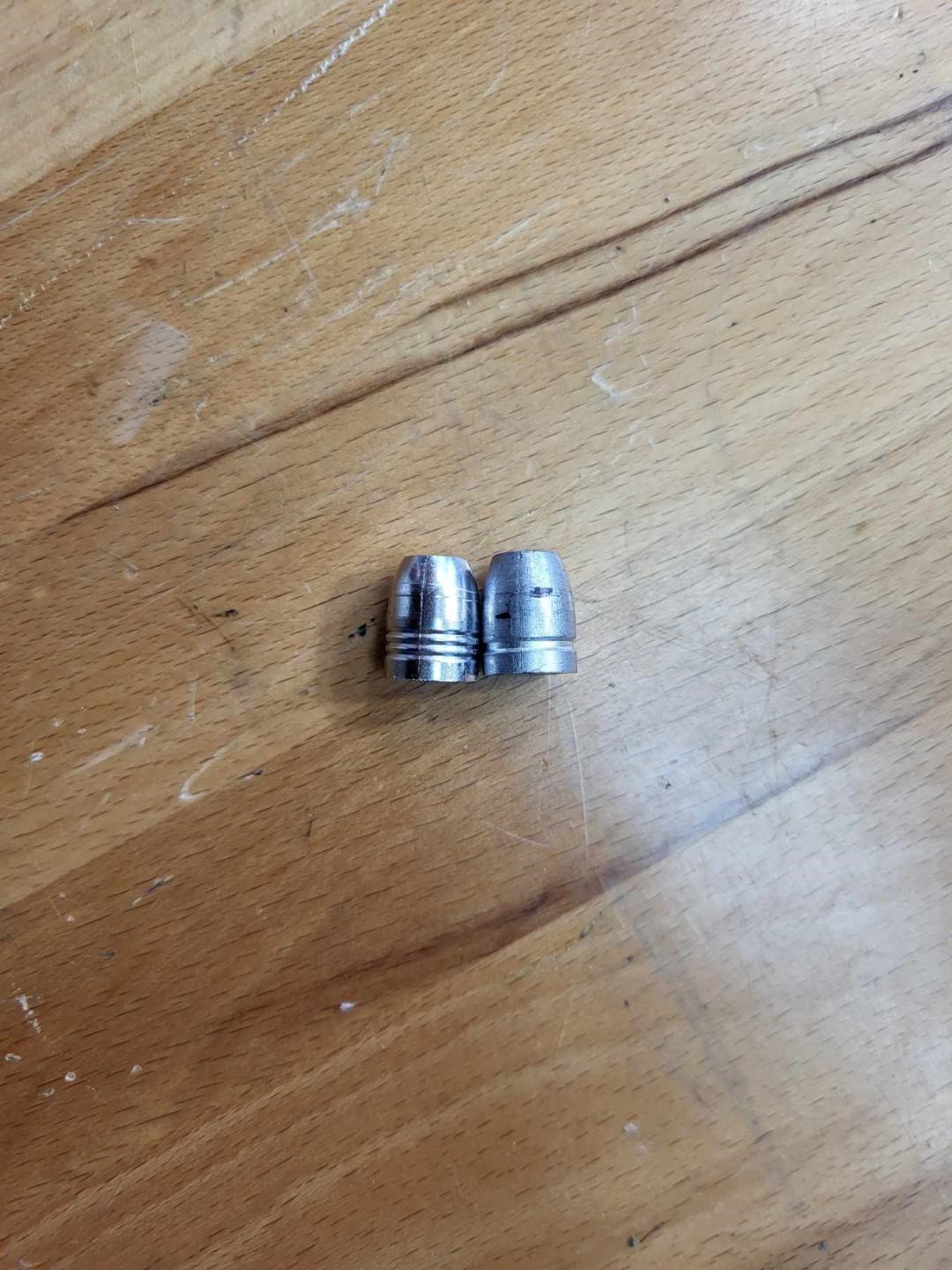

Acc 45-230H + LBT.jpeg (280.67 KiB) Viewed 2452 times
Bullet on the right is from one of Veral Smith's (LBT) molds, and it's about the slickest feeding 230 grain .45 Auto bullet you could ever hope for, but. . .conventional lube. After some careful measurements and comparison, I learned that the Accurate 45-230H on the left is samey-same, but with tumble grooves. Ordered it to cast at .452", and one production step omitted.

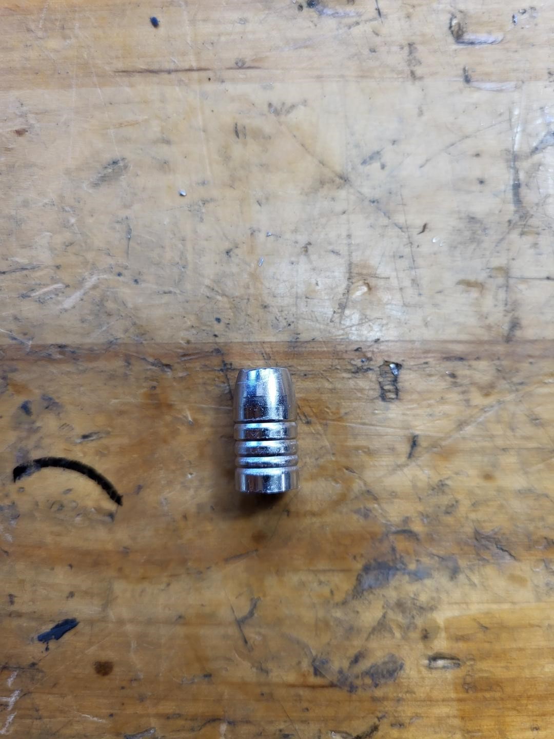

Acc 36-170C.jpeg (214.33 KiB) Viewed 2452 times
This one's my creation. I asked Tom at Accurate to take one of his pre-existing tumble lube designs and tweak it to have two crimp grooves for working with either .38 Special or .357 Mag brass.
