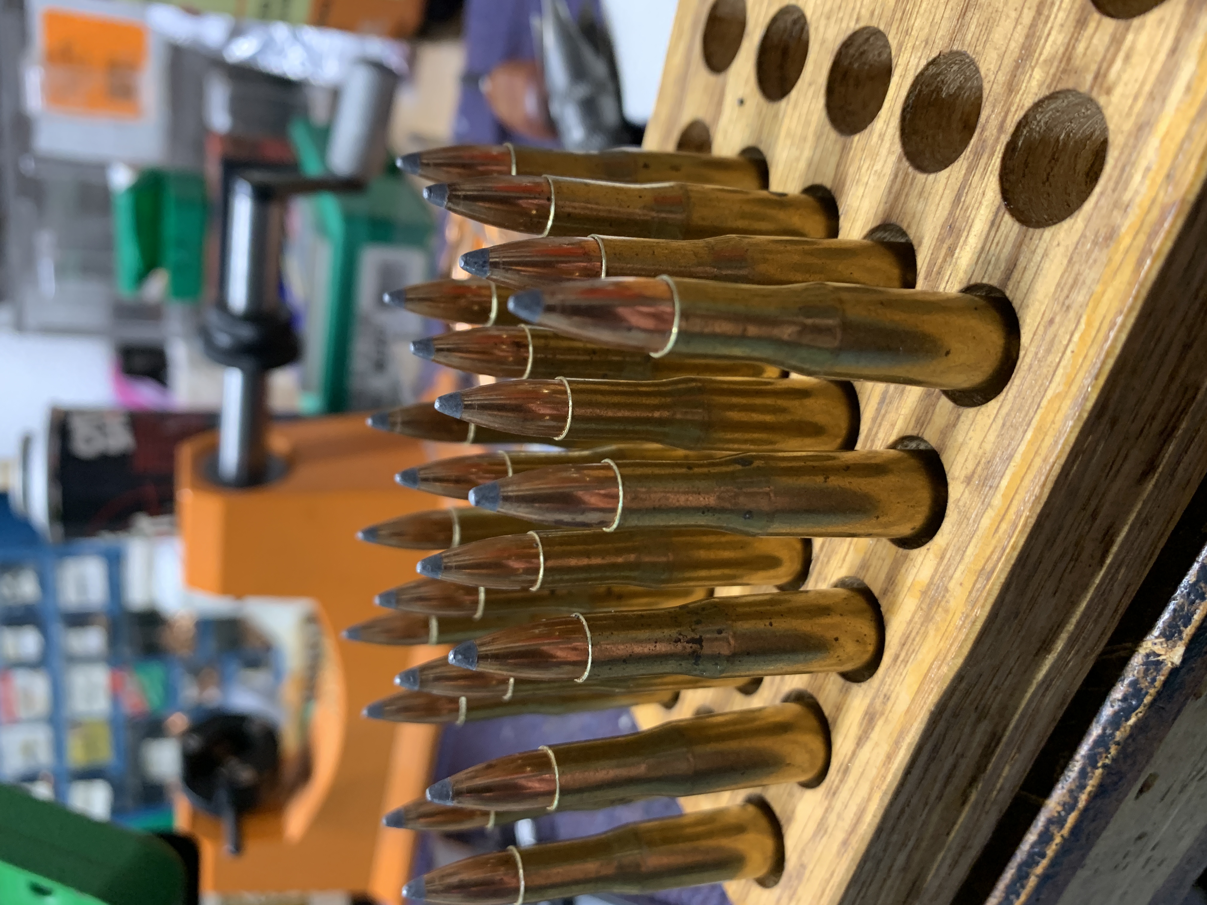

:lol: Interesting! Could be lee dies are not the best choice for the intended purpose. That's what I get for being thrifty, the Lee's were 10 bucks cheaper

Ready to launch!

I usually use Lee dies but I got the .25-35 dies at a gun show!
What load is that, powder/bullet??

117 gr BTSP 19.5-22.5 gr H4895

Yup! 4895 is what I used, don't remember the powder charge!

BTW wondering if your brass turned out about. 050 long as Al's did ?
Thinking if so that trimming 20-30 thousands off first would possibly help in reforming too.

And yes, my cases can out about the same long and will require trimming. Hadn't thought about trimming first, might be worth a try.

Seems if you could experiment and find the right starting length then you won't be moving as much brass back neck and shoulder wise.. it would possibly come out even better or easier then.
