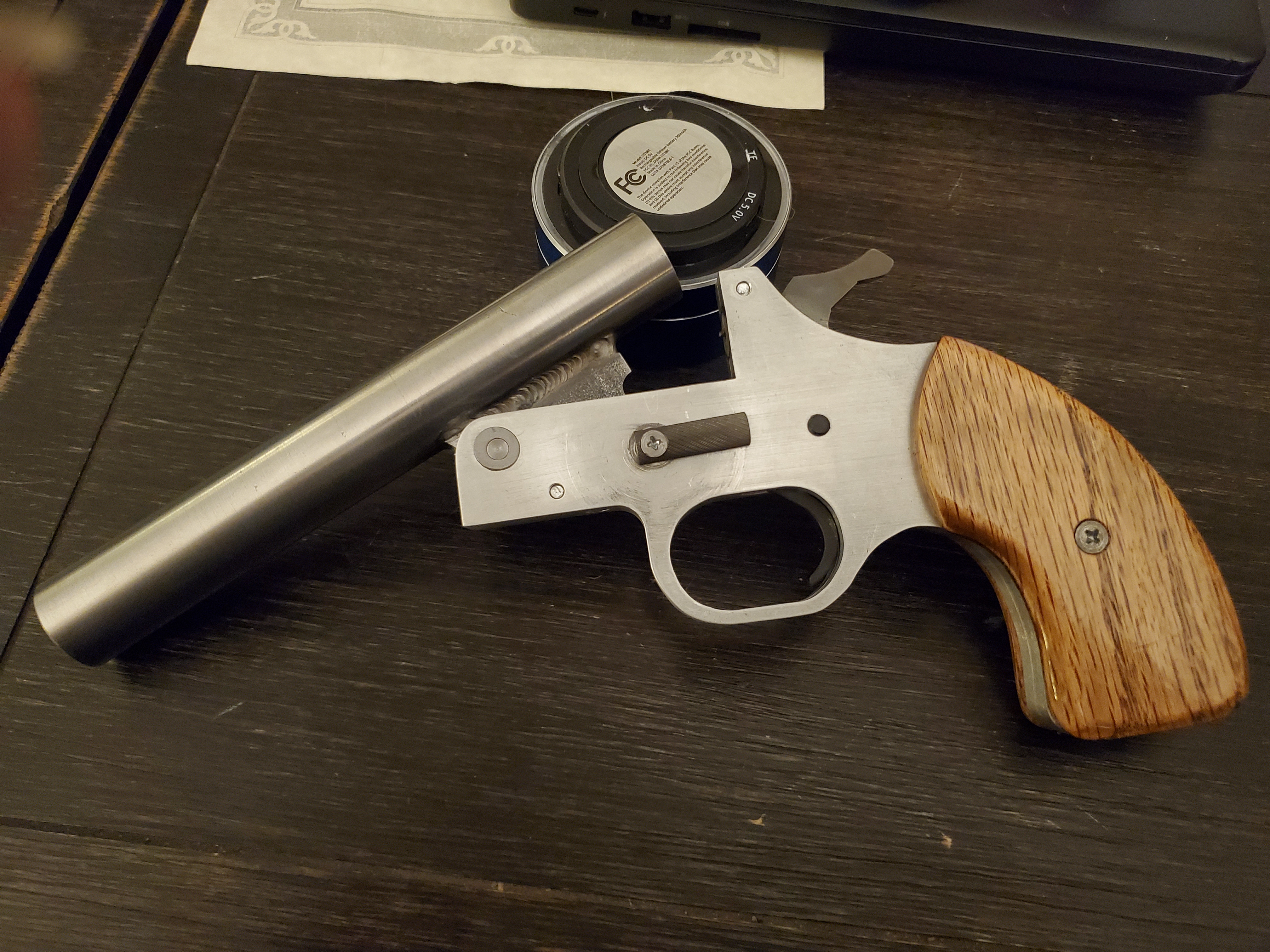

That is the abortion that happens when a non artistic individual sits down with a pencil and paper and tries to put in writing what is in their head. It works but it's fugly. Now I just build from my minds eye.

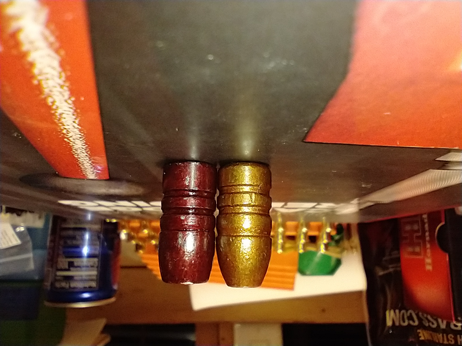

In keeping with the spirit of the .310 Cadet cartridge I'm debating some cast lead loads for this rifle. Digging through my boxes of cast I found two 180gr powder coated options. Both are supposed to be .358". They are shaped slightly different, but essentially the same. I asked my wife which one she though I should use and her response was to use both. I'm not looking to push maximum velocities with this rifle. I have the 77/357 for that if I want. I know the .310 didn't run this heavy of a bullet, but the majority of the cast bullets I have in the .35 range are .356" for use in 9mm.
MBC Striker RNFP and Pugnose WFN flat base bullets.
Re: .357 Cadet finally made it home
Posted: Thu Feb 08, 2024 2:52 am
Being a .358 groove diameter, you'll ideally want a .359-.360" bullet, but with the powder coating, you will likely be fine.
My Cadet came with the same rear sight yours has. It's a nice sightMaybe figure out the math on your sight radius and adjustments, and try to come up with load that sorta matches the arc. You will likely need to fiddle with front sight heights, but if you can get it to track true for a couple hundred yards, it'll be worth the effort.
If it's a plinker, the gold bullet will fly a little flatter and still has enough meplat for giggles on water bottles and cans. If a short range hunter, go for the blunt force.

Im banking on the PC helping to make it work as a .358". I have shot plenty of PC .458" through my little .458 without any issues (except one bullet that leaves a lead ring in my chamber, but thats another topic for another day) so Im thinking it will be okay.
My plan is to start low and work up to a load that plays nice with the sights. If I recall correctly the .310 was somewhere around a 115gr bullet at around 1500-1600fps. That doesnt really matter too much when you consider that the sight radius is completely different now though.
My eyeballs dont really let me shoot iron sights past 50 yards anymore. This is going to be a paper puncher for "cheap" fun times at the range. If I cant get it to perform appropriately with the 180gr I will look through my 125-158gr plated and jacketed options.
