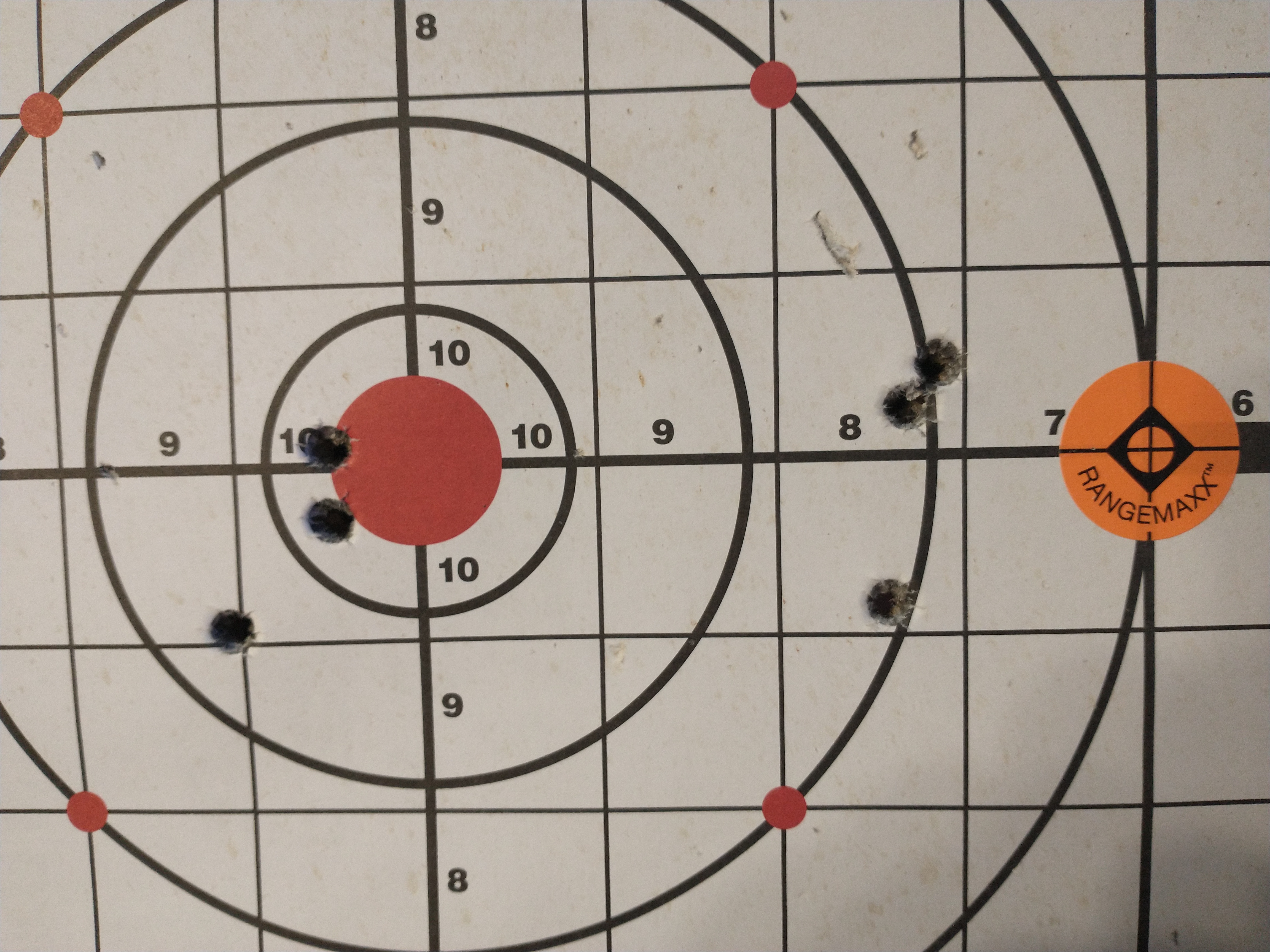

Tried a couple loads today with 129gr ABLR/RL-26 and 142gr ABLR/RL-22. I need to rerun the loading through Quick Load as actual velocity was higher than predicted velocity. I just want to be sure I'm good before pushing it further. So far it seems to want to group as I have two shots close together, but the third in the group is off 3/4-1" from the other two for three of the four loads I shot today.
Only fired two loads of each combination today. The 129 ABLR loads averaged 3204.9 and 3250.6 fps while the two 142 ABLR loads averaged 2988.3 and 3050.0 fps.
129/RL-26 3204.9 (left) and 3250.6 (right)
142/RL-22 3050.0 (left) and 2988.3 (right)

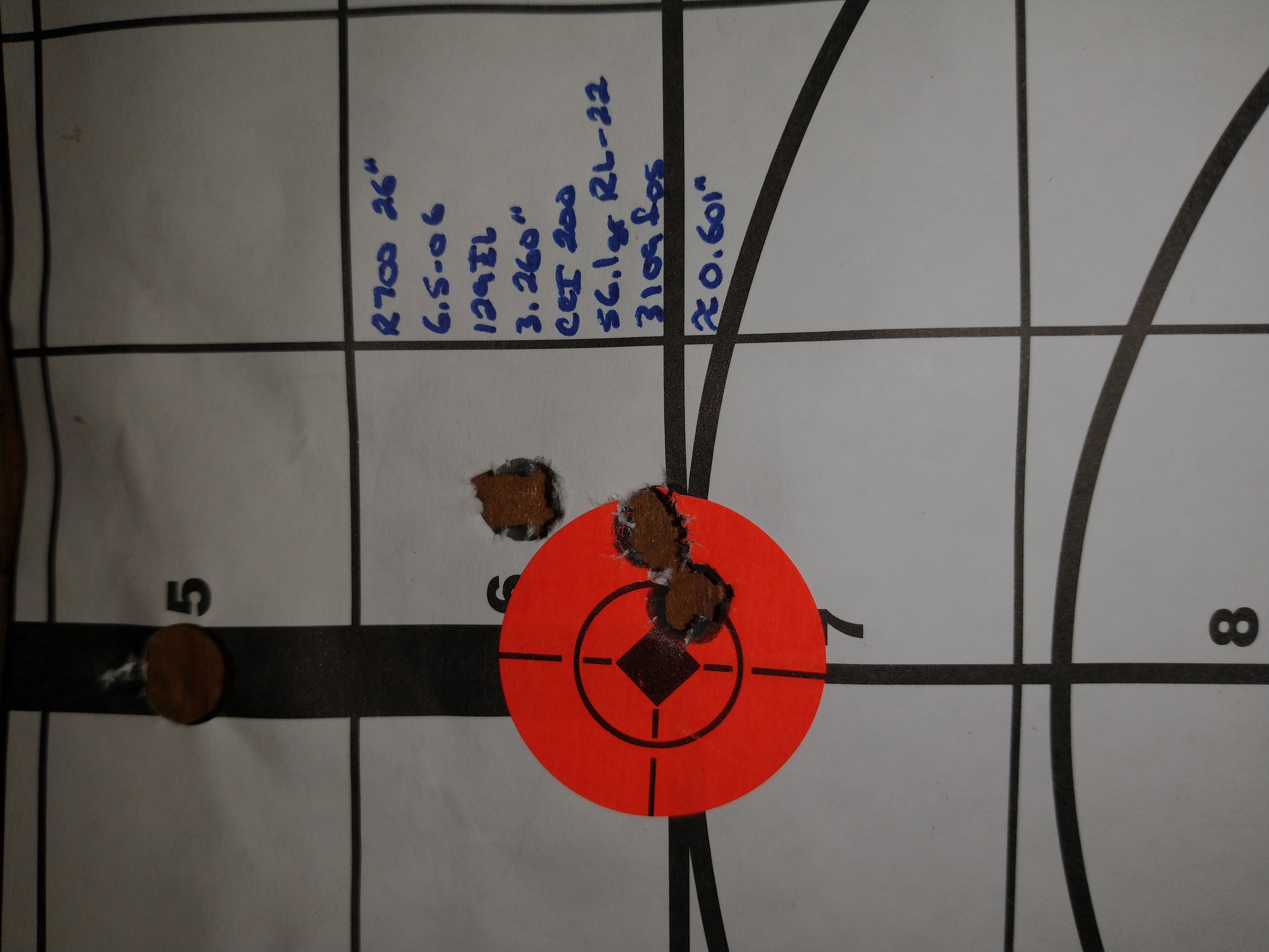

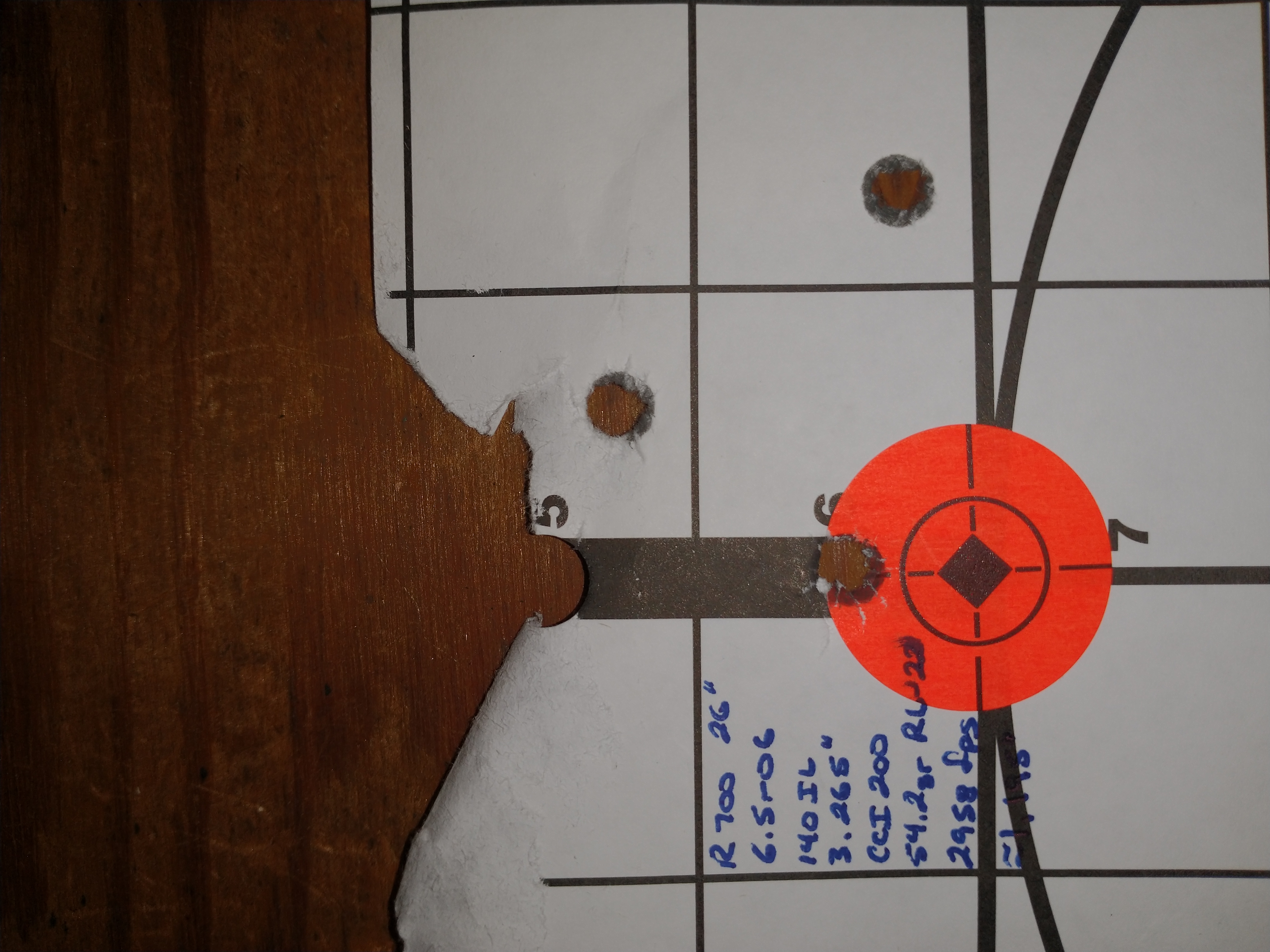

Switched gears on the 129gr and 140gr bullet options. I decided to test out the 129gr InterLock and 140gr InterLock bullets with RL-22 using new Sig .270 brass reworked to 6.5-06.
Cold and mostly empty range day so it was a good time out even if it wasnt the best performance overall. Its amazing how temps in the upper 20's to lower 30's will keep so many away. Primers were getting flat and I was getting some cratering around the firing pin. I will say that I have gotten the cratering with very mild loads as well. 142gr ABLR at 2600 fps had the same cratering as the 142gr ABLR at 3000 fps. This may just be a product of the machining and QC of new Remington though.
I plan on retesting the following loads when it warms back up a little. I want to rule out me as much as I can.
129gr InterLock
140gr InterLock
Velocity is around my goal and things seem to be behaving so far.

Managed to sneak in a range trip with my dad this morning so he could test out a few more things with his .25-06 and .430x1.8. I decided to retest three loads each from the 129gr and 140gr loads from my last round of testing. No ejector marks on the brass but the primers are heavily suggesting to me that I should stop while im ahead.
129gr InterLock
140gr InterLock
