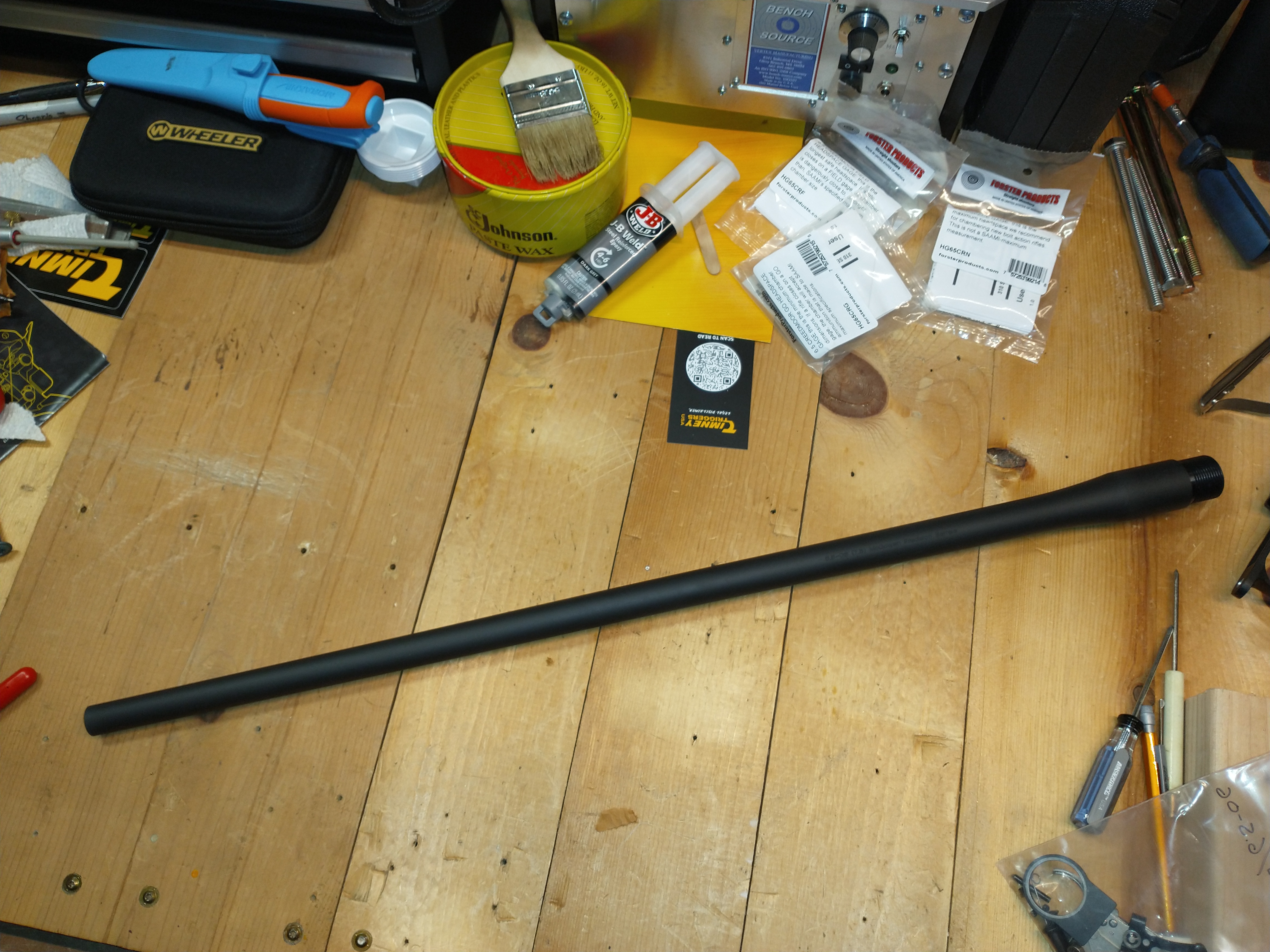

According to UPS tracking my prefit barrel will be arriving at my door on Wednesday. This is several months ahead of planned, but I am okay with that. Im my pursuit of odd ball stuff and wanting a somewhat hot rodded 6.5mm I decided to finally go through with a 6.5-06. I order a prefit from McGowen barrels and went with a 26" finished length, 1-7.5 twist, chromoly barrel with a #4 Douglas contour. This will be going on a donor R700 SPS that was purchased specifically to be a donor. I still need to look at getting a trigger for it as well as deciding if Im going to stick with a factory stock for now, or use a Bell and Carlson stock.

Well Mr. UPS man dropped off a package today.

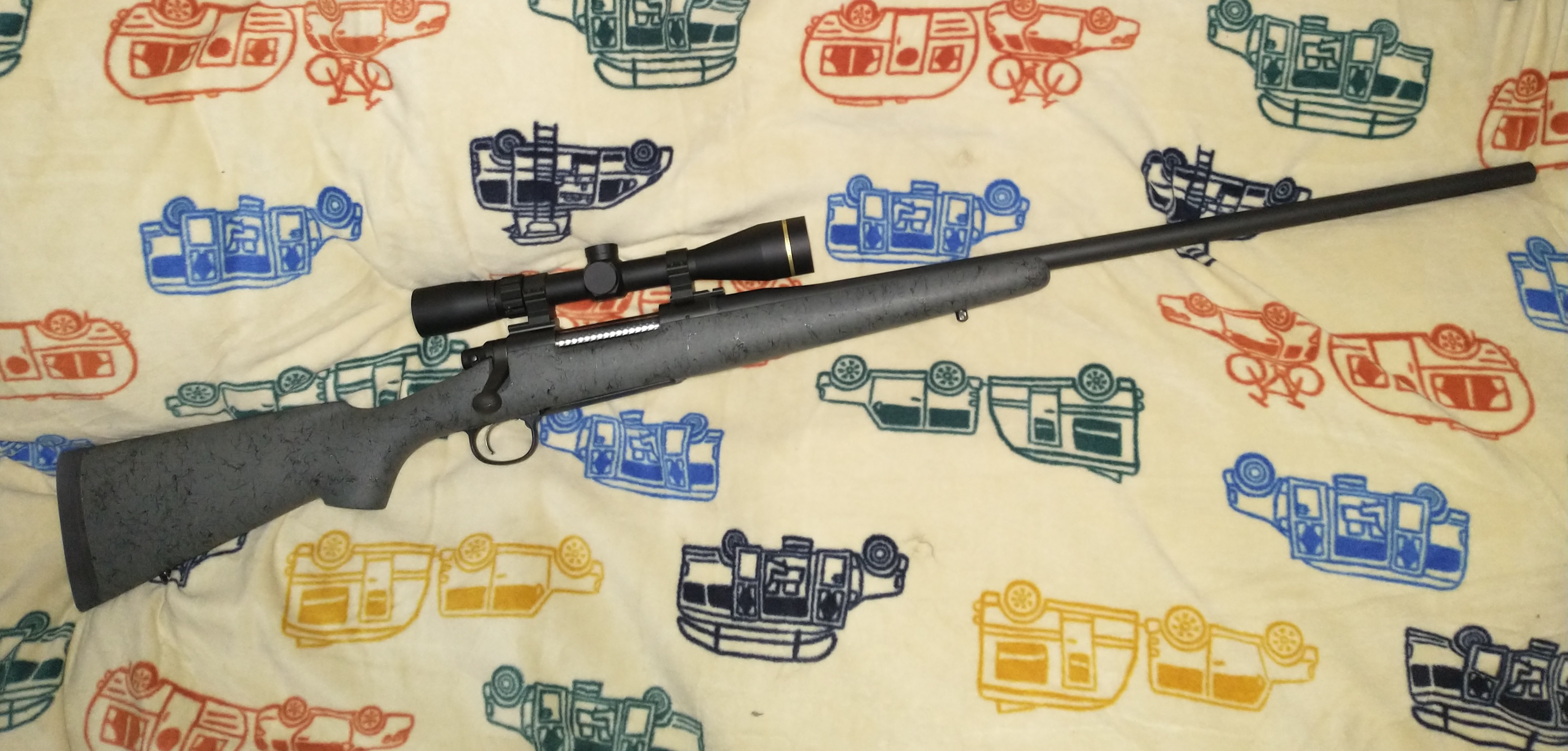

The barrel is on, stock barrel channel opened up some, and bedding compound is setting. I ended up using the Bell and Carlson stock since I didnt want to have to hog out the Remington stock to get the barrel to fit the channel. It does look a little goofy with a 26" barrel, but im okay with it. I need to decide if IM going to keep the factory trigger or replace it and then dig out some bases and rings. I have a 4-12x40 scope sitting on top a cabinet just waiting for a rifle to go on.

Quick update. Pulled the metal back out of the stock, did some quick clean up, put the metal back in the stock (with the factory trigger for now), and grabbed my "spare" set of Leupold bases and rings so I could get a scope on it. As it currently sits it comes sin at 9lb 4oz. A touch on the heavy side, but that is expected with the Bell and Carlson stock.

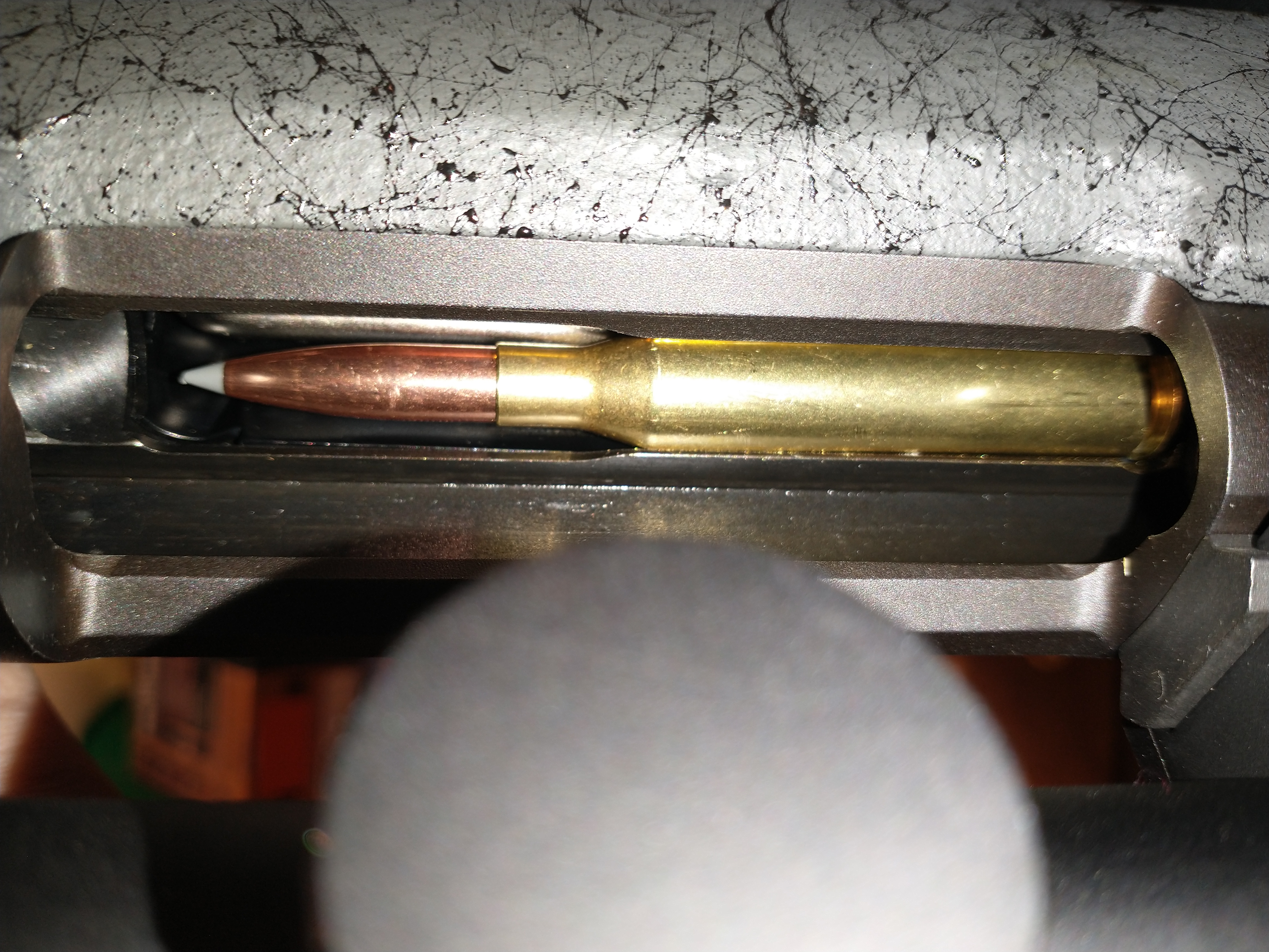

I put a couple dummy rounds together today to. I decided to try out the 100gr Partition and the 129gr ABLR. These dummy rounds were to sort 0.020" off the lands. Keep in mind that these lengths do not leave a whole lot of bearing surface in the neck as you will be able to see in the picture. The R700 has a really long magazine box length.

I may try loading up some at the max length to try, but I dont have high hopes. Then again one of my 6.5x55 rifles really like the 129gr IL with an overall length of 3.115 if I recall correctly. Thats only about 0.200" longer than book, but doesnt leave much left in the case. I like to try and have one caliber of bearing surface between the neck and bullet, but if it works fine with less and it performs better I will go with it. Maybe I might be able to seat the 142gr ABLR long and push it to book velocities for the 129 ABLR??

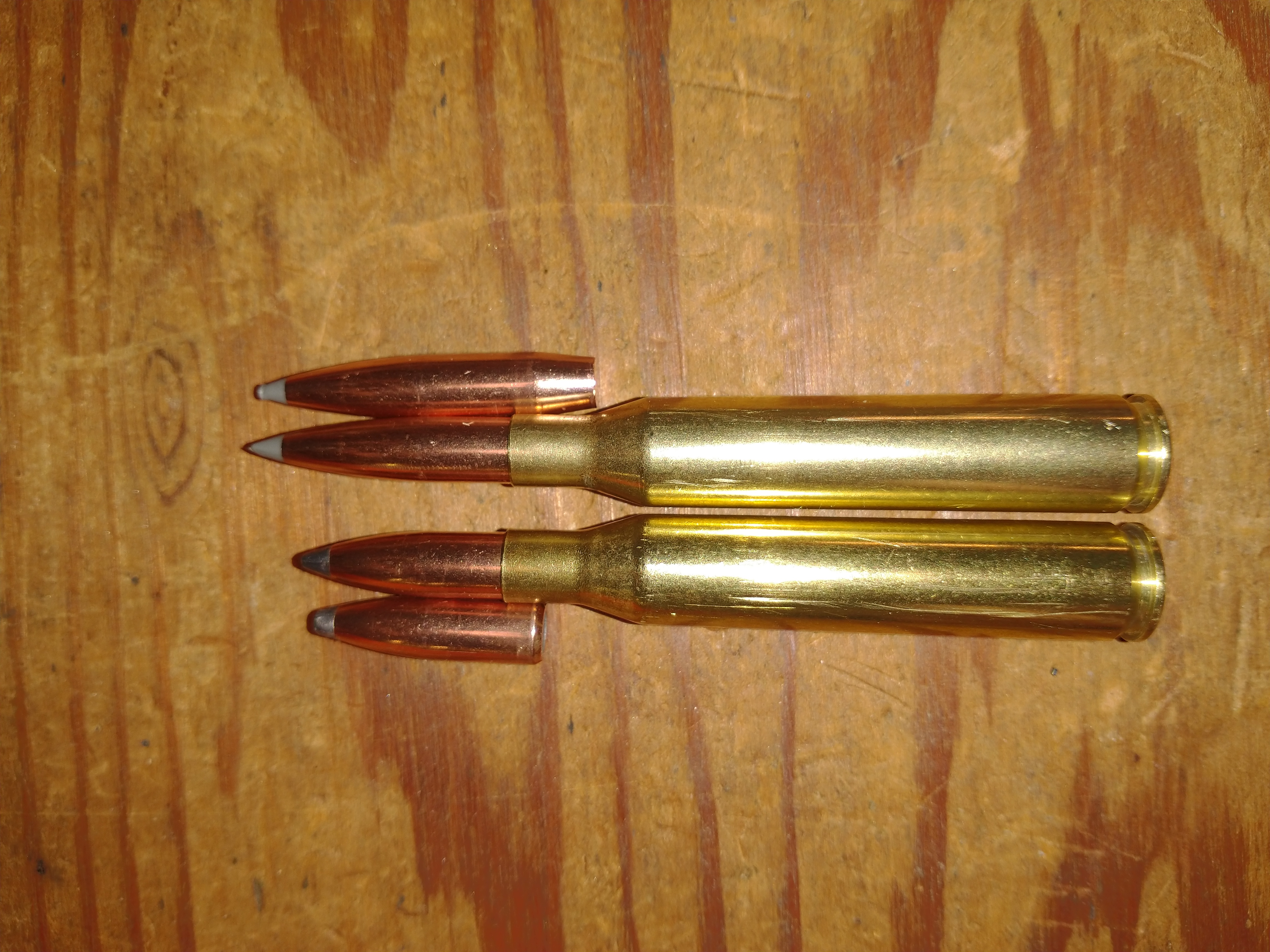

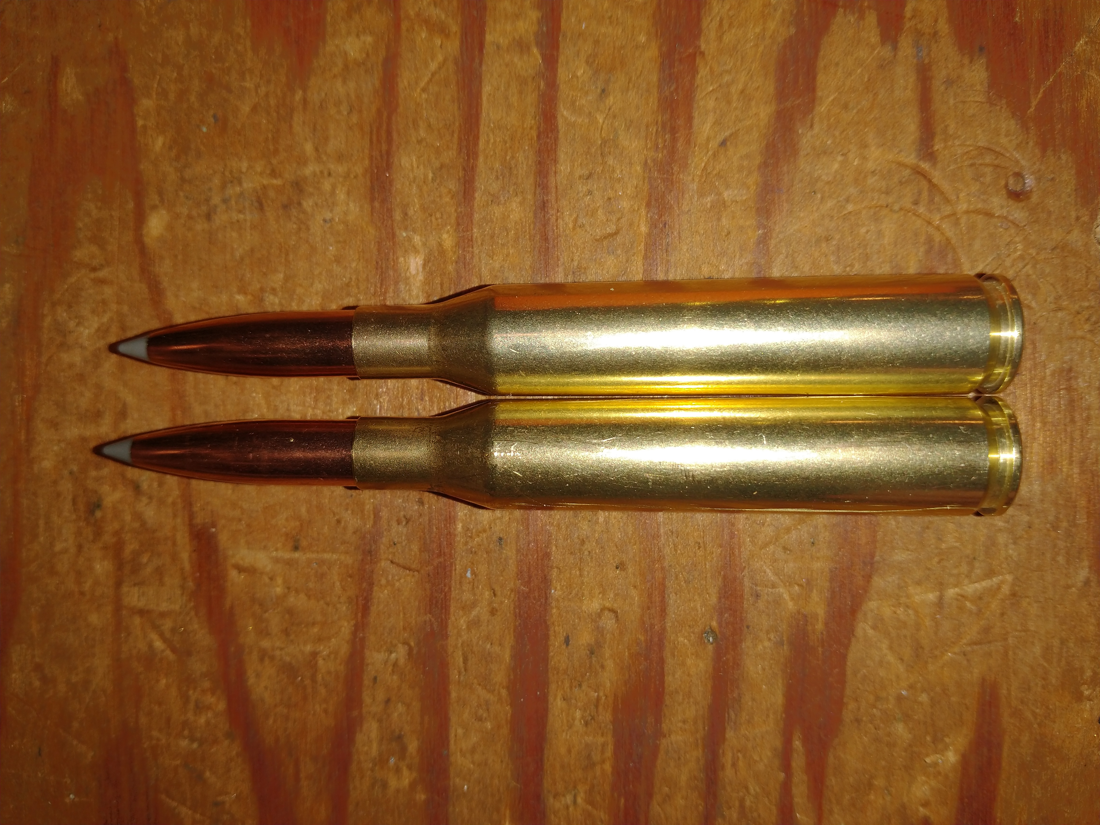

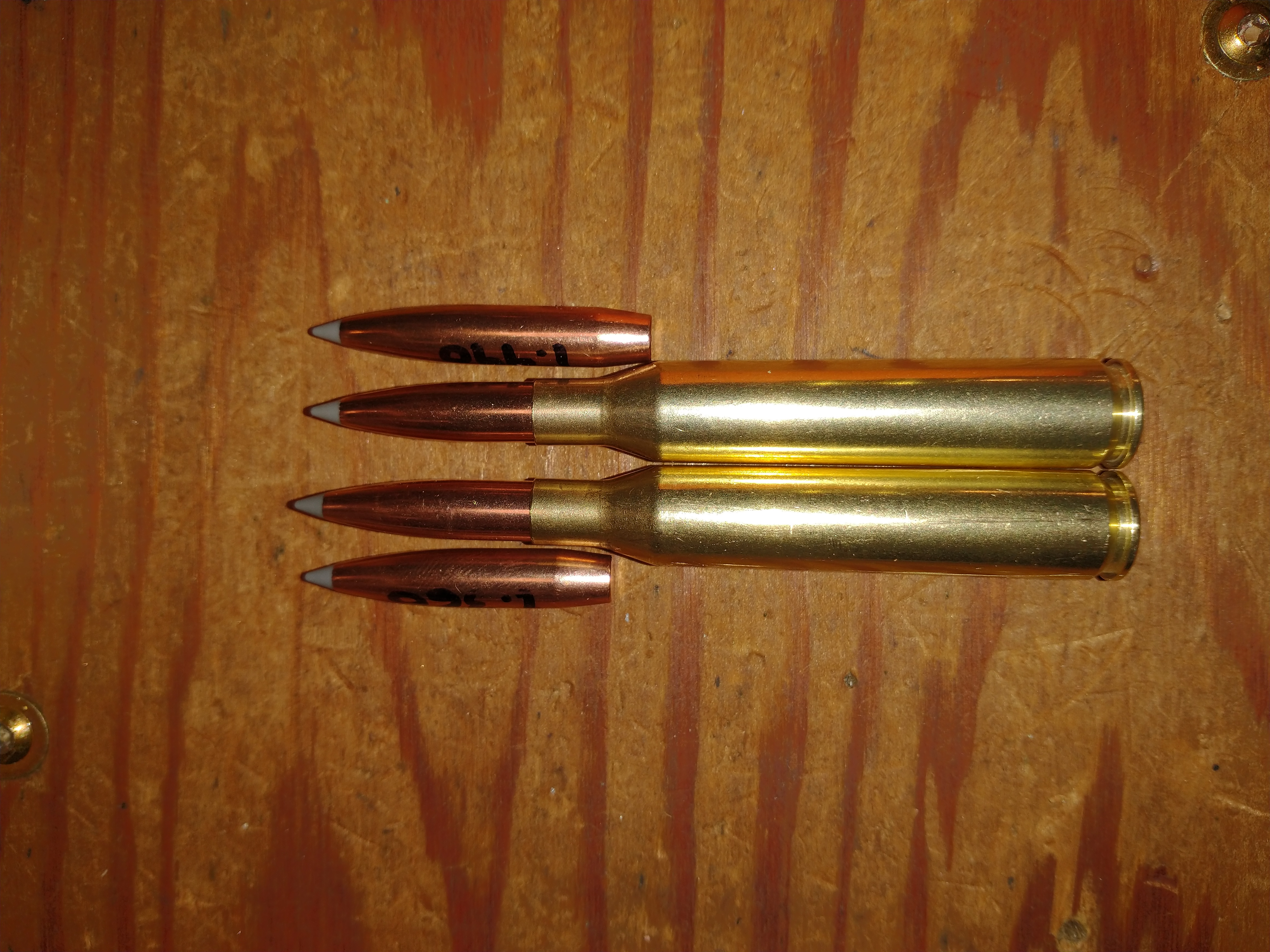

I decided to put together some loads with the 142gr and 150gr ABLR. I used the same load data for both since some of the other data I can find has very similar loadings between the two bullets in the same cartridge, and I'm seated to an OAL of 3.460 for the 142gr and 3.455 for the 150gr where the book OAL in 3.250. The same setting on the seating die resulted in a 0.005" difference in length. Since I have a decent supply of it I decided to go with IMR 4350 for these loads. The load density is well below optimum, but these are just test loads to get some baseline numbers and have cases to measure for actual case capacity. I am expecting great disappointment in the velocity department. Nosler has the max charge weight topping out at under 2900fps with the 142gr. There will be further experimenting with other powders that will hopefully produce higher velocities.
This is the 129gr at 0.020" off the lands and the 150gr at 3.455". With the 3.455" length I have almost one caliber of bearing surface between the bullet and case neck.
