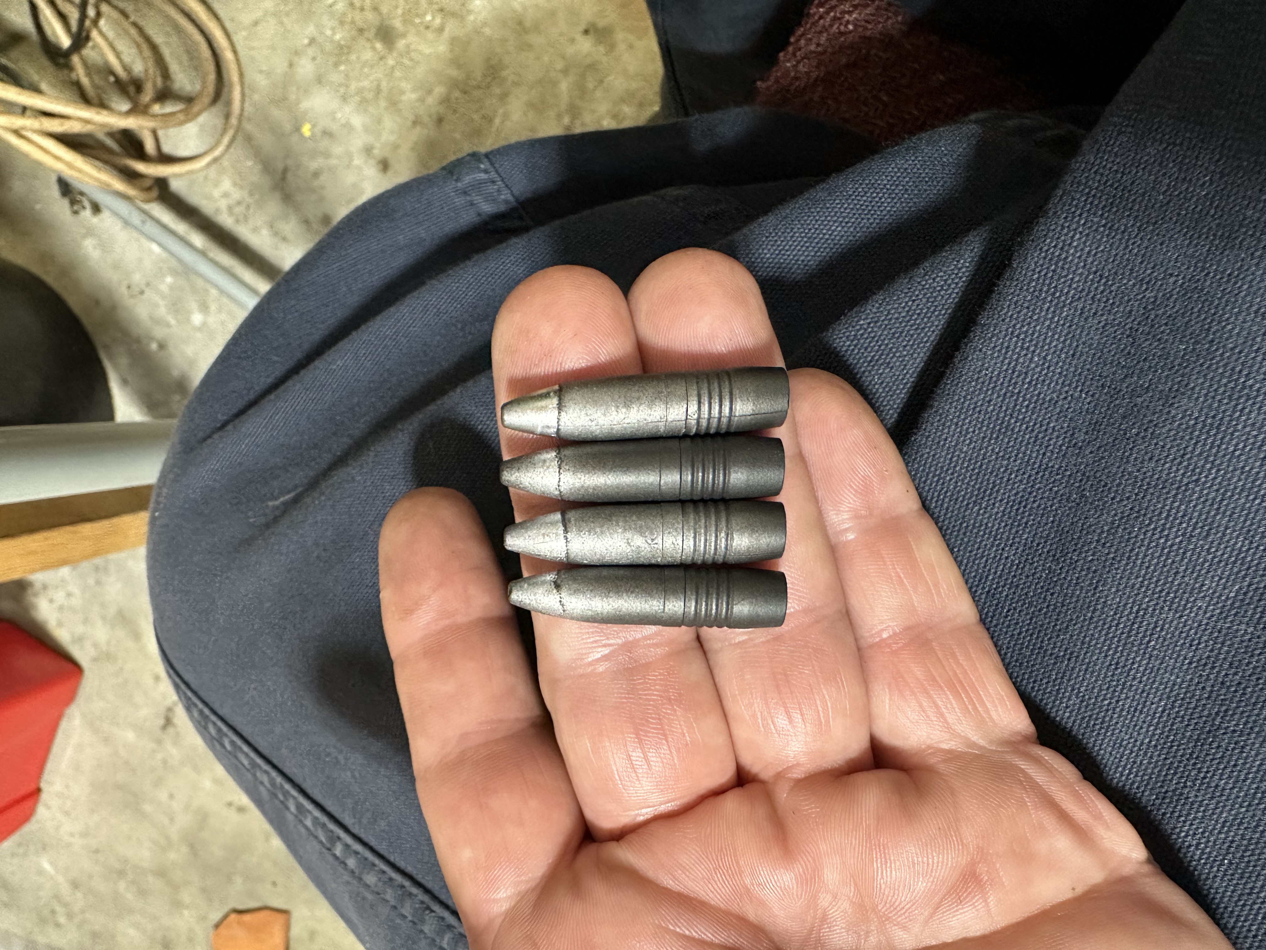

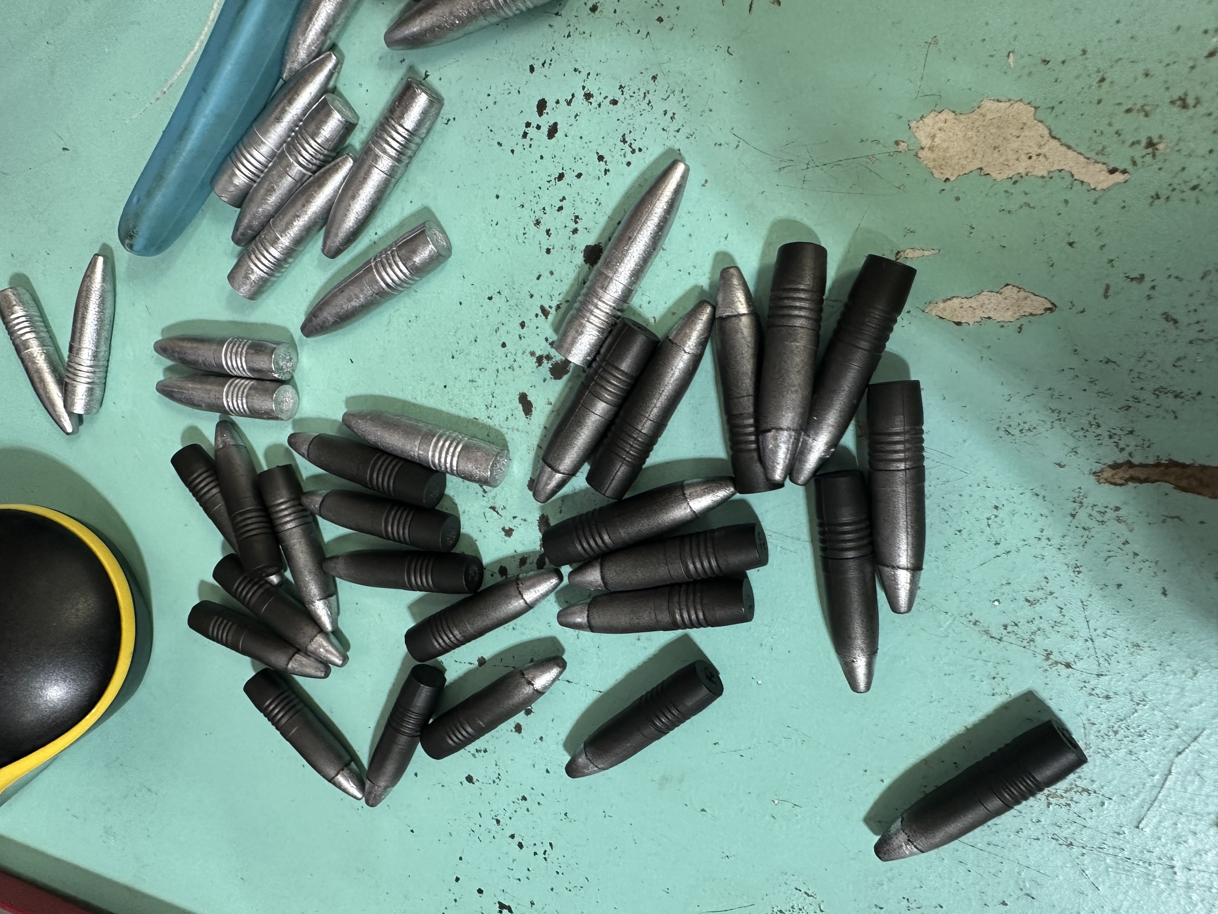

Set the temp to 725, ran the mold by feel. When the sprue plate didn’t need to be whacked with my dowel rod to cut the sprues, it was pretty decent. When it got too easy, I blasted it with compressed air and cooled it. Seemed to work.
Lead temp started within 30-ish degrees of the set point, which is miles better than just using the built in controls.
Posts: 3933
Re: Long boi bullet mold
Weighing a handful they came out at 231 grains plus. None under 231. A few tenths plus on a crappy little scale, meh. Perfection.

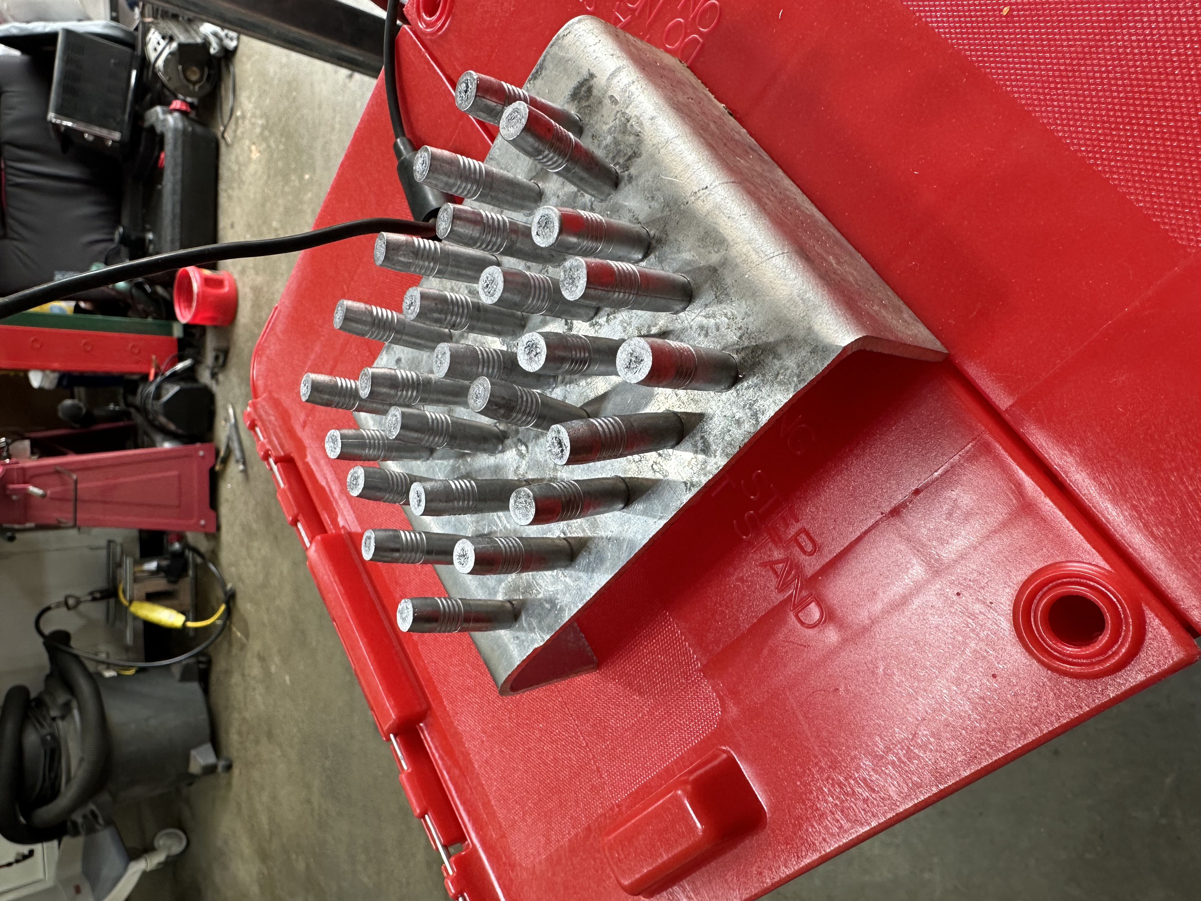

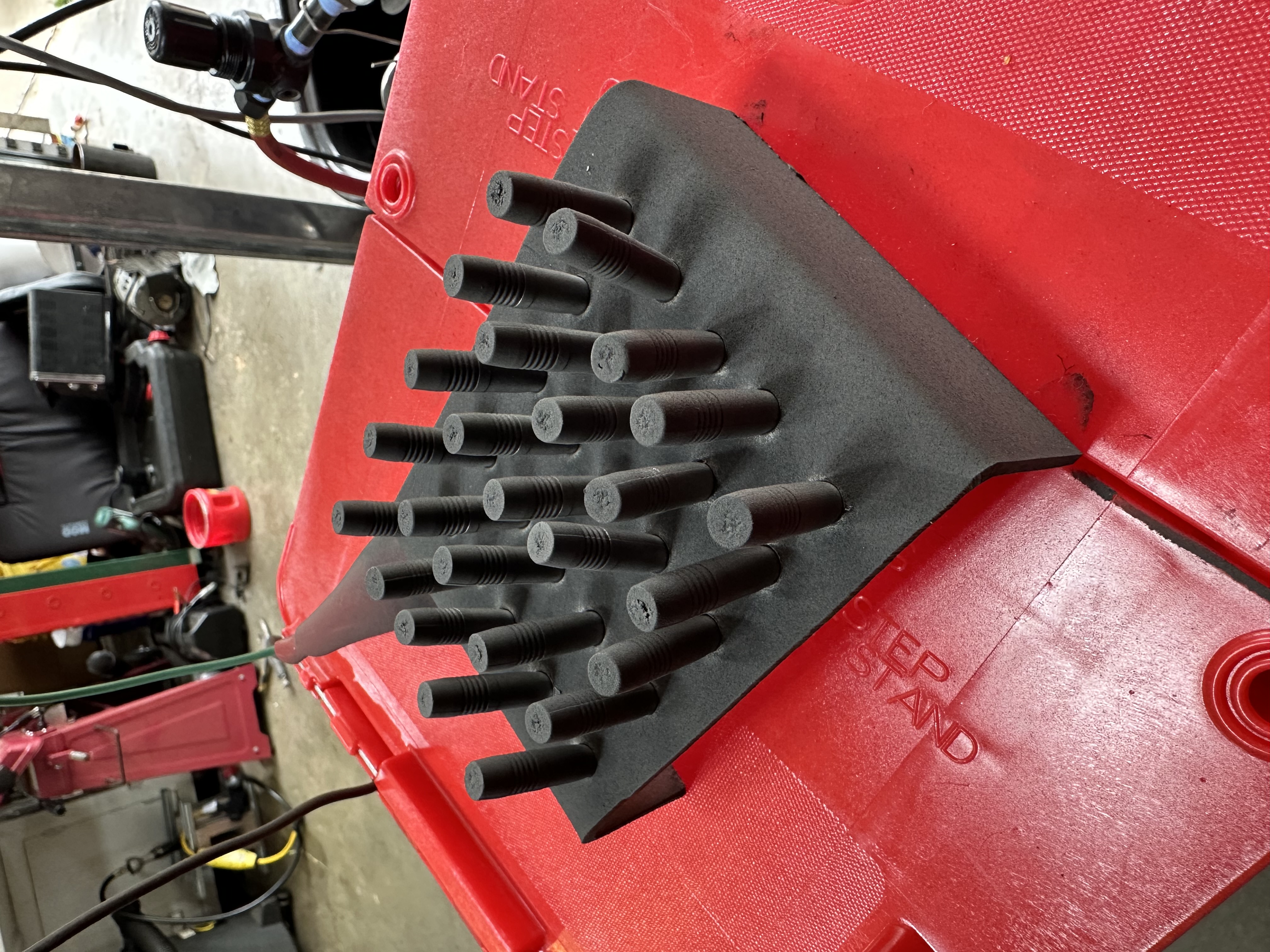

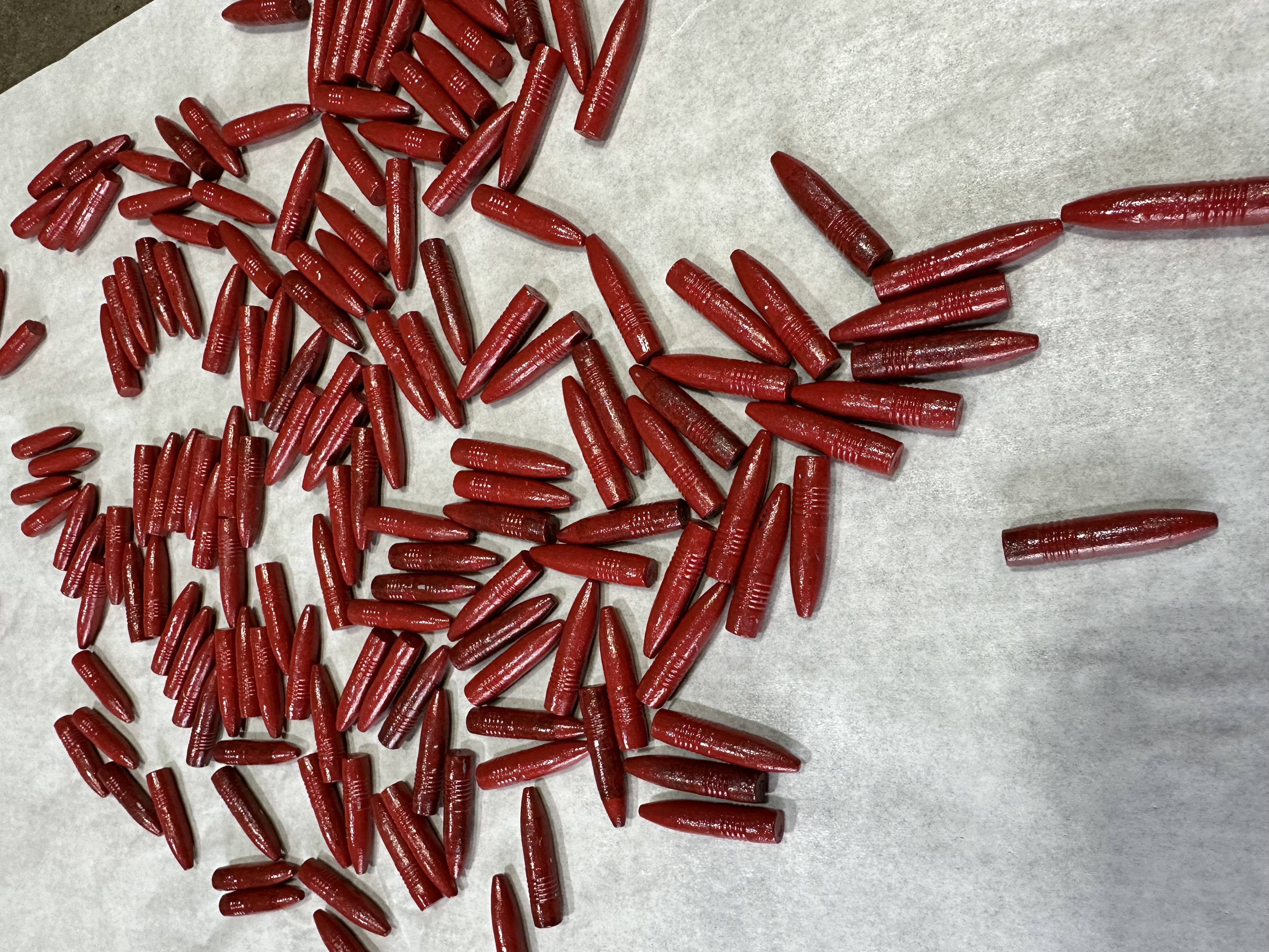

Just whipped this up to do the PC. Not needed, and may not work as good as the traditional way of coating: tossing them in a cool whip tub and shakey shakey.
But, I’ve got the PC set up, let’s try it. Science. It won’t get the tips (just the tips) as they are poking out the bottom. But the tips ain’t touch anything…

Fail. Powder coating suffers from the faraday effect, holes, inside corners, or bullets lined up side by each essentially repel or at least don’t attract the static charge as well as a flat piece or item without the aforementioned features. So the “inside” surface of the bullets didn’t get coated. I could do it by using less bullets per setup, but meh.
But, maybe not. I’ve got nothing better to do, may as well try.

Maybe line them up instead of a 5 by 5 matrix.
Posts: 3933
jwv2023 wrote: Sun Apr 28, 2024 8:15 pm Maybe line them up instead of a 5 by 5 matrix.
Went every other one. Still doesn’t play nice.
Posts: 3933

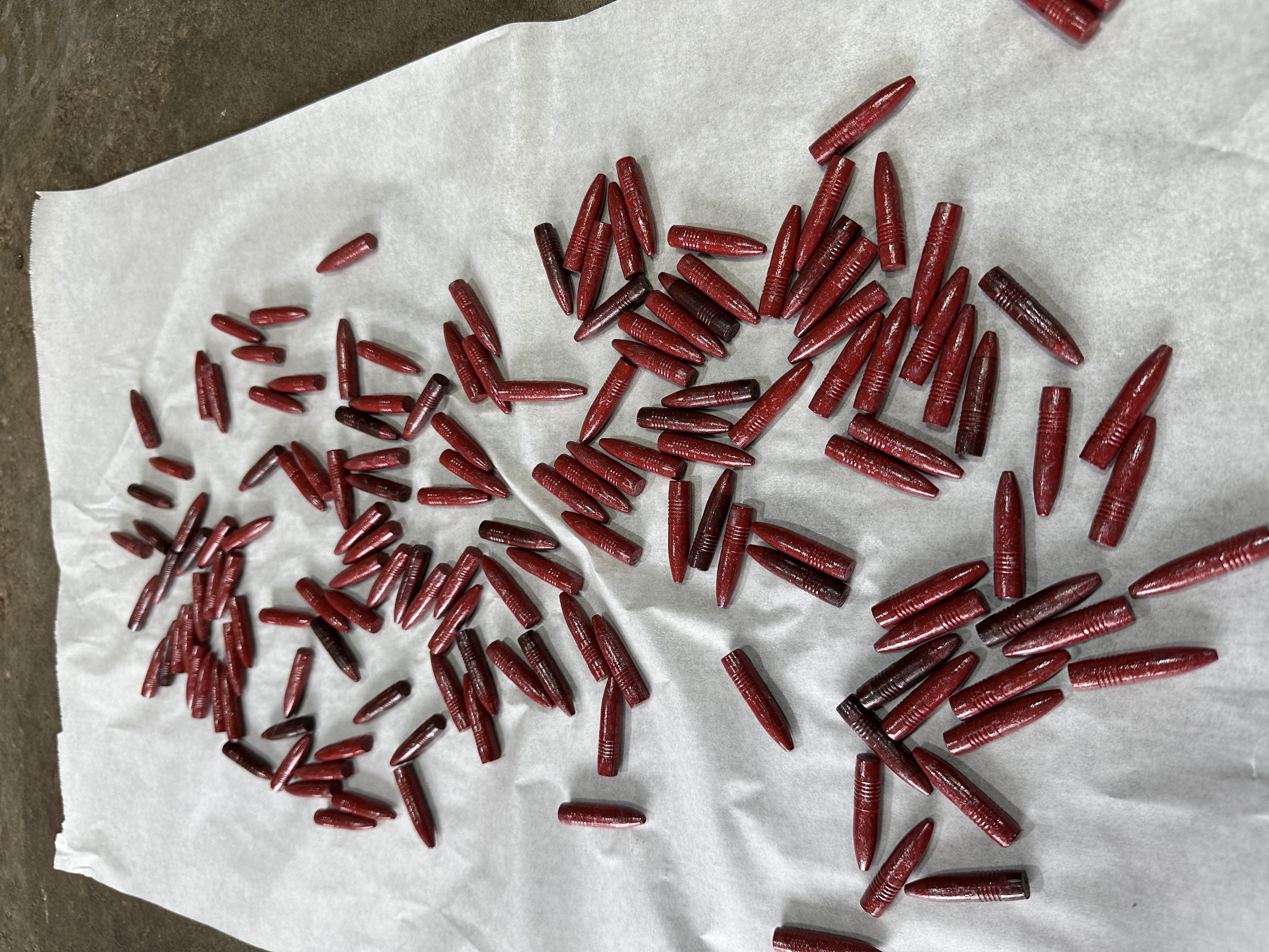

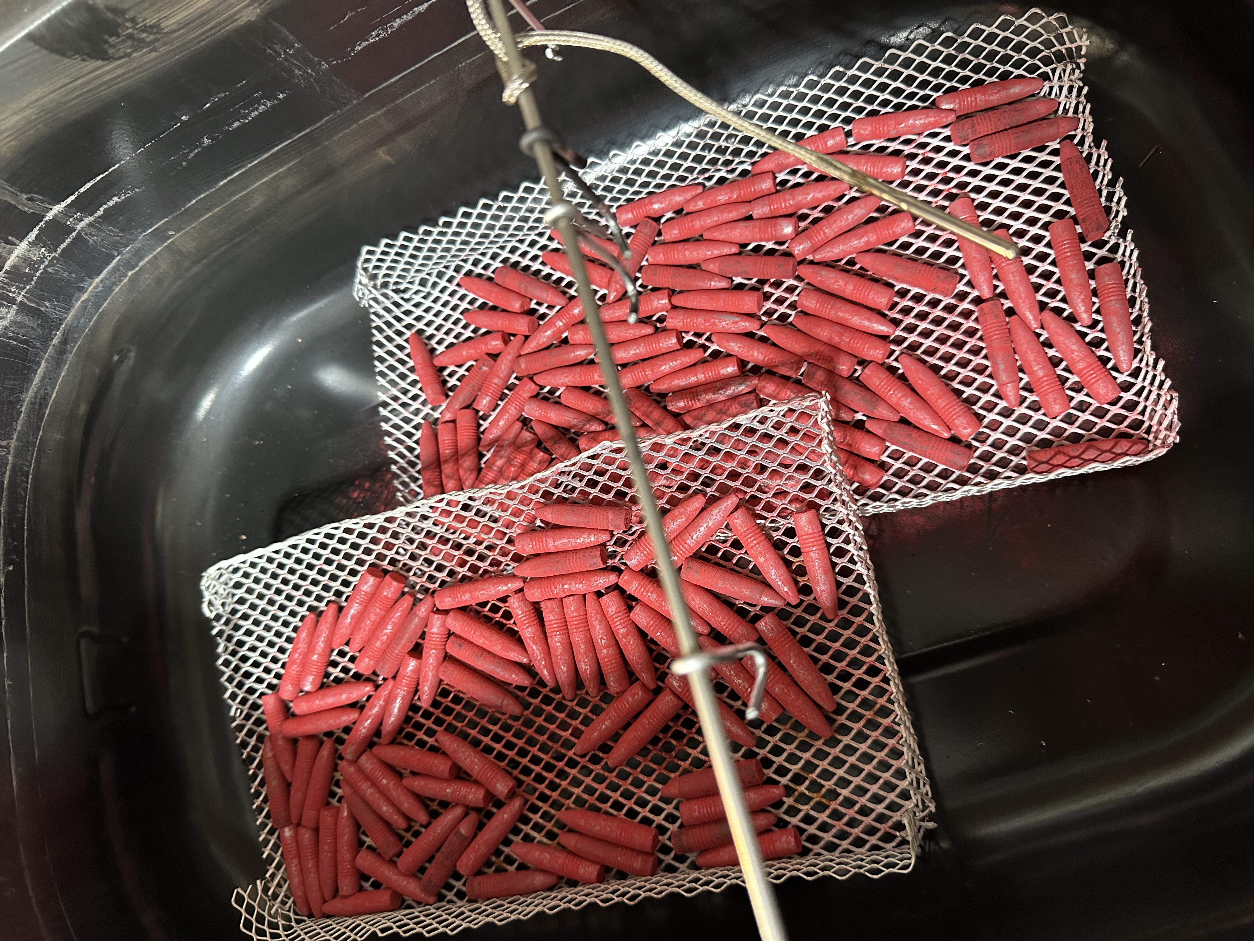

Shake and bake is the way.
I put two coats on them, making sure I don’t poop up my can.
Posts: 3933
The method I used. It really doesn’t need to be any more complicated than this. But people make it such.

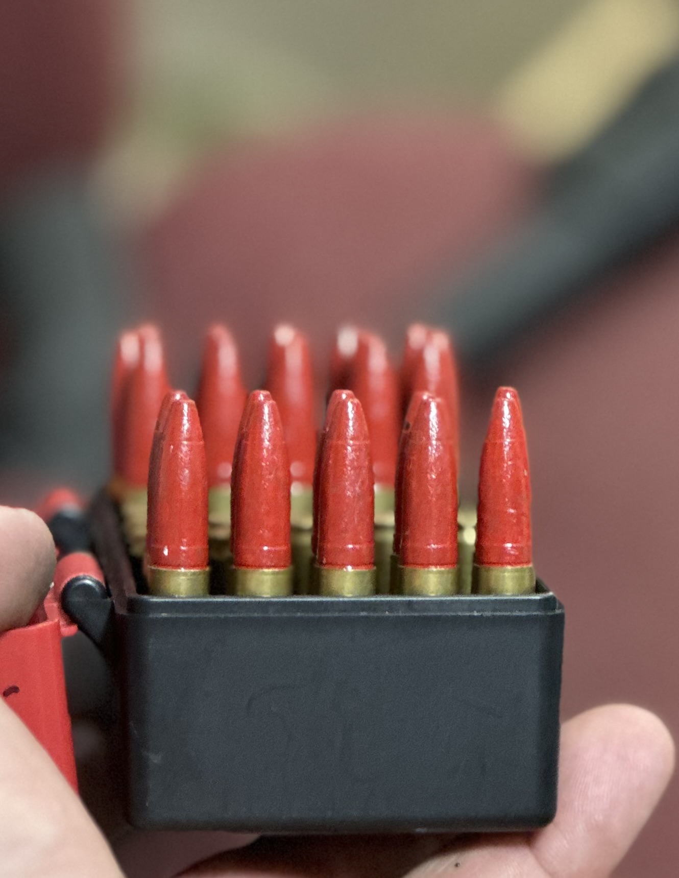

4.5 grains of trail boss, and 9 grains of hatche-one hundred ten.
We shall see.
