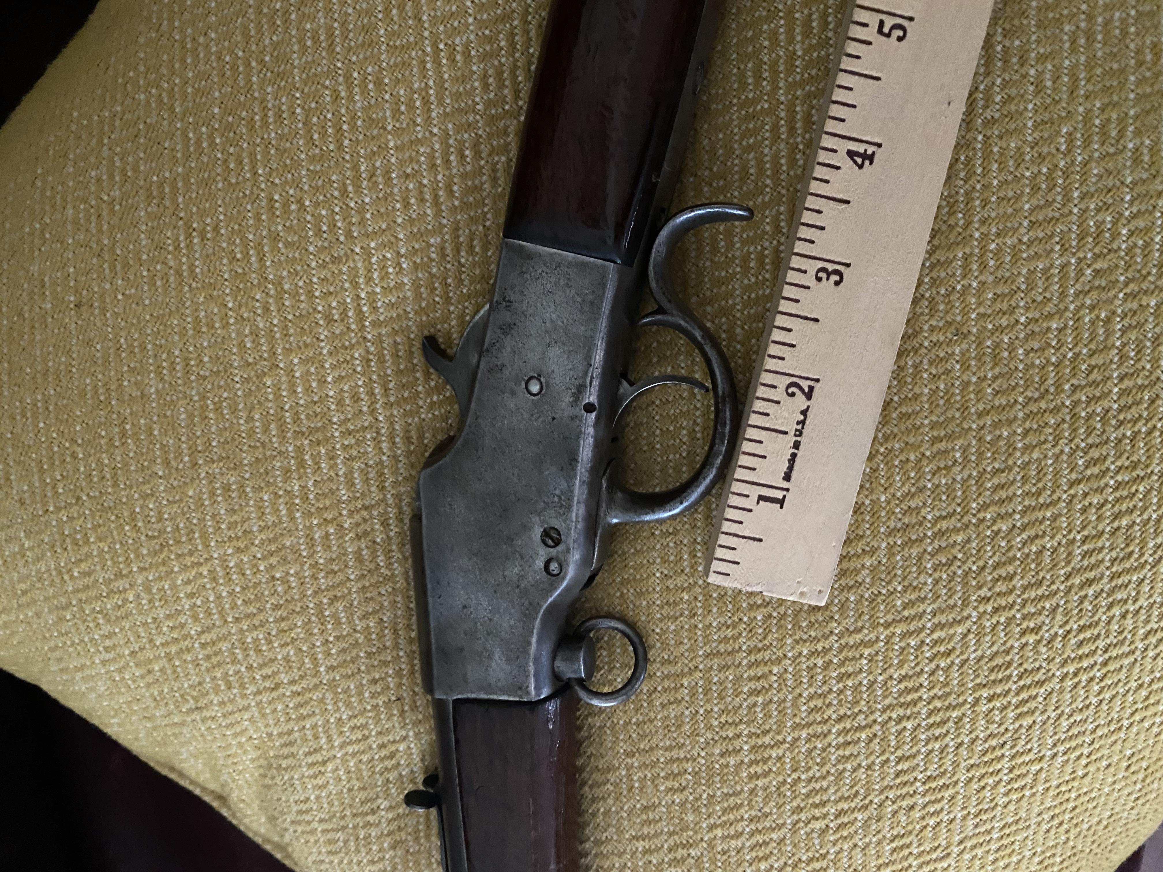

Posted: Wed Jul 02, 2025 10:13 pm
This is the lever on my Hopkins & Allen Junior 922.

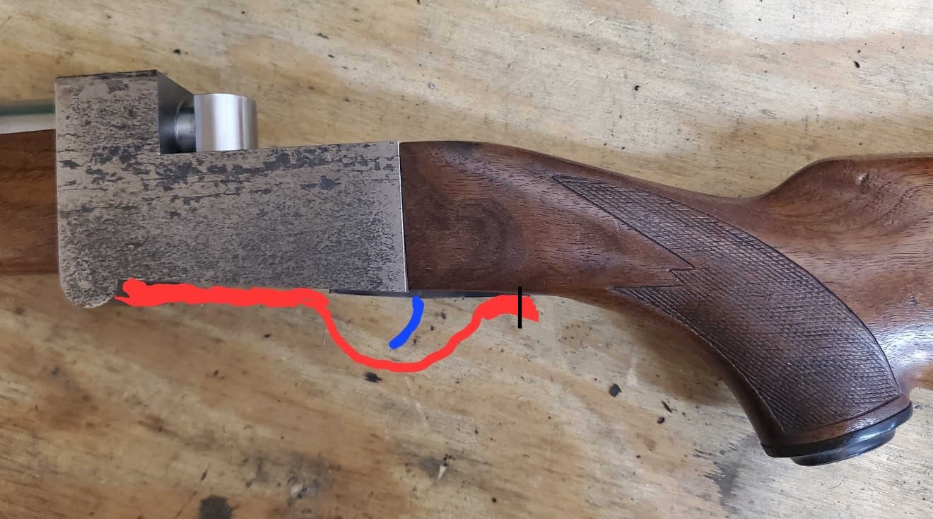

Re: Pinfire rifle.
Posted: Wed Jul 02, 2025 10:16 pm
That's what I was going for in my last sketch. I think that would look good with my style stock.

Re: Pinfire rifle.
Posted: Wed Jul 02, 2025 10:56 pm
Looking better, but I'd do away with the bent down "tail" at the end
Re: Pinfire rifle.
Posted: Thu Jul 03, 2025 2:48 am
I just thought it would give a positive purchase to get it past the detent.
Re: Pinfire rifle.
Posted: Thu Jul 03, 2025 3:49 am
Justsomedude wrote: ↑Thu Jul 03, 2025 2:48 am I just thought it would give a positive purchase to get it past the detent.
You're doing the designing and building, so feel free to do as you wish.
You asked for ideas/input, so I figured I'd put mine out there. It's worth everything you paid me for it ;)
Making the trigger guard large enough to hook your thumb in it would serve the same purpose, I'd think though.

Re: Pinfire rifle.
Posted: Thu Jul 03, 2025 11:58 am
Experiment with a slightly longer, more “gentle” curve.

Re: Pinfire rifle.
Posted: Thu Jul 03, 2025 1:44 pm
On the last picture, recoil will drive your hand into the lever and pop it open. Also looks like a knuckle rapper to me. I think your original direction was correct or go with the 922 design to allow your grip hand to help lock down the lever.

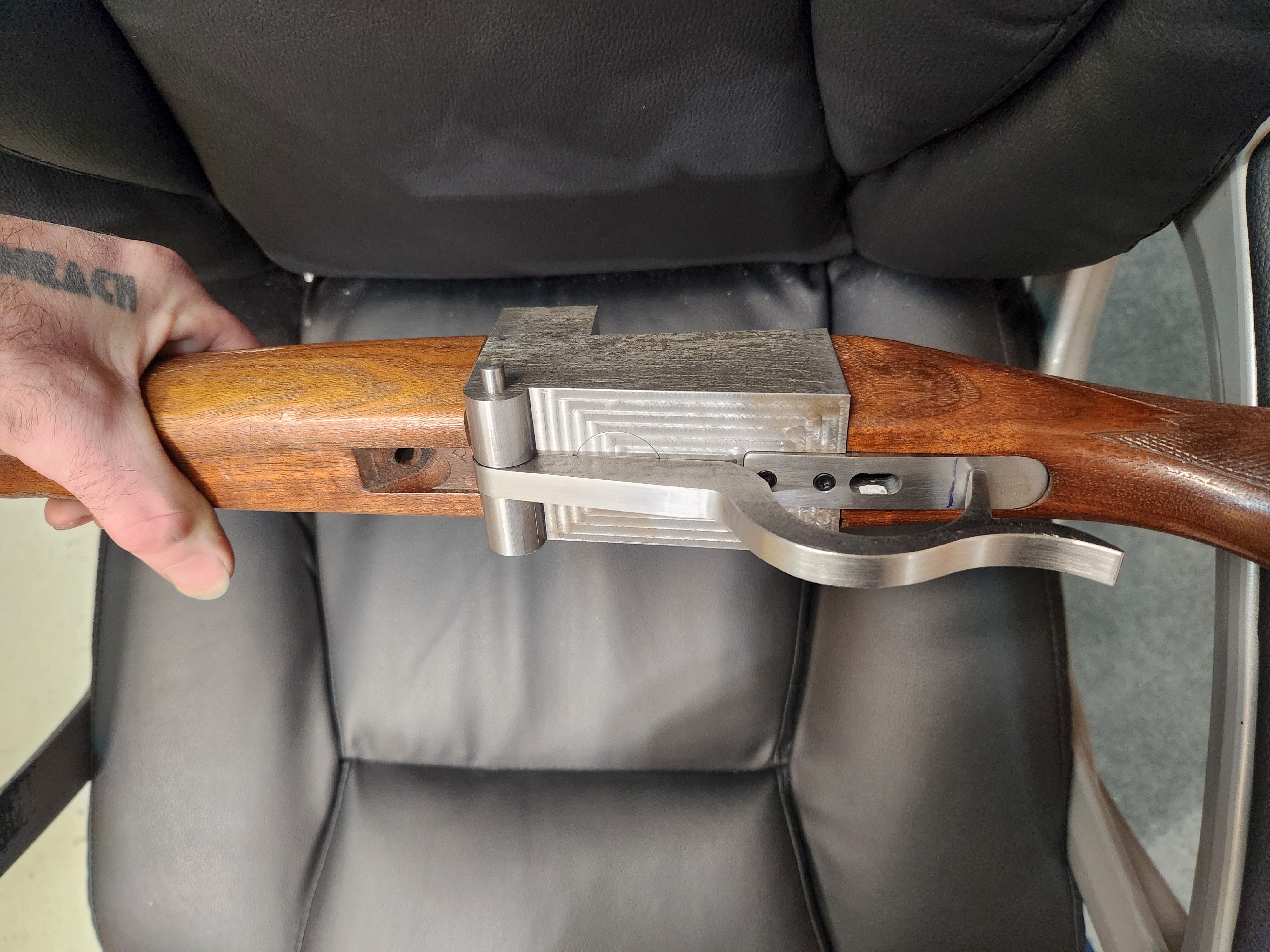

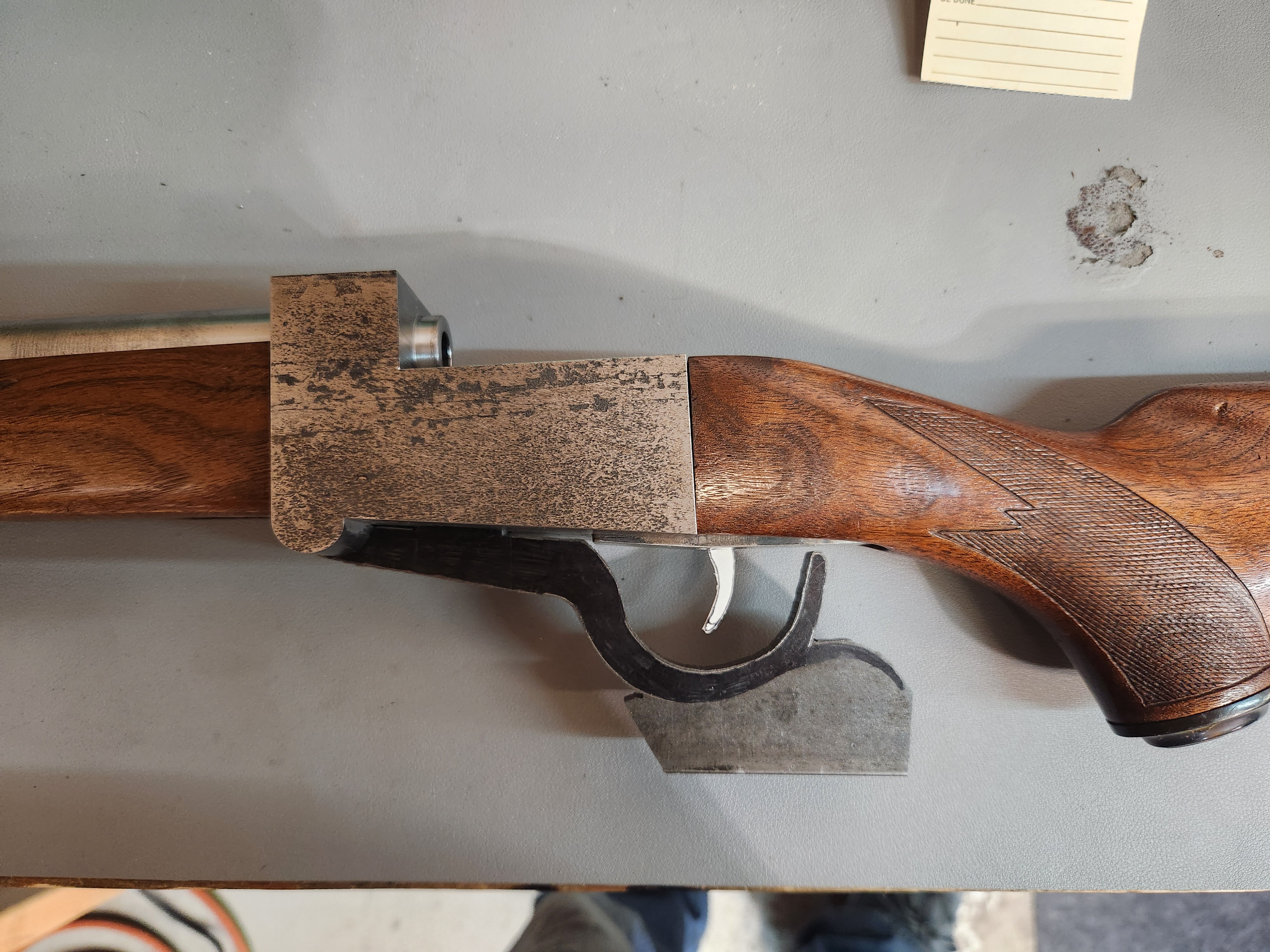

Posted: Sat Nov 08, 2025 10:30 pm
I finally gathered enough time to pick this project back up. The lever is 4140 that's 3/8" thick. I rough cut it but my bandsaw blade had to snap and leave me with the chunk that you can see in the picture, and I'm out of replacements. It'll obviously get filed and contoured nicely, but I'm pretty happy with the overall shape of it and it clears my fingers very well, even the tail of it. The rest of the build should go pretty quickly from here.
Re: Pinfire rifle.
Posted: Sun Nov 09, 2025 12:12 am
That looks great!!!
Re: Pinfire rifle.
Posted: Sun Nov 09, 2025 7:47 am
Elk Creek wrote: ↑Sun Nov 09, 2025 12:12 am That looks great!!!
Thank you. It'll look much better once I file to my scribe lines and do the contouring as well. It's grossly oversized right now.
