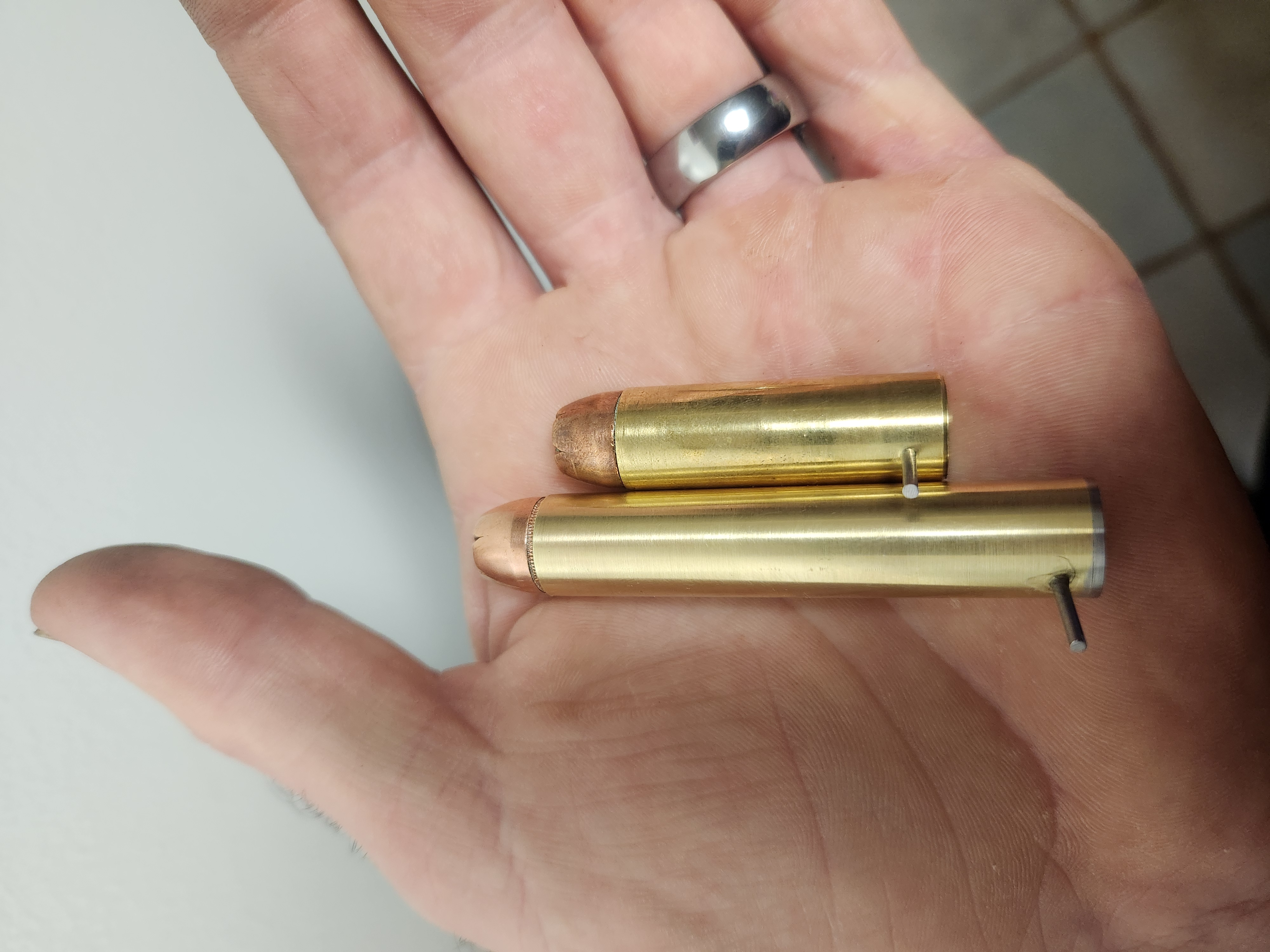

That's pretty much how I make them also, with the exception of making plugs and soldering them in the primer pockets before I face the back of the brass in the lathe. Apparently alot of people have the misconception that pinfire cartridges are/were low powered but they were really no different than any of the other black powder cartridges that came later. And I can't remember the exact number, but if I recall I was getting 32acp velocities out of the 7mm revolver I converted to 32 pinfire.

Ended up holding 120 grains of powder and this thing is a hoss. The first one took a bit of time to make and I didn't have any brass to solder as end caps so I just used steel. I'm sure I could make the rest pretty quickly but this really is overkill.

So how does one resize a straight wall case without a rim? Is it like a lee single cartridge setup, tap in and use a rod to remove from the die?
Re: Pinfire rifle.
Posted: Thu Nov 20, 2025 12:52 am
I have not made it that far yet. I lathe turned this one but I assume I could use my press to push it into a die and then knock it out with a wooden dowel. It's my understanding that most BP cartridges don't expand alot in chambers, but who knows if that's true or not. I'm guessing it'll be easier to just neck size it.

Sticky extraction could prove tough without a rim. I’d full length size so they just slide out…..

Justsomedude wrote: ↑Thu Nov 20, 2025 12:52 am I have not made it that far yet. I lathe turned this one but I assume I could use my press to push it into a die and then knock it out with a wooden dowel. It's my understanding that most BP cartridges don't expand alot in chambers, but who knows if that's true or not. I'm guessing it'll be easier to just neck size it.
BP cartridges that do not expand in chamber are tough to extract because cases will not seal the chamber and fouling makes a mess and makes for sticky extraction. My son in law is having an issue with his 50-90 Sharps extracting cases that have massive amounts of fouling on the outside even after just one firing. I read that all cases that are to be used with BP should be annealed to soften them so they expand and seal the chamber so science will be following shortly.
I didnt consider that scenario but it makes sense. The only thing I'm not happy with is the lack of ability to extract these cases but I can always just use a wooden dowel down the barrel if worse comes to worse. I have zero experience with black powder cartridges so this is all new territory for me.
