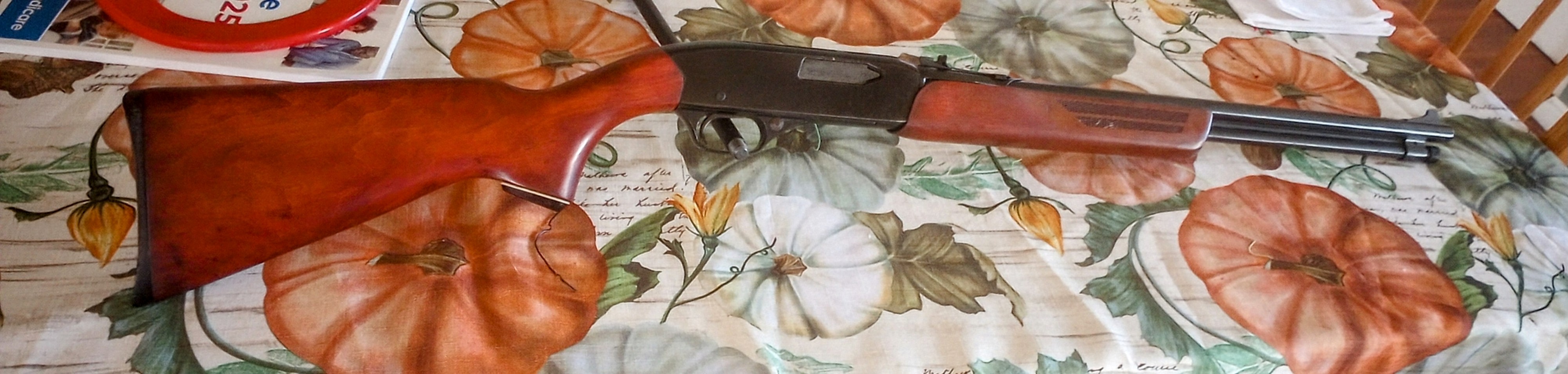

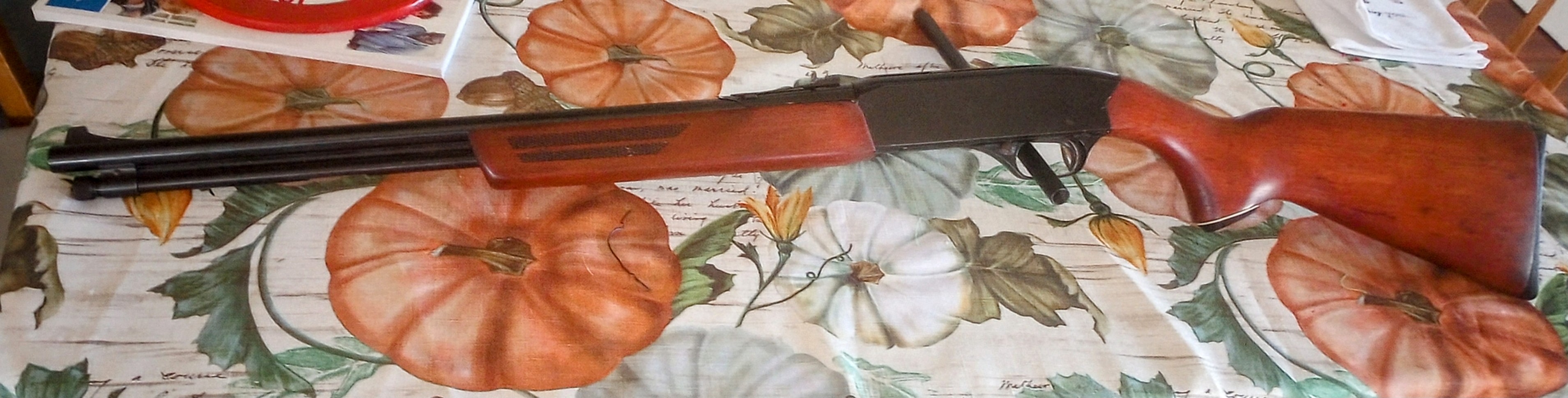

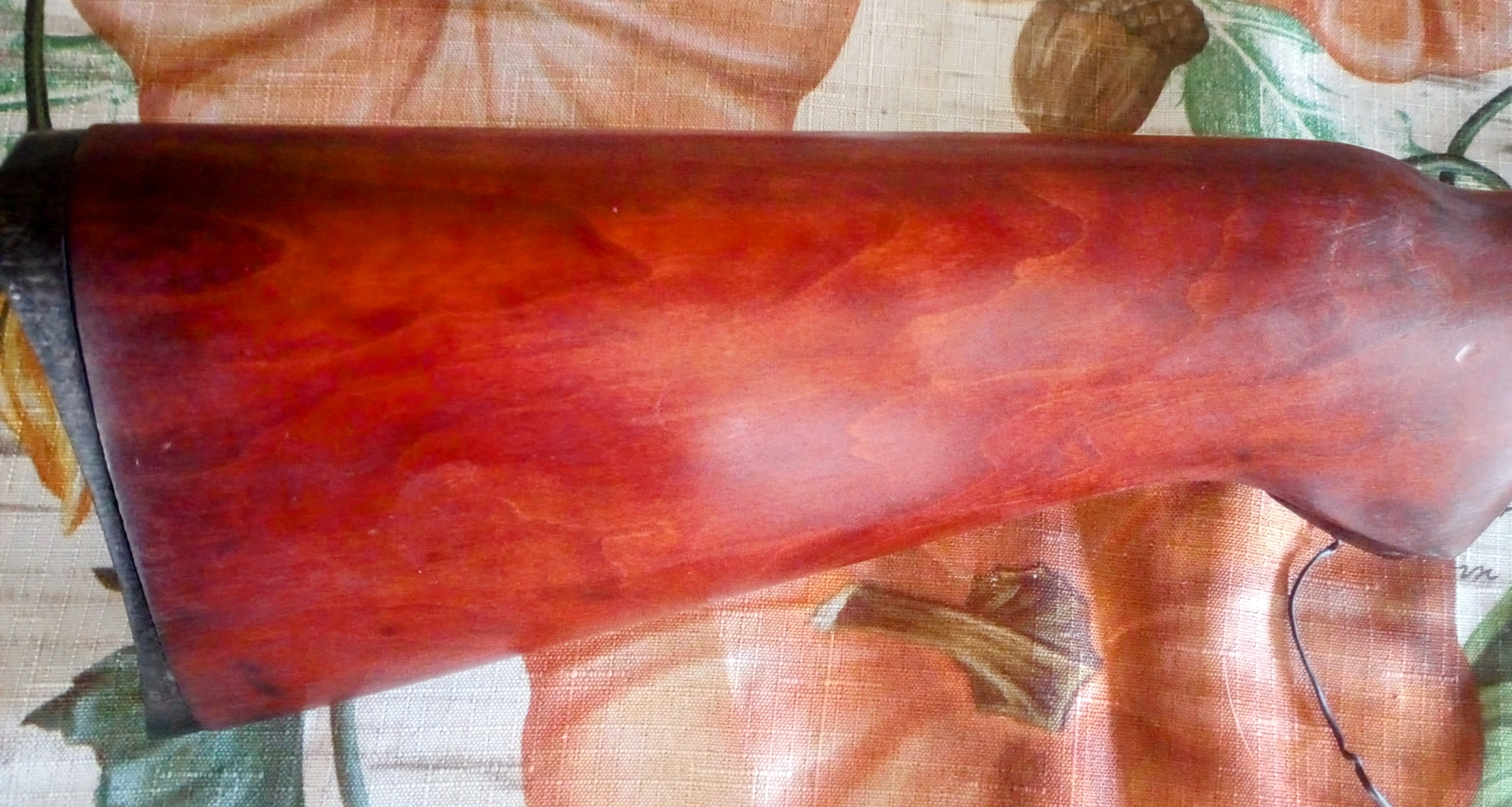

My nephew's wife found her fathers rifle in the corner of a damp basement. the metal had a red fuzz covering, The stock was black and the butt plate was caked with mildew. I wish I had taken before pictures. The metal cleaned well with only a little minor pitting. the butt plate took over an hour to clean. The wood came out better than I expected being hard wood not walnut. I didn't want to overwork this project, I want to make it look like what it is, a neat old rifle. I had never seen a slide action 22 mad before but here it is, Winchester 275. The product of the post 64 thinking, cheaper is better. A range report will be coming soon, maybe Monday. I used Minwax "gun stock" stain on the butt stock and it matched the forend perfectly. Six coats of tung oil and it has a nice low gloss finish like it originally had. I ordered the rear sight elevator from Numrich and was happy to see it is a perfect match. It is now what it should be, a neat old looking gun.

That looks amazing! BTW, for you or anyone else that needs this info this company NC Ordinance makes replacement vintage buttplates annd grips for old models of guns including some rather obscure models, and their molds were made from originals.
They are relatively inexpensive and virtually identical to factory. A great way to replace a cracked part with the equivalent of an OEM part. I’ve used their products and they are very good 👍🏻

Freezer that is good work! It’s great these older pieces are back in working order and will have many more years of life.

That is very cool. Good save.
Was the bore affected?

Nice save, that came out nice, hope it is a shooter.

The bore is pristine. The action was sticky from the old grease and dirt. It is very slick now and the trigger isn't bad. I feel confident in this rifle but like most of my projects, its not mine. I removed the ear sight to clean everything so I'll have to drift it back into place.

Nice save!! Looks great! I've cleaned up those moldy butt plates by putting them in the dish washer!!
