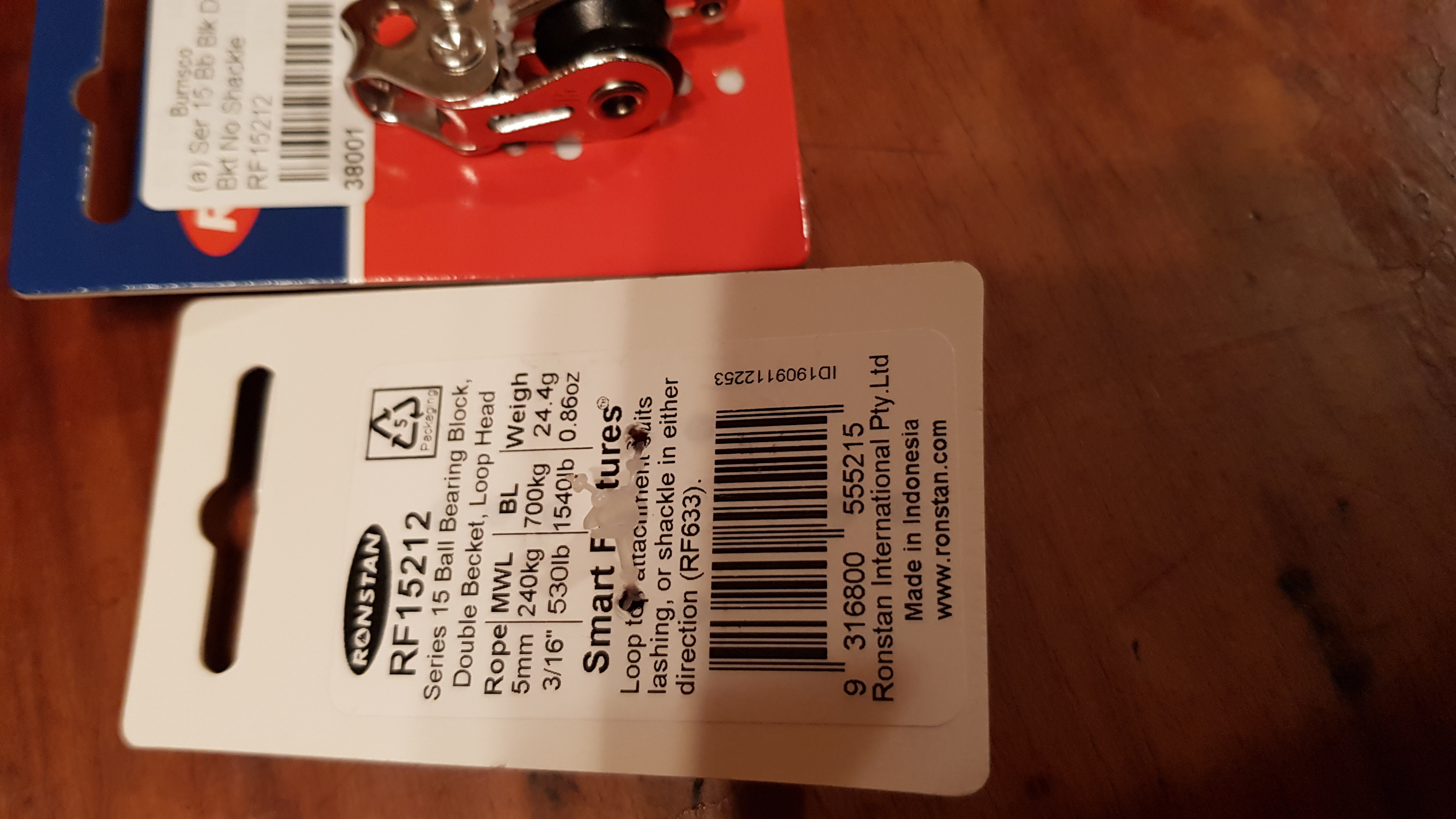

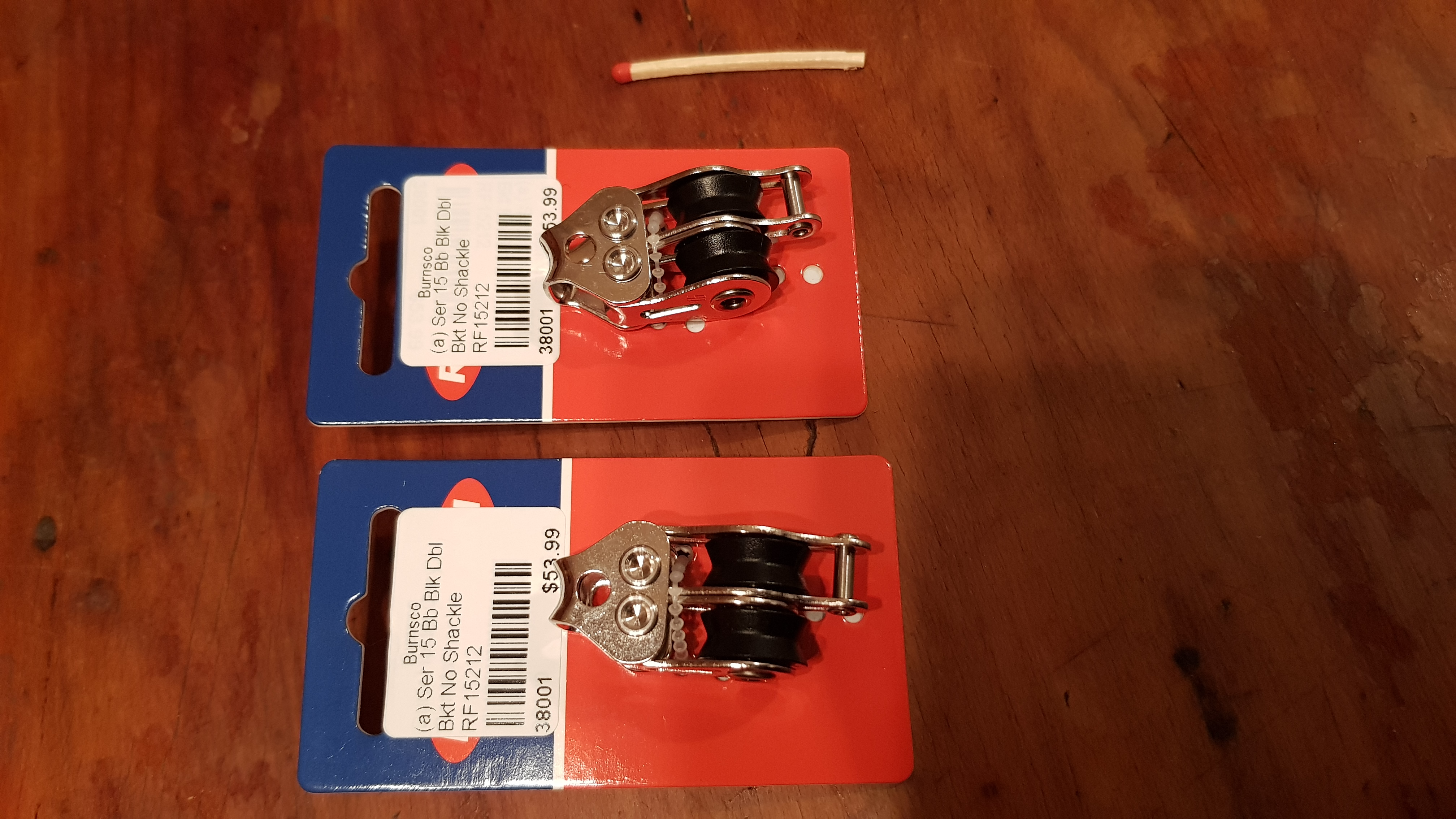

Looked at getting a gambrel hoist but found they were bulky and not easy to fit in my day pack. Figured I could make one that would do the job and not be so bulky.
Went to my local Marine shop and found these......
The match next to the packet gives you an idea of scale.
Note the load capacity.... Max working load is 240kg/530lb from a pulley that is smaller than a matchbox!

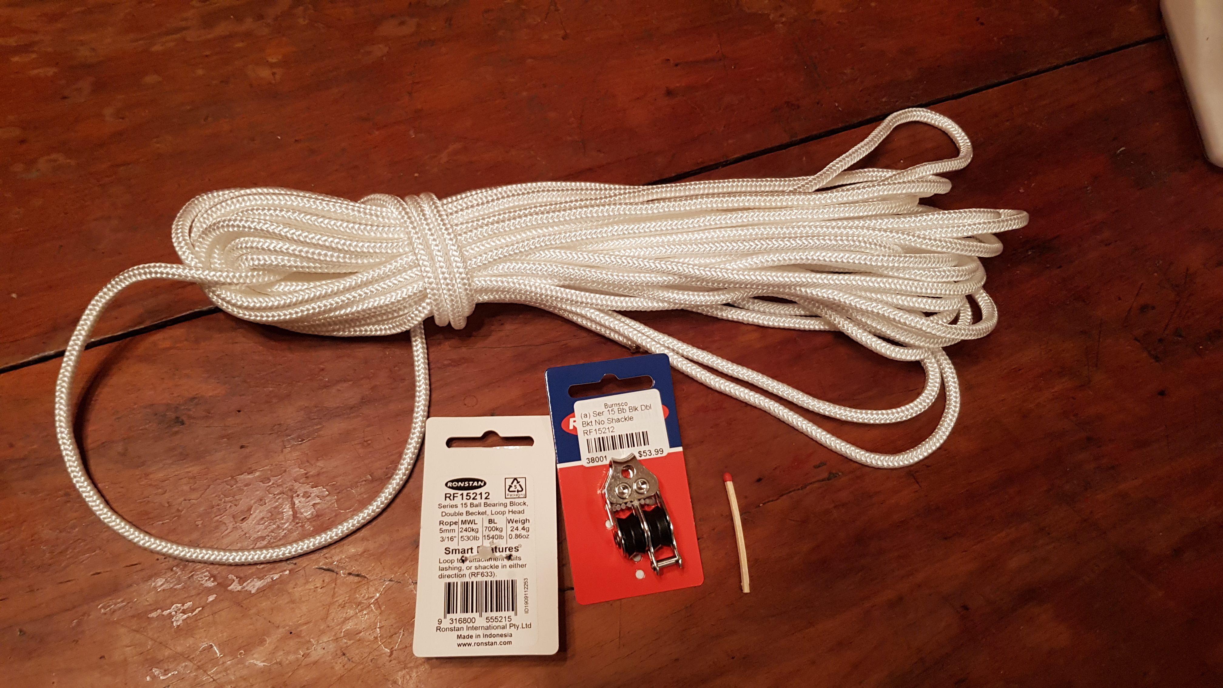

Nylon cord is rated at 400kg....
Put it all together and it makes a very small packet that fits in the side pocket of my day pack.
