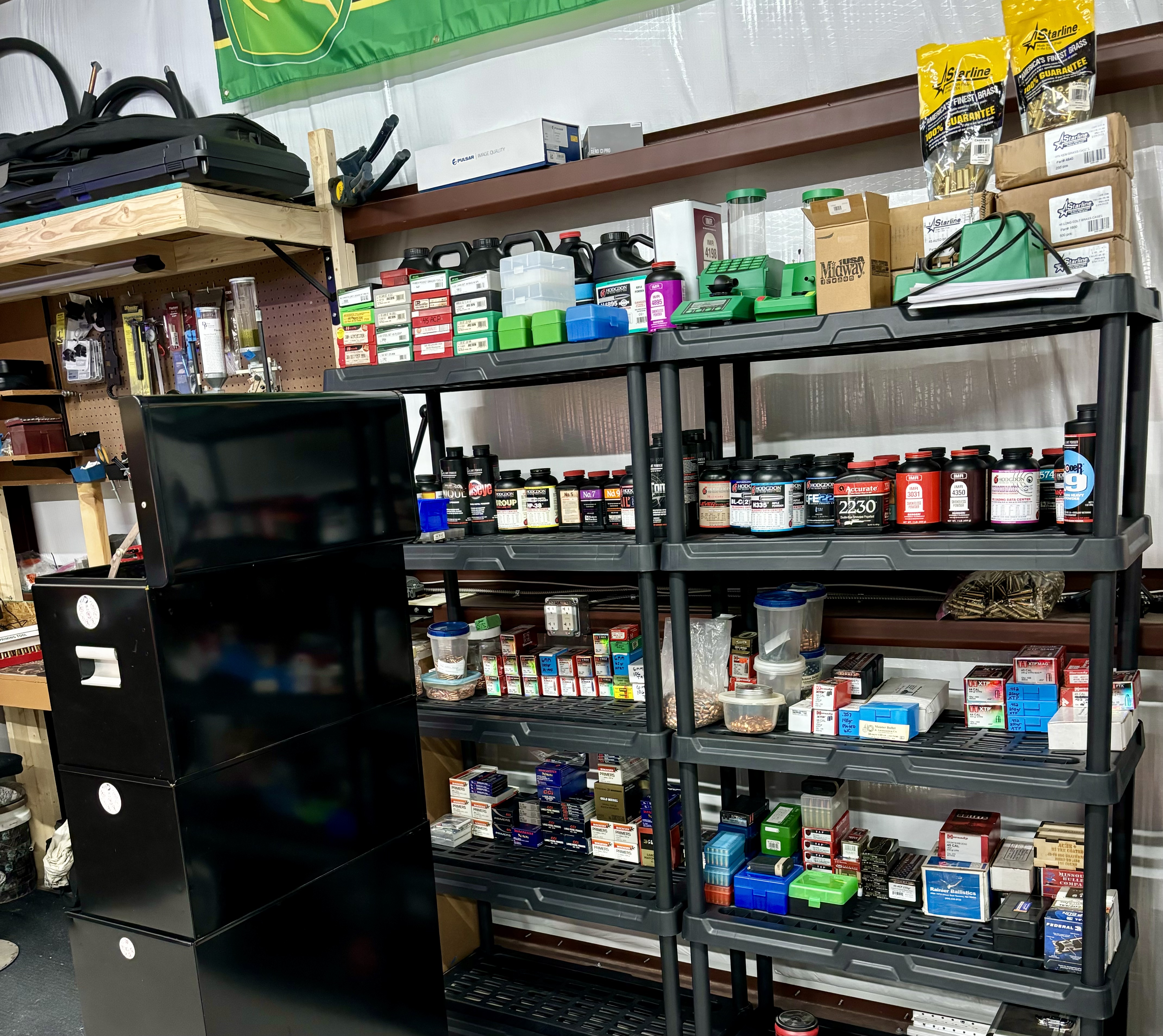

Most used/favorite and least favorite gun powders?
Posts: 2339
I have 1# cans of multiple powders that I try when doing load work-up and 8# jugs of the ones I use the most
Most used:
  • Ramshot TAC
    H4895
    Hodgdon Li'l Gun
Least favorite:
  • BLc (2)
    LeveRevolution
What are some of yours?
