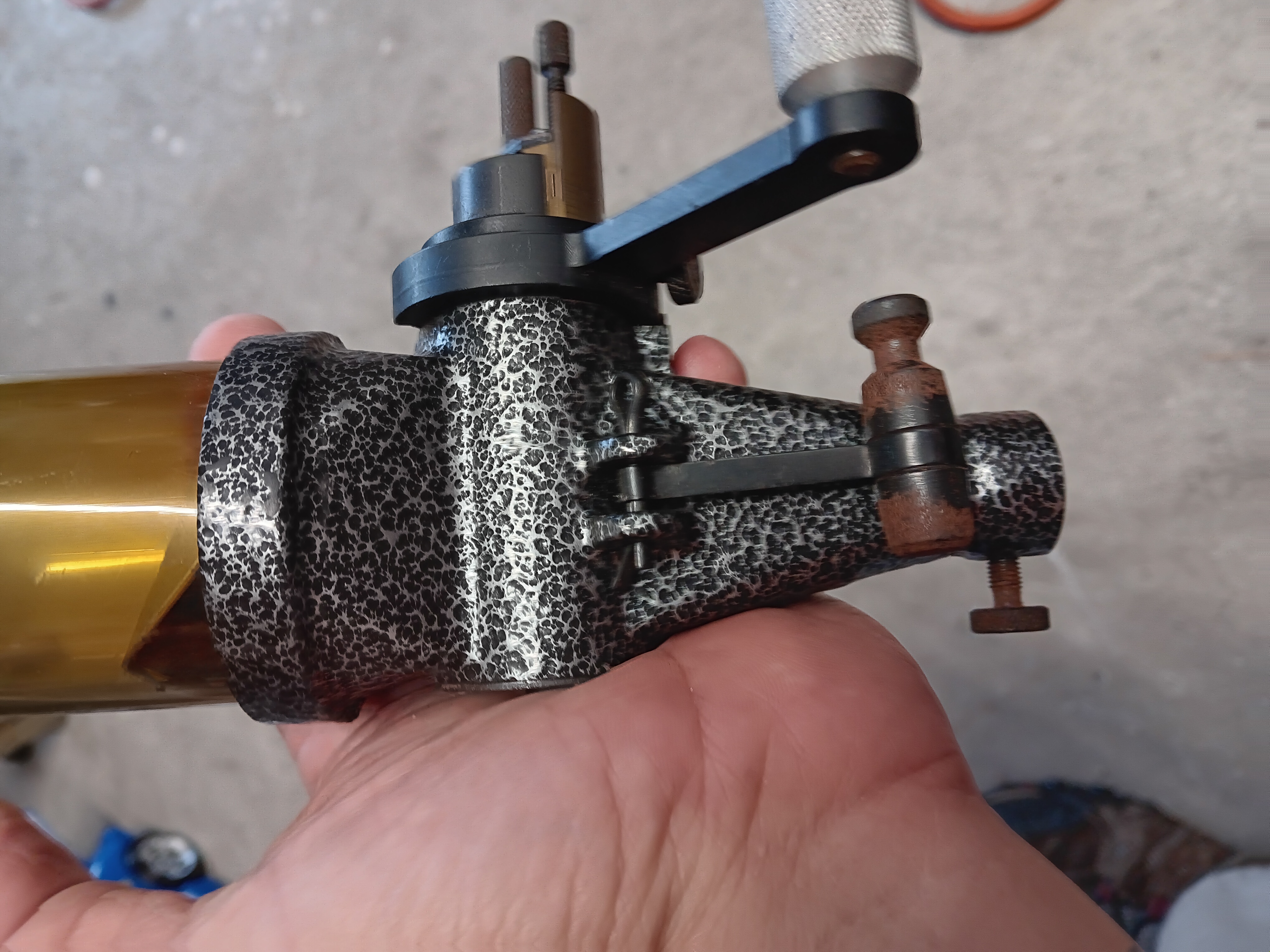

Few years back I was given an old Lyman powder measure. Original box, not abused but kind of icky. Mice had made a home in the box, and pissed all over it. Time and piss caused rust, pitting, etc.
I cleaned it up with the intention of repainting, and making it automatic, but didn’t do either. Last night I bead blasted it and threw on some powder coat. Which is so much better than paint.
Turned out pretty decent. I laid the PC on thick, to try and hide the putting. It worked well on the not so bad parts, and is certainly better than it was before on the really pitted parts.
It works well, and drops H110 within a tenth of a grain. The hopper is kinda jacked, I flipped it from the threaded end to the plain end and “threaded” it by forcing it into the measures threads. It’s assembled, so, I’m not pushing it. Worst case I 3D print a new one. Or machine one.
I MAY carry on with making it automatic, maybe not. Plan was to hold an empty case up to it, and it would operate itself. Why? Because I can.

Thanks. It’s easy, as long as you follow the rules.
1. Good surface prep. Aka sandblasting.
2. Wipe with acetone.
That’s really it. The process kind of does it on its own.
The other rule is don’t bump the parts placing them in the oven. There’s ZERO touching allowed. No matter how light you THINK you can touch it, you can’t. Period. Point blank. End of story. You’ll wipe the powder right off.
Now, the nice thing is you can *maybe get away with just spraying more powder over the blemish before baking. (I got away with it. 😬)
Worst case you blow it off with the air hose and start over.

There appears to be a part missing. Look at the box and you'll see a little thumper/hammer. When you charge the measure tube , you should life and drop the thumper to add consistency to every charge.
I use the same measure.
Nice work!
Re: Powder measure spruce up.
Posted: Sun Jan 19, 2025 9:46 pm
Freezer wrote: Sun Jan 19, 2025 9:34 pm There appears to be a part missing. Look at the box and you'll see a little thumper/hammer. When you charge the measure tube , you should life and drop the thumper to add consistency to every charge.
Nice work!
I’ve got the hammer dingus. I took it off because I was offended at the horrible way it was attached. And, other measures don’t use one, and they work fine. So does this one. It meets the accuracy of my scale, so I can’t prove one way or the other if it helps. If I ever get a scale with better resolution, I’ll for sure try it. If I end up automating it, I’ll add a vibrating dingus to it to perform the same function.
