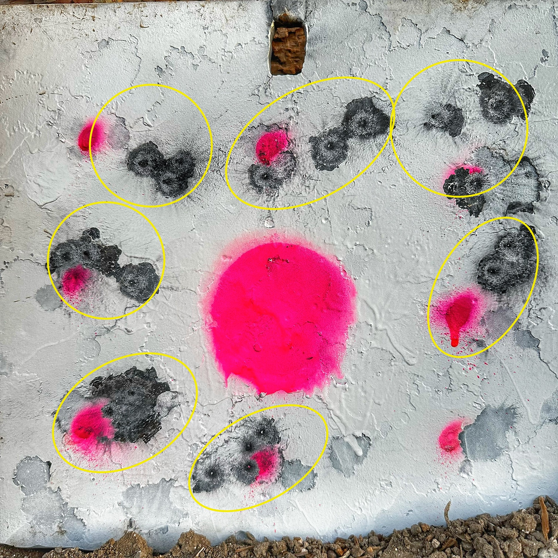

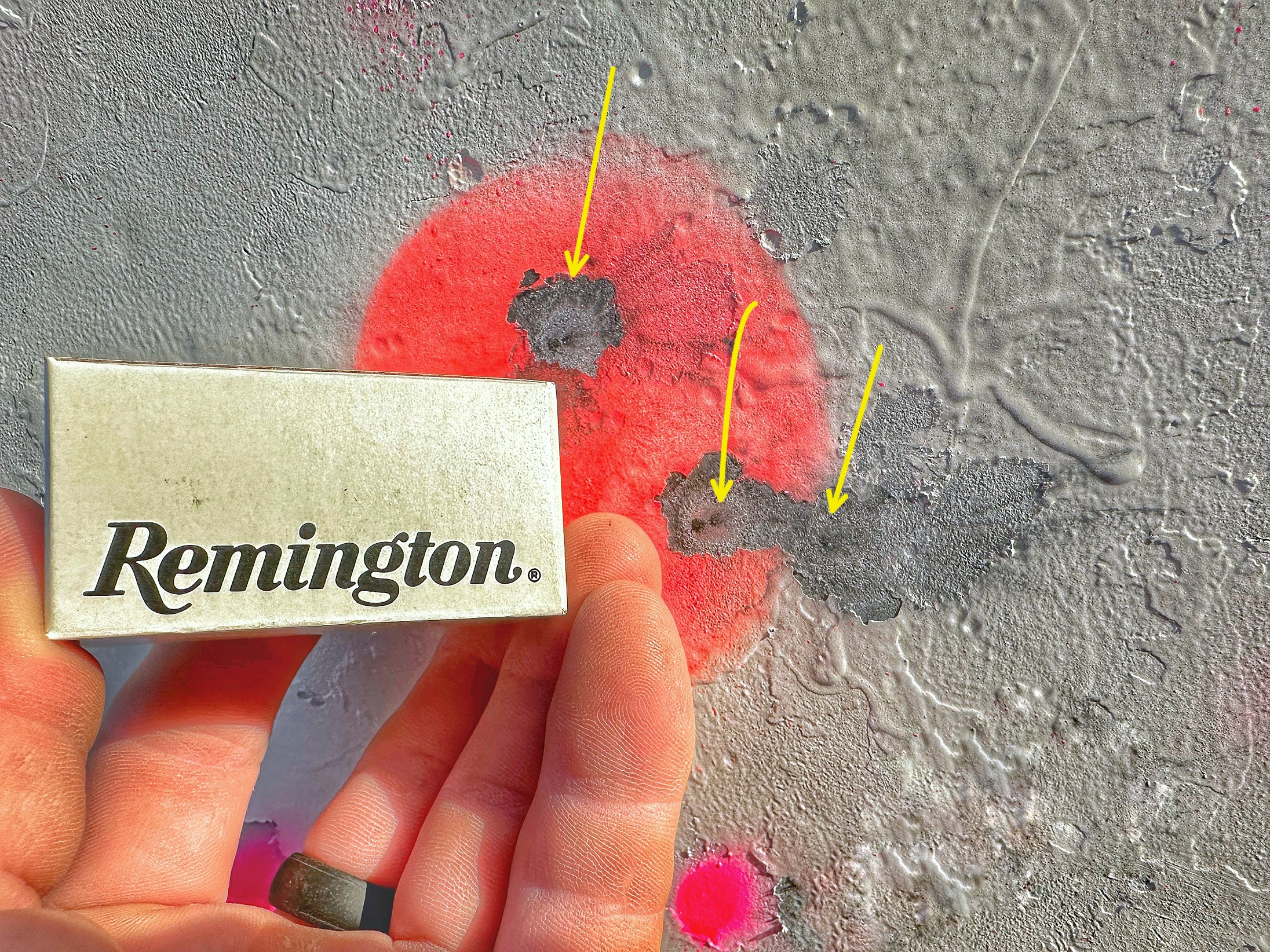

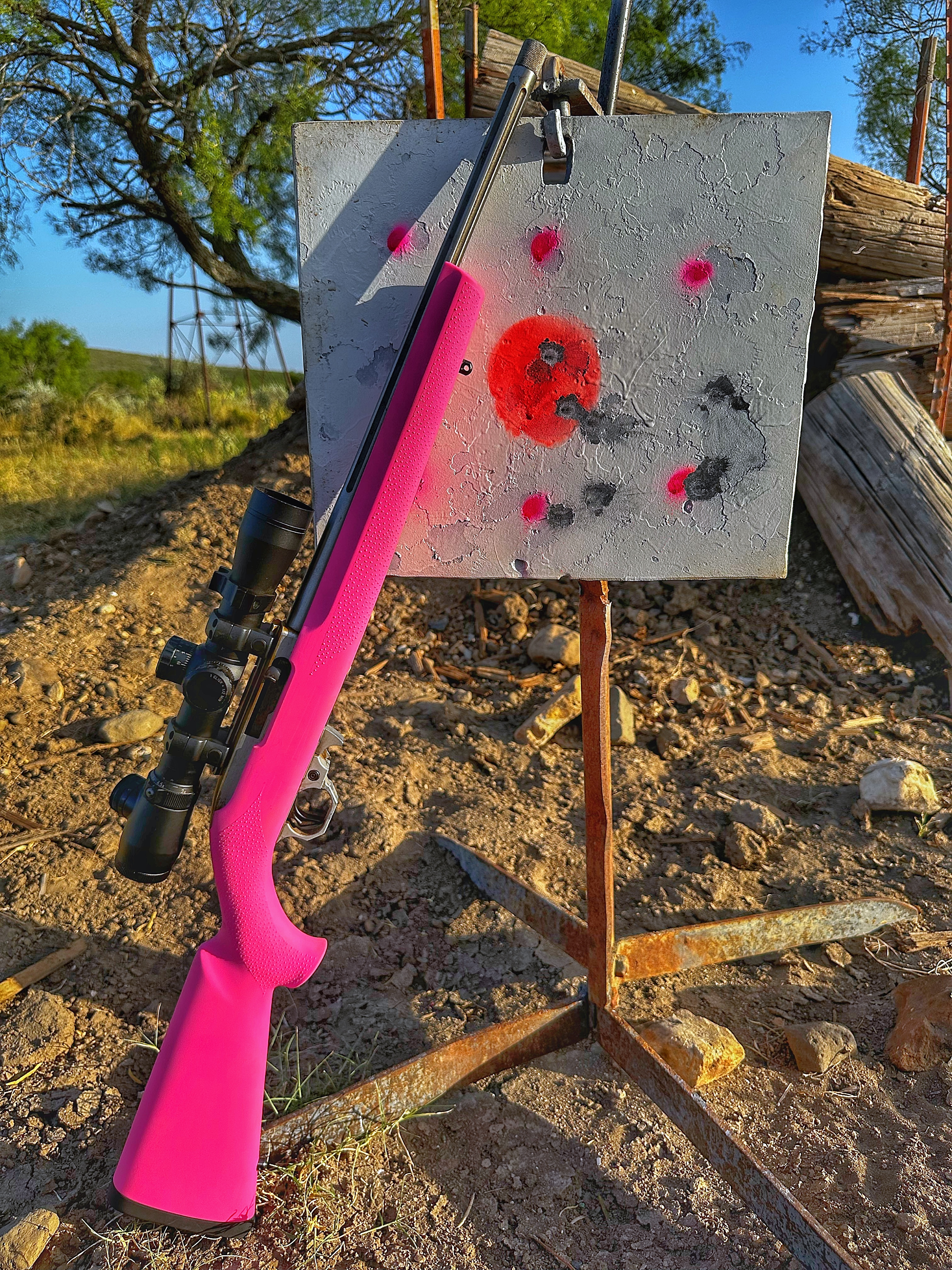

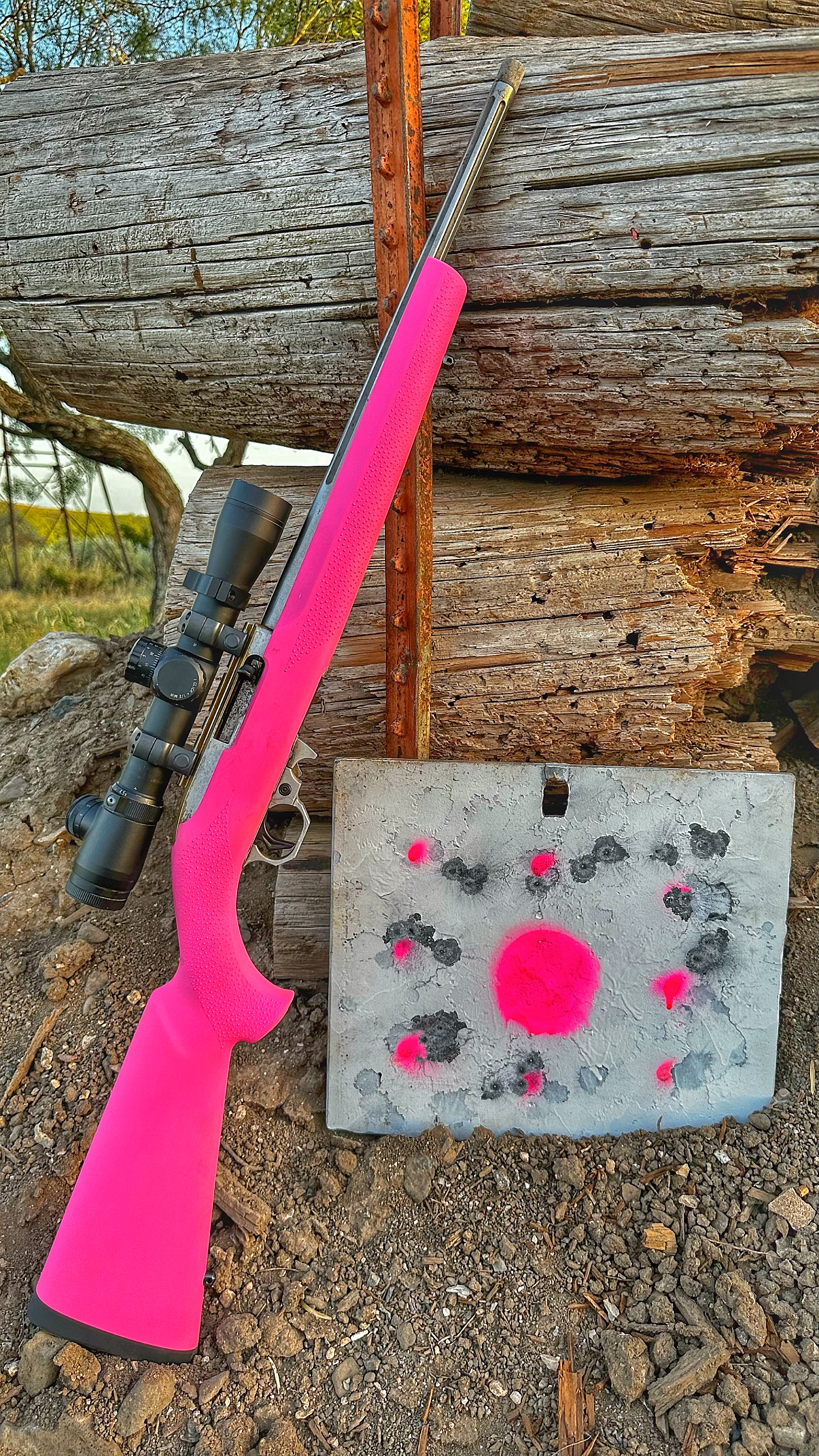

My rancher friend has had a 10/22 for ever since I’ve known him. He had a Green Mountain barrel installed and a Volquartsen Trigger before we met and since I’ve known him, that rifle was a one hole gun. Sighted in at 35 yards, we used to shoot ground squirrels and Ringneck Dove in the heads for the pot.
Recently I’ve noticed the accuracy going to crap. I replaced the cheap Weaver Rings with Leupold and shot it. No improvement. I replaced the factory plastic stock with barrel band for a spare Hogue free floating stock and no improvement. I cleaned the barrel (not a deep lead removing clean but a light carbon clean) with no improvement. Today I swapped the Nikon scope and Leupold rings for one of my Leupold and Mk4 rings………with no improvement using 3 different types of ammo.
Those groups are at 25 YARDS!!! They SUCK!!!
Only other thing I know to do is deep clean the barrel or replace the barrel.
Thoughts? Suggestions?

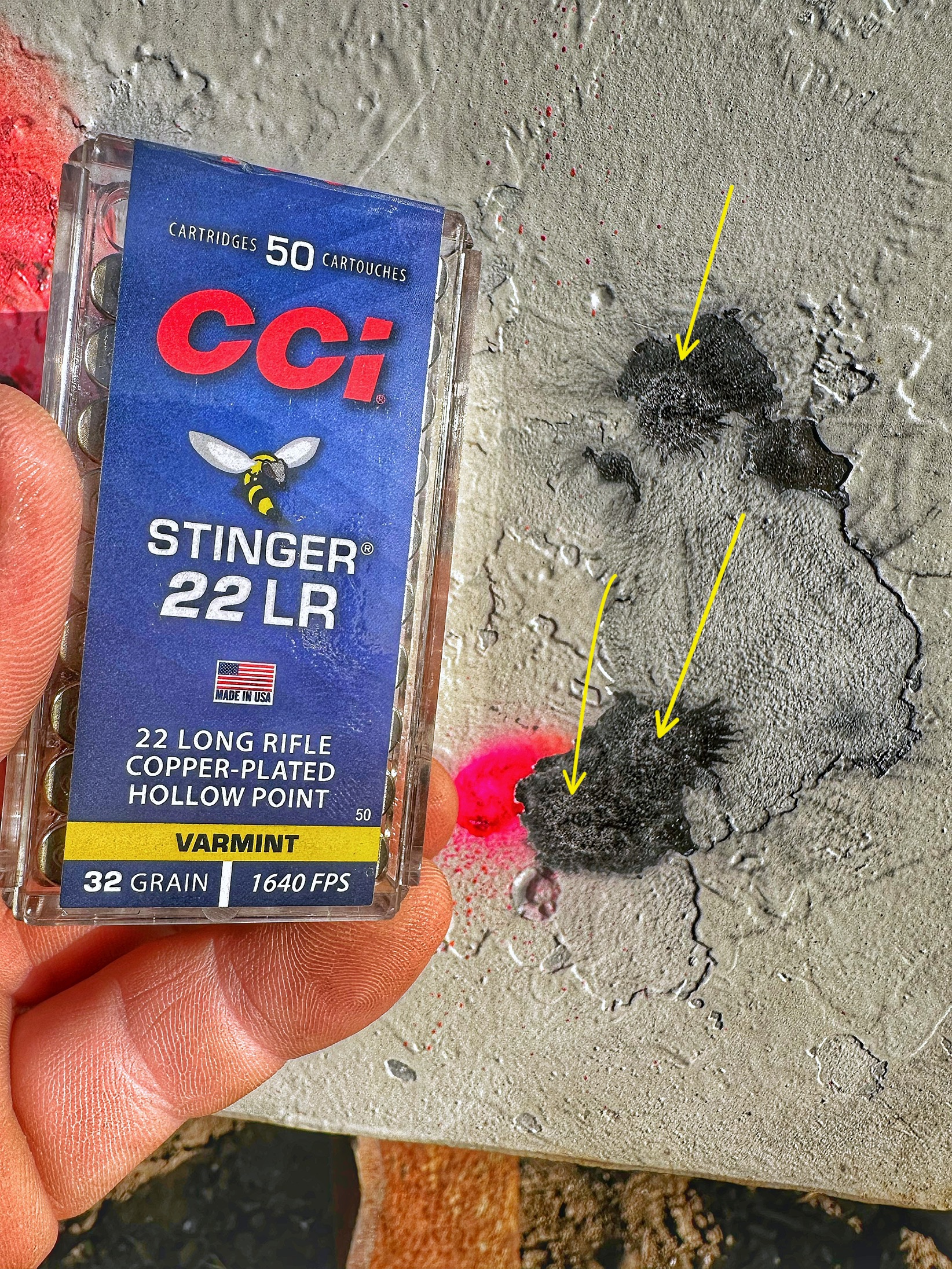

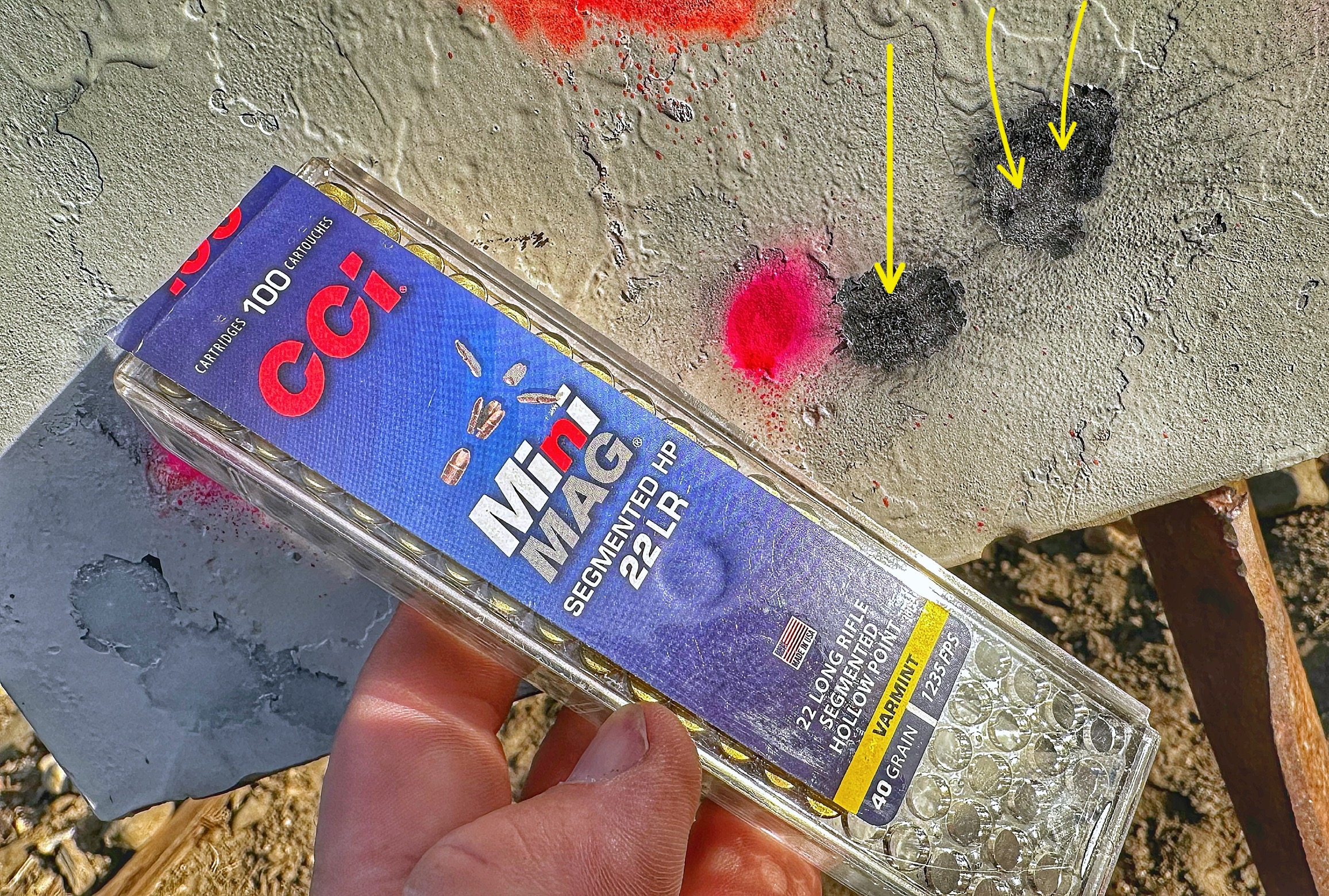

Deep clean and try different ammo.
Stingers are garbage accuracy wise.
As are that white box stuff. (In my experience)
The segmented, I don’t know. Never shot it.

CPJ 2.0 wrote: ↑Thu Jul 20, 2023 2:58 am Deep clean and try different ammo.
The question is….did it shoot any of that better BEFORE?
It shot the white box well. The other is unknown.

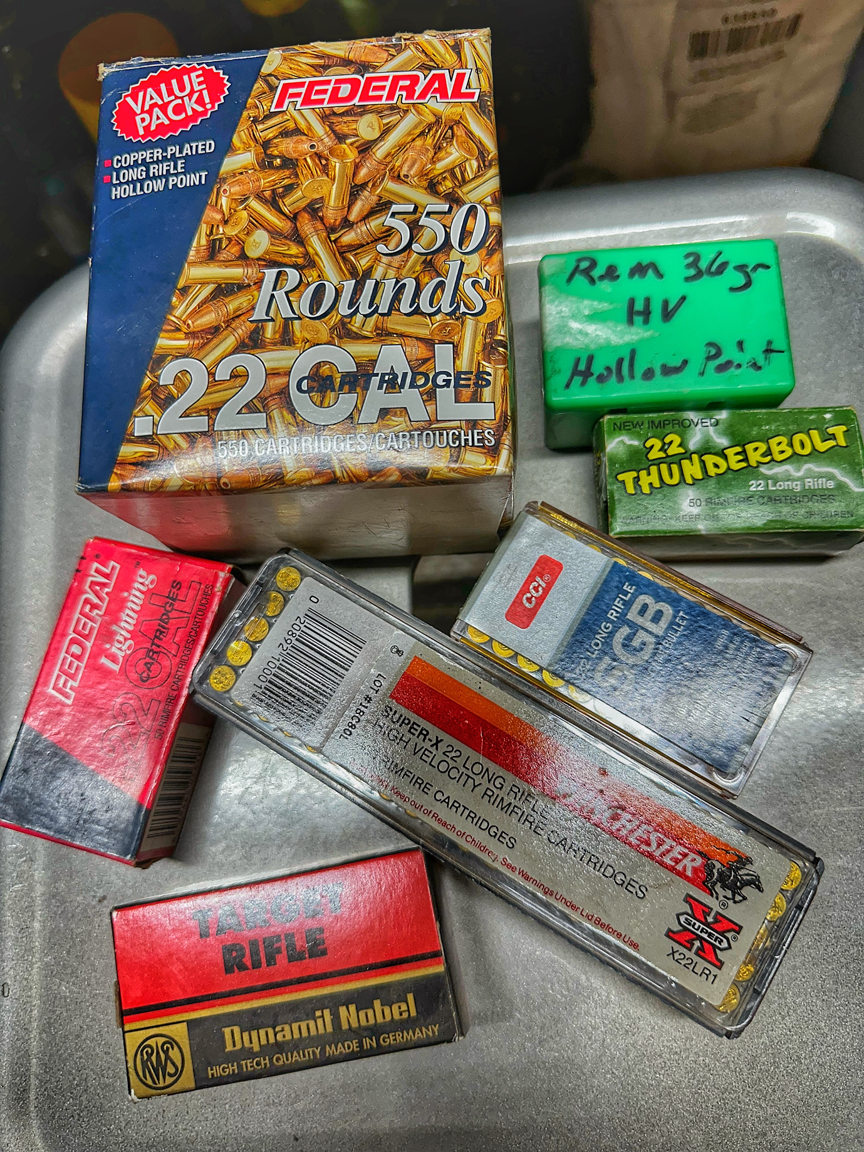

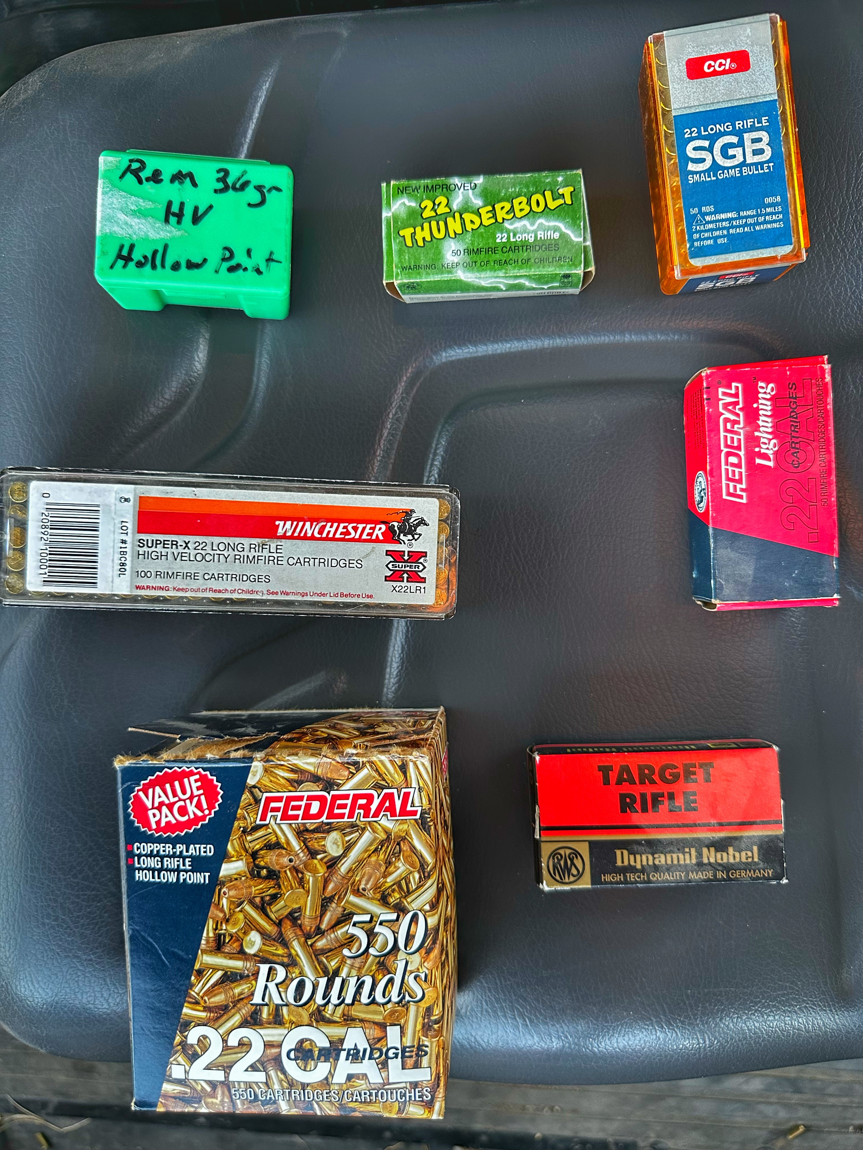

I see thunderbolts in your picture if things went south after using them......get the lead out.
Posts: 553
Re: Ruger 10/22 Issues - Thoughts?
Maybe try some better ammo. The RWS is the only thing pictured that has potential. But of course you never know with Rimfire ammo.
Posts: 4519
JunkCollector wrote: ↑Fri Jul 21, 2023 12:41 am I see thunderbolts in your picture if things went south after using them......get the lead out.
Funny I’ve actually had great luck with Thunderbolts in a few rifles.
Posts: 3025
This evenings results. The ammo is placed in order of grouping.
Posts: 4519
Did you just go from one to the other? If so that is not optimal for accuracy testing.
Posts: 1011
Looks like an improvement?
What changed ?
Wambli my nephew had a brick of those thunderbolts that turned a rifled barrel into a smooth bore in very short order.
