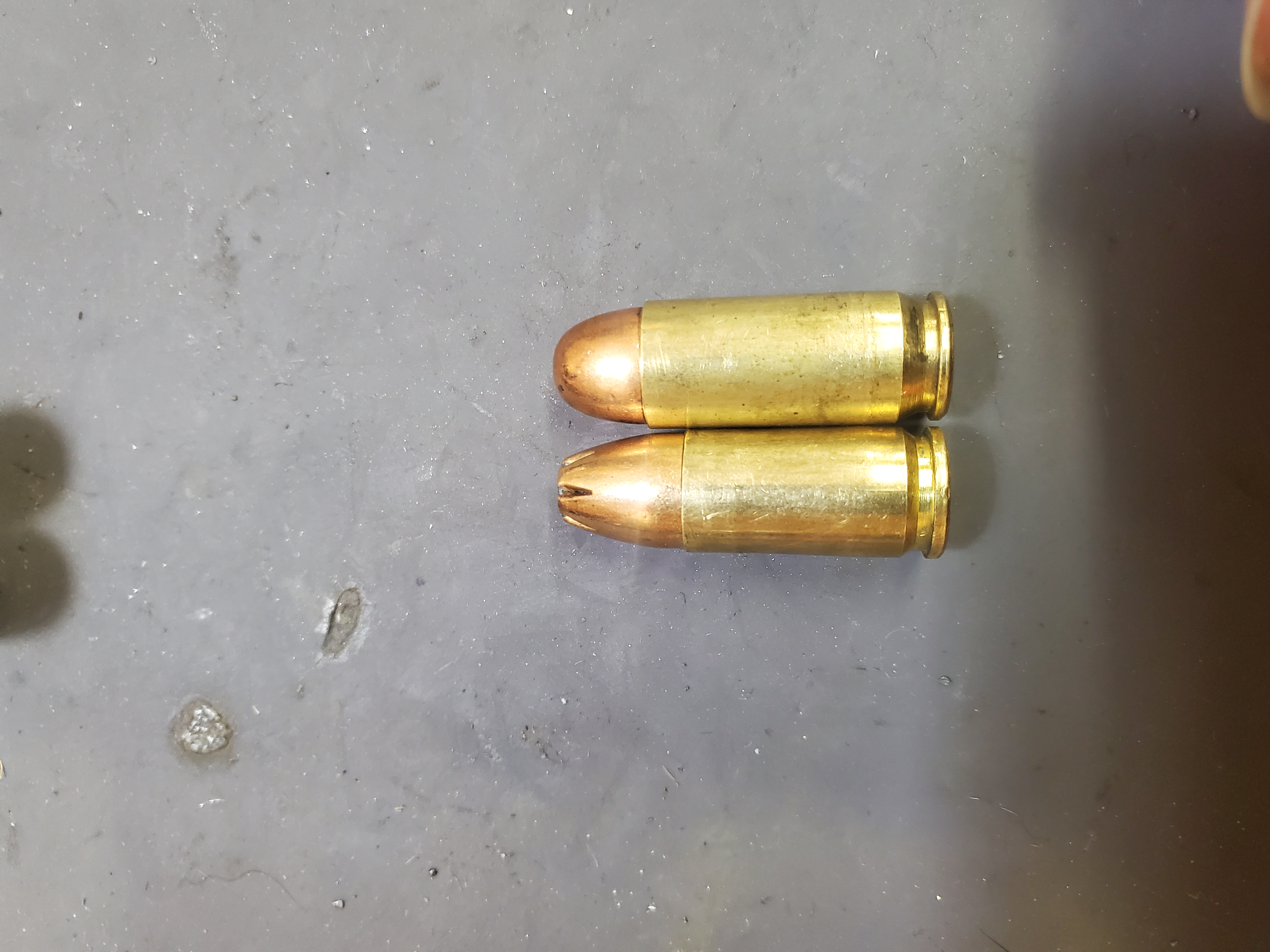

For my glock. Took 350 legend brass and cut it to 22mm in length. It has a 100 grain bullet in it, because it's what I have but I should be able to load 115 and it still load in glock magazines. It "should" have the performance of a 38 Super and I have a G19 barrel on the way. Although I could use a reamer from a different 9mm, I'm just going to do it in the lathe. The rim diameter is slightly smaller by .009 but it still seems to work against the breech and extractor. I'm just doing it because I'm weird and like one off stuff.

I'll be curious how high I can get the velocities before showing pressure signs and sticking brass. My slide is an aftermarket ebay buy (whole upper) and I've almost always needed +P ammo to cycle it because it's heavier than a normal G19 slide so I think it'll be a good candidate for this.

Isn't looking for pressure signs on a hand gun a dangerous undertaking ?
Re: I made a wildcat.
Posted: Fri Feb 28, 2025 2:06 am
On a blowback, yes. Delayed actions not so much. There's some play room if you're careful and making small adjustments.

CPJ 2.0 wrote: ↑Fri Feb 28, 2025 2:29 am https://en.wikipedia.org/wiki/.356_TSW
I didnt know that was a thing but at least I have an extra mm in length to be different enough 🤷‍♂️

Get a gen 3 glock 19 bbl chambered and send it and 2 rounds ammo this way (one to fire remotely and one to put in my gel)
Though from what I just read, you might need a slightly heavier recoil spring. One article on the 356 TSW said the glock bbls came with a 22# spring
Posted: Fri Feb 28, 2025 6:00 am
The barrel I ordered says it'll fit gen 1-5 but won't sit flush in a gen 5 so I assume that'll work. I'm not too worried about the heavier spring since I have the heavier slide but I get that you'd probably need it if you have a factory weighted slide. I might just take you up on it when I send the 50-60 pinfire.
