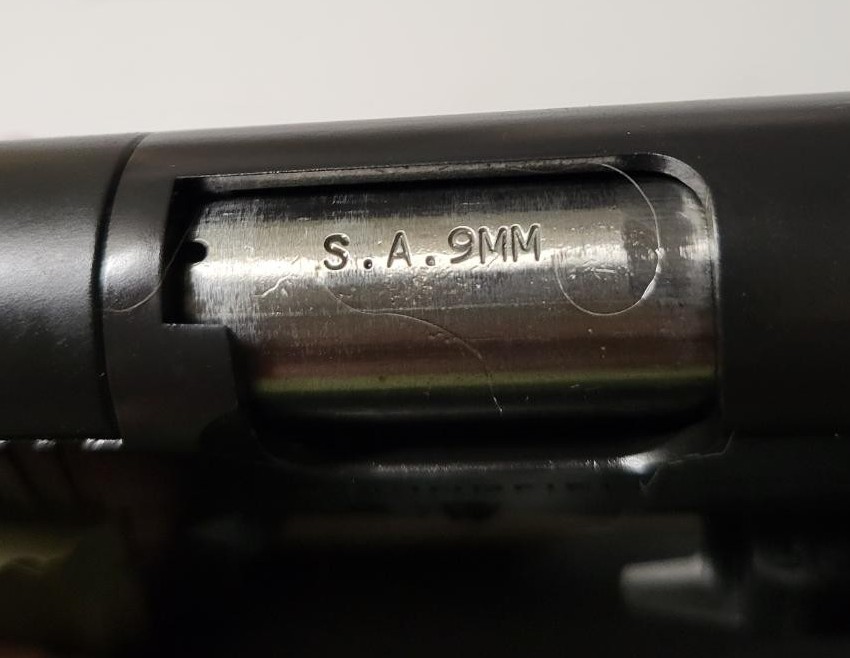

So when Springfield dropped their "AOS Operator", it made me go "Hmmm". Please consider:
SA9X19 4.jpeg (123.62 KiB) Viewed 3092 times
So it's got a light rail on the frame and an optics cut on the slide, but it's otherwise a 1911. . .
SA9X19 3.jpeg (67.64 KiB) Viewed 3092 times
Sort of :mrgreen:
So follow along for a few posts as I outline my journey of setting this thing up. The mindset of this build is in line with what the Japanese Emperor had to say at the end of The Last Samurai as he was contemplating the "need" to modernize while holding a sword: "We can not forget who we are, or where we come from"
Enjoy the ride!
