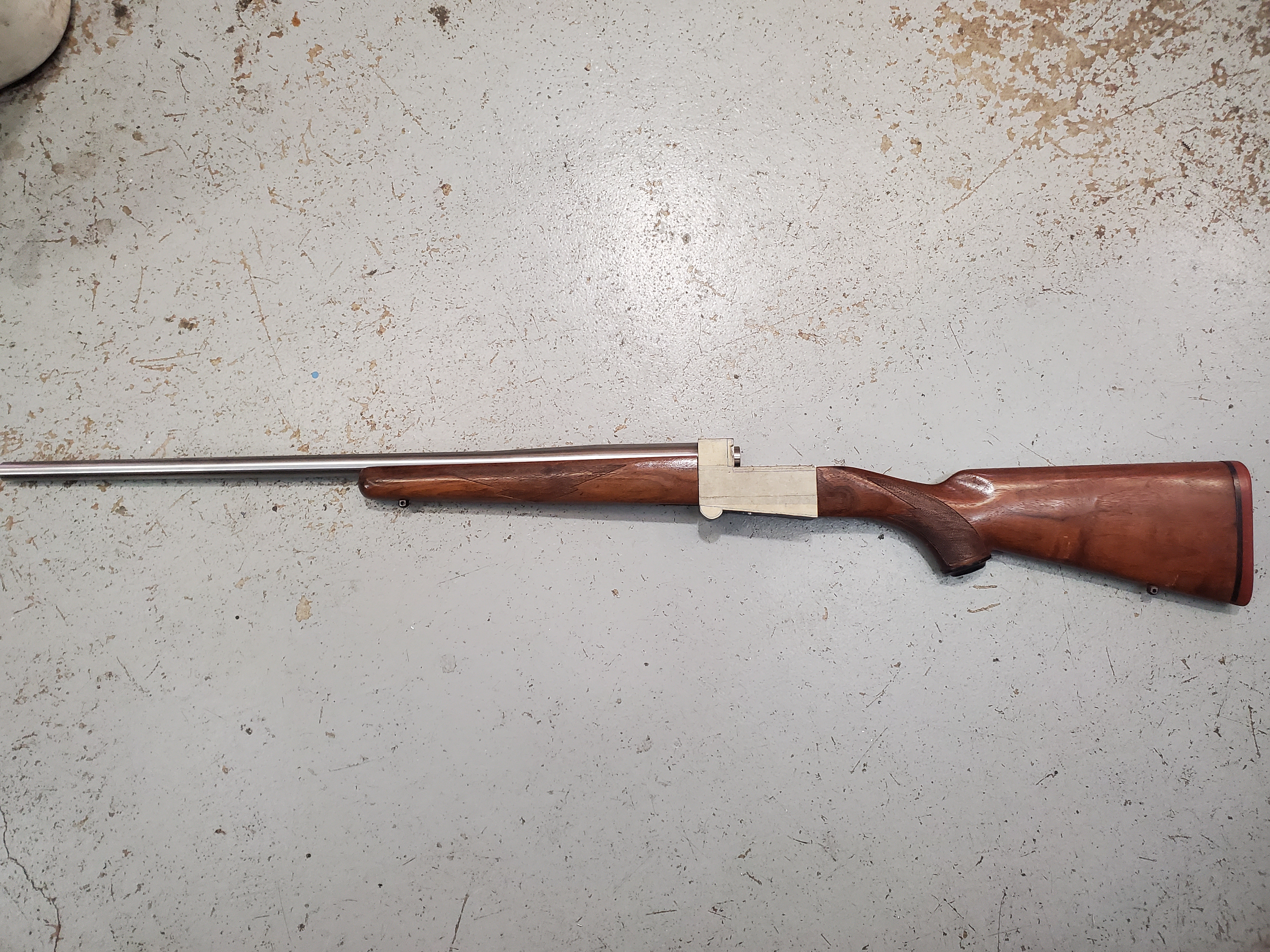

I got started (roughed out) on the 50 caliber pinfire. I'm going for a simple design and I'm using a 1" diameter piece of O1 drill rod as the bolt/breech block for the falling block. It's a bit "over built." This thing will probably in all seriousness be able to function with heavy smokeless loads, but it's going to use 60 grains of 777 powder in the 500 S&W Magnum brass that im using. The reciever is medium carbon steel and its oversized at the moment because I wanted enough material to be able to contour everything into the stock and forearm when I'm done. I'm also fairly certain the wood was donated by @Grapeape from his M77 that I built. The barrel is a Green Mountain blank that I cut the tenon and threaded but am yet to contour, hence why the mock up has the forearm looking funny. It'll be a simple lever design to raise and lower the breech block and a hammer that swings from the side and not over the top to hit the cartridge pin. I still have a ways to go but even getting to this point was pretty quick. And drilling and reaming a 1" hole took longer than you'd expect.

Chunk gun! πŸ˜„

It's definitely roughed out and oversized at the moment. If you look closely at the last picture you can see my pen mark of where the bottom of the reciever line is drawn from handguard to butt stock. It's real faint.

That based on those drawings?

CPJ 2.0 wrote: ↑Sun May 18, 2025 9:29 pm That based on those drawings?
No, this was just floating around in my head. I actually forgot all about that but still have them saved as a download. I'm realizing it's pretty similar though πŸ€”

That’s cool!!! A Ferguson rifle style breech setup could be amazing!

I appreciate that. I'm going to try to make this thing a piece of art when it's done. Nice hot blue finish a mile deep and beautiful contours. I got partially finished with the barrel contouring today and can get onto the reciever shaping after that because I need to see where the forearm will sit exactly. I can't wait to fire it. Should be a hammer!

Got the barrel contoured and most of the excess removed from the reciever. It's actually starting to look like something now.

Ironically I always do these things from my head because if I put it to paper or try to write up plans or blue prints, it never works πŸ€·β€β™‚οΈ.
I'm thinking the fun part is going to be milling out the pocket for the internals of the hammer pivot shaft and trigger and then making a side plate to enclose it again. I'm pretty sure that'll be next.
