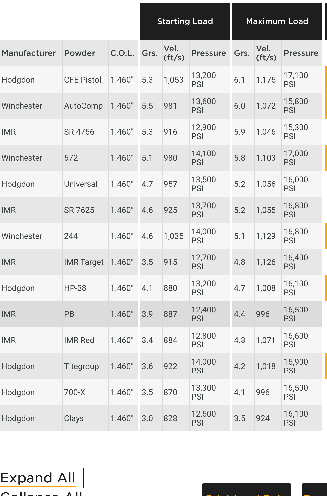

Noticing some deficiencies in my reloading data. Any idea what load books have the most data on the 327 Federal and data on .38spl with 130gr jacketed bullet loads?

Here's the 327 data Hornady lists
