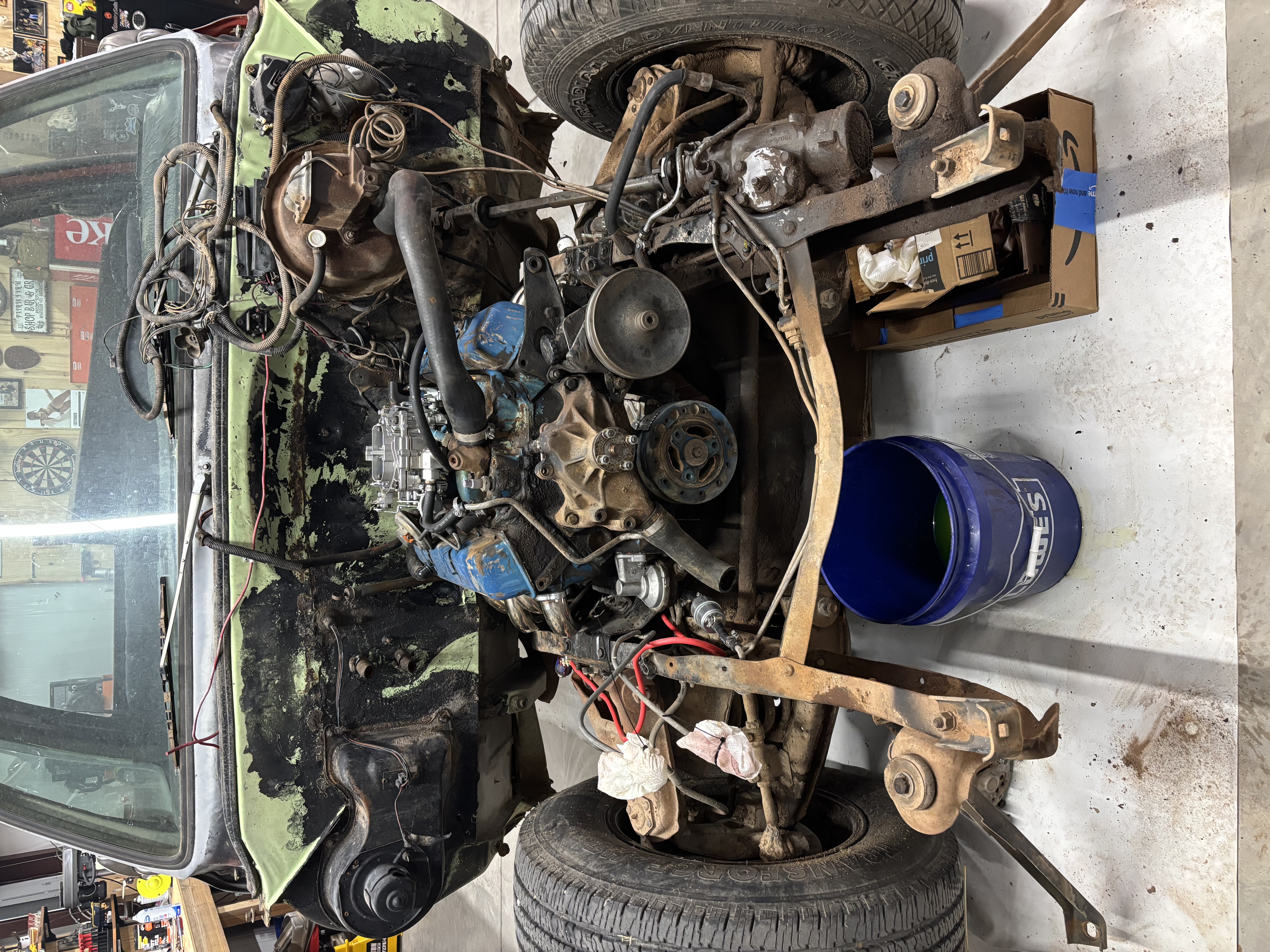

Got it up in the air and ran into the first problem. WHODATHUNKIT
Drain plug frozen solid, I am guessing cross threaded. Even holding it I was bending the actual radiator tank itself.
Cowling out. See the other problem on a 1969 350 man trans and no AC? Yep, wrong radiator.... ish. In 69 there was a strike and Corvettes went through an "if it fits it ships" phase. So while not the radiator in the assembly manual, it is the radiator.
Image Cowling adjusted by PO. Why??? No idea.
So the first parts, headers and clutch kit already arrived from Summit.
I am torn on the radiator. Go new and what is the quality? I am going to find a rad shop and see if its worth saving. It wont go back in if its questionable. At my age and planned driving of this I wont wear much out and I dont want to do this again.
Plan for engine is a refresh. It is original numbers matching and I like that, if it needs honed or taken 30 over, I can live with that. I'm old and have been as fast as I need to be 350hp is enough with whatever I get from letting it breathe a little better with headers and exhaust.

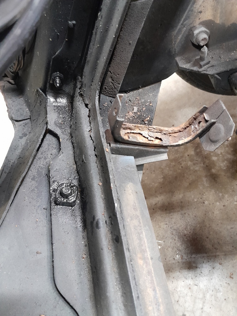

Got the radiator out, looked at the radiator support, its rotten. Not uncommon, but I was hoping...

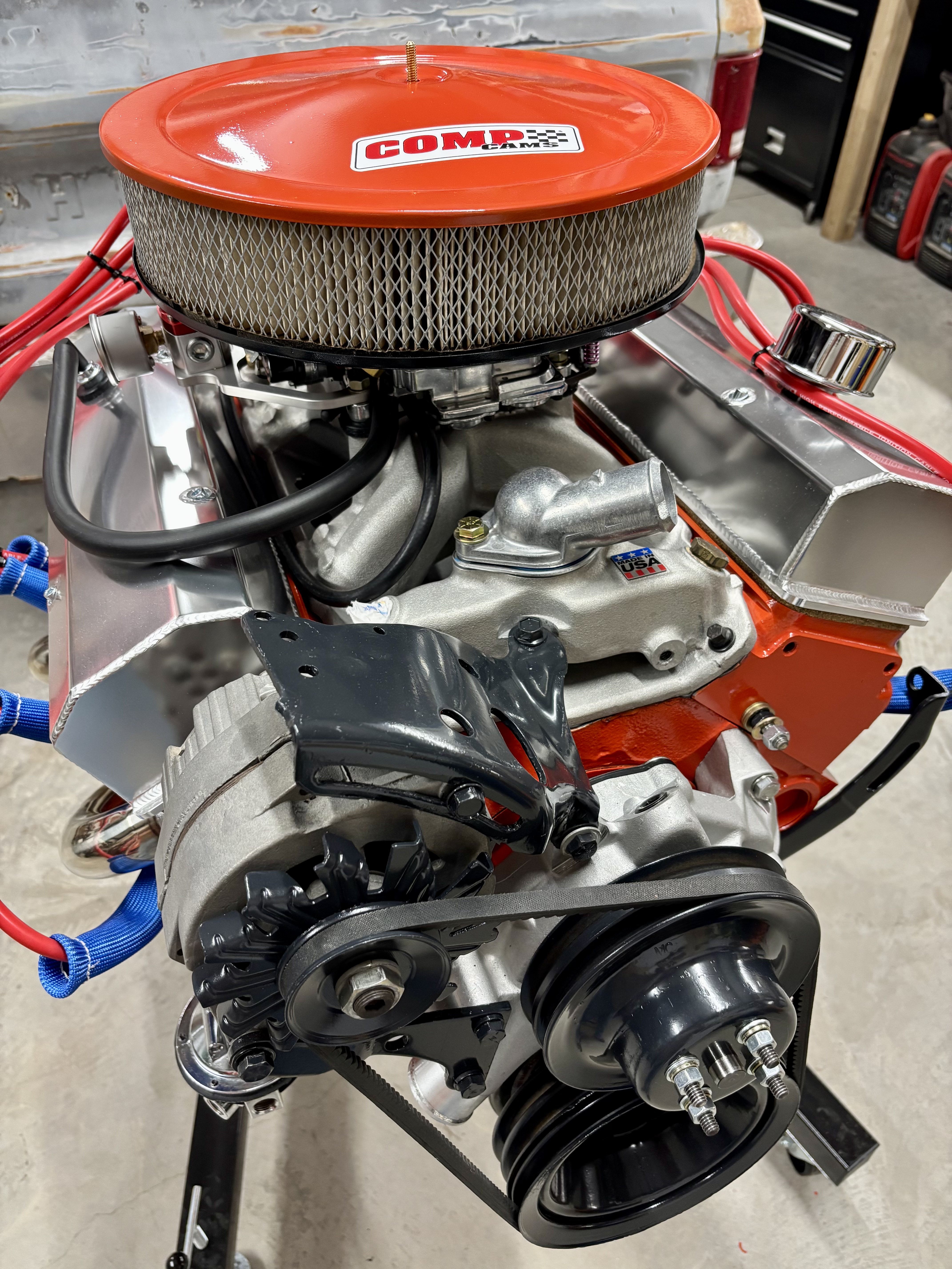

I happened to recently sell a factory GM aluminum “snowflake” intake manifold from a similar year Corvette or Camaro. I bought a newly built engine from a friend and he had that intake on it. It wasn’t what I was going for on my project and the cam in it was too small for what I wanted, so I tore it down, put in a bigger cam and lifters and an RPM Air Gap intake manifold.
355” SBC, 10:1 compression, World Products heads, Comp XE 274 cam. Nothing fancy. To go into a ‘76 Chevy C10 short bed. The original 350 in the truck was unfortunately replaced with a ‘79 smogger 305 at some point in its life. So swapping the engine is a must for performance. I’ll also be swapping the cab. It’s rusted pretty bad and has very little floor pan left. I have another cab that is in great shape and has solid floors.
