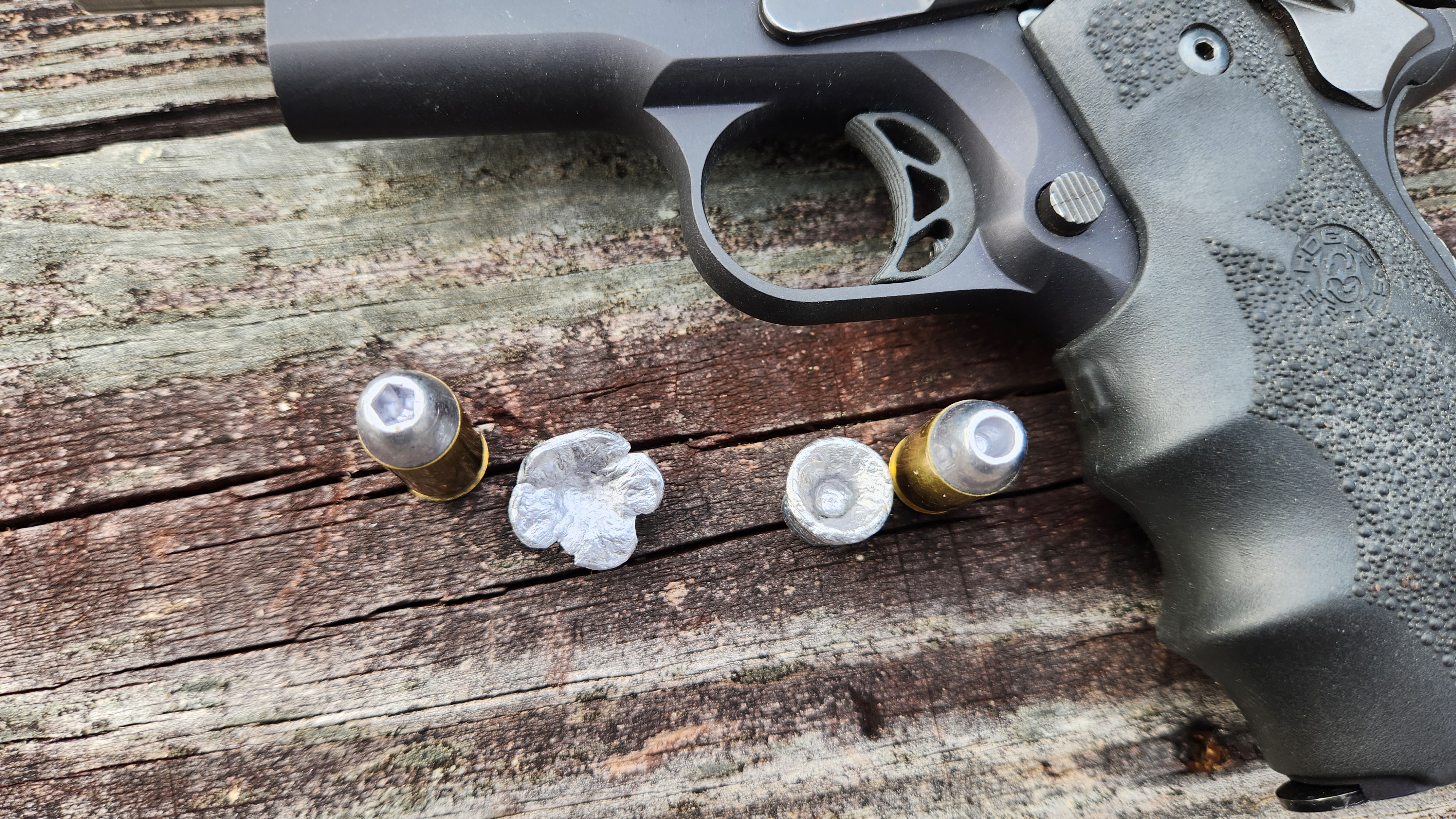

Range report
Posted: Thu Jan 08, 2026 9:37 pm
Well, that was interesting. From my 5" gov't model 937 fps. From my 4.25" Commander 860 fps averages Proof that barrells are a breed unto themselves. I would not had figured that 0.75" of barrel would yield a 77 fps difference. Concerning the PentaPoints (PP) Mixed results, first one from the 5", zero expansion and straight through my 16" block of 10% ClearGel :o
First PP from the commander, 10" penetration and nice expansion. I scratched my head and decided I HAD to try another through the gvt model, There's no way a faster cast lead bullet should expand LESS than a slower one into the same medium. Second PP from the govt went 9" and expanded nicely
Regular HPs, first through the commander. Minor expansion, 14" penetration. Through the gvt, NICE expansion and 12" penetation.
Now for 2000 quick words ;)
An unfired round is next to its fired version, black grips are the commander.
While the 2/3 of the PPs that expanded did so quicker than the HP version. The one zipping through with no obvious expansion, from the wound channel, gives me pause. While the HP from the 4.25" didn't expand as much as the PP, it DID expand. The 1/3 PP that didn't expand from the 5" greatly reduces my desire to use them as my all purpose bullet
