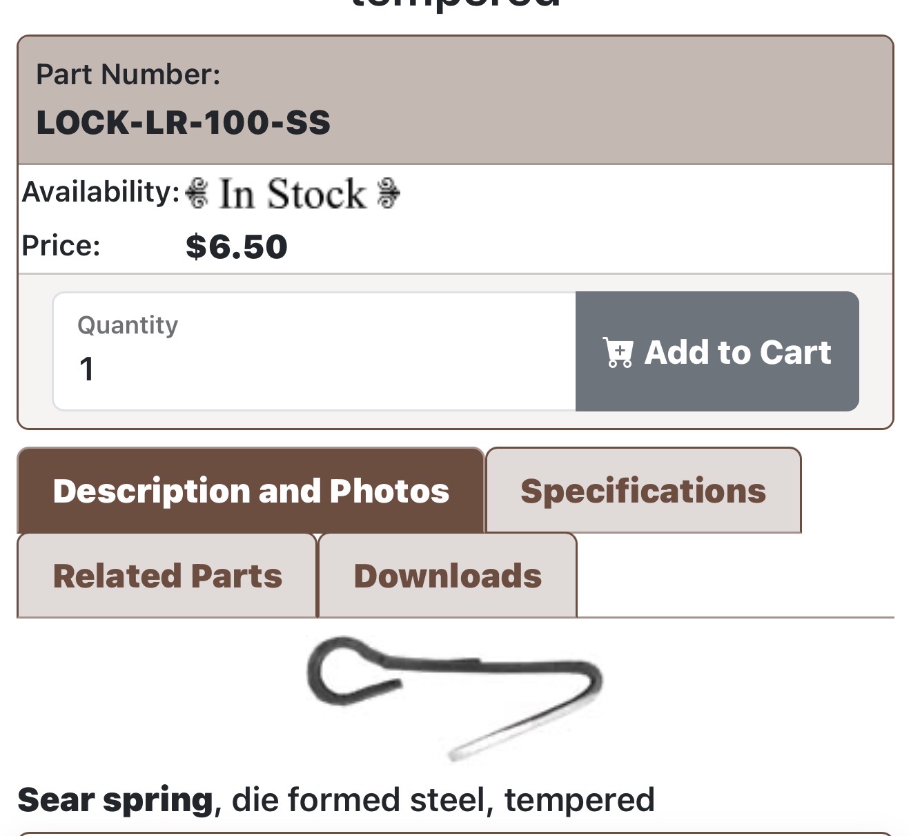

I managed to get 5 shots out of my CVA Kentucky Long Rifle before I experienced a problem, the sear spring broke. I have done extensive research and found it is no longer made and hasn't been in twenty years, There are two different springs, the "U" shaped spring is available but not the "V" shape. I have three choices, find someone to make it, make it myself or spend $275 for a new lock.
I'm watching videos and researching techniques. My first problem is they want $40 for a lot more steel than I would need. Is there an alternative? A putty knife or taping blade?
I understand I'll need to get it red hot to shape it and then quench it in oil to harden it again. Then there's the tempering question, I was thinking of a cast iron skillet over a camp stove filled with sand. I saw a gunsmith do it with indirect heat until the metal turned blue but.....

https://www.trackofthewolf.com/parts/de ... -lr-100-ss
“Brand of Manufacturer
L&R Lock Company
Choose Right or Left Hand Lock
Right Hand Gun
L&R Replacement for Factory Lock Assembly with Parts
CVA & Traditions Kentucky -”
That’s for a reproduction of the CVA lock so it may or may not be the exact same, but it’s worth a few bucks to try it.

No, Track of the Wolf sent me the 'U" spring. They don't have the 'V'" . I have tried every source including one in Australia, no luck. Wolff Springs doesn't have them. The shotgun springs don't have the side retainer tab. I went to a local BP shop yesterday, this was the first lock he couldn't fix.

I bought this spring, it cost me $15. This is the spring that I thought would work and threw the broken spring away, This is a spring for their replacement lock, not the original CVA. New lock $270.

It’s going to work. It may take a bit of work but you’ll be up and running in no time.
