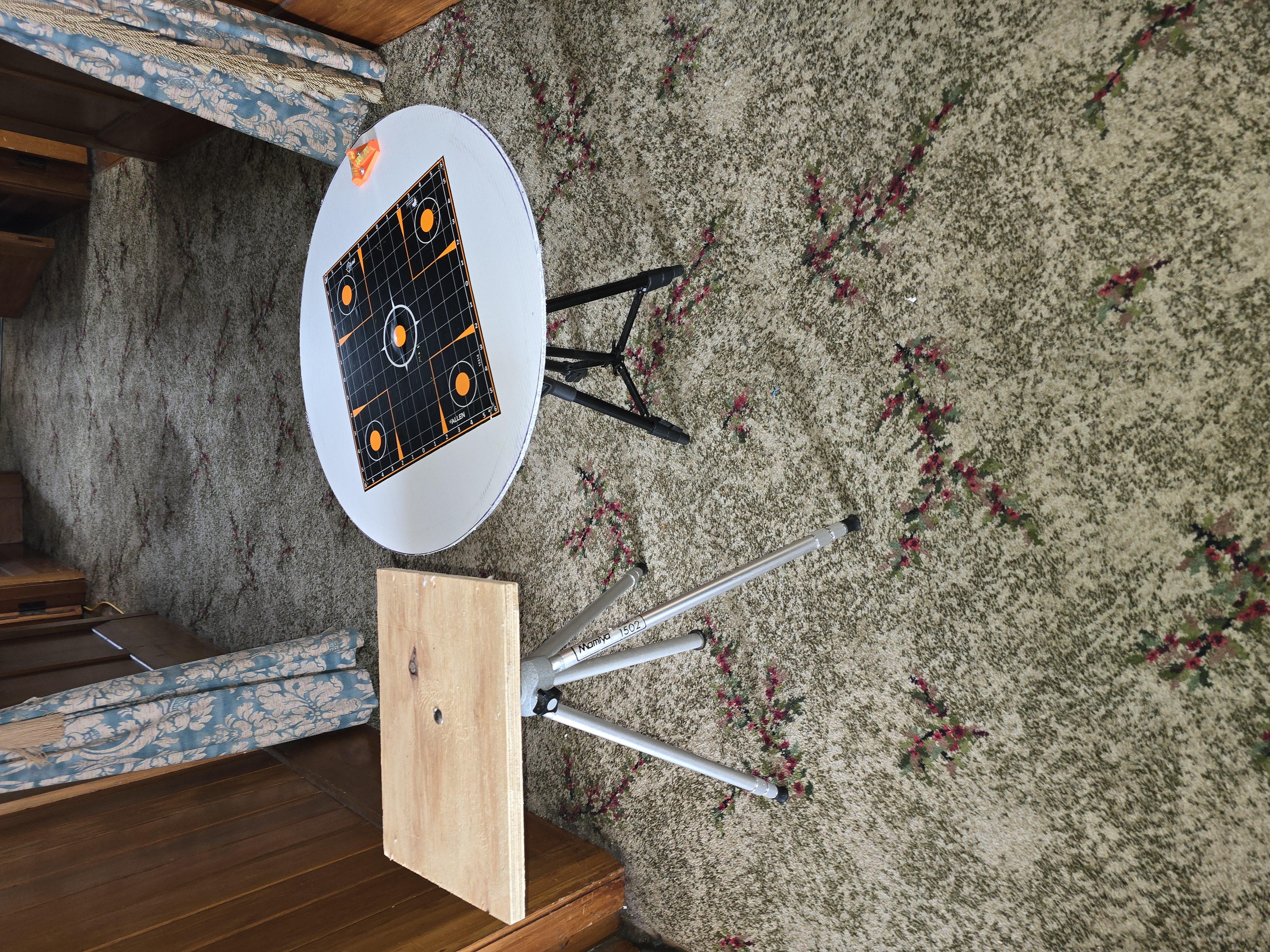

Have made a take off and landing pad with materials I had on hand and just about to finish a stand to sit the drone on near to the targets..
Flight time is only 30+ minutes but by placing the drone near the targets on a pad, it should last a lot longer.
Heres a pic of the drone in its case.....
And a pic of the 2 stands I made. Both stands were made from old camera tripods I had laying around....the grass at the range is knee high and they are adjustable for height to get them above the grass. The landing pad has a built in level which was only $3.00 and the only thing I had to buy. the 'viewing' pad just needs a little more work at this stage....

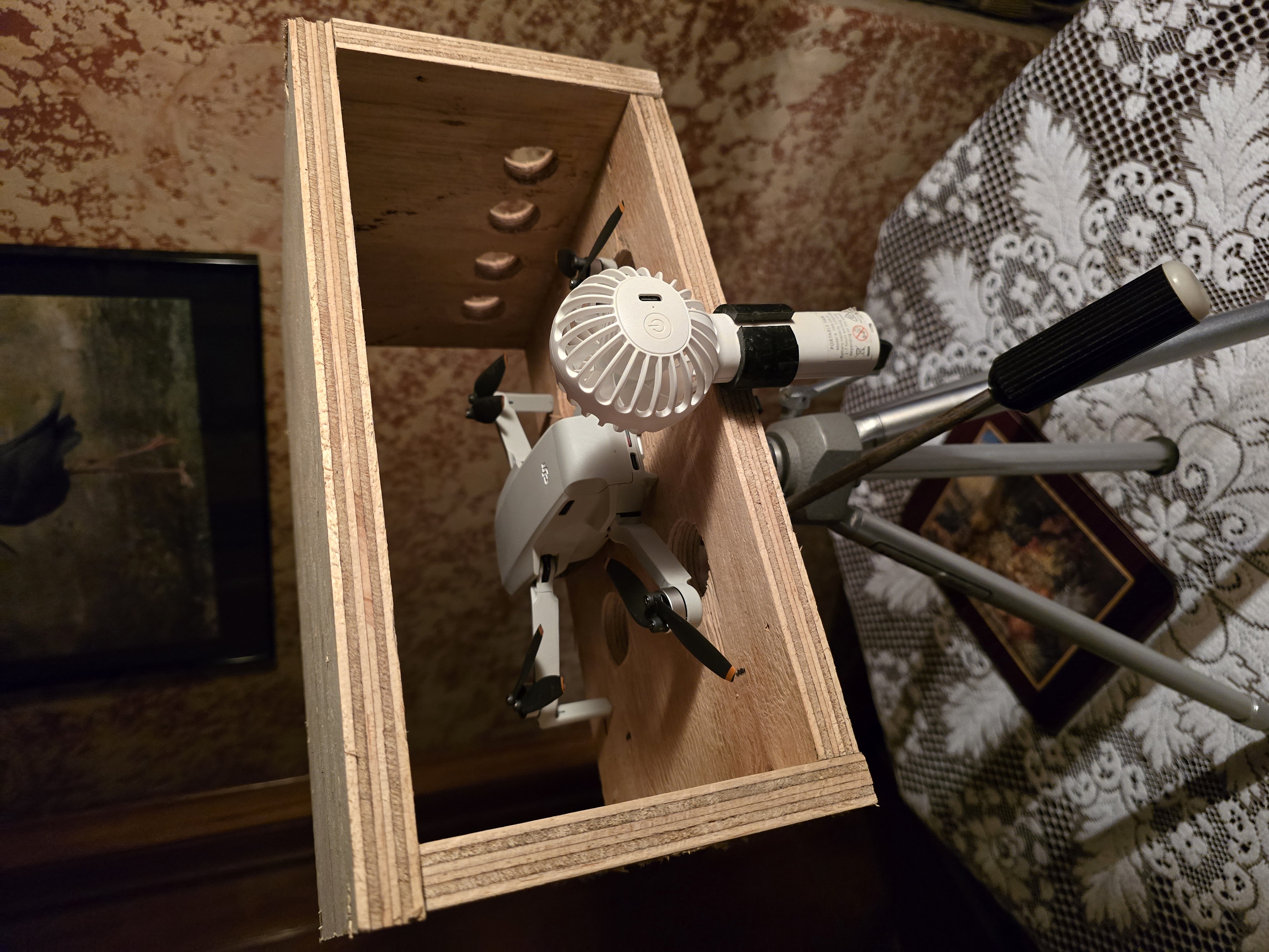

Update on progress.....
Did some research and found out that there may be a problem with overheating if the drone is 'live' but not flying...apparently they do get hot when the battery is discharging and the air movement as it flies keeps the temp down...
So, I adapted the flat platform to this.
Had to spend more money and buy a battery fan for extra cooling......cost me $10 for a rechargeable fan....
Hopefully will get out tomorrow if the crappy weather changes and give it a test but the forecast doesnt look good so far..
Total outlay so far is $13.00 for the landing pad and the 'observation platform'.
