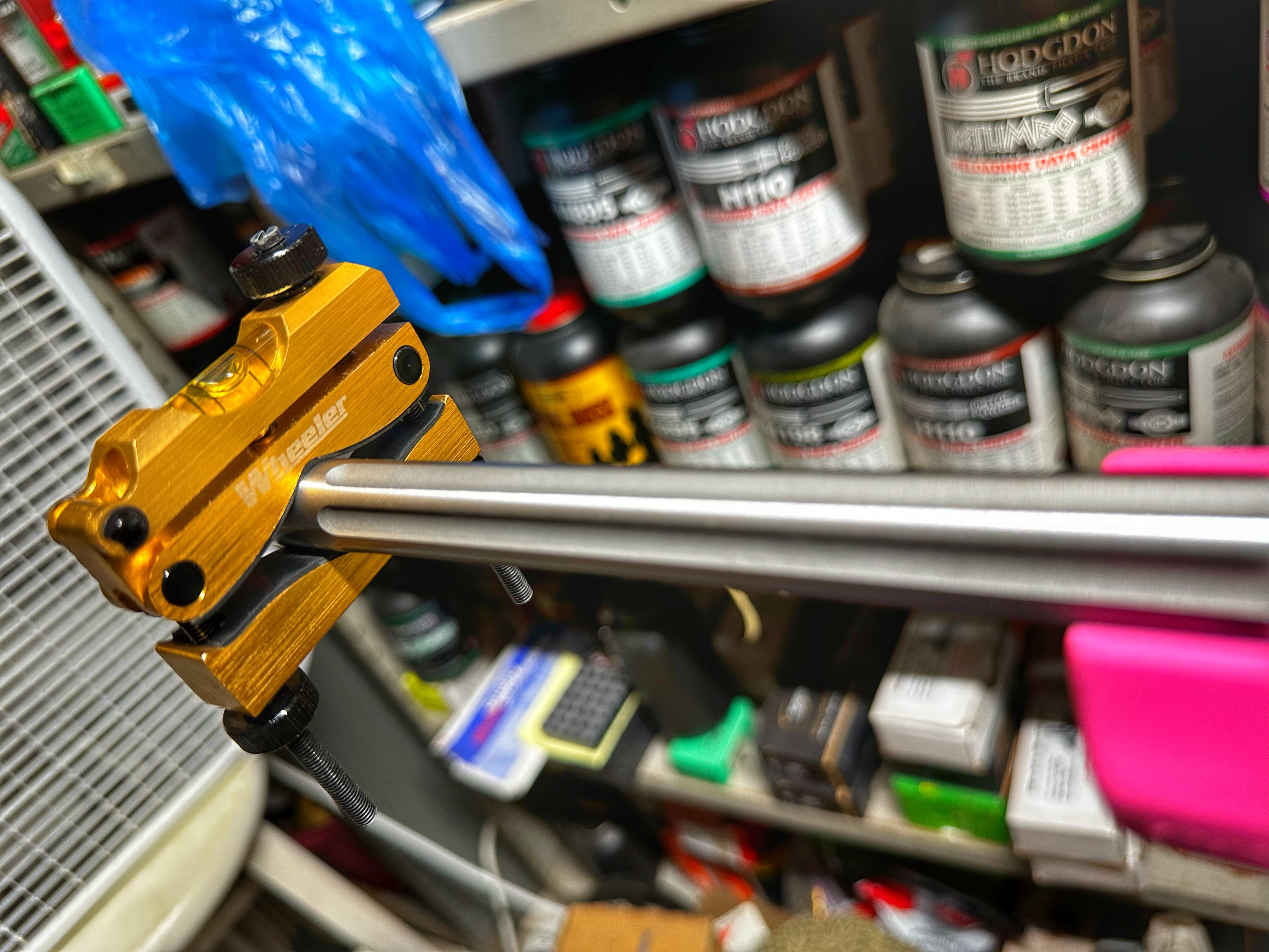

You may recall my friends Ruger 10/22 going to hell in a hand basket as to accuracy and the process I went through to trouble shoot the issue. He decided to just get a new barrel and here we are.
The following will be a photo montage of my “break-in” process of cleaning, lapping and installing the barrel. Not pictured, I also used BoreTech solvent to clean between series of diatomaceous earth.

If you have any specific questions as to the pics, please ask.

Can you offer some specifics regarding your lapping process? What sort of pads / pellets are you using and do you use something like JB bore cleaner that has the earth stuff in it or are mixing your own brew?
Lapping in one direction?

Re: Ruger 10/22 Green Mountain Barrel - Installation & Break-In (Photo Montage)
Posted: Sun Aug 06, 2023 12:13 am
jkp wrote: ↑Sat Aug 05, 2023 10:06 pm Can you offer some specifics regarding your lapping process? What sort of pads / pellets are you using and do you use something like JB bore cleaner that has the earth stuff in it or are mixing your own brew?
The felt pellets I use are VFG Pellets (.22cal).
I clean the barrel, before ever shooting, with either Shooters Choice/Kroil Oil 50/50 mix or with BoreTech Eliminator and the VFG Pellets. Once the pellets come out clean, I use Remington 40x Bore Cleaner which contains a lubricant (RemOil?) and Diatomaceous Earth (mild abrasive) and the VFG Pellets. I pass the pellet end to end and the first one always meets with noticeable resistance and comes out almost black. Pass back and forth until the pellet loses its resistance. Clean the barrel and push a dry pellet through.
I repeat the process noticing the resistance lessens and lessens and the pellets come out less black.
It’s a “feeling” process and how clean the pellets end up to know when I’m done. Pretty much, when I don’t feel noticeable resistance as compared to the start, and the bullets aren’t black, I’m done.
Then, I clean the barrel again and dry run a pellet through it until it comes out clean. Then, I shoot as normal.
I do this to all my new barrels. I can’t prove it helps. But, it hasn’t hurt and the accuracy is usually stellar. 🤷‍♂️
I don’t drink barrel break in KoolAid. But, this pre-shooting cleaning/lapping process has never screwed me.
I don’t do any other shoot/clean break in afterwards. I just polish the barrel before I ever shoot it and then run it like I stole it.

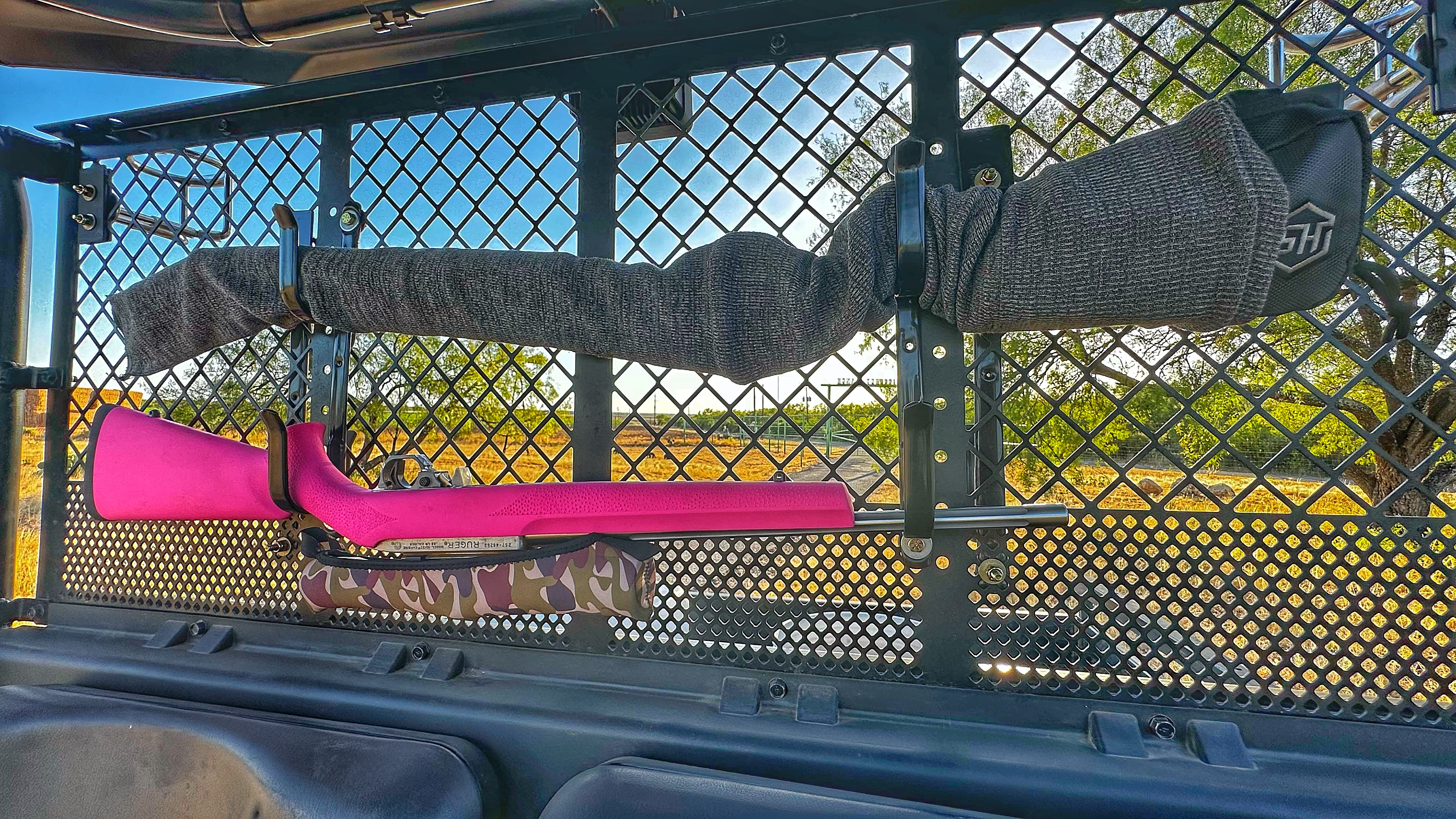

The Ruger is back in its rightful place in the Kubota. Riding behind me doing ranch work and earning its keep on an almost daily basis.

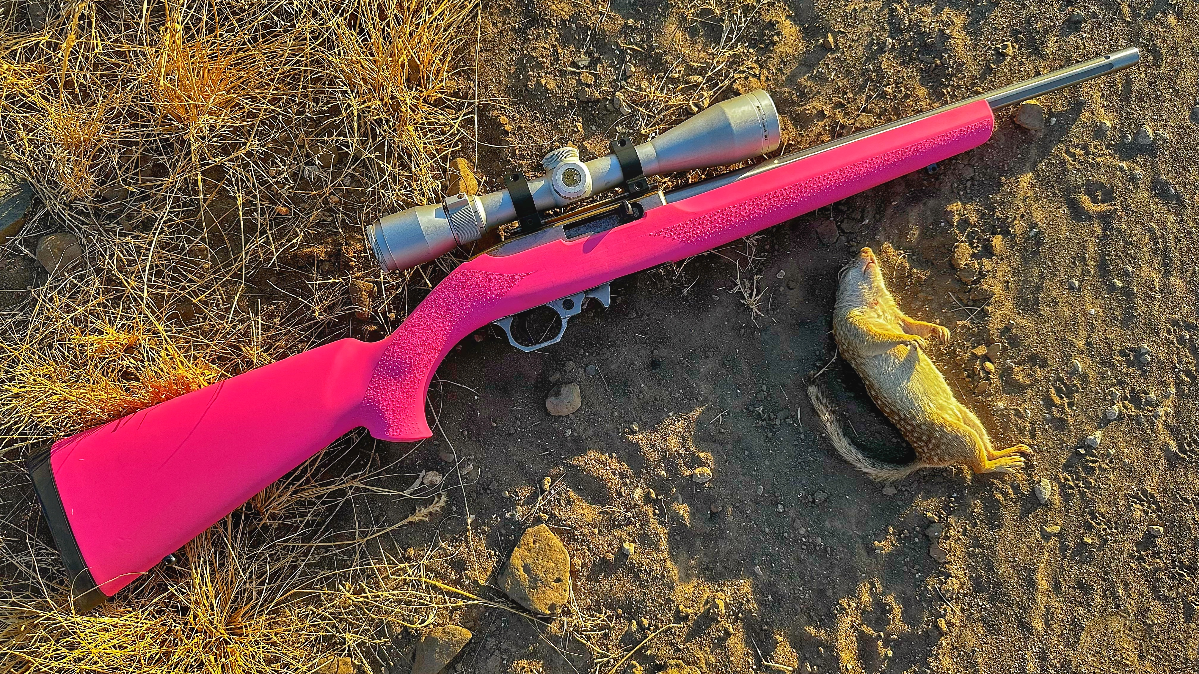

She works!! Ground Squirrel for the pot.
10yrds just under the chin.
Holy Crap!! Those 36gr Remington HVHP bullets make an EXIT hole!!
I may have to reconsider and use the 40gr SVRN if I want to eat anything I shoot.

I wonder if riding on the barrel in the rack does something to accuracy over time?
Posted: Sun Aug 06, 2023 4:27 pm
I wouldn’t think so. Maybe. It is an aluminum receiver. It’s ridden that way ever since I’ve known my friend. If it damaged the receiver over that time, I don’t think the new barrel would work either. Assumption on my part.
