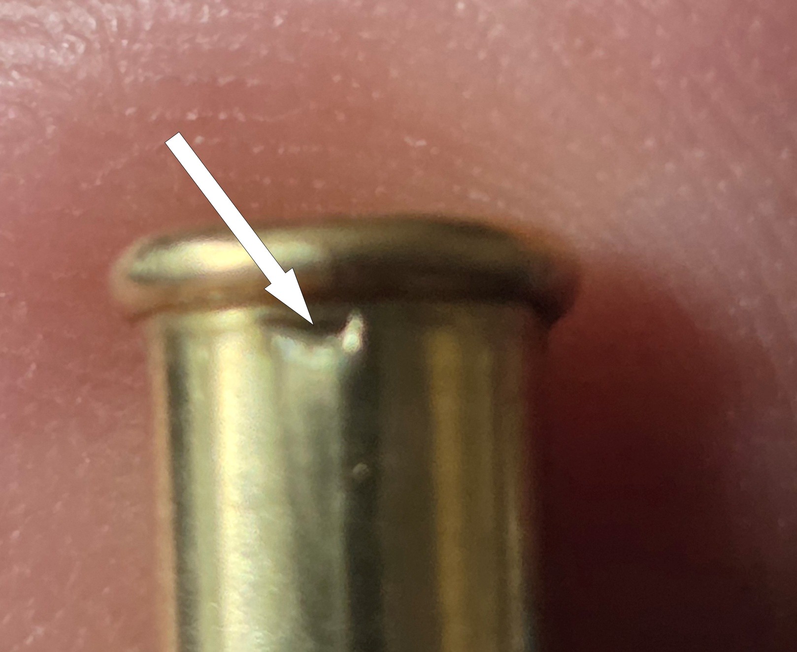

Some history of what it does doesn't do or seem like so far.
It will load feed and eject unfired rounds perfectly.
A loaded round slides right in the chamber with no resistance or binding....doesn't feel peened from dry firing
The ejectors seem fine.
The Firing pin strikes are very strong.
Perhaps too much so ?

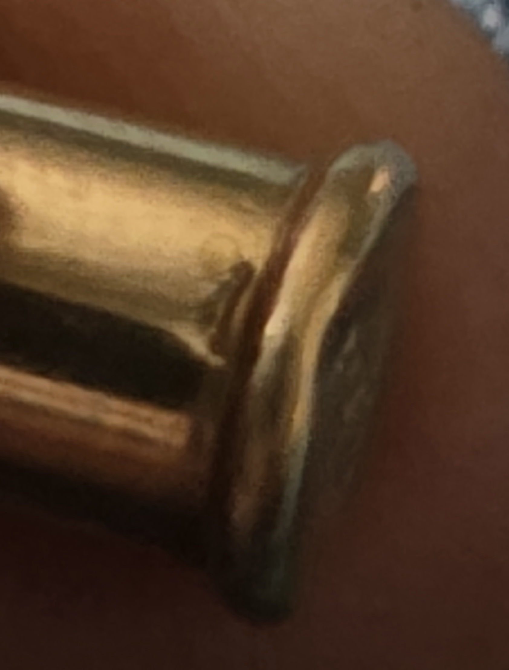

A fired case showing the backside of the rim and firing pin strike not sure what the backside cause is ?

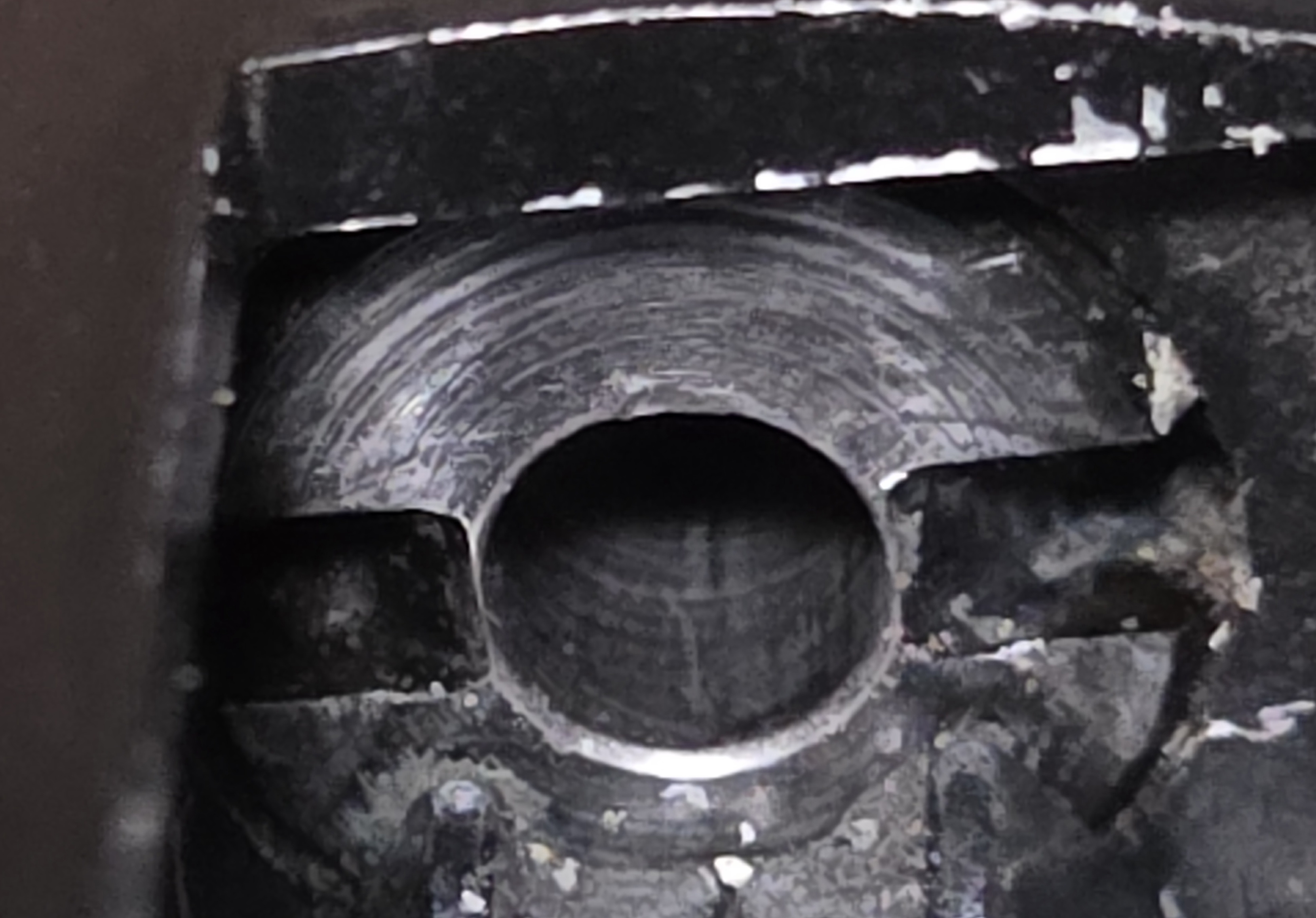

I'm pretty sure the chamber's been peened from dry firing.
This mark, aligned with the firing pin strike on the rim, seals the deal for me

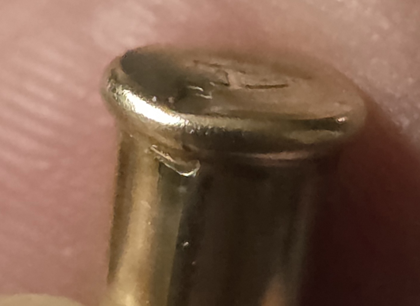

Have another look at the first pic showing the firing pin strike on the brass.
The top is scalloped and does not contact the full rim.
That indeed may have been caused by dry firing.
I looked for a spent 22 brass but didnt find one in my bag. But look at one from another gun you will see a sharp rectangular indent that covers the entire rim. If dry firing it will be the outer edge of the firing pin that takes the damage from striking the face. Could be 2 problems. Firing pin and chamber breach.

Enlarging the first pic of the chamber you can see the peened area at 12:00
Re: Help diagnosing the lever 22 problem
Posted: Sat Mar 14, 2026 9:44 pm
I would agree, dry firing damage to the chamber and firing pin. The pin doesn’t deform the rim of the case, all the way pout to the rim. The pin should be flat all the way to the top edge. The picture of the chamber seems to show a little deformation.
