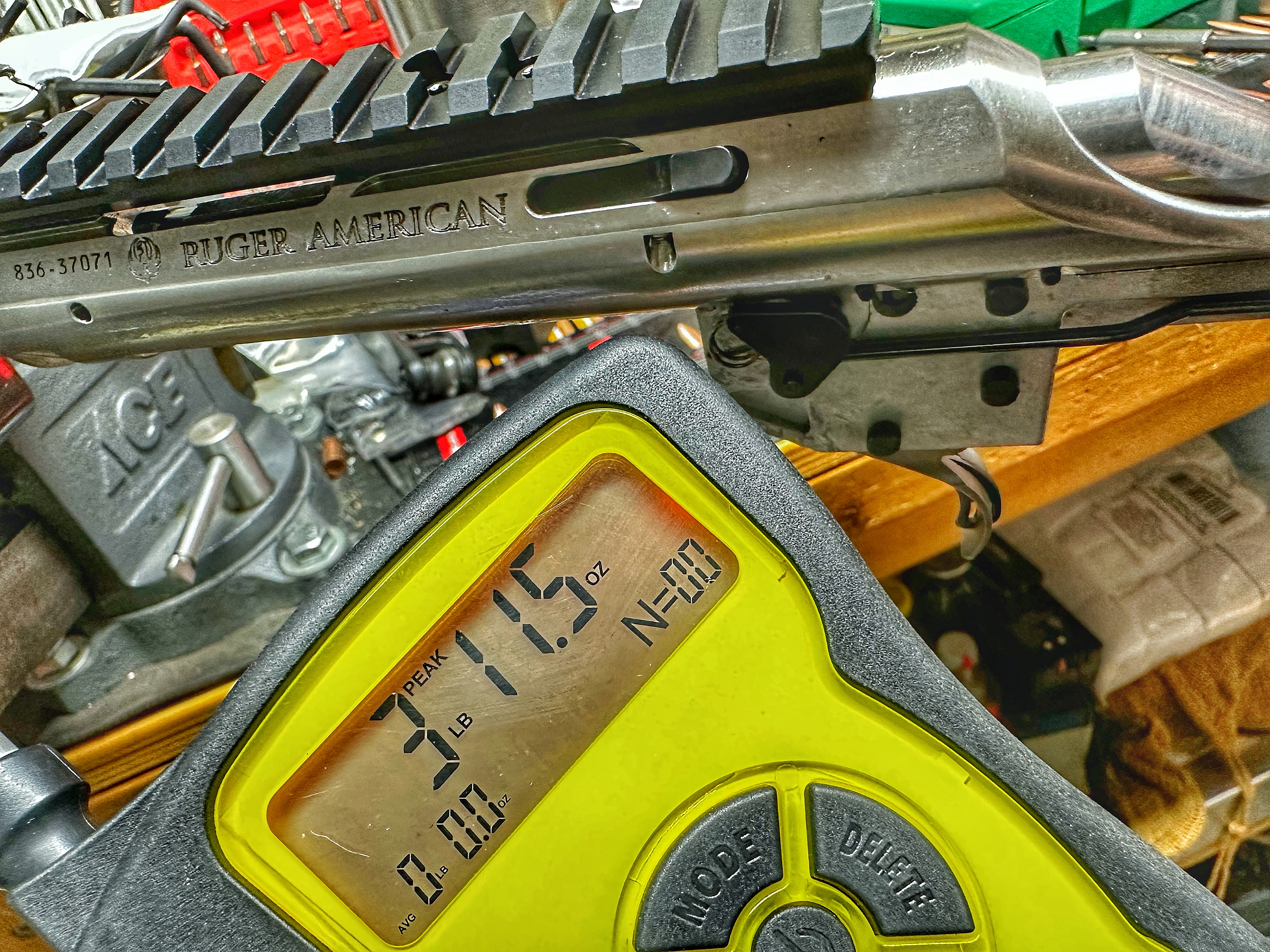

First task was a trigger job. YouTube to the rescue as the factory setting was 3.11 pounds.
Following the video, I was able to adjust the trigger pull to an amazing 6.9 ounces!!!

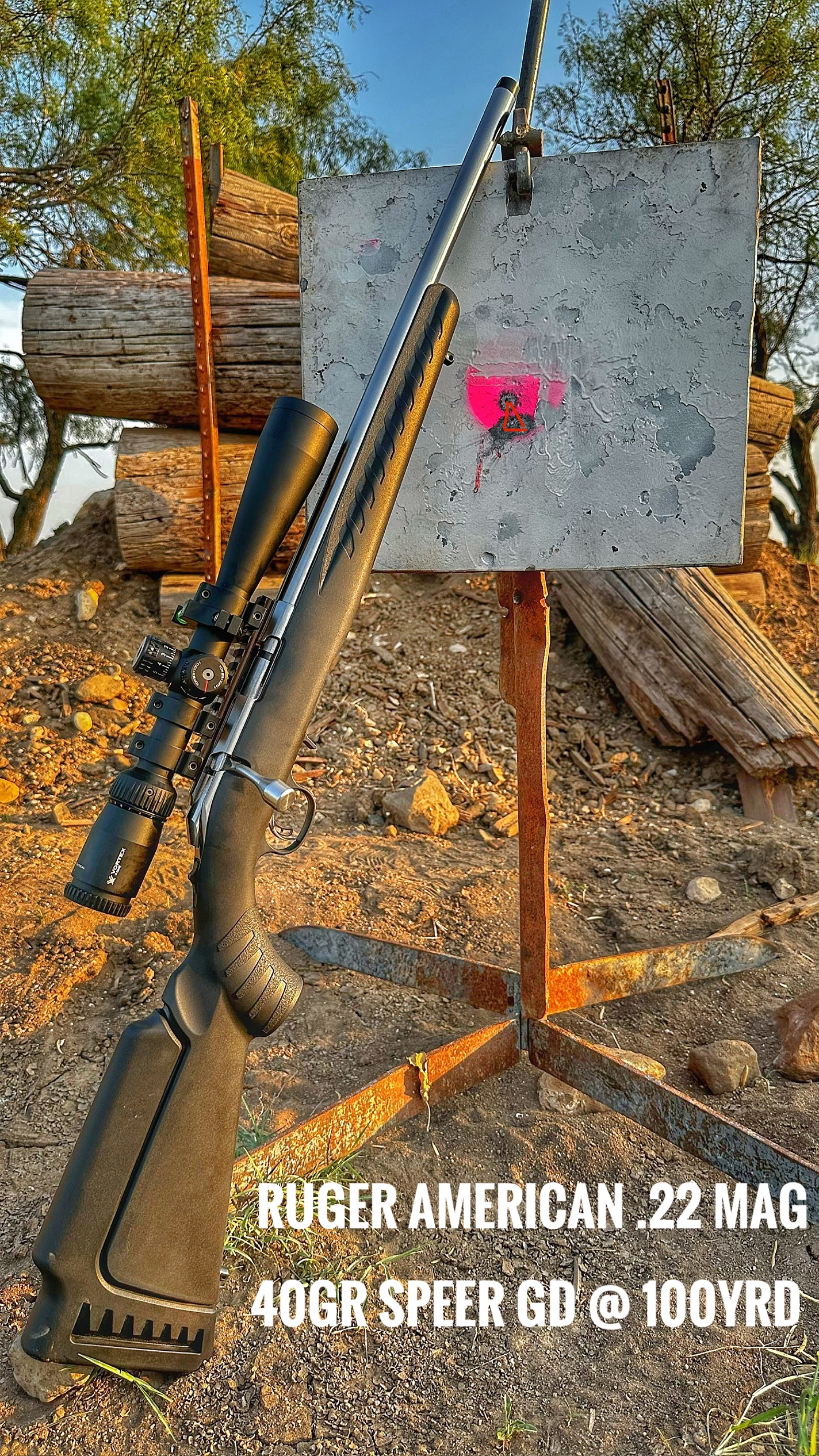

Intended to test two loads.
30gr Hornady V-Max
40gr Speer Gold Dot

Results were surprising.
I expected this to be the winning load, but the rifle had other ideas.
So I ran the Speer Gold Dot out to 100 yards and it continued to perform.

jkp wrote: ↑Wed Jun 21, 2023 1:09 pm What did you do to the trigger to get it that low?
Remove the receiver. On the right side of the trigger housing is an E-Clip. Remove that and then push the trigger pin out. Gently pull the trigger out making sure not to lose the small return spring in the trigger you’re removing. Inside the housing you will see a large horizontal trigger return spring. You can reach in with a flat head screwdriver, push it into the coil and then remove the spring.
Place the trigger back inside, return the trigger pin, and then the E-Clip. Seat the action and voila!!!
