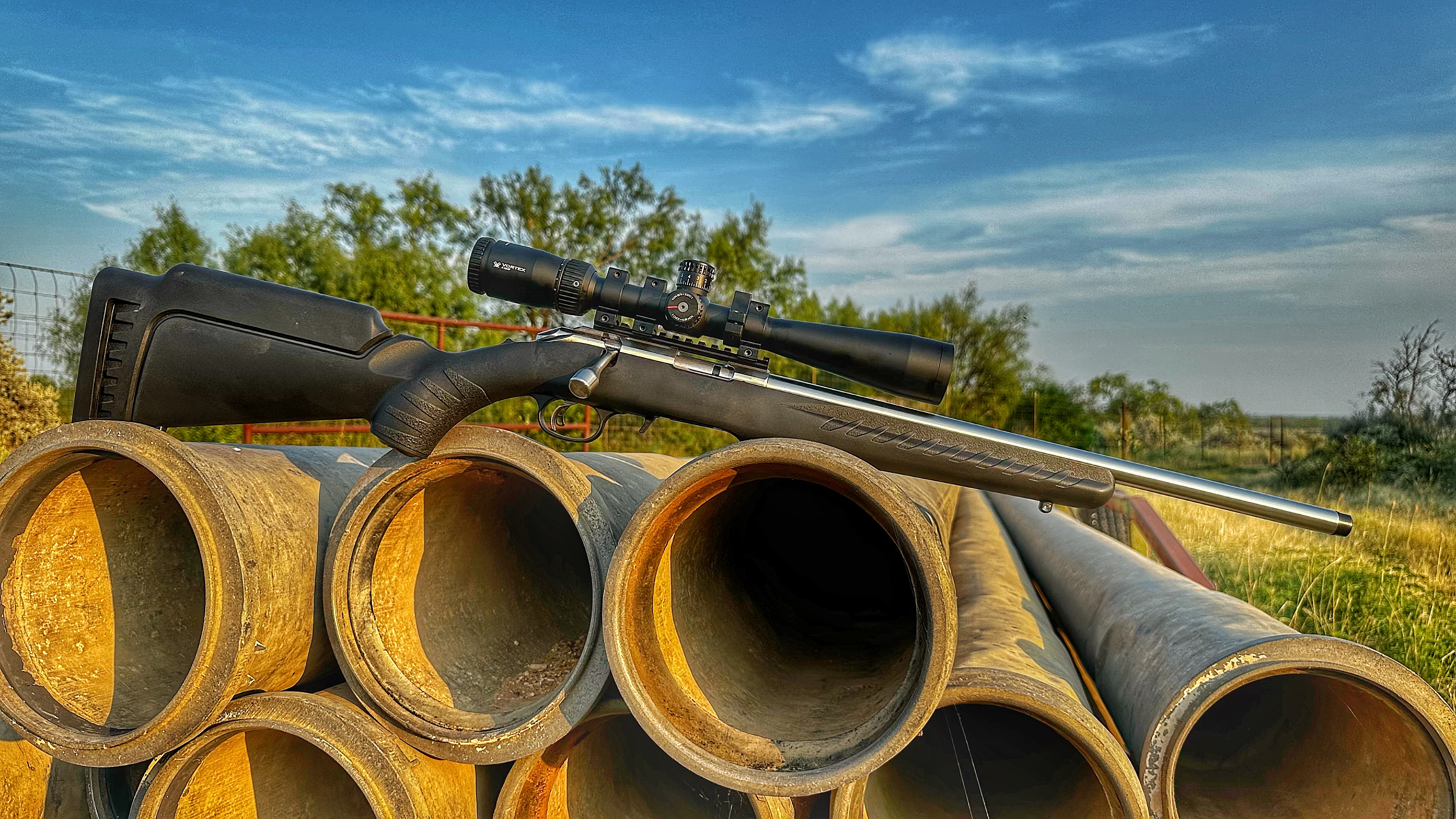

Got my Ruger American Rimfire last week to utilize as a Ranch Rifle with reach that won’t blow my ears out or require a suppressor.
Goal was something to use on Varmints that wasn’t overly expensive, could weather the bumps, bruises, and weather of life in a UTV, and get me to 150yrds with out blowing out my ears.
Enter the Ruger option.

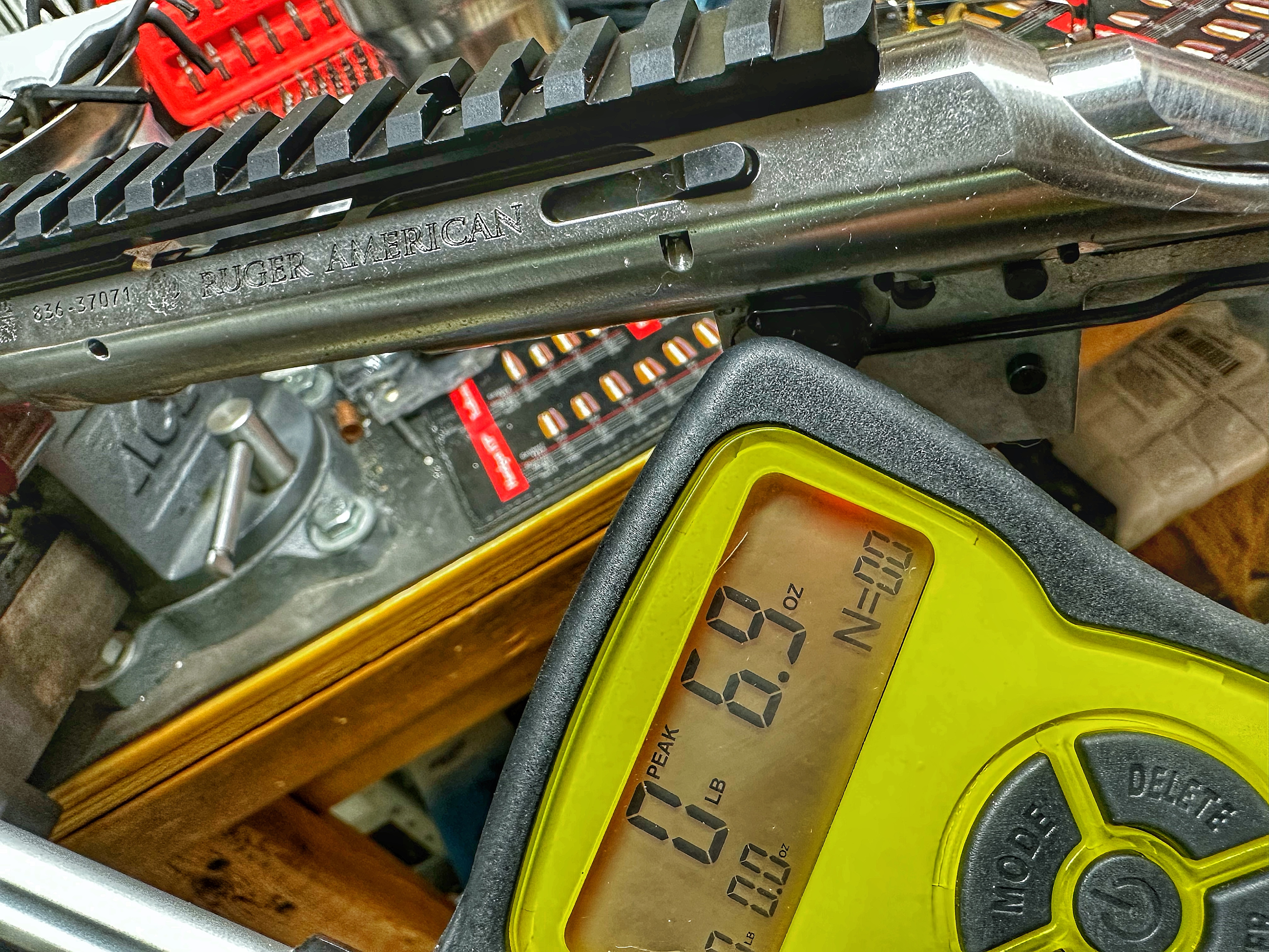

First task was a trigger job. YouTube to the rescue as the factory setting was 3.11 pounds.
Following the video, I was able to adjust the trigger pull to an amazing 6.9 ounces!!!
Mounted a Vortex Diamondback 1” tube 4-12x. I won’t spend much time on this. But, I would never buy another one of these scopes. Narrow FOV, coarse reticle, and I can’t get the reticle and target in the same parallax plane. But, not wanting it on any other rifle, a low use, hard life…….No tears shed.

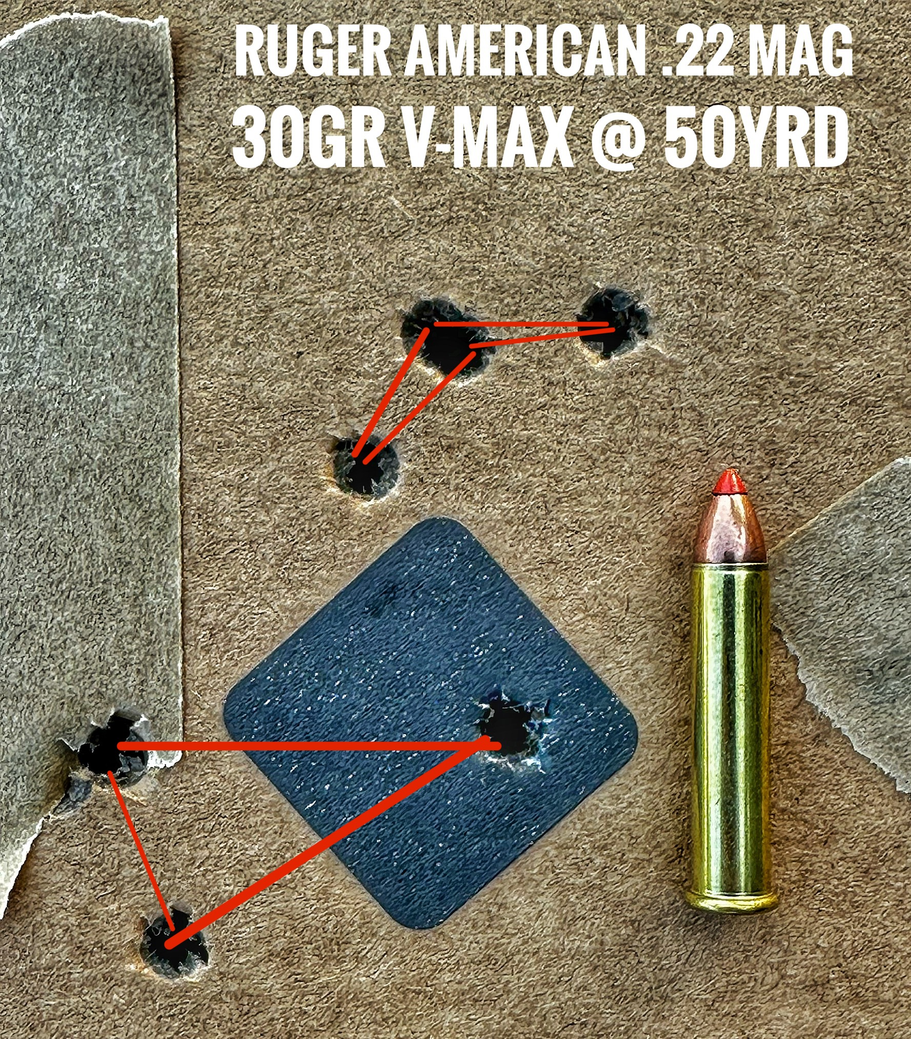

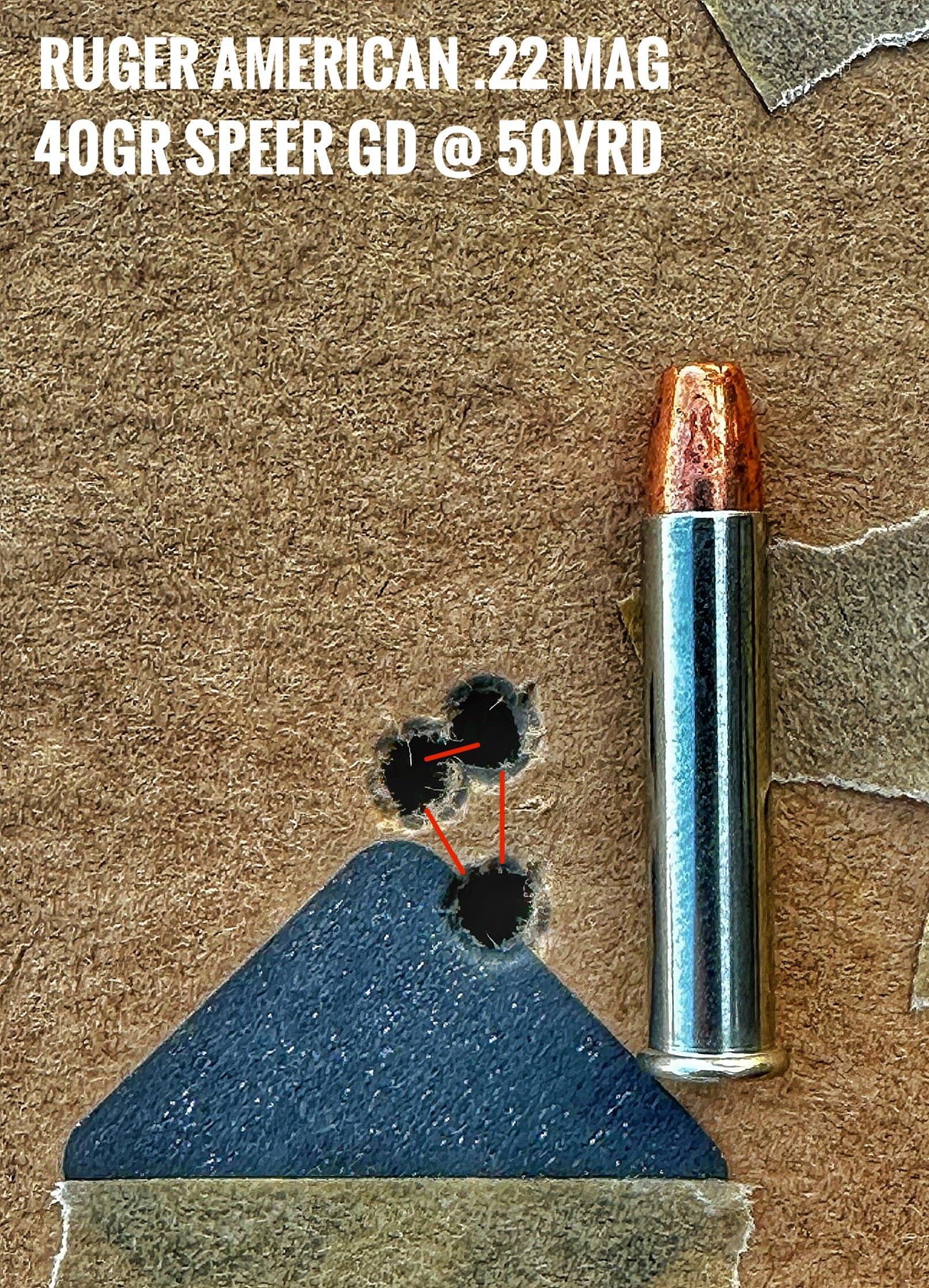

Intended to test two loads.
30gr Hornady V-Max
40gr Speer Gold Dot
First let me say, the trigger job is amazing.
Next, the factory stock sucks. I have another Ruger American Ranch Rifle in .223 Remington that accepts AR mags and that barrel is free floated and the rifle amazing.
This stock is warped and touched on the left side of the barrel. The action has been removed and reattached twice with no reprieve. If you grab the Forend and place any pressure, the Forend torques in multiple directions.
Regardless, on the bench, with the front rest placed close to the centerline of the stock and not out front, there is little influence.
Results were surprising.
I expected this to be the winning load, but the rifle had other ideas.
So I ran the Speer Gold Dot out to 100 yards and it continued to perform.

What did you do to the trigger to get it that low?

jkp wrote: ↑Wed Jun 21, 2023 1:09 pm What did you do to the trigger to get it that low?
Remove the receiver. On the right side of the trigger housing is an E-Clip. Remove that and then push the trigger pin out. Gently pull the trigger out making sure not to lose the small return spring in the trigger you’re removing. Inside the housing you will see a large horizontal trigger return spring. You can reach in with a flat head screwdriver, push it into the coil and then remove the spring.
Place the trigger back inside, return the trigger pin, and then the E-Clip. Seat the action and voila!!!
