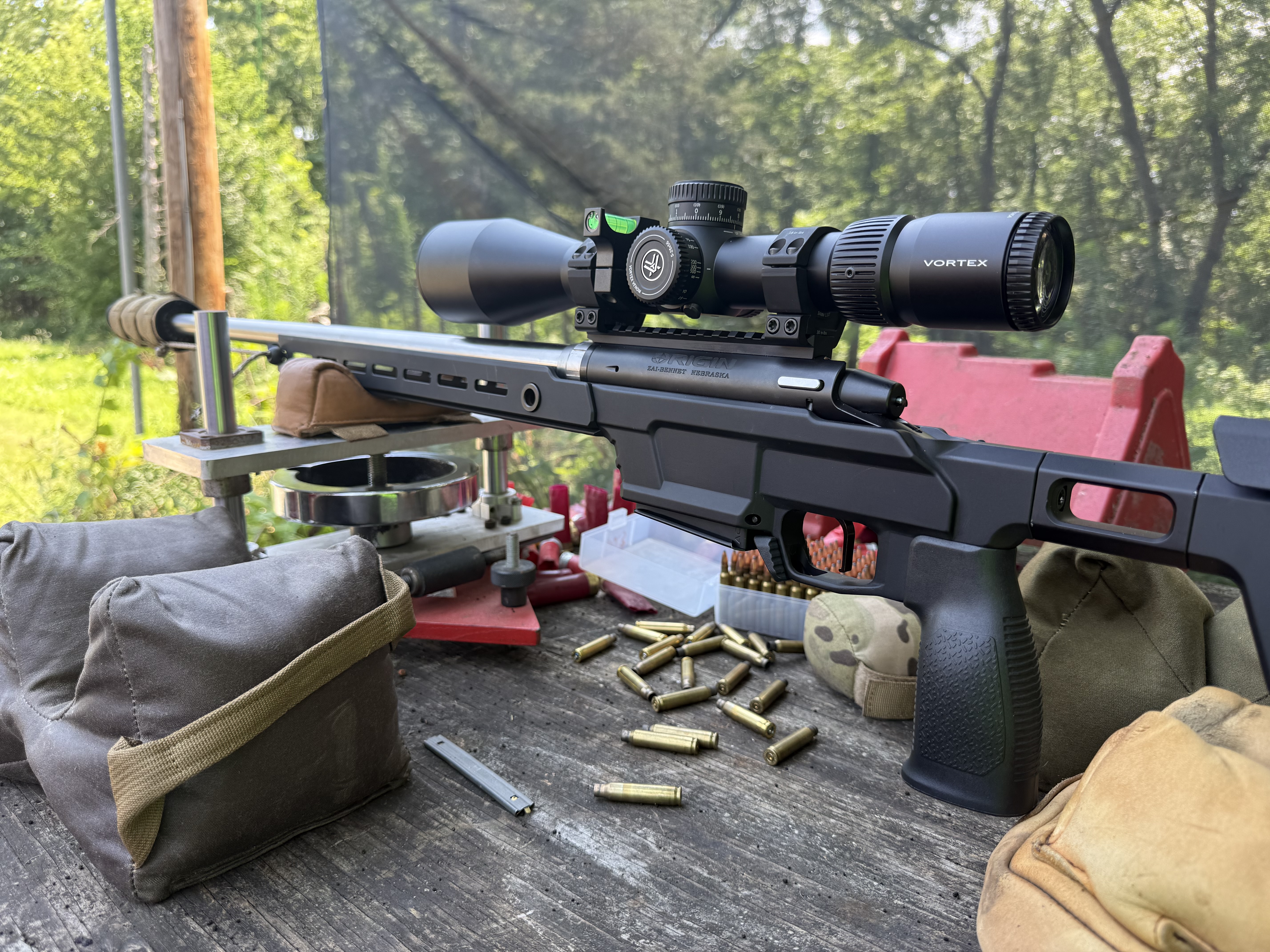

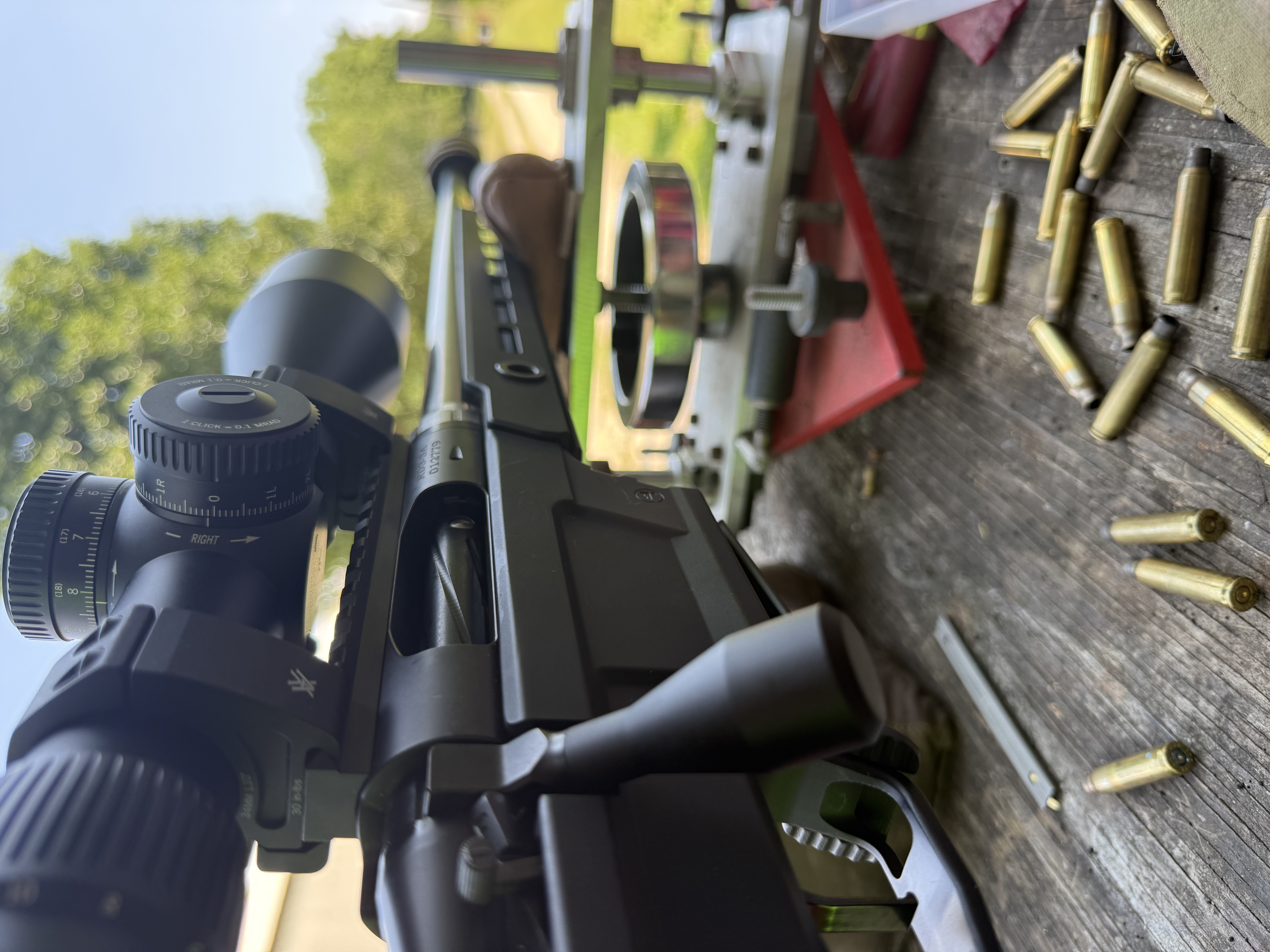

Don’t ever shoot a custom action. Unless you want to buy one. I knew better. But did it anyway. Groups were meh, but it was also some random crap I had on the shelf. I’ve got new brass and bullets, but needed to celebrate F U “king” George day and didn’t have time to load.

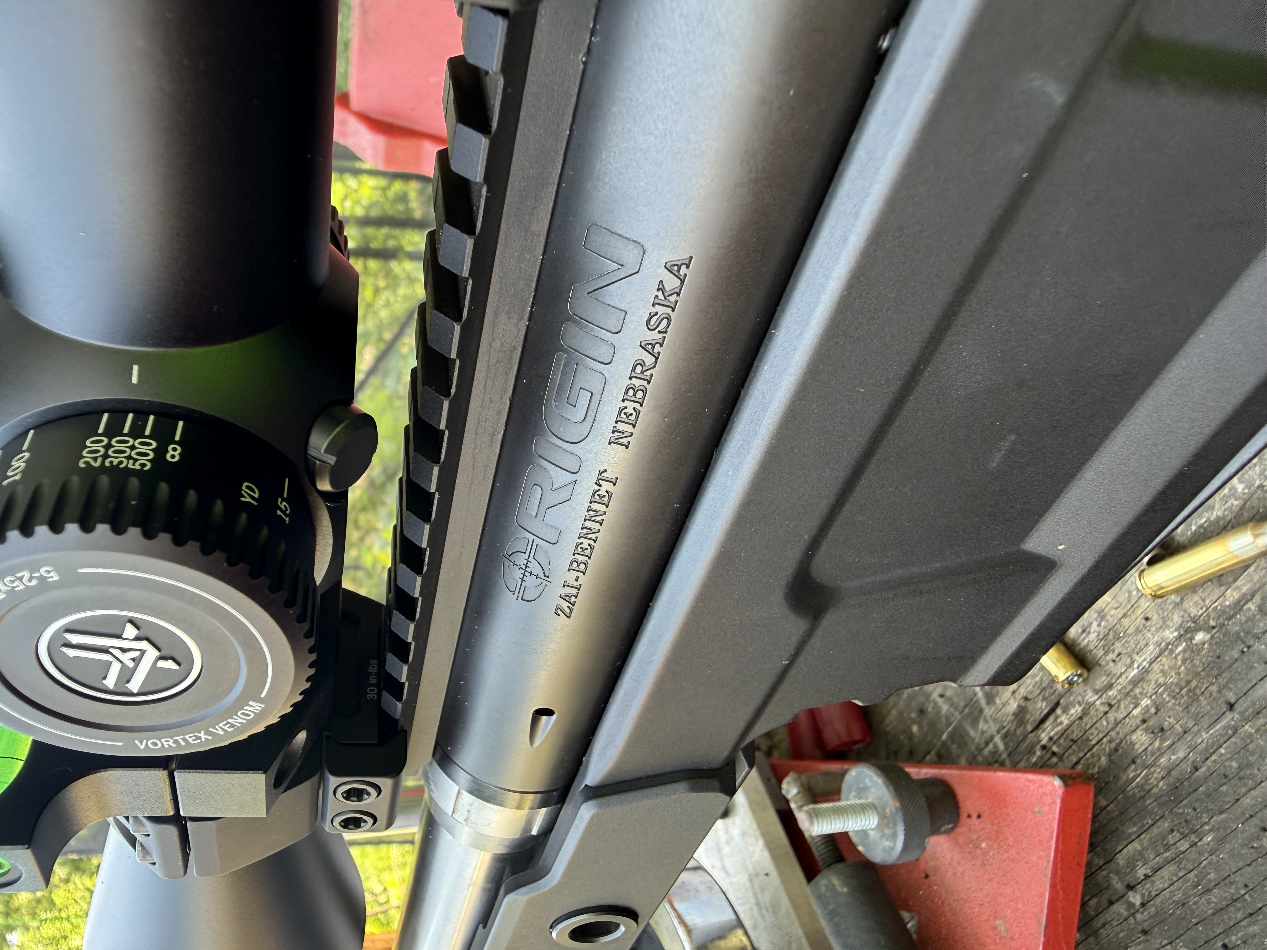

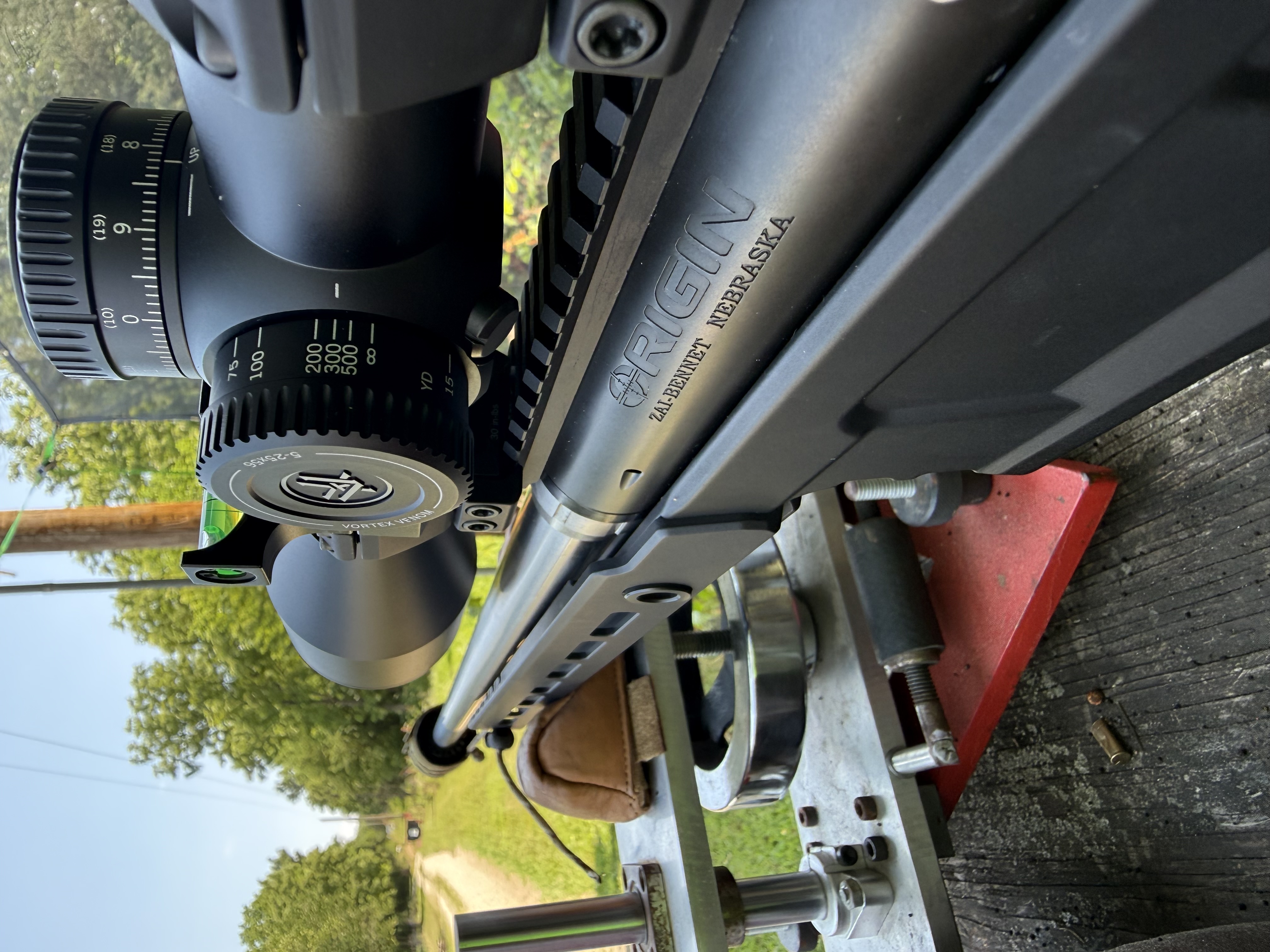

It’s a Zermatt Origin action in an Aero Solus chassis. Trigger tech primary trigger, 1.5-ish pounds. I would prefer lighter, but the way This One feels makes the extra weight not an issue. And now I can be a real rifleman because I don’t shoot a 2 ounce trigger.
Shilen 1-8 twist 223 barrel. Vortex scope. And of course a suppressor because unsuppressed guns are gay.
The action is a 700 footprint, with savage barrel
Threads and a savage style bolt head. You can swap heads at will. Modified controlled round feed, with a mechanical ejector. You ran run the bolt like you own it and fling brass away from you, or open it gently, and it will fall in a neat pile right beside your rifle.
