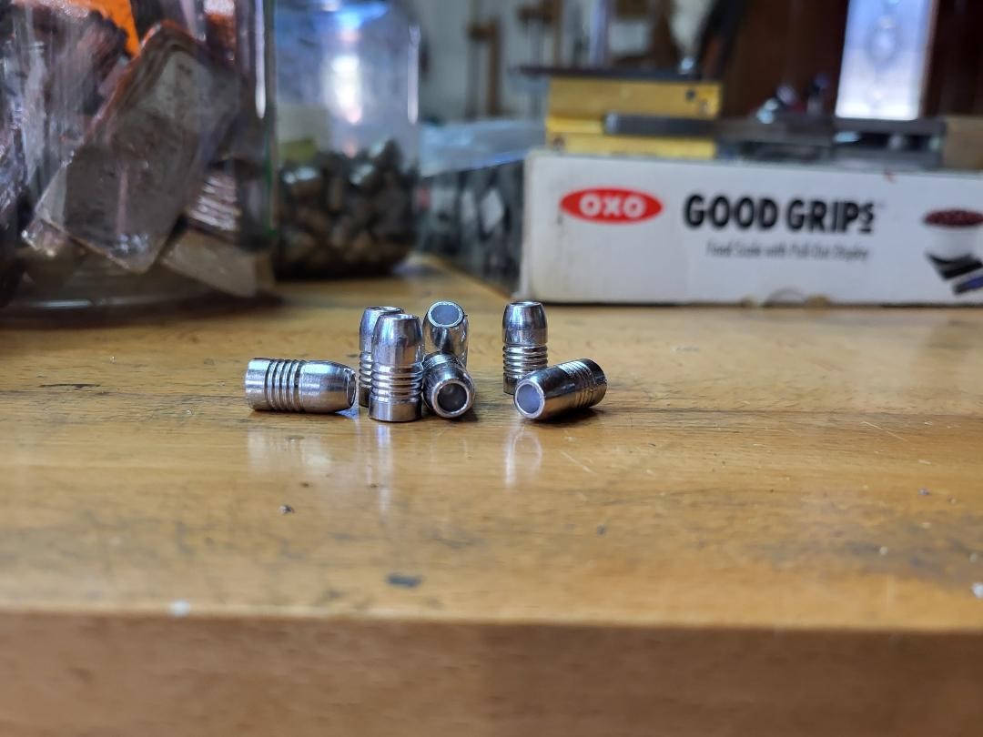

The latest chapter in my Dad's various joint deteriorations has been a surgery fusing his right wrist. Leading us to some experimentation as to what guns he can (a.) shoot, and (b.) shoot comfortably. Among other things, we've cooked up a SWEET .44 Special load and have started playing with heavy .45-70 projectiles at subsonic speeds. Today, however, we decided to play with .38's. After cranking out a bunch of 175 grain solids from a mold I recently commissioned, we thought it might be good to tinker with some HP's.
358 Ranch Dog HP's.jpeg (80.3 KiB) Viewed 4772 times
If you've ever been curious about the tech for casting a hollowpoint, this is how NOE Molds does it. Their system has a bracket that bolts to the bottom of the mold into which you insert your hollowpoint nose pin. The bracket is angled so that when the halves of the mold are opened, the pin can tilt outward and the bullet is allowed to drop off - - if all goes well. Sometimes they can stick to the pins a little, or a lot. There's a little more voodoo and chipmunk juggling involved when it comes to casting hollowpoints.
Some of the end product:
358 Ranch Dog Boolits.jpeg (104.78 KiB) Viewed 4772 times
These were cast out of the cores melted out of jacketed bullets scrounged from various range berms with a little tin added to help the mold fill out properly. There's some trace antimony on board, but functionally, it's 25-1 lead/tin with a Brinnell hardness of 9.5.
That particular mold was a initially minor disappointment because, when seated to the crimp groove in .357 brass, the front driving band was too long to chamber in the Rugers. It worked OK in the Smiths, and could probably have been made to work in the Rugers with a trip through a sizing die, but that would have defeated the purpose of buying a tumble-lube mold. Thus, it's pretty much a .38 Special brass only proposition if I want a round I can shoot in anything. Since Dad's looking for comfort cartridges, this isn't a problem here.
Goal is to see what the velocity range is for expansion with this thing. Hopefully, this occurs without needing to get into +P pressure levels, but I ain't holding my breath. The Science will tell...
