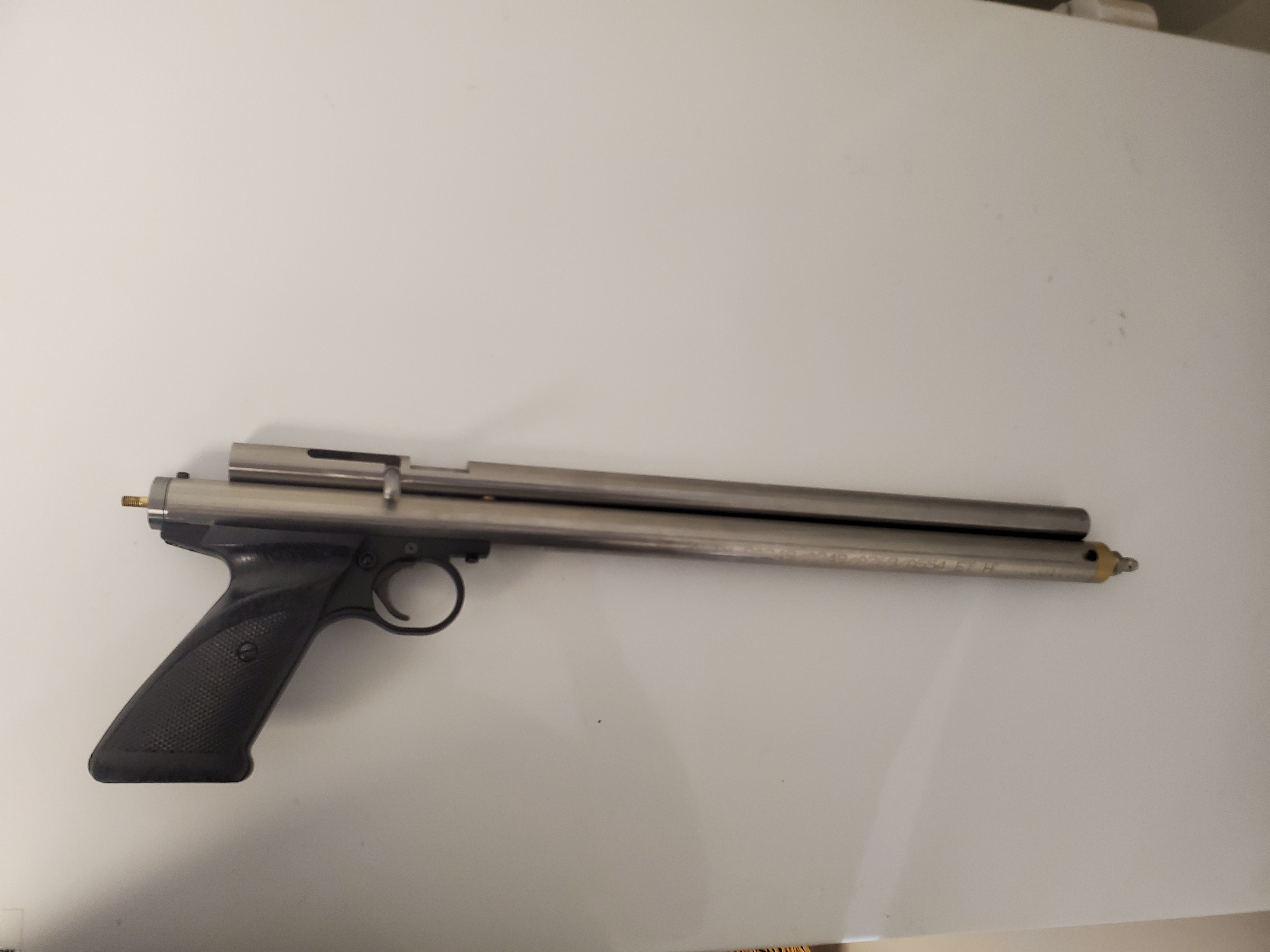

Used the typical crosman grip/sear assembly as usual. I still have to make a cocking knob for the rear and the rear portion that ties the back of the breech to the lower pressure tube so it doesn't have that gap. I've been pulling 148 grain bullets from some 38 special that were given to me to use as test fodder and I've only tested it to 1500psi and it's pushing just under 800fps! Increased pressure should exponentially increase velocity but I'm pretty happy with its performance as of now and I've not tuned it yet.

Well, either way I hope it got your attention. I made another one but a pistola in 357 caliber and using my new valve that I really really wish I could go into details about but I cant,, for reasons

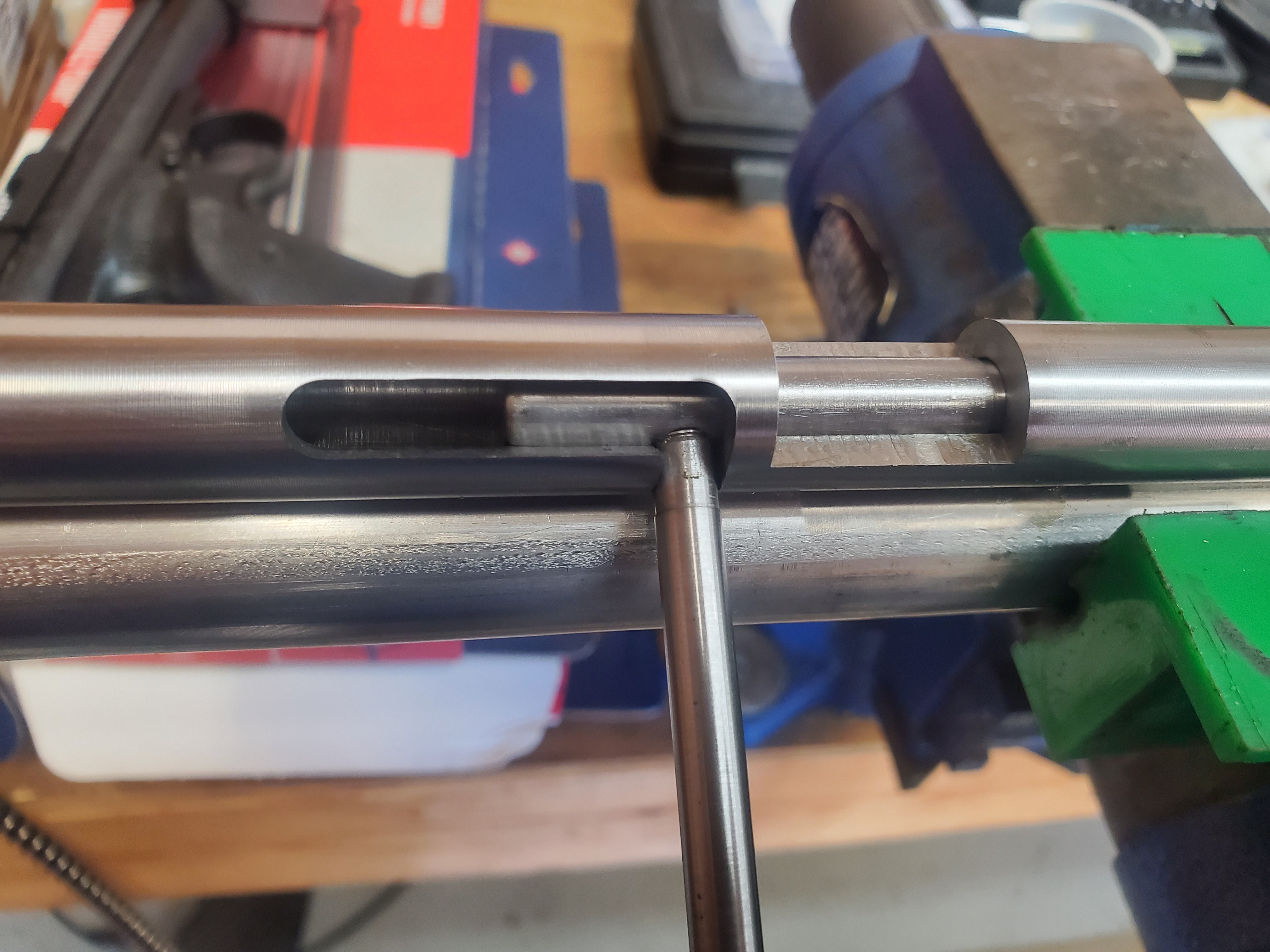

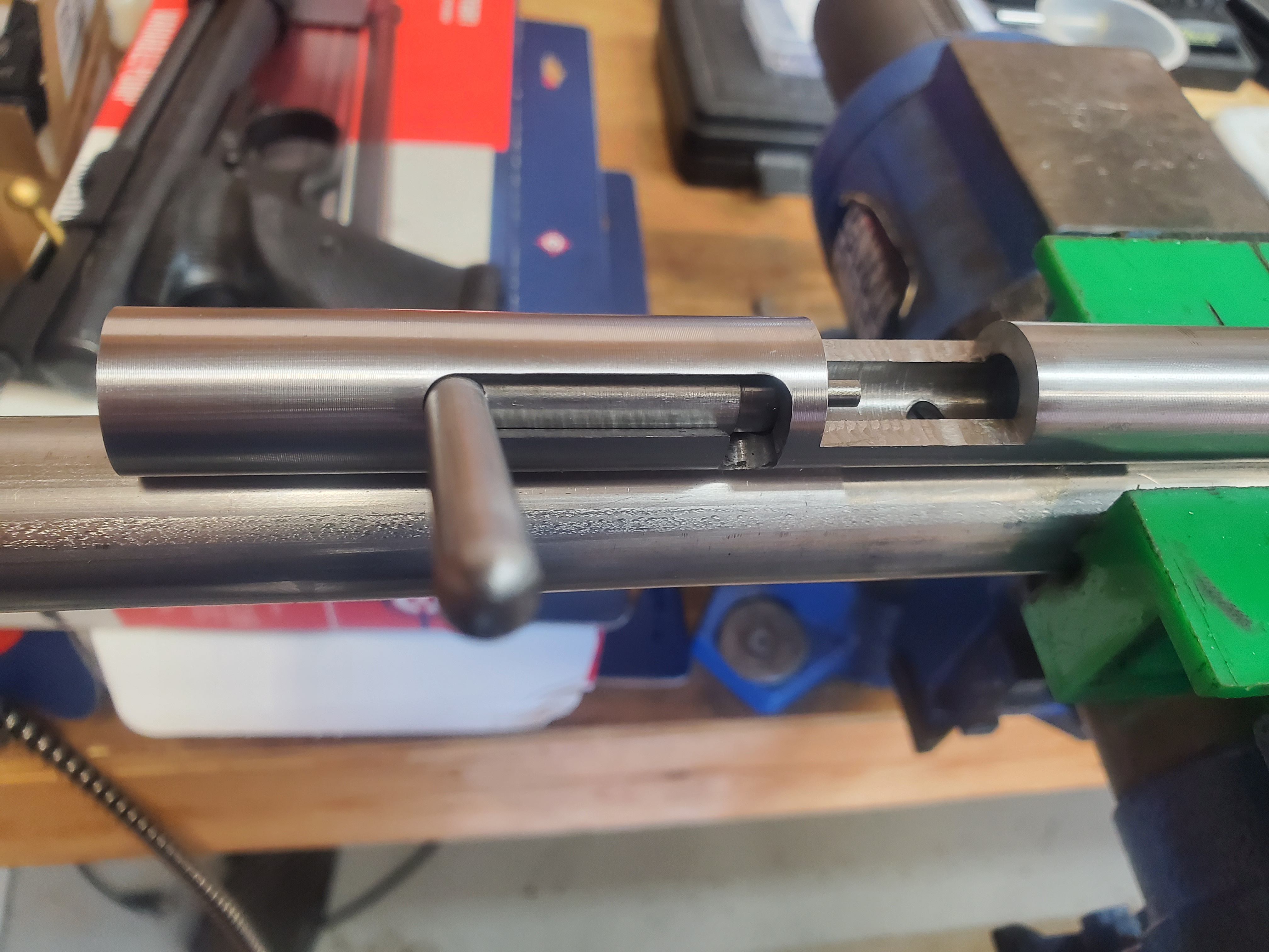

. As usual started with a Green Mountain barrel blank and machined the breech into it and added the bolt probe which I machined to have an integrated o ring that seals the chamber.

That is one interesting pistol. How loud is it when fired?

It's definitely not backyard friendly being that it dumps alot of high pressure really fast. It's probably about like it's powder burning counterpart.

Ah, well in that case I retract my statement. I'll also add as a response to the weight of it that it's not very heavy at all. It looks cumbersome but even my wife held it up and said "wow, it's actually very light compared to how it looks." There's probably a good joke in there somewhere
If you get on YouTube and search airguns, or especially PCP airguns, you'll see how big the airgun community is. I'm drawn to doing things that are over the top or shouldn't be possible. I also just love building my brain childs.

Beautiful machine work! (As usual)

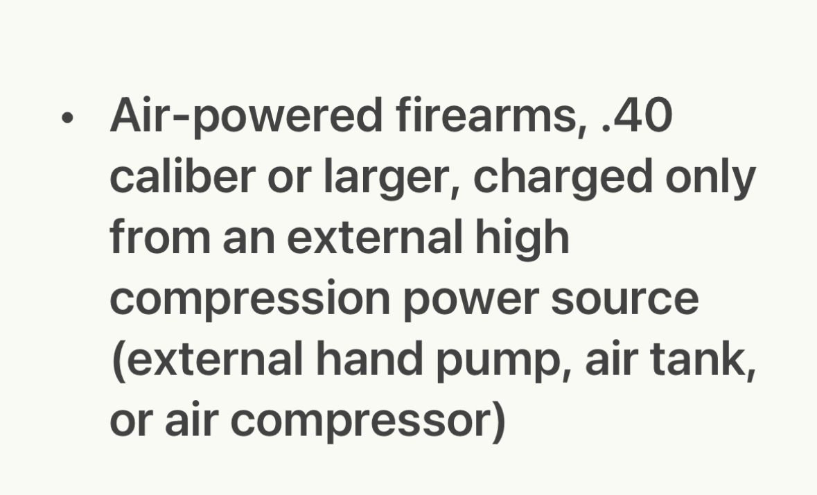

Not sure there is a FPE requirement in Missouri, but it must be at least .40 caliber. Off to GooglesJustsomedude wrote: ↑Mon Aug 21, 2023 3:37 am I appreciate the compliments. And Sako, no rush on anything. You really don't owe me anything but if you'd like and get the time, then I'll happily ablige your generous offer. I still have some kinks to work out with the pistol like increasing the shot count and somehow regulating each one but I have some ideas. Apparently if I can get over 200fpe, I'll be in the legal territory to hunt game bigger than rabbit and squirrel lol.

How far off are you from 800 fps with those 148's? I mean, 780 fps puts you at about legal territory.Justsomedude wrote: ↑Mon Aug 21, 2023 3:37 am Apparently if I can get over 200fpe, I'll be in the legal territory to hunt game bigger than rabbit and squirrel lol.
It's also possible that by using a lighter 125 grain bullet or something close to that, you could be over that 200 fpe mark already.

Well, back to the drawing board. To answer the above question, and I didn't even try the math on fpe yet because I was just assuming that it wasn't at the 200fpe mark yet, but my shots were between 789 and 798. So now that I actually used the online calculator I see that I'm at 209fpe. BUT, there's always a catch and I ran into this when I built my 50 air rifle, I'm having an issue balancing performance and reliability. It's alot to get into but it's either get a high velocity and tear up seals or make it robust and get lower velocity so now I'm back to staring at the wall while the wheels turn, but I'll figure it out eventually. I'm just tired of pulling this thing apart and putting it back together.
