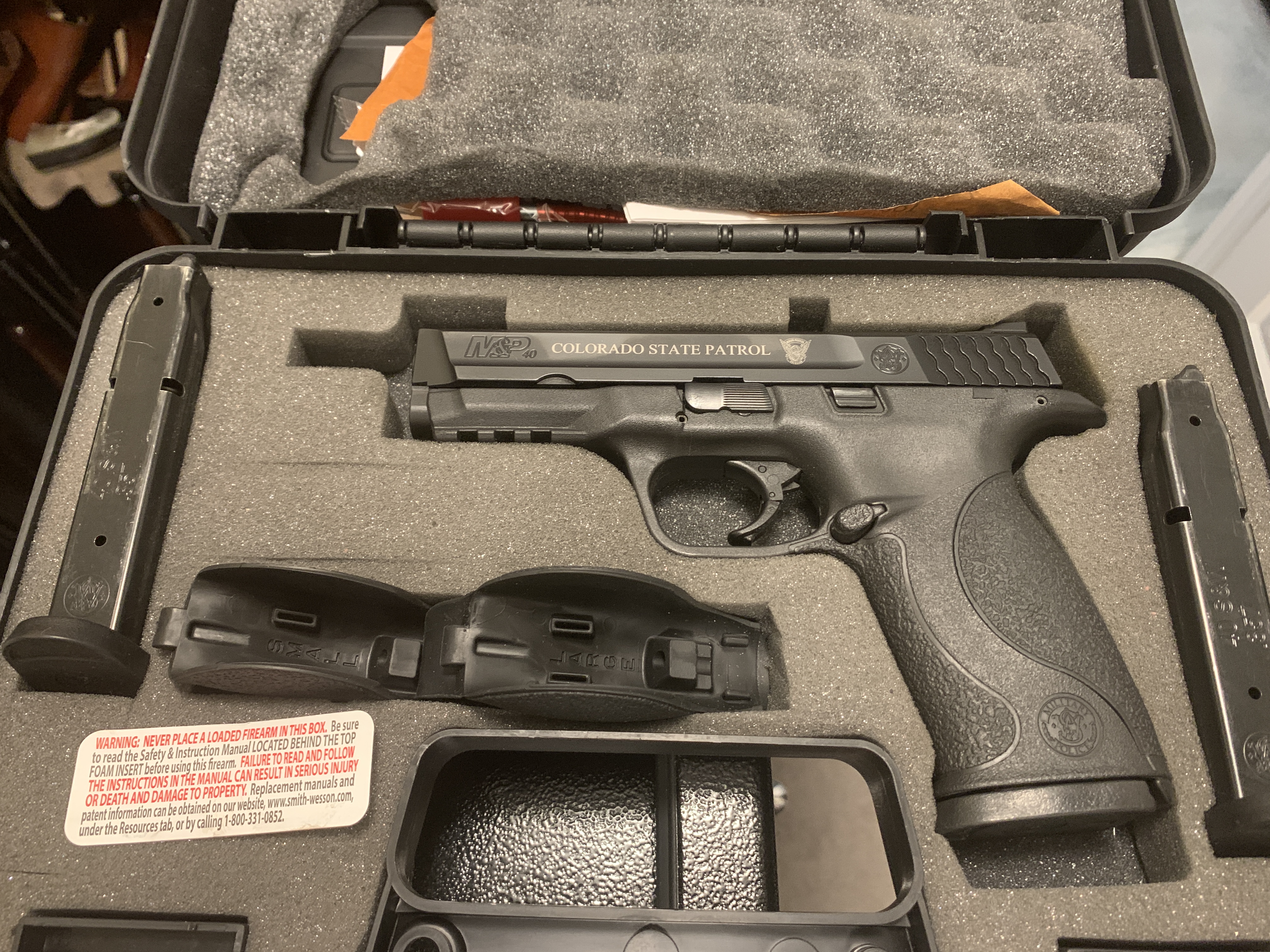

Posts: 907
Re: Deal on trade in Glocks
If you going to do police trade ins at least get one with a little panache😋
