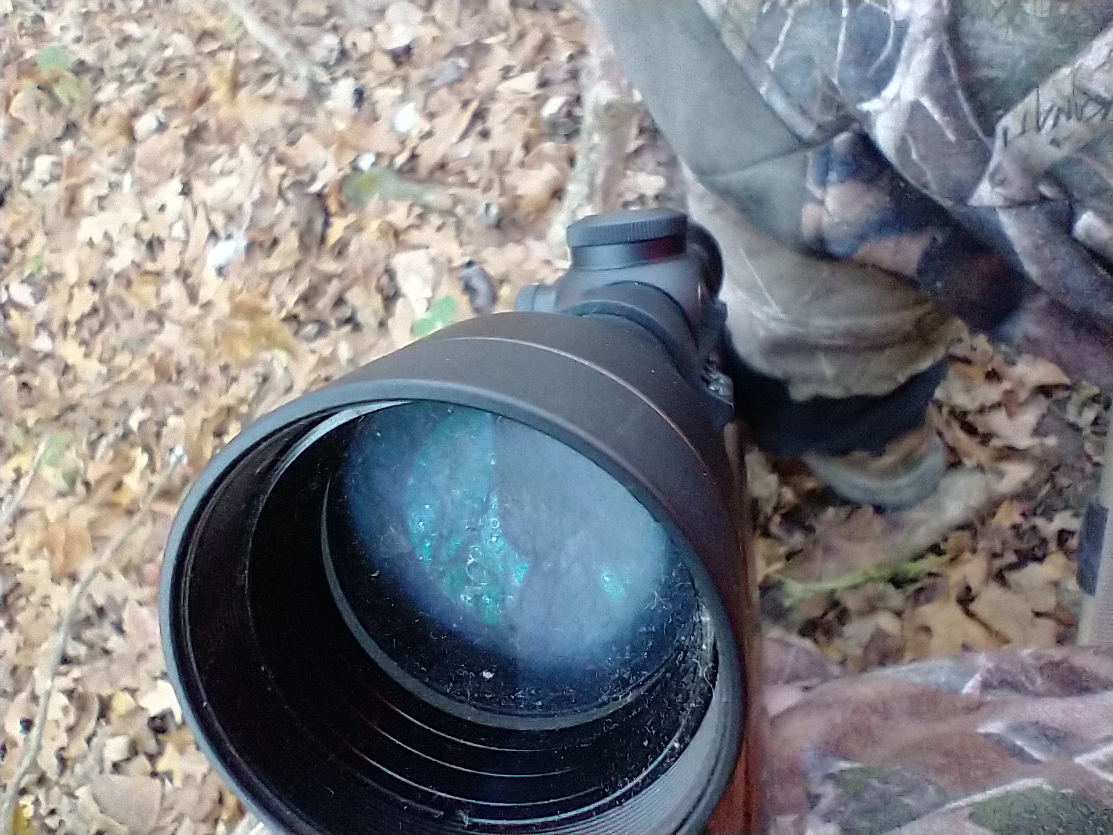

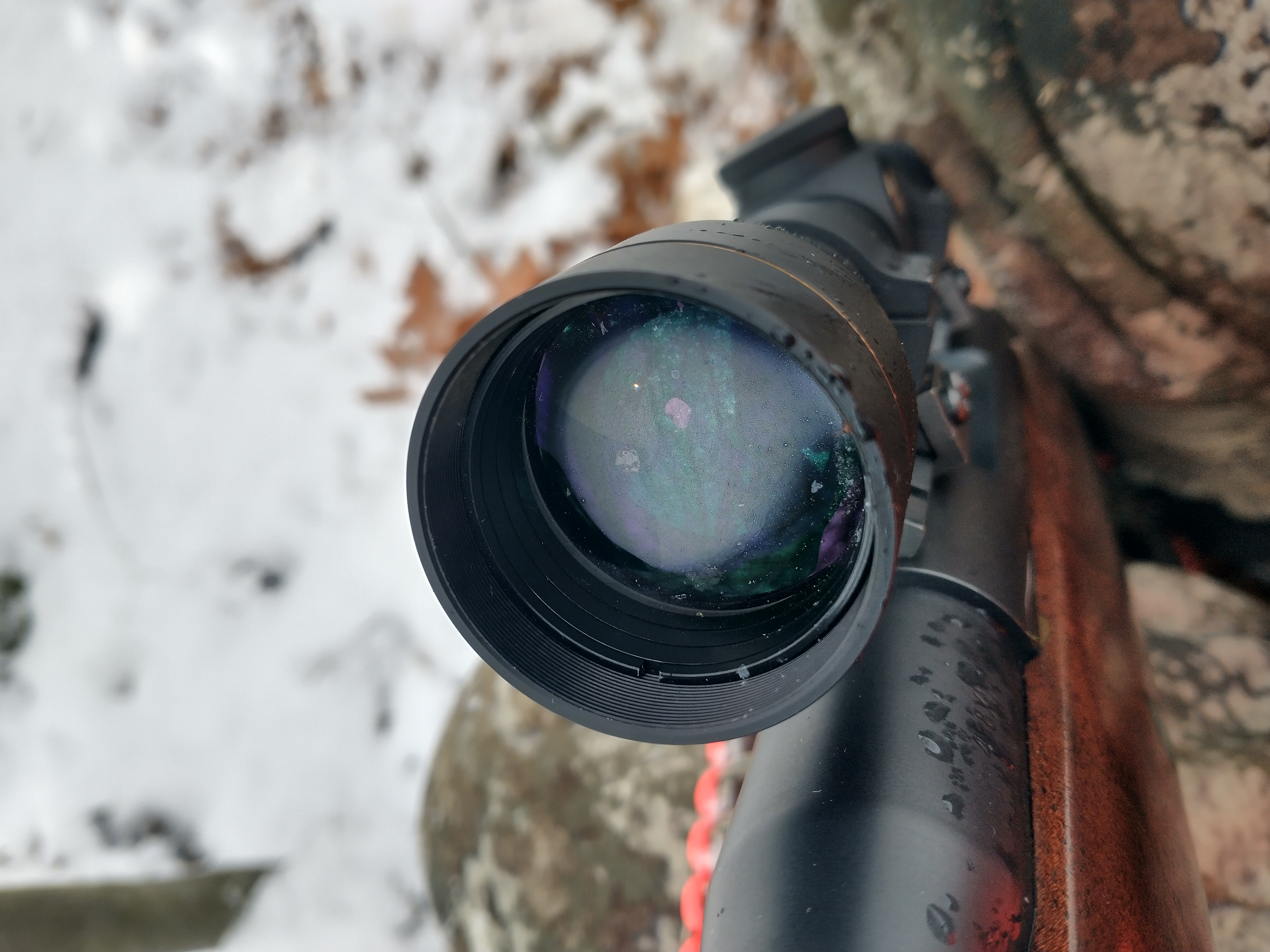

This is my backup In case I have issues with the little .458 again. Last season I scrambled to swap the scope and get zeroed toward the end of season so that I didn't have to cut my woods time short. The season before was cut short due to the same issue. Two seasons in a row with a fogged scope. It was sent in for repair after both times and has not made it back into a gun since the last repair. I just don't trust it.

What brand of scope went south on you?
Re: .350 legend and Lil'Gun
Posted: Fri Sep 08, 2023 12:21 am
by mitdr774
Leupold. Same scope two years in a row. Apparently the first repair didn't correct the issue. I'm not trying to make excuses for the scope, but recoil is on the upper end of what I can tolerate for more than a few rounds. 8lb 4oz rifle flinging a 350gr bullet at 2100 fps gets your attention. According to shooterscalculator.com it is around 34.33 ft-lbs of recoil energy.
