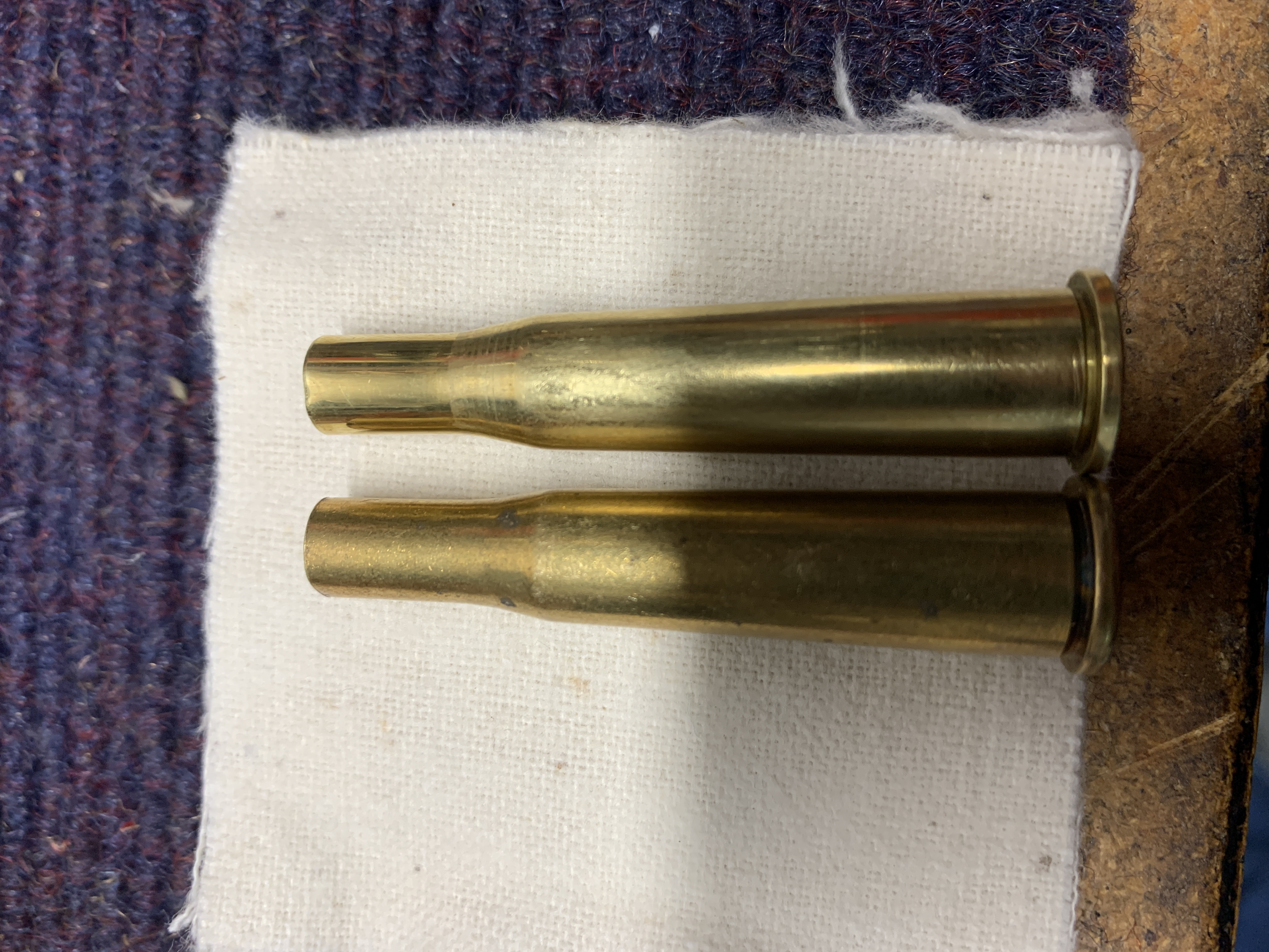

Side by side view. Factory on left, re sized 30-30 on right. Pretty clear the shoulder is not setting back far enough. Lee die, wondering if I should try another brand.
Thought?

Posted: Fri Sep 15, 2023 2:34 am
I’d call Lee, as that’s not even remotely close.

CPJ 2.0 wrote: Fri Sep 15, 2023 2:34 am I’d call Lee, as that’s not even remotely close.
I just sent an email with the photo so we will see what they say.

If you didn’t anneal the cases first, I would. That’s a lot
If brass to move.

I didn't anneal. In the research it seemed about 50-50 pro vs con with annealing but probably worth a try.

I don’t think there’s any cons, honestly. The brass is already hard, and you’re making it harder by squishing it.

wrinkles and collapsed shoulders are the most mentioned. I'm going to try it today, see if I get any different result.

When it comes to comparing, I'd use a fired case, once you have one. Factory brass is normally closer to minimum specs to fit all factory chambers.

Well Lee's response was about what I expected. They say their dies are not designed nor intended for case forming but resizing formed brass.
They suggested annealing as you did and multiple passes through the die.

Posted: Fri Sep 15, 2023 6:02 pm
You know….
You may run it though once un annealed, then anneal, and run again.
Maybe prevent the crushed shoulders? Maybe I’m talking out of my ass.

Well here's the latest, Annealing did the trick. The cases, while not quite factory spec will now chamber and can be fire formed to my chamber.

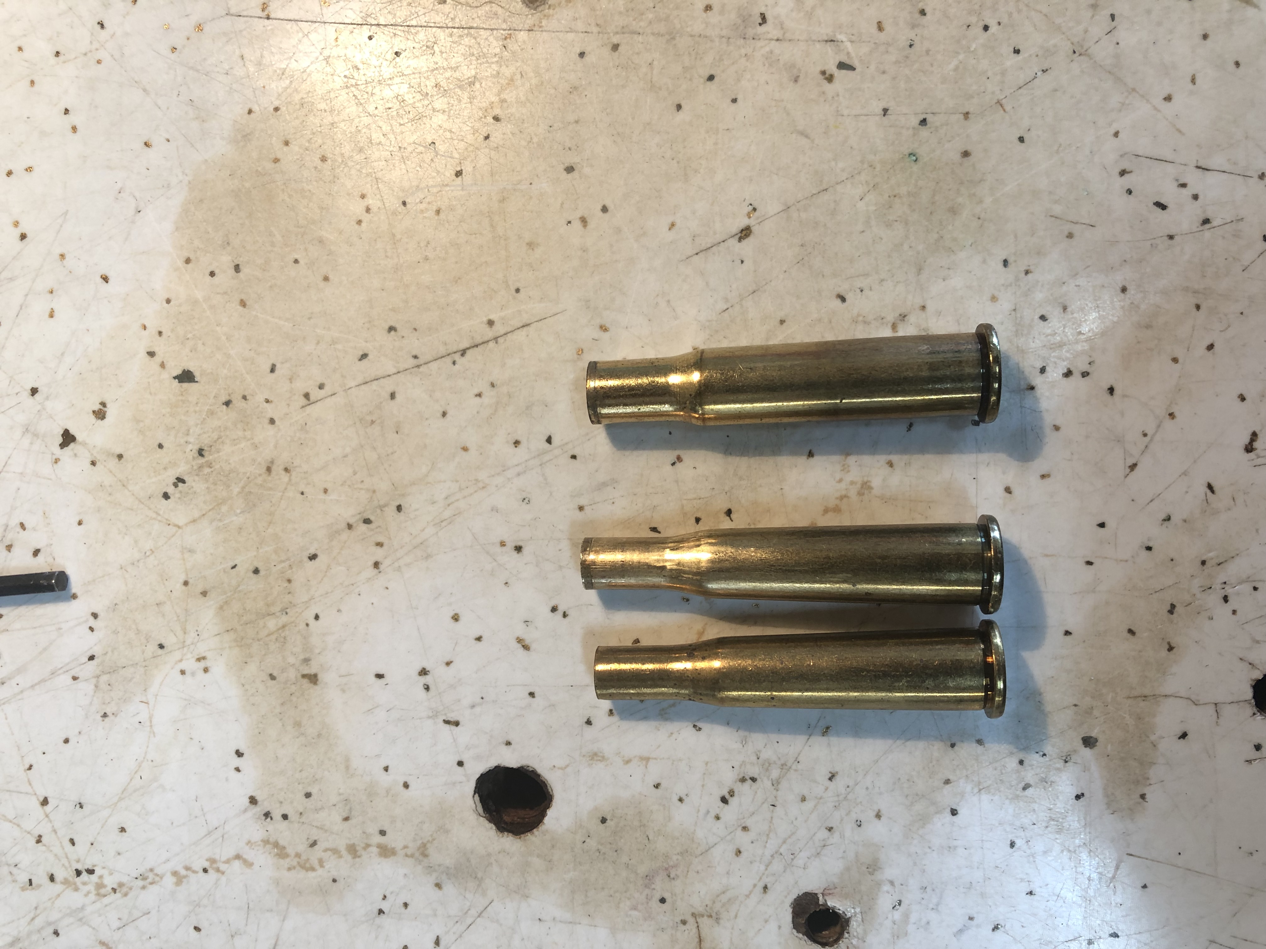

So I did a little experiment.! Thought I'd try resizing a .30-30 case to 25-35, just for science!! I have a lot of .30-30 case since I often resize them for other rounds, like .32-40 and .375 Win. without problems, except they come out a little short but still work! I have RCBS dies for the .25-35, lubed a .30-30 case and ran it in the sizing die. I had to grunt a little bit to size it, but it came out perfect, just a little long, by .050 compared to a factory case. Although it doesn't look like it in the picture, the shoulders are the same, and it chambered nicely in my .25-35. There are some stretch marks, but no wrinkles!
