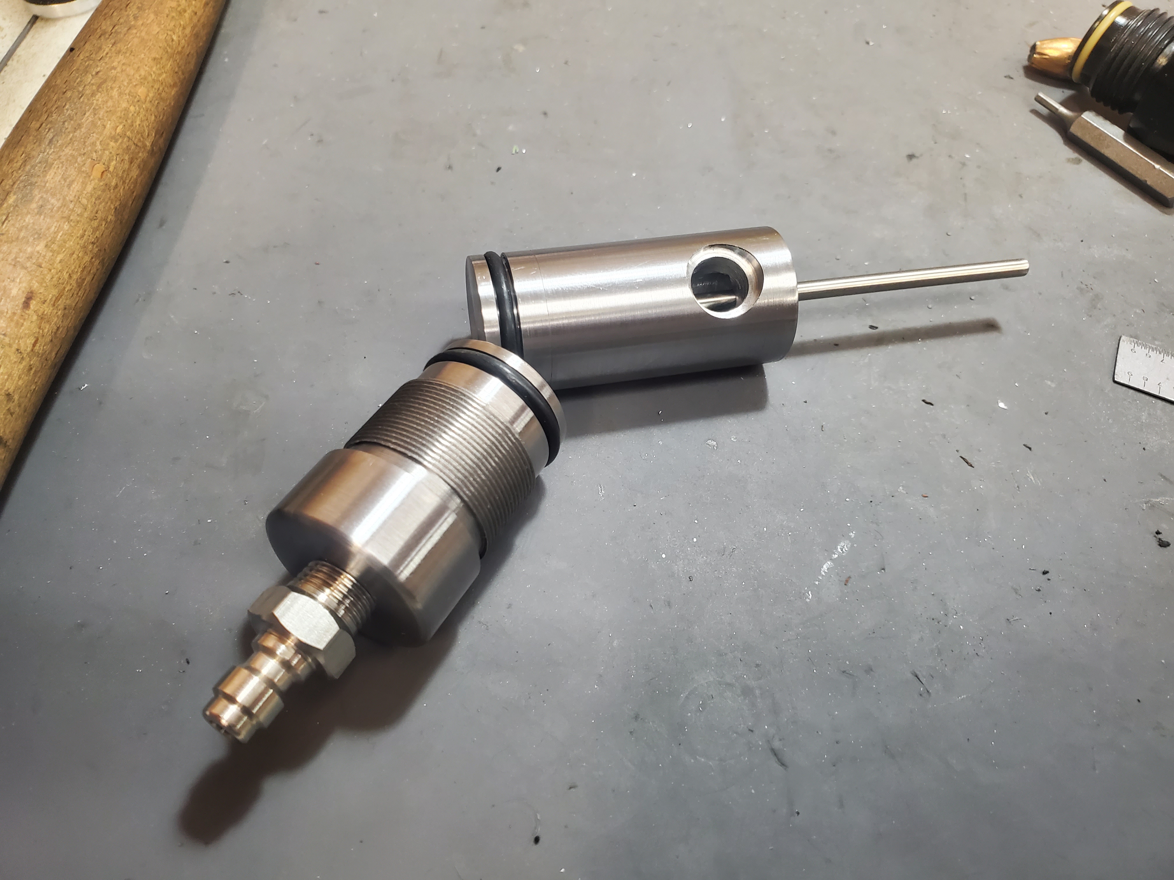

Probably the most time consuming parts to make, the valve and the pressure tank cap and fill.
Posts: 726
Re: Finally in production.
Looks like the big dog in the air gun pack has arrived!
