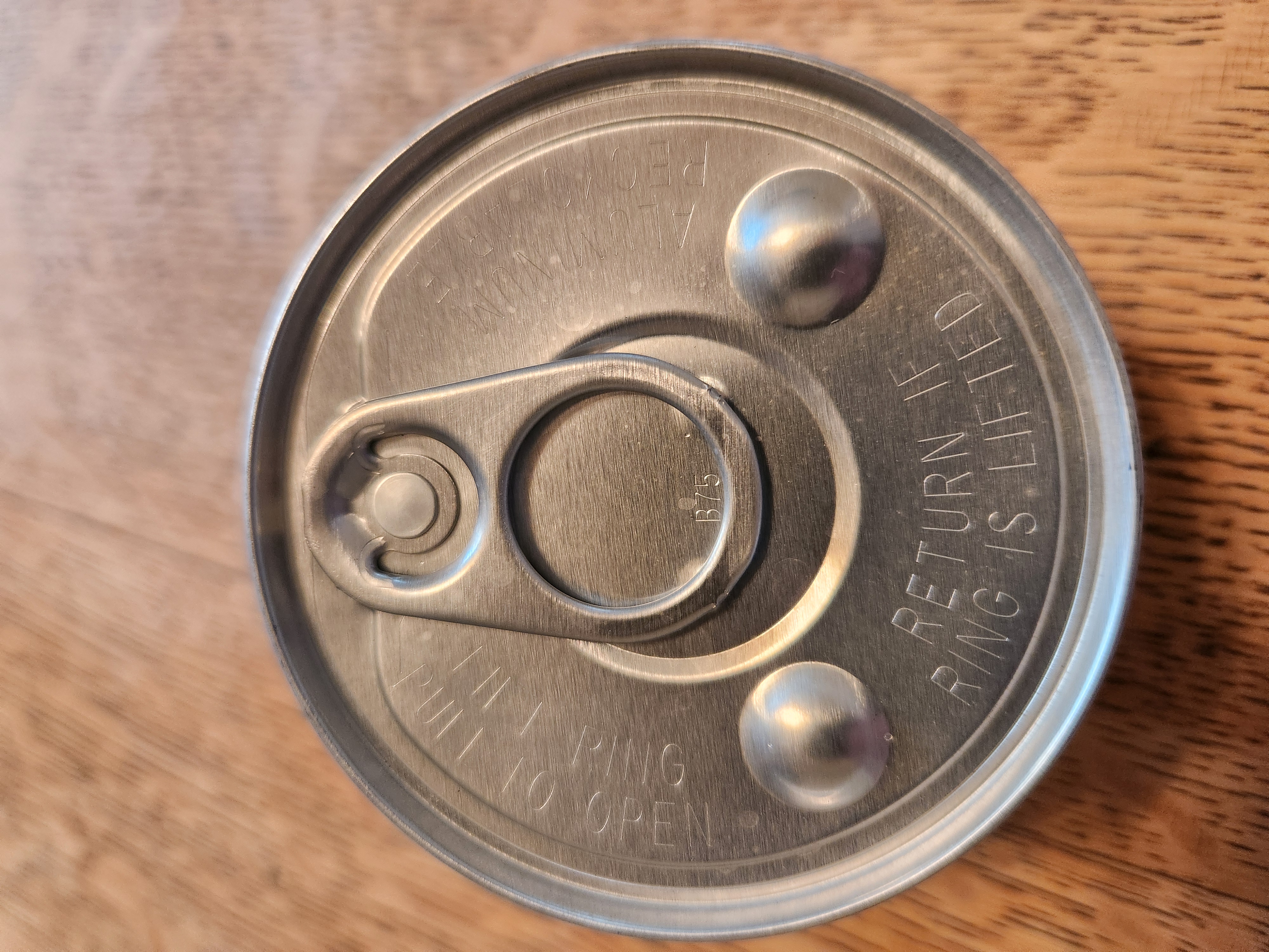

That is what I do. Not the tool & die part (we have a tool and die shop though). The running/fixing/adjusting to spec part. My line has a blanker press that makes the lid out of a coil of aluminum. Each stroke makes two lids. Then it uses air to move them out of the die into a curler that curls the edges to be seamed to a can. Then they go through a compound liner that puts 55 grams (+-10) sealant in the curl. An oven cures the compound so it doesn't get on any of the next tooling. Next is the conversion press that forms the lid, adds lettering, makes a score where the lid tear upon opening, and attaches a tab. After a lid is completed it goes thru an air tester (big lazy susan with 30 pockets that clamp down on each lid and put 10# of air on top to see if any leaks thru). Last is the packing station where a packer puts 450 lids into a bag then put those on a skid.
Tolerances are in the .001's. The score has to be parallel within .0005. The lids go thru 6 stations to form and the tab goes thru 10. Our speed is 360 strokes per minute. Six per second. You can't see what is happening. You have to guess from what is happening to the lid what the cause is. With scheduled and unscheduled cleaning and coil changes, we average 200,000 strokes a 12 hour shift.
800,000 lids a day x 7 days a weeks x say 44 weeks a year (holidays, maintenance shutdowns and overhauls) = 460,000,000 a year?
If you are in an Advanced Auto, look for a California Scents in a can....
Or look at 3oz cans of Blue Buffalo cat food. If the lid says '74' or '75' in the middle. That is my line...
Most of our lines make 13 lids per stroke @ 150 stokes per minute. Our 'big' line makes 27 steel lids with every stroke. It runs about 115 strokes per minute.
27 x 115 strokes = 3150 per min
3150 x 60 min = 186,300 per hour
186,300 x 22 hr = 4,098,600 per day
