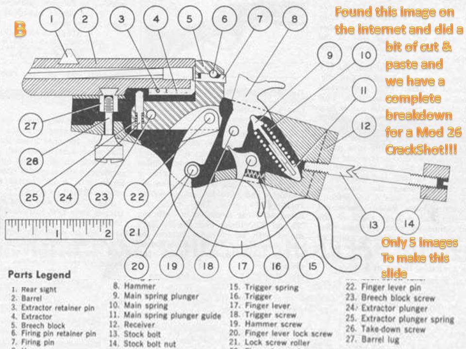

You might be able to find the drawings for a Steven's Crackshot action. It's a falling block that's simple and would be perfect for that type of build.

Justsomedude wrote: Sun Feb 04, 2024 6:27 pm
CPJ 2.0 wrote: Sun Feb 04, 2024 4:20 pm Guess what action isnt available as a machinist type kit? Guess which one is damn near impossible to find drawings of?
Oh there’s several that would be easier. And one day I may go that route.

Justsomedude wrote: Sun Feb 04, 2024 6:29 pm0axIRSh.jpg
If I did that, I’d likely do it two piece if it could be adapted. Slot milling that much material isn’t that desirable to me.
