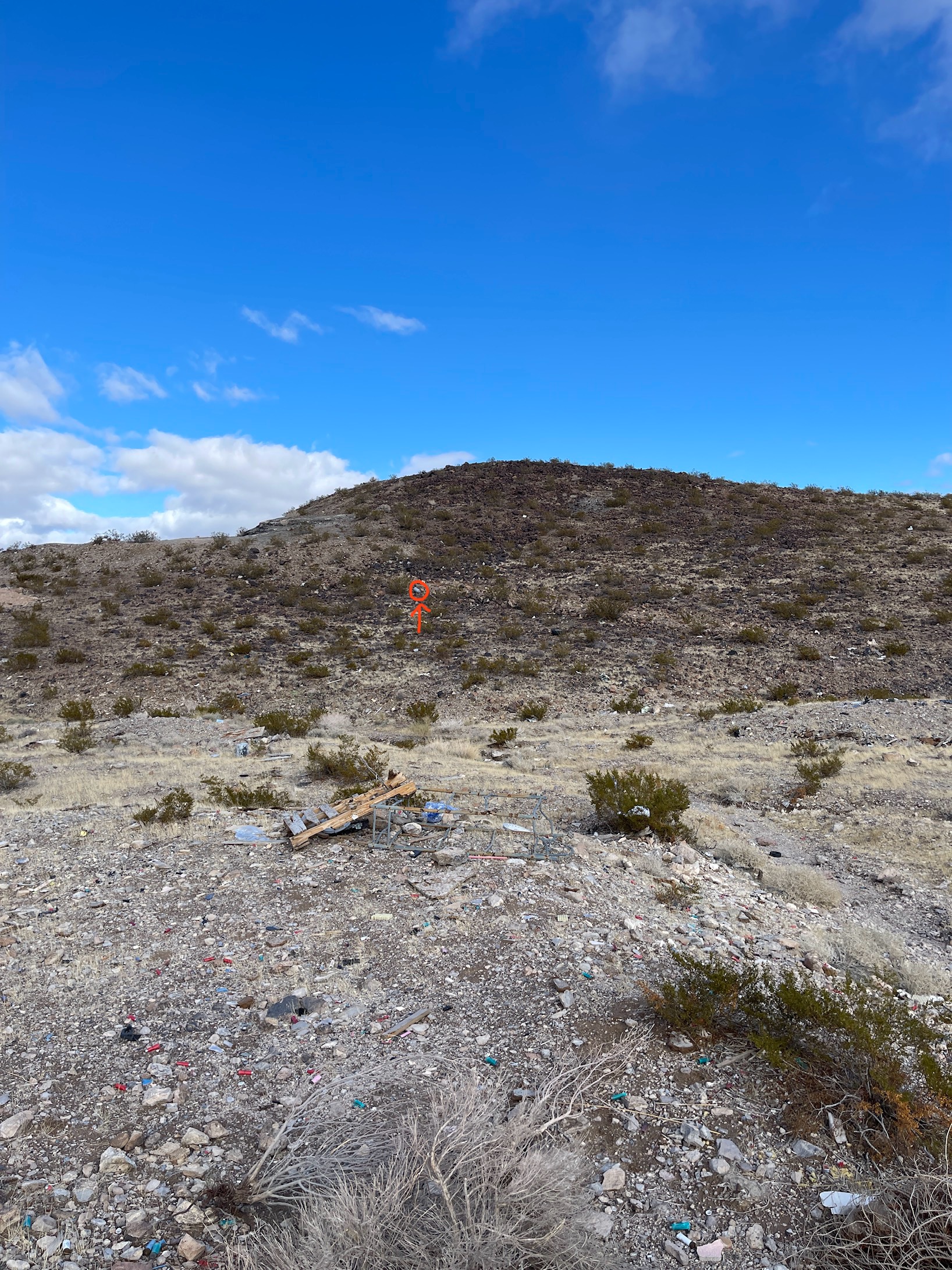

Got to the middle test load of 38 grains and feeling a little more confidence I spotted a 5 gal bucket at about 100 plus yards.
Put the front sight on it and the 3 shoots I sent down range “Quigleyd” the bucket into the air 🍾🥂 😎
Amazing! Dead on with the factory sight setting and definitely stouter than 37 but still a very comfortable load to shoot!
