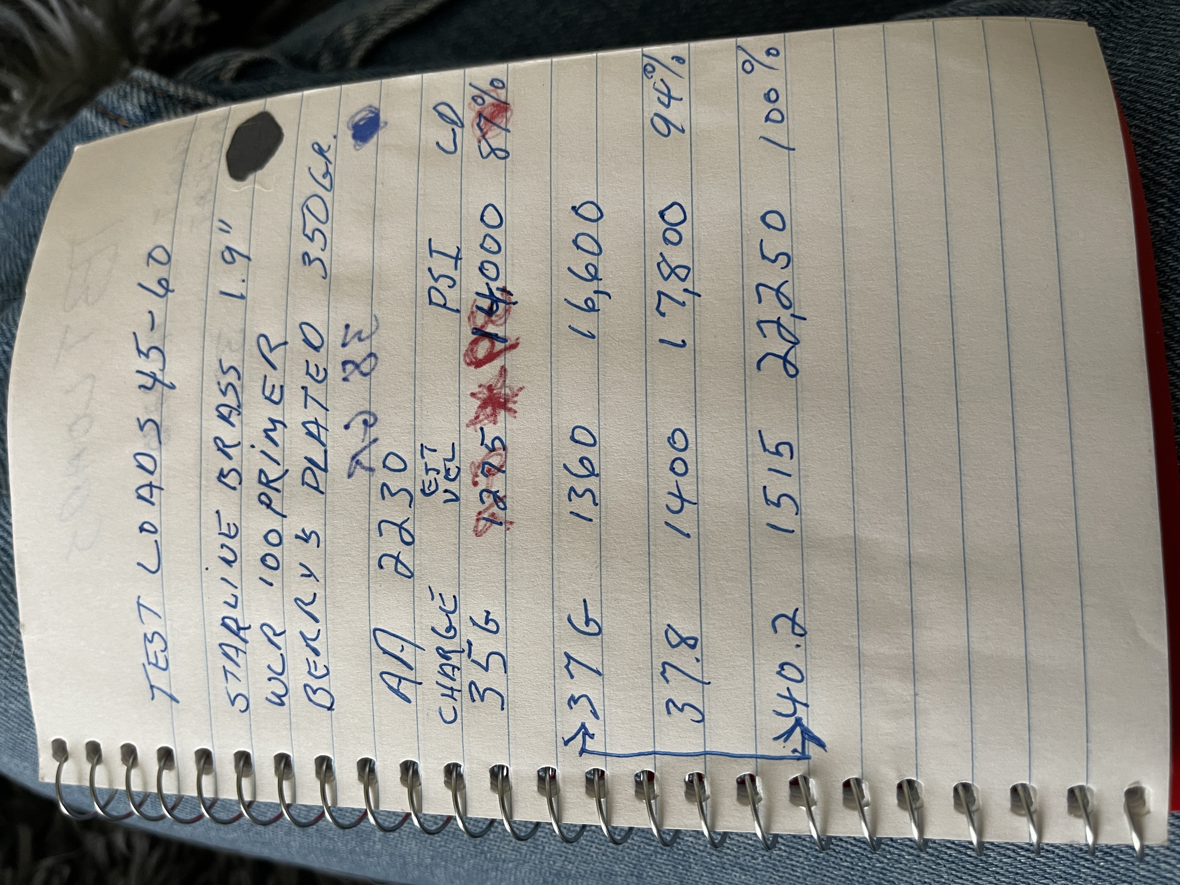

Going for safety, smooth cycling and potential accuracy. Will fine tune later.
First set of test loads.
Benchmark load is the load Big Al gave me which work very well in this gun. Itโ€™s a 300gr LFP on top of 33 gr of 4198. Very mild and a pleasure to shoot ๐Ÿ‘
Black tip is 37 gra of AA2230, blue is 38gr and red is 49gr. According to GraoeApeโ€™s QuickLoad software I should still be well under the 28,000 psi the action is rated for and at 39 gr I should be closing in on 1,500fps and still under 22,000 psi.
So one last check, anyone see something wrong with the approach?

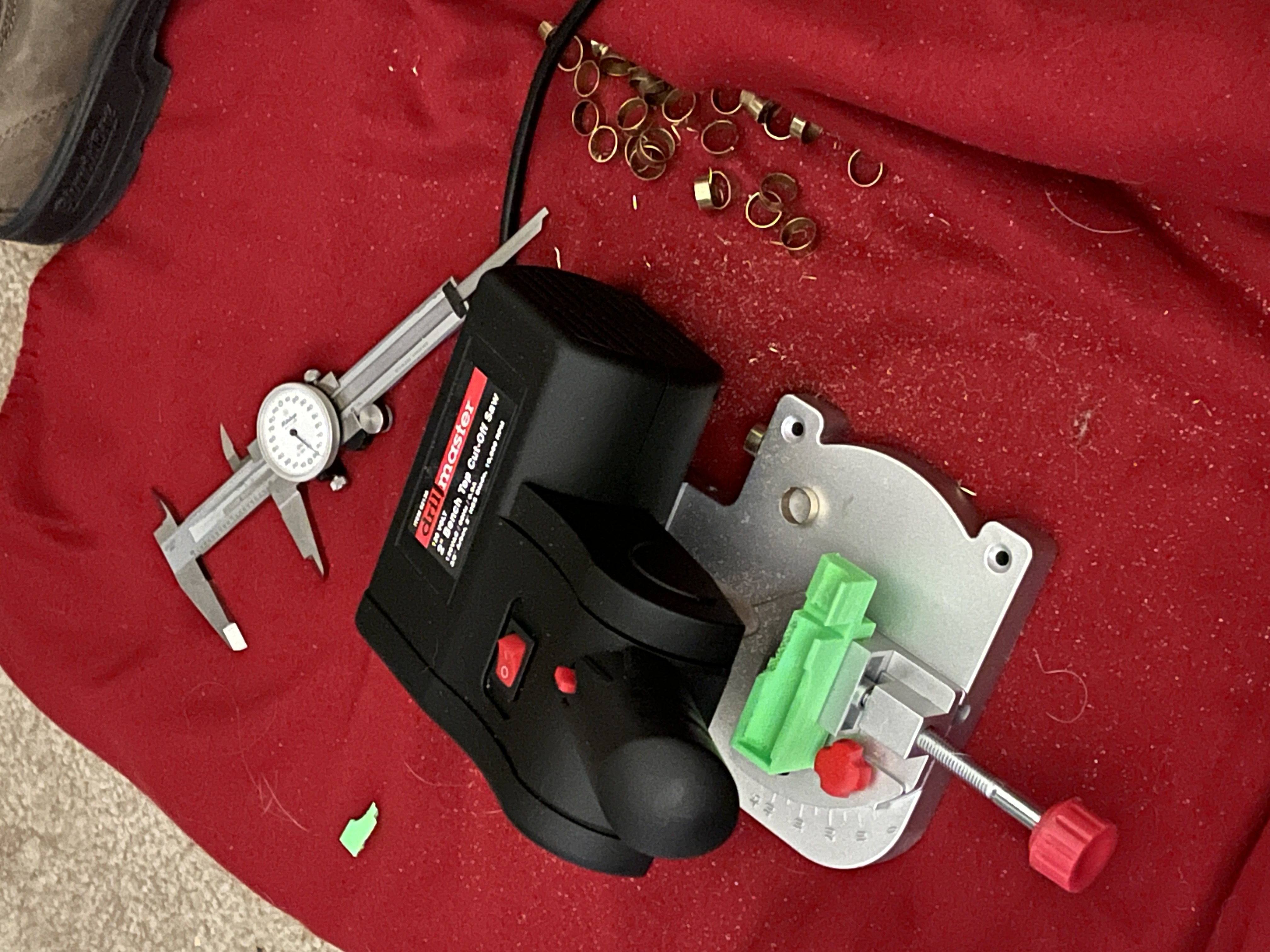

Making cases ๐Ÿ‘

QuickLoad numbers from our late night (for him) conversation.

Thinking you meant to type 39 for the red tips?

JunkCollector wrote: โ†‘Wed Feb 07, 2024 7:45 pm Thinking you meant to type 39 for the red tips?
Yes! Thanks for catching that ๐Ÿ‘๐Ÿ‘

I'll be curious to see how the QL calculated data compares to real world. Though with the longer COAL, I'm betting velocity and pressure are going to be lower than predicted

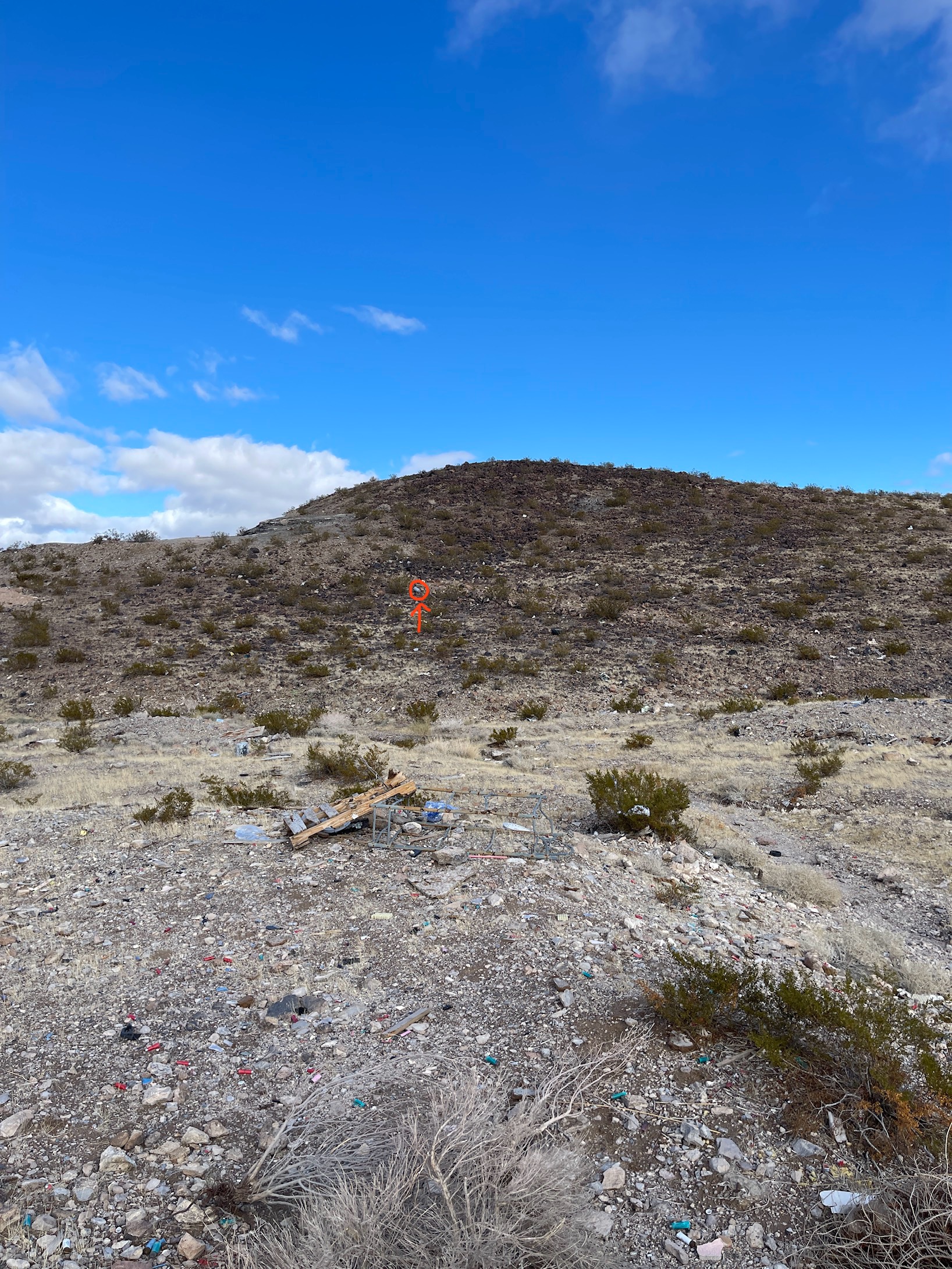

Got to the middle test load of 38 grains and feeling a little more confidence I spotted a 5 gal bucket at about 100 plus yards.
Put the front sight on it and the 3 shoots I sent down range โ€œQuigleydโ€ the bucket into the air ๐Ÿพ๐Ÿฅ‚ ๐Ÿ˜Ž
Amazing! Dead on with the factory sight setting and definitely stouter than 37 but still a very comfortable load to shoot!
