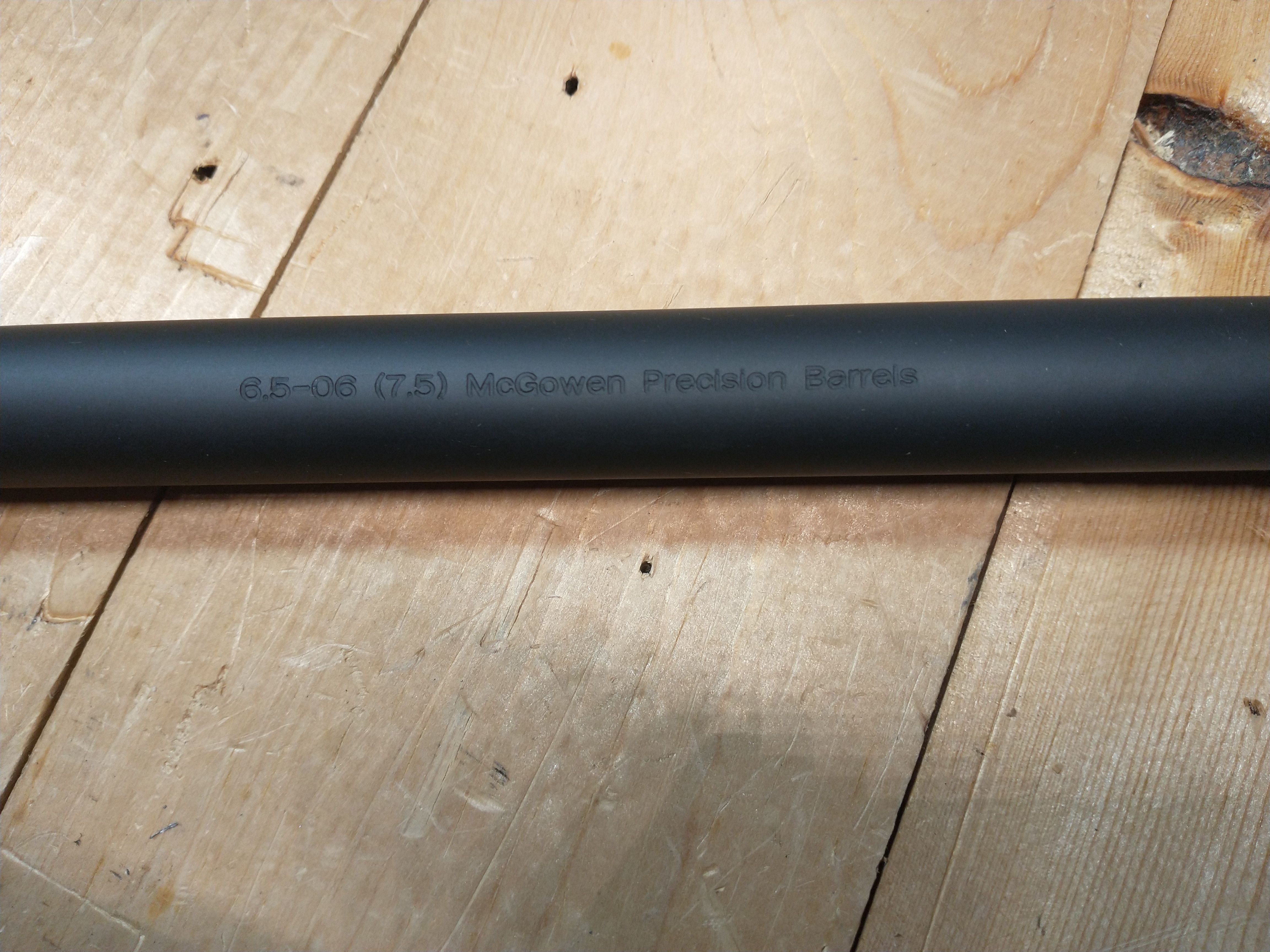

This has been an idea I have been kicking around since the previous forum. I was going to go through with this project with the resident forum gunsmith, however he has been slammed (that should tell me enough about his work) and the project has been "delayed". I will embark on another project with him another time when he is not so busy, and I think I already have an idea what it will be. Due to applying for Colorado pronghorn season soon, I wanted to get this project going so that it could hopefully be all set in time if my dad and I draw. The .243 project was a warm up way to convince myself I could do this.
According to UPS tracking my prefit barrel will be arriving at my door on Wednesday. This is several months ahead of planned, but I am okay with that. Im my pursuit of odd ball stuff and wanting a somewhat hot rodded 6.5mm I decided to finally go through with a 6.5-06. I order a prefit from McGowen barrels and went with a 26" finished length, 1-7.5 twist, chromoly barrel with a #4 Douglas contour. This will be going on a donor R700 SPS that was purchased specifically to be a donor. I still need to look at getting a trigger for it as well as deciding if Im going to stick with a factory stock for now, or use a Bell and Carlson stock.
Last year I ran a bag of Sig .270 brass through a 6.5-06 die and now have 50 pieces of brass just waiting to be used. I also have some Starline .270 brass but that may be for a different -06 project if I decide the 6.5 isnt harsh enough on the barrel. Based on some quick measurements of the sized brass it doesnt look like I will have to do any neck reaming. That will have to be confirmed once I have the barrel though.
I dont know what Remington torques their barrels down to, but they for sure will not come apart on accident. I am almost glad I pulled the barrel off before thinking of shooting the donor as I found packaging material jammed up in the locking lug area when I pulled the barrel off. This is also one of the oiliest rifles I have had my hands on, and I own several CZ rifles with a reputation of leaking oil for years. Maybe new Remington dunks the blued barreled actions in a drum of oil to neutralize the bluing salts??

Well Mr. UPS man dropped off a package today.

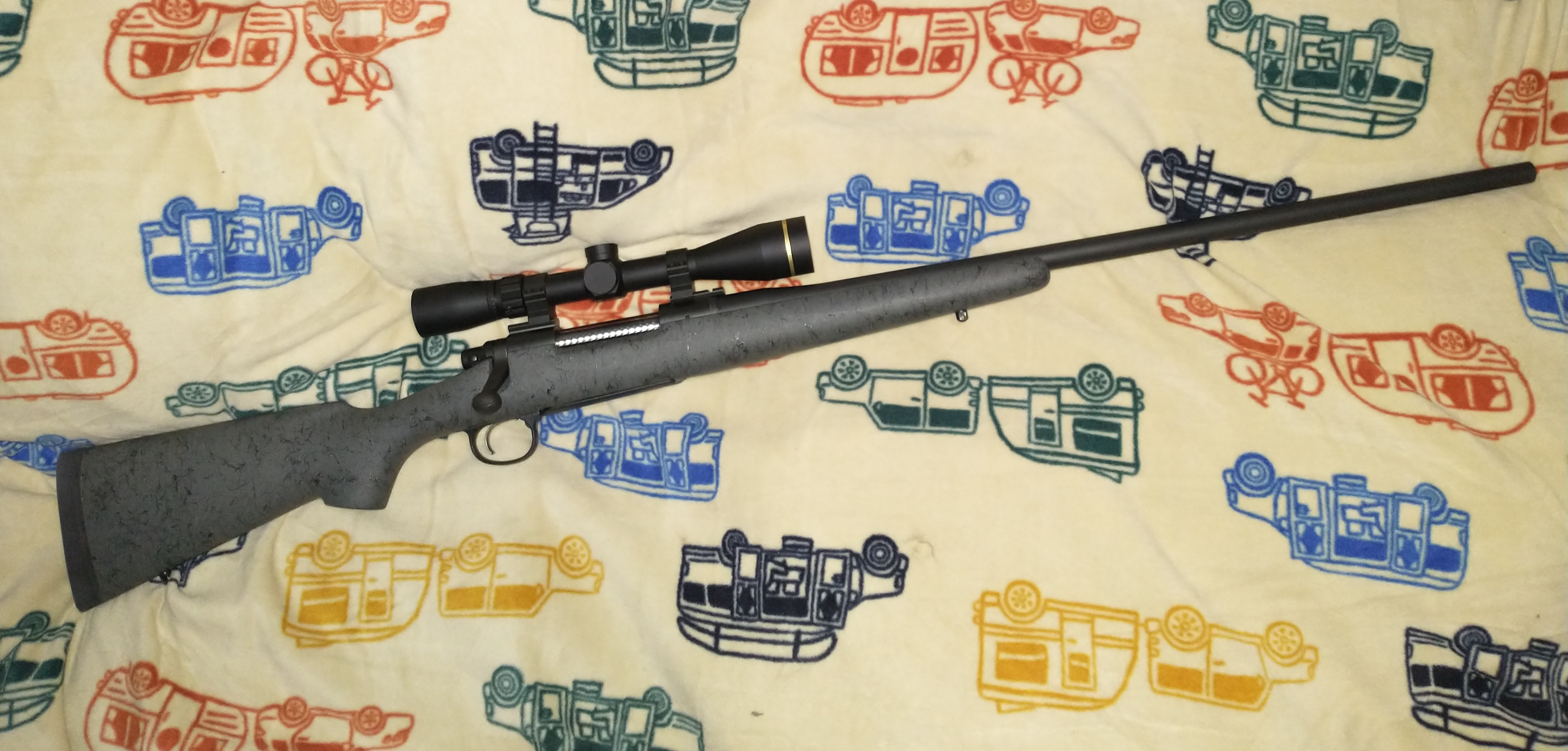

Re: This one might get Zee excited..
Posted: Thu Feb 15, 2024 1:25 am
by mitdr774
The barrel is on, stock barrel channel opened up some, and bedding compound is setting. I ended up using the Bell and Carlson stock since I didnt want to have to hog out the Remington stock to get the barrel to fit the channel. It does look a little goofy with a 26" barrel, but im okay with it. I need to decide if IM going to keep the factory trigger or replace it and then dig out some bases and rings. I have a 4-12x40 scope sitting on top a cabinet just waiting for a rifle to go on.

Posted: Fri Feb 16, 2024 12:49 am
by mitdr774
Quick update. Pulled the metal back out of the stock, did some quick clean up, put the metal back in the stock (with the factory trigger for now), and grabbed my "spare" set of Leupold bases and rings so I could get a scope on it. As it currently sits it comes sin at 9lb 4oz. A touch on the heavy side, but that is expected with the Bell and Carlson stock.

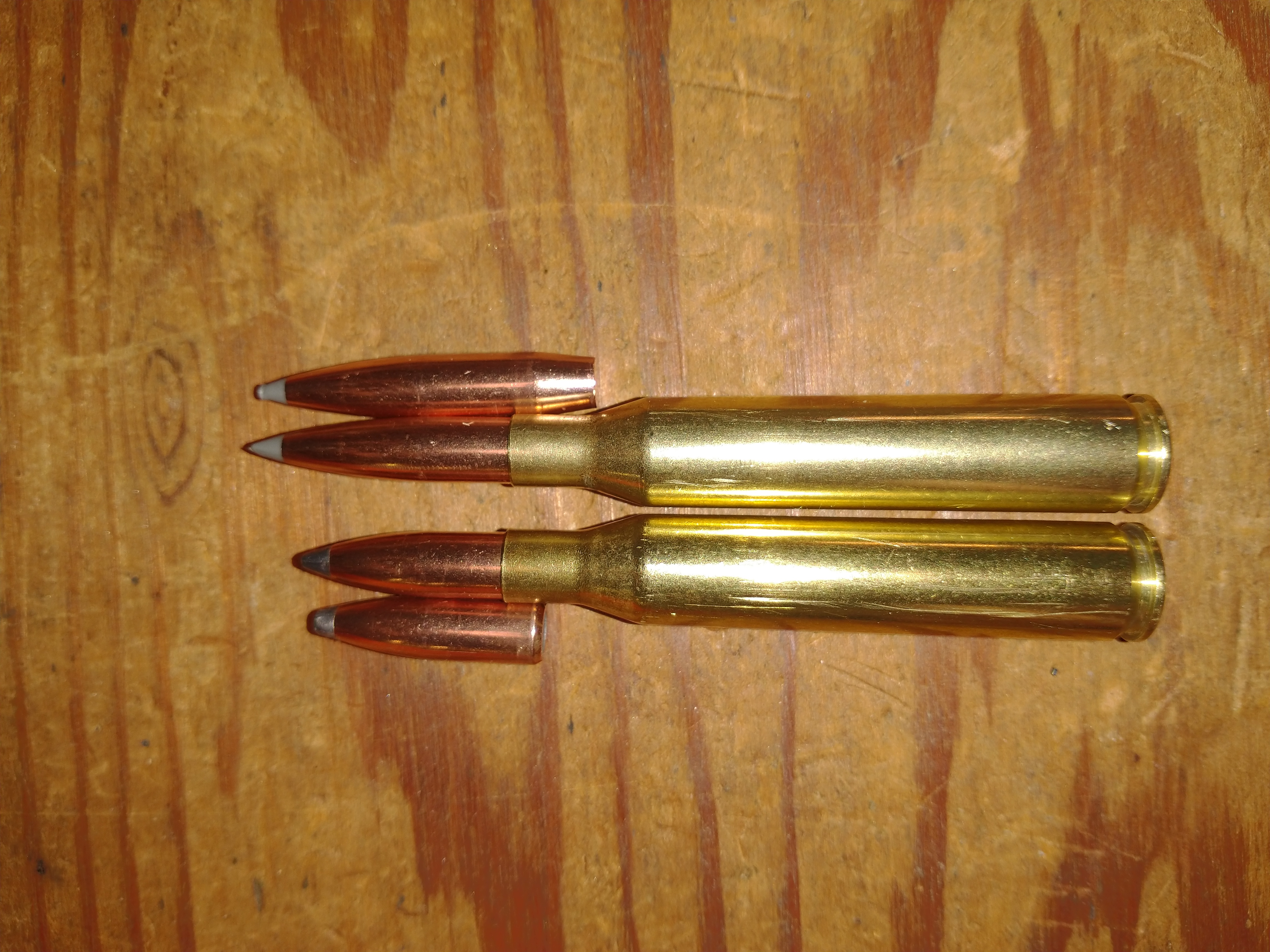

Posted: Sun Feb 18, 2024 12:45 am
by mitdr774
I put a couple dummy rounds together today to. I decided to try out the 100gr Partition and the 129gr ABLR. These dummy rounds were to sort 0.020" off the lands. Keep in mind that these lengths do not leave a whole lot of bearing surface in the neck as you will be able to see in the picture. The R700 has a really long magazine box length.

I may try loading up some at the max length to try, but I dont have high hopes. Then again one of my 6.5x55 rifles really like the 129gr IL with an overall length of 3.115 if I recall correctly. Thats only about 0.200" longer than book, but doesnt leave much left in the case. I like to try and have one caliber of bearing surface between the neck and bullet, but if it works fine with less and it performs better I will go with it. Maybe I might be able to seat the 142gr ABLR long and push it to book velocities for the 129 ABLR??

This is the 129gr at 0.020" off the lands and the 150gr at 3.455". With the 3.455" length I have almost one caliber of bearing surface between the bullet and case neck.
