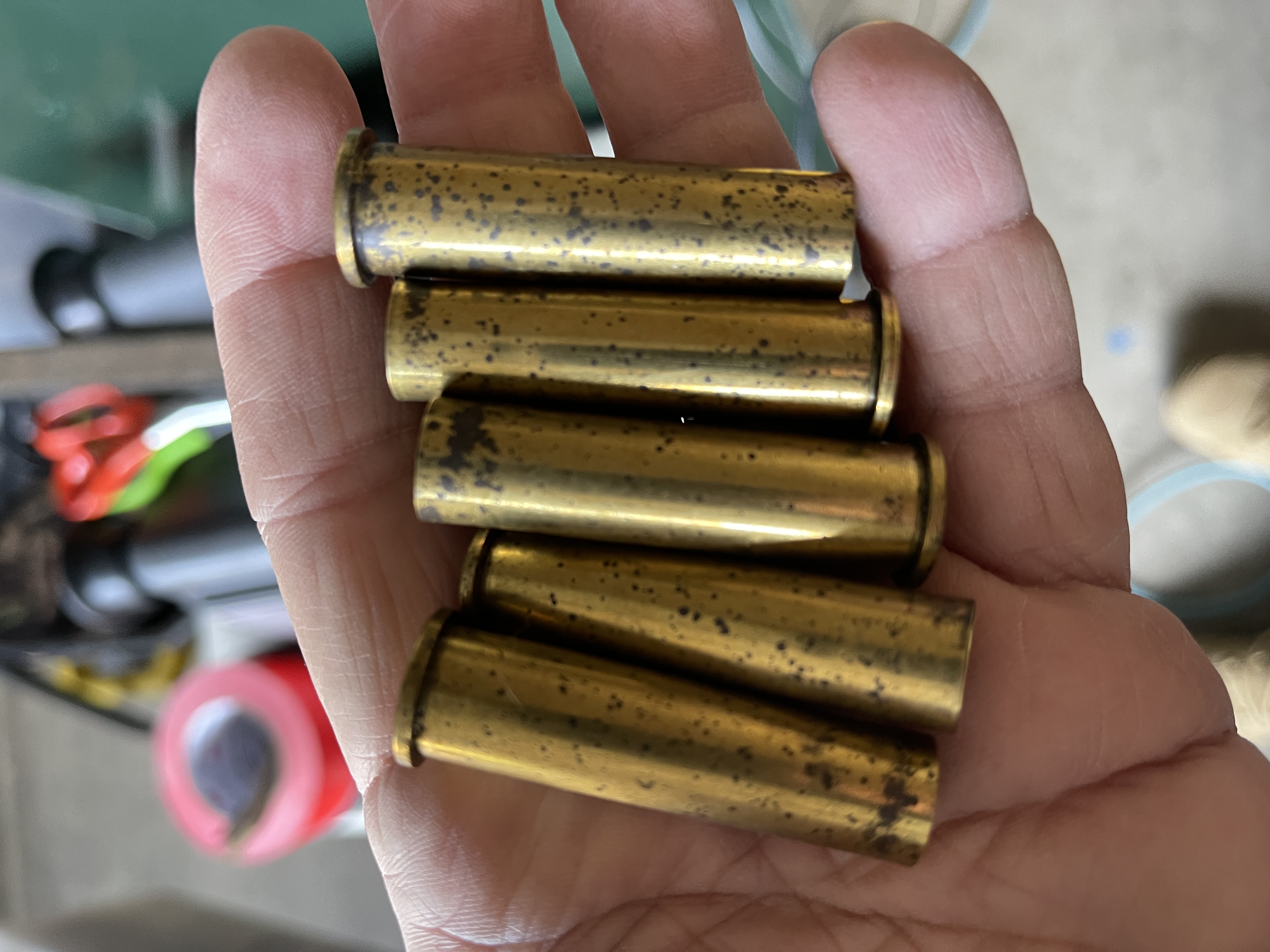

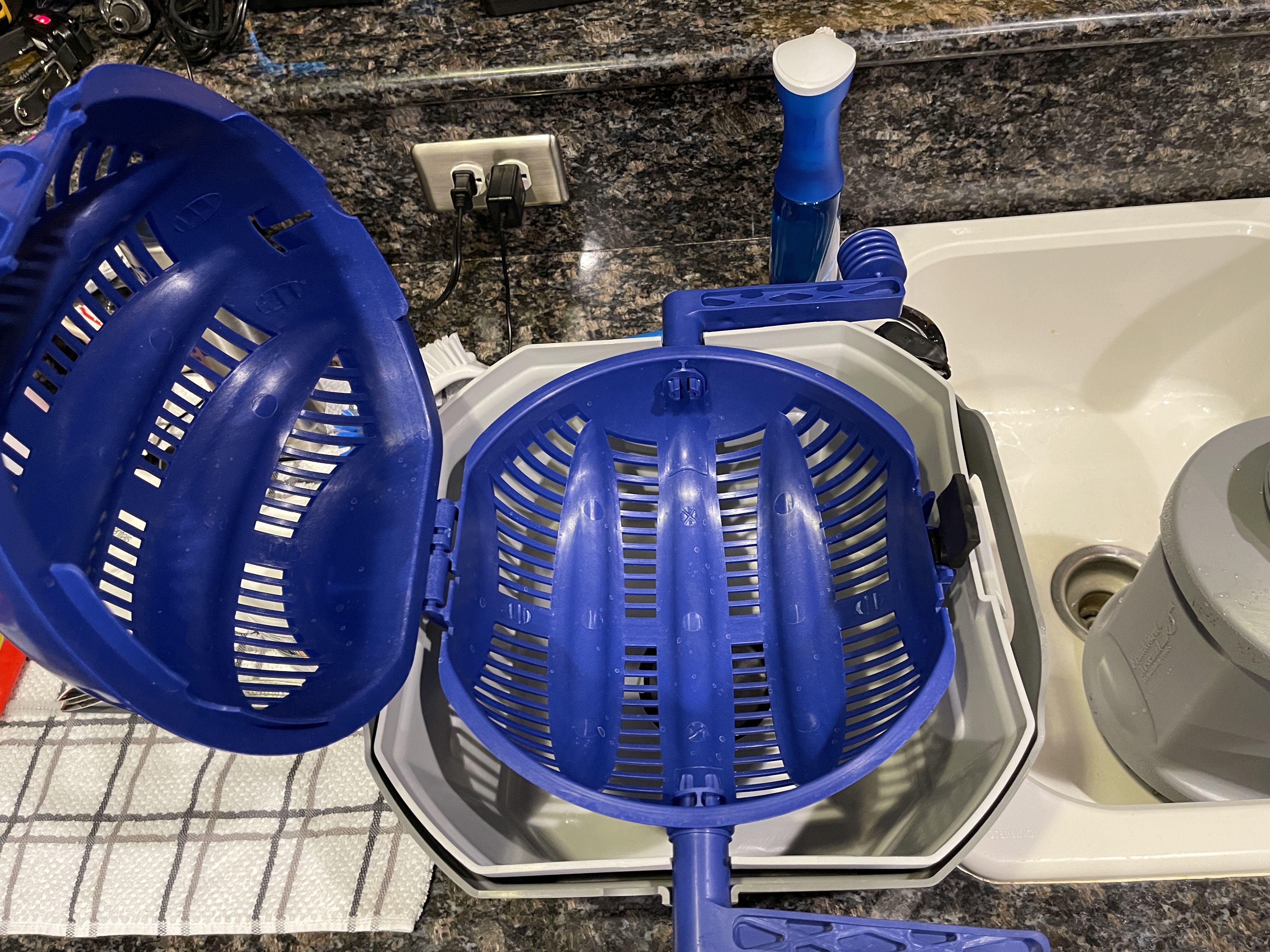

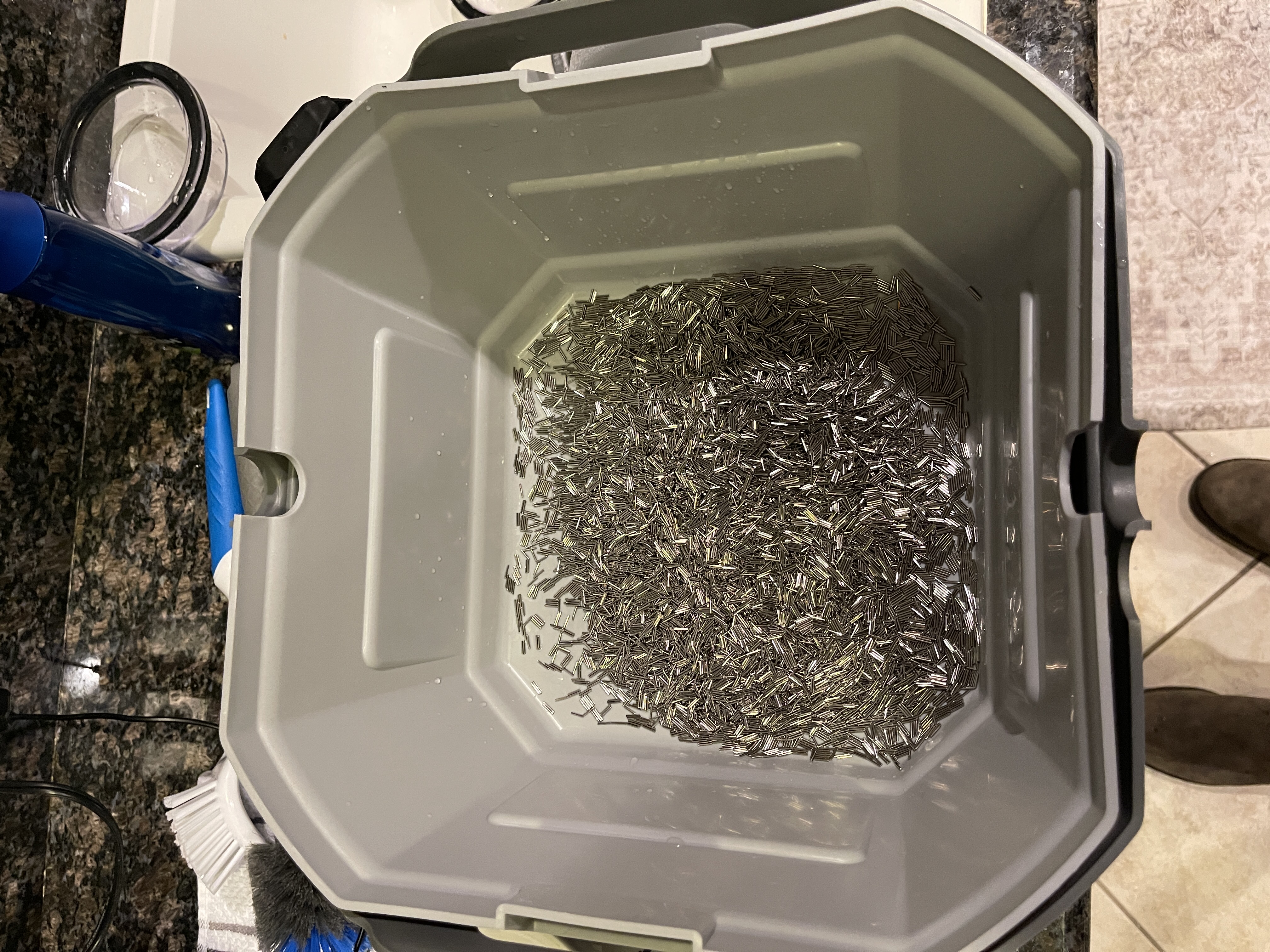

Having been told that they were a PIA by some folks I had avoided them but decided since I had them I’d give them a try to see how much more work they are.
So the sequence was dump a bunch of REALLY dirty, some of it seriously stained, brass into the tumbler after removing the primers (de-primed all the 45-60 but not the .45 Colt to see the difference and it was night and day!), fill with hot water + a squirt of Dawn Dishwashing soap + a flew grains of Lemi Shine Dish Detergent Booster( literally just a few grains) and the steel pins. Tumble for 3 hours (max on auto timer on tumbler). Drain dirty water, quick rinse and second tumble with hot water and a capful of Armor All Ultra Wash Wash and Wax car soap + steel pins. This second wash with the Armor All leaves a nice coating on the brass that prevents tarnishing and avoids any water spotting.

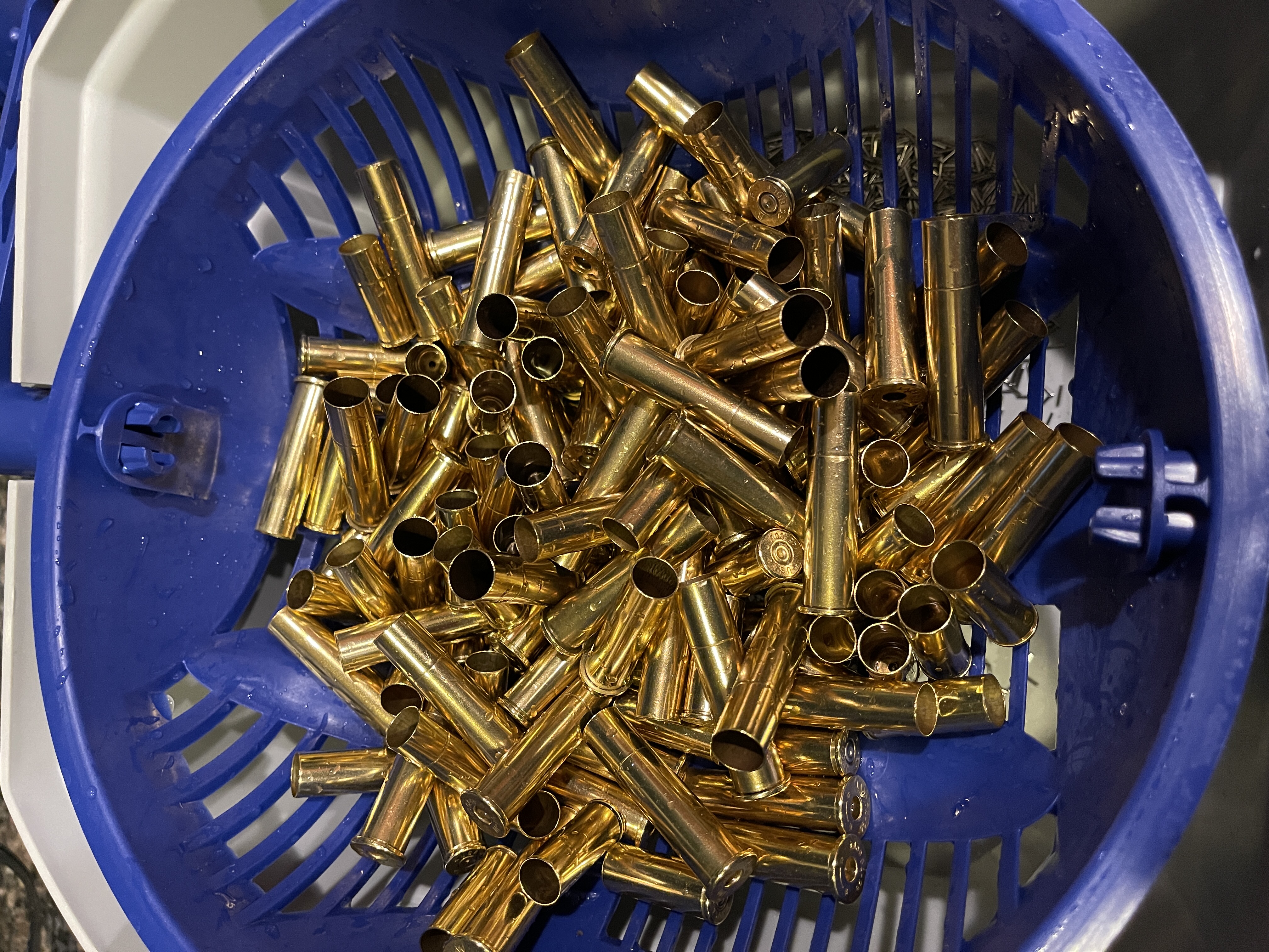

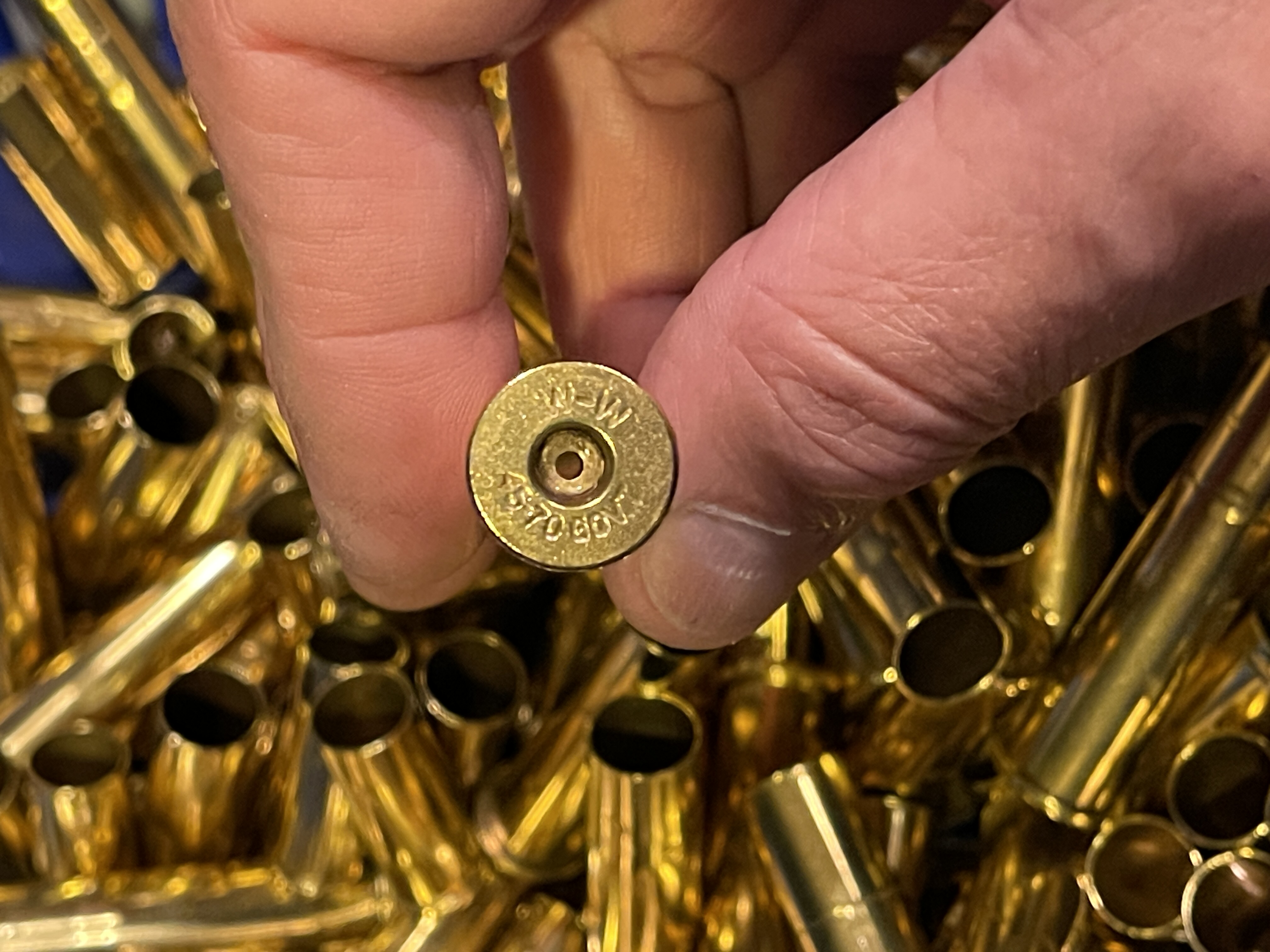

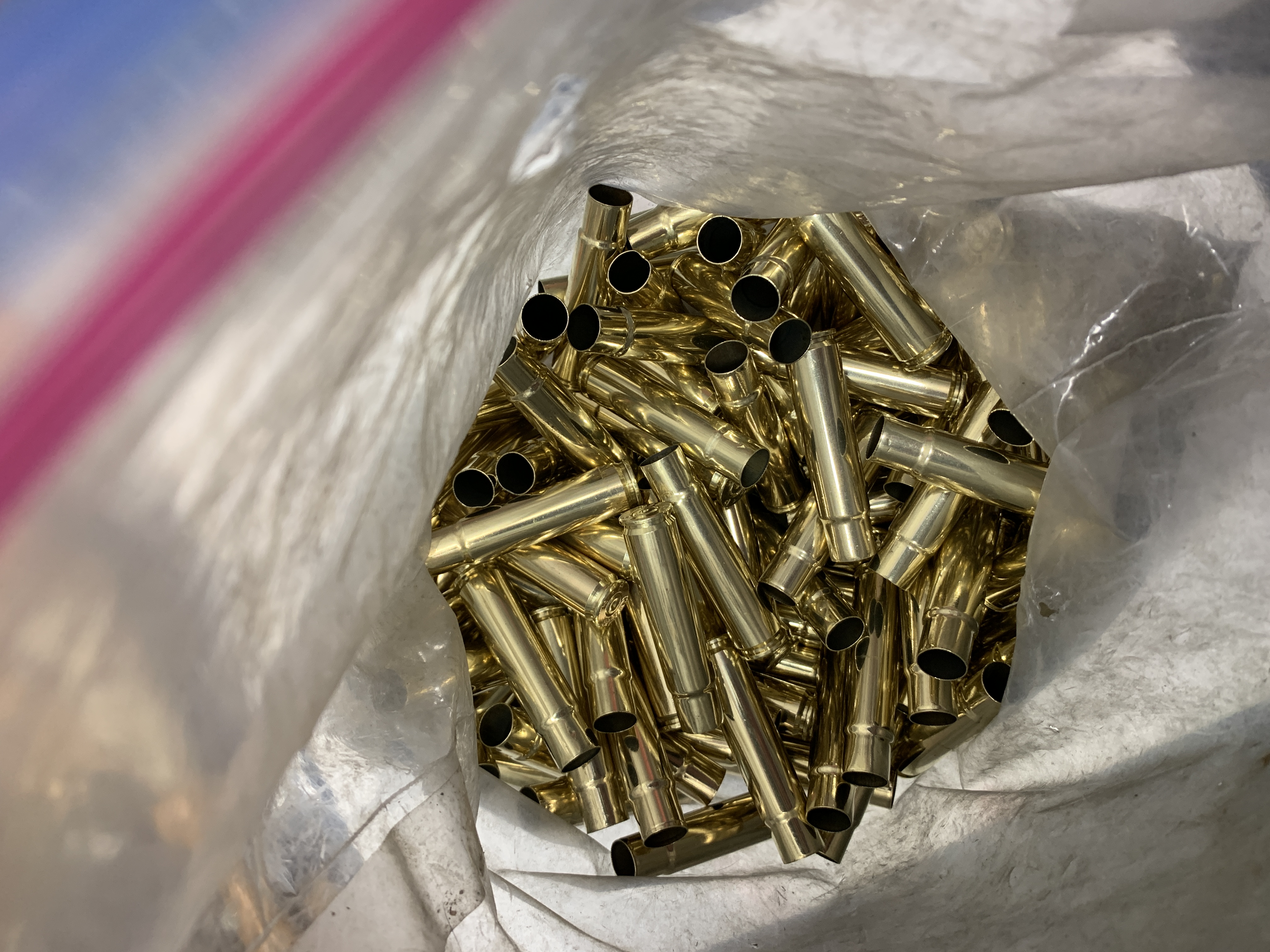

The result is brass that looks brand new, actually better than factory brass and clean inside and out including primer pockets. Even the toughest stained brass was spotless and I couldn’t tell new brass from the once fired cases

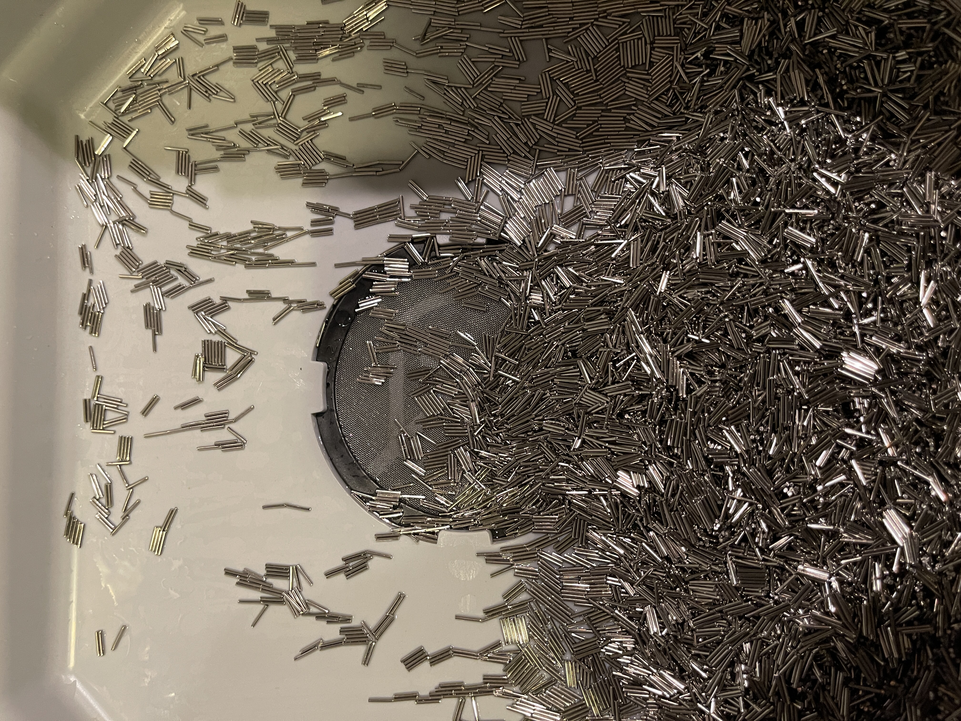

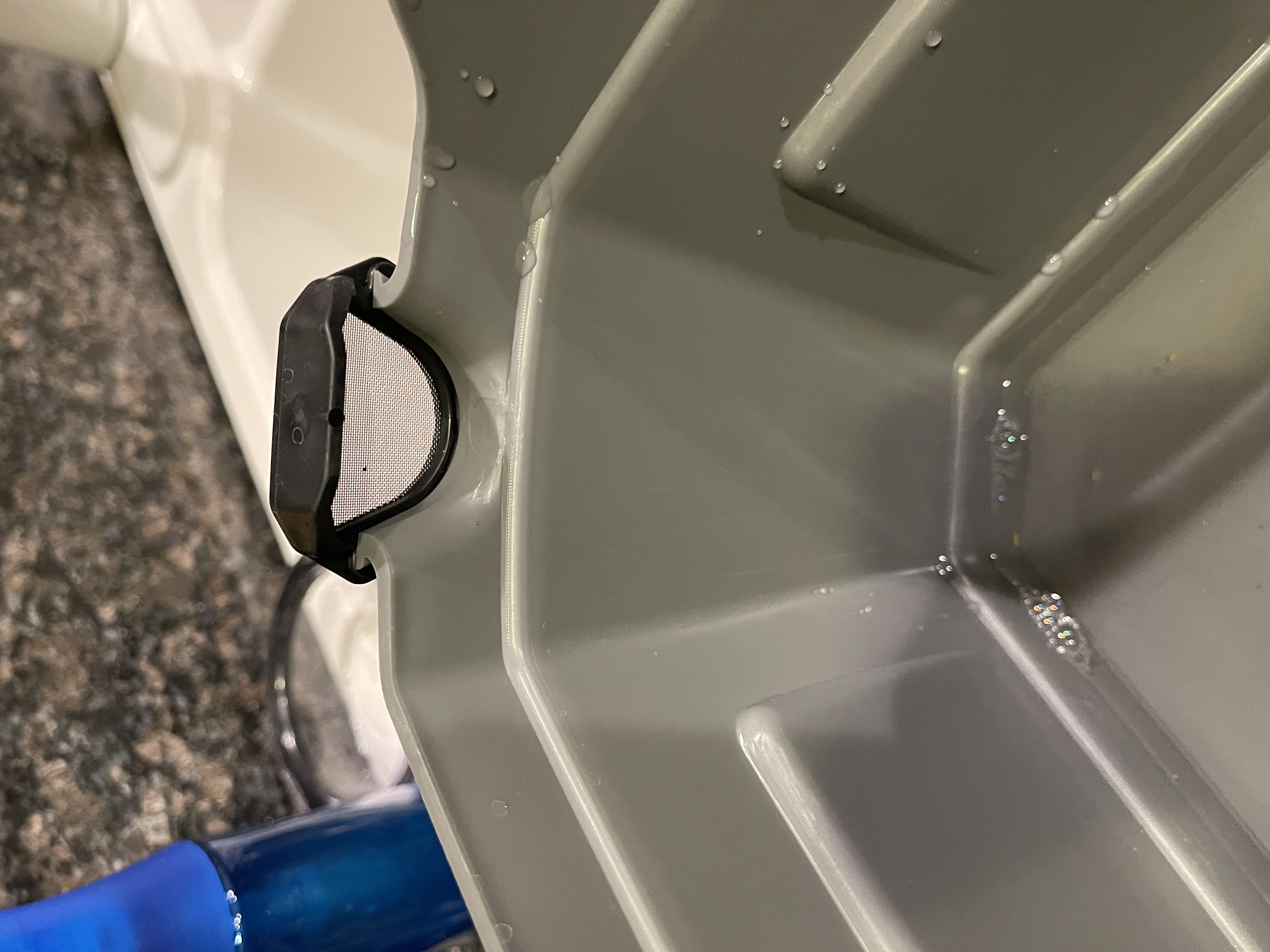

To separate the pins a quick whirl through the media separator and the pins all go to the bottom pan which has a thin mesh screen that allows the dirty water to drain leaving the pins. Pick up the pins with a magnet and dump then in a plastic container, allow to dry and reuse. Added just seconds to the overall process.
I’m sold on wet tumbling because it’s CHEAP!!!, pretty fast, and unlike dry media the dirt goes down the drain with the water instead of accumulating in the media.

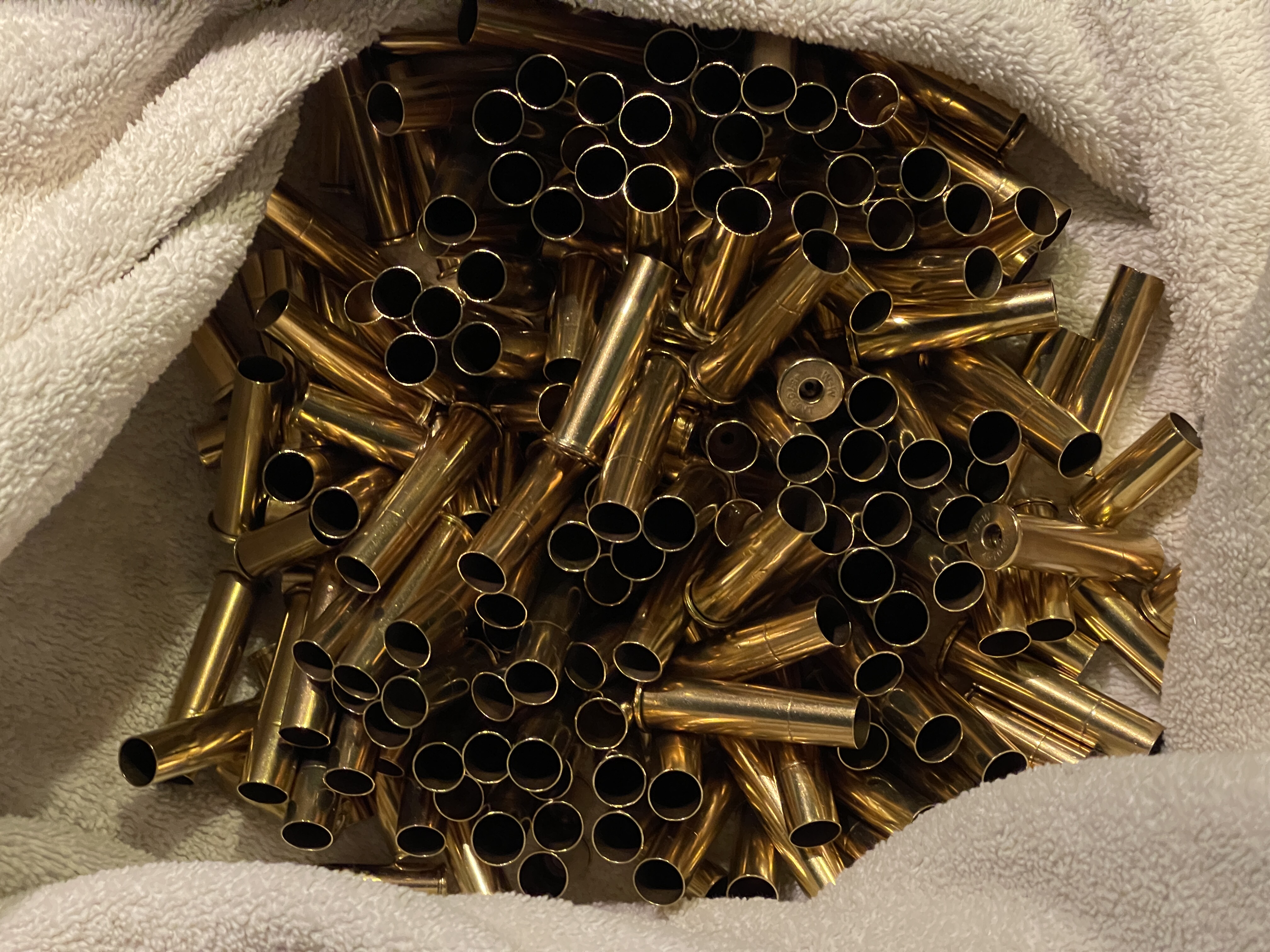

Thats good to know. How did you dry the brass? I have a small food dehydrator that I use for drying parts from powder actuated tools after running through a sonic cleaner. Im assuming that would work just fine for brass.

That would work just fine but I bought a thick fleece CHEAP twin size blanket at Walmart and I just lay it in the sun ( God bless desert climate) throw the brass on it and just spread it out with my hands and roll it around. The polyester fleece doesn’t really absorb any water but it allows it to drain out if the cases and the cases and blanket dry in a jiff. It can dry a few hundred cases in a few minutes that way. The Armor All prevents any water spots from forming.
