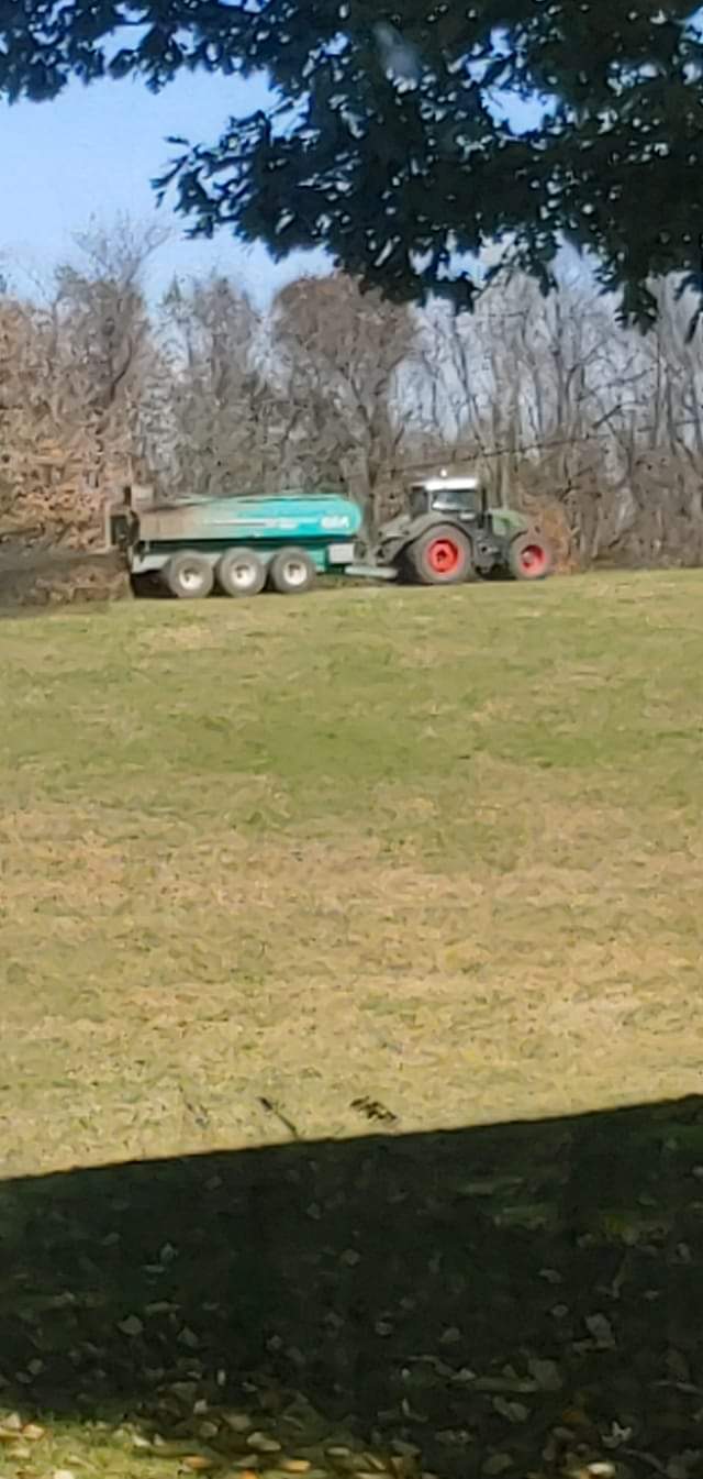

Have to keep testing mine since they dump pig poop across the road a couple times a year.......

My brother has a neighbor with a cow lot across the road from his well. It tests positive for E. Coli if he goes longer than 3 months.
