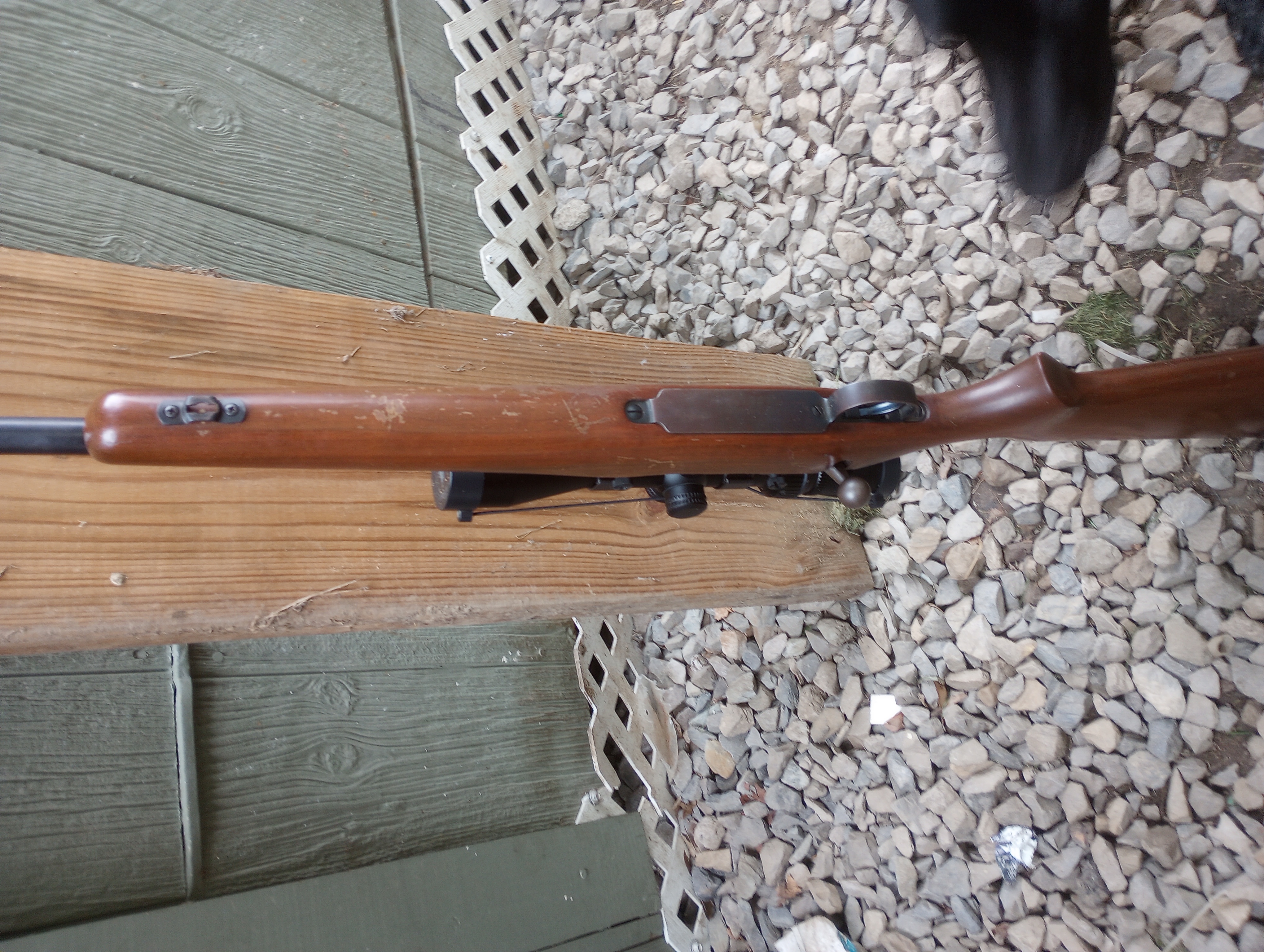

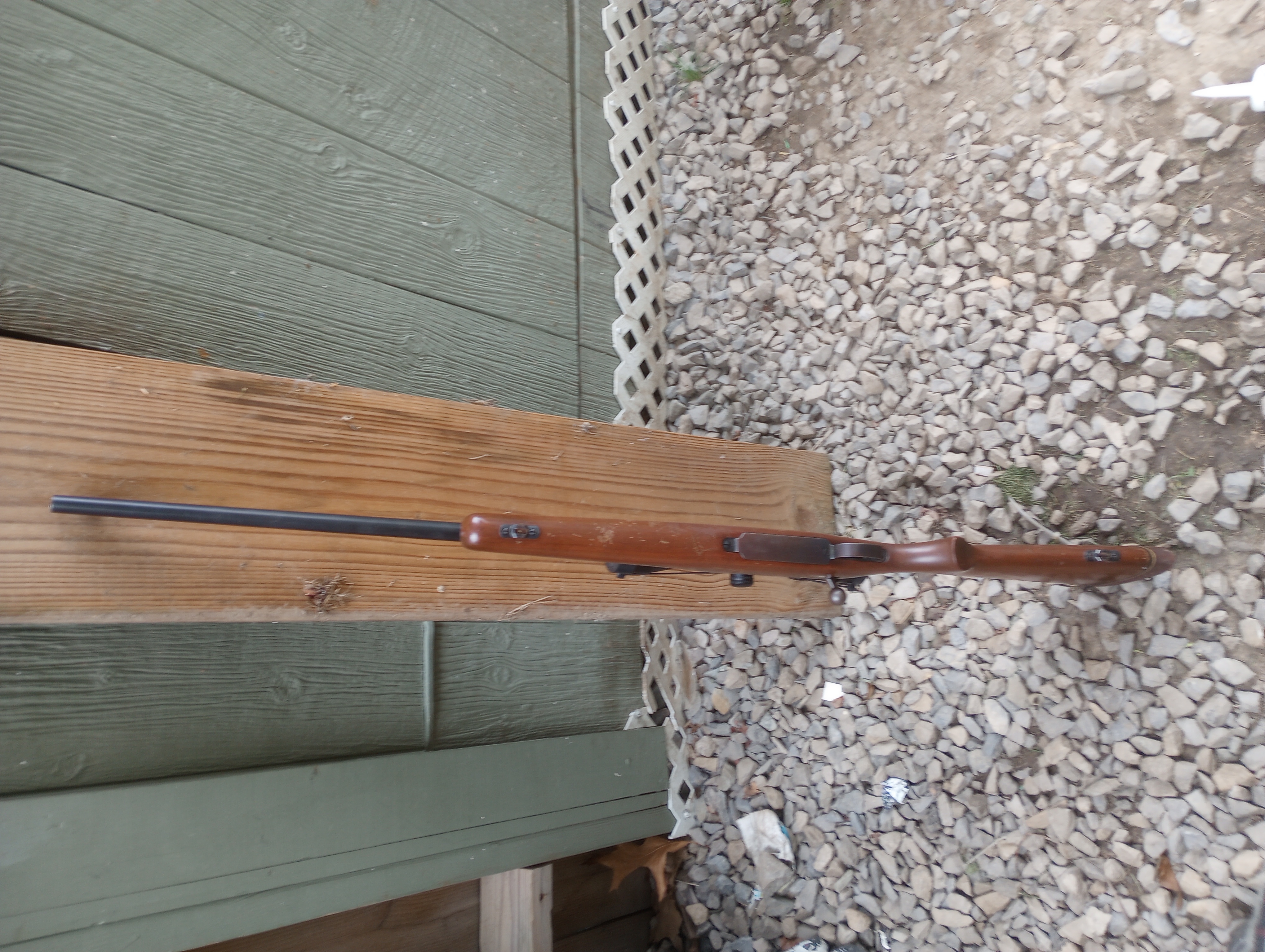

This one is a friend's Remington 721 chambered in 30-06. It's a good shooter, but it shows its age and neglect. I'll repair the bluing, refinish the stock, bed the action and float the barrel. The trigger is horrible! I'm going to try to polish and adjust but, I fear it will need to be replaced. On my Rem 700 I used an adjustable Timney Pro hunter, but on this one I may use their basic non-adjustable 3 lb trigger. It's wearing a 3x9 Vortex but I may replace it with an older Redfield Wide Field 3x9 just to make it period correct.
That a look at the swivel mounts, I've never seen these before. Are they still available? I really don't want to patch one of the holes, if I have to I'll save some of the sanding dust to help feather the color bit...

A little TLC on that particular rifle is going to go a long way, sorry, can’t help you on the sling mounts

Sounds like a worthy project. I have seen swivel mounts with two screws but never exactly like that.

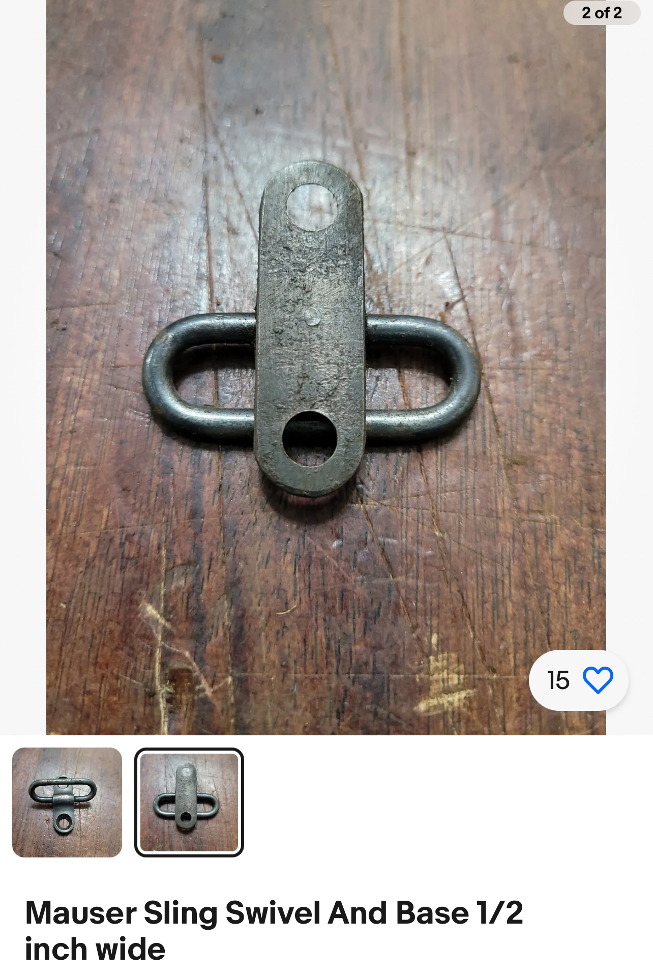

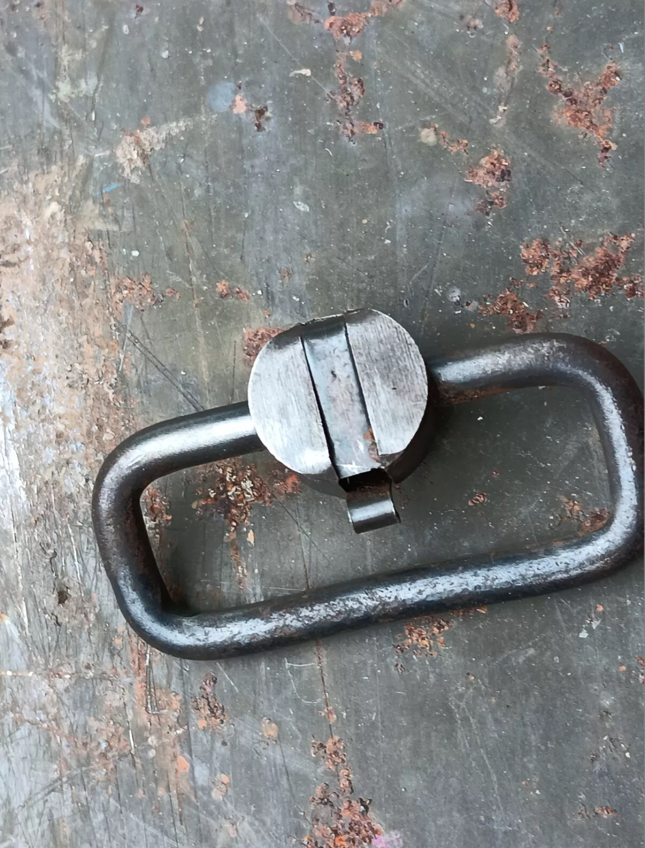

Ha! Those sling bases are from an old Mossberg .22 rifle and use their removable swivels. They were a cool design, kind of ahead of its time. You can still find them on eBay though they are relatively pricey. This ONE is almost $40 and I just saw another one for $85. The bases by themselves come up fairly often but the swivels not so much.
They look like this: Here’s the link to this one on eBay
https://www.ebay.com/itm/335355454555?m ... media=COPY
BTW nice project!
BTW nice project!

If you don’t feel like repairing holes (actually the easiest way to go) a nice alternative is to inlet a pair if these in. They actually polish and blue rather nicely and they look great on an old rifle and they are everywhere on eBay super cheap.
https://www.ebay.com/itm/234993634233?m ... media=COPY

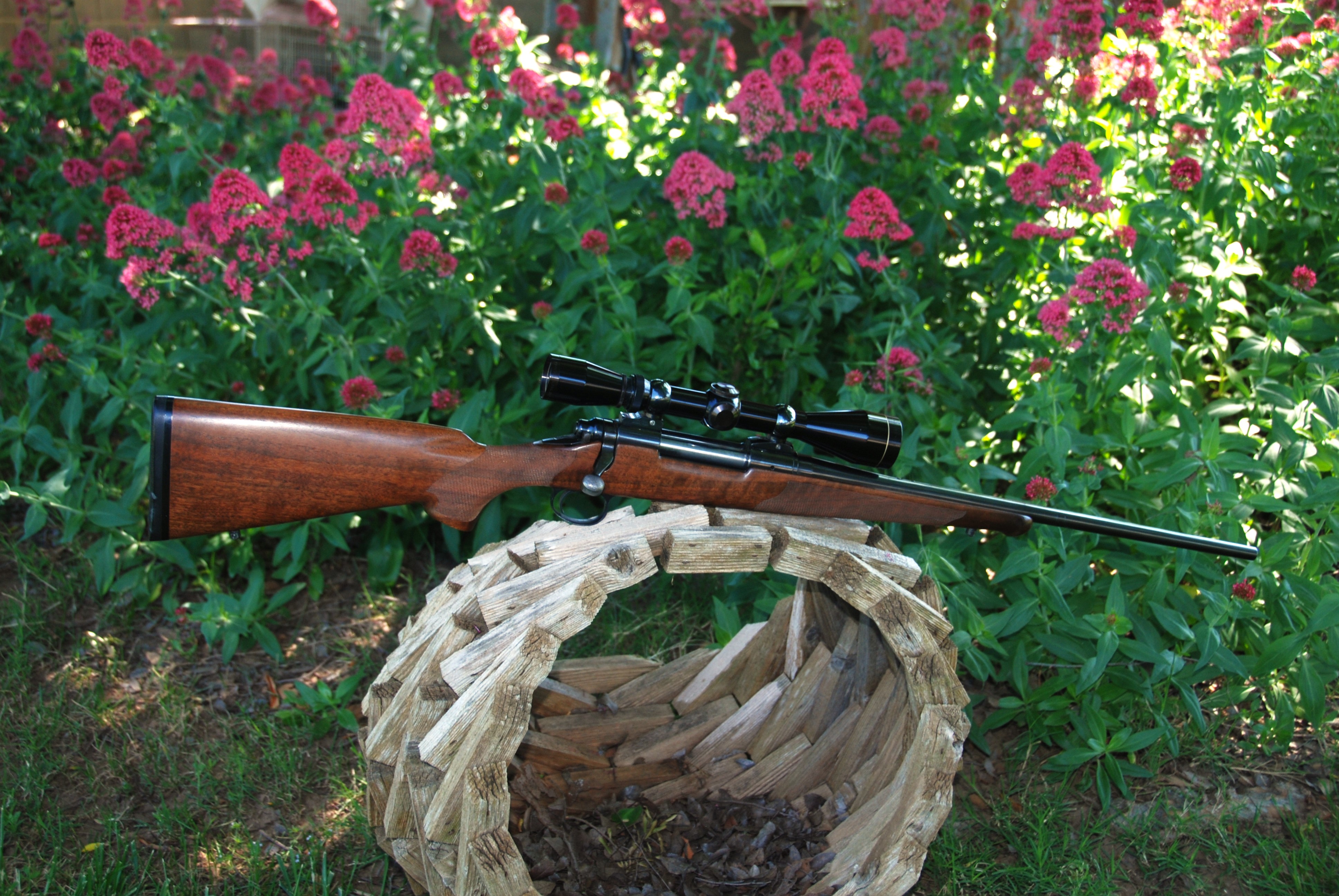

I have a 700 ADL that I bought when I was in high school. I made the rifle over into my certain specs.
I cut the barrel to 20", polished, then reblued. I cut the stock up, even hollowed out the butt. Put a schnabel on the end and then the checkering. All in, the rifle weighs 6 1/4 pounds with a Leupold 3-9 scope.
Good Luck with your project

I really hadn't looked at it close enough to see the off centered sling mount, I hope it's an optical illusion. The Mauser sling mounts seem to be the best option.

I have a set of them on a SHORT sling that cam with my Mossberg 151Mb, might have to put them up for saleWambli Ska wrote: ↑Sun Apr 21, 2024 4:48 pm Ha! Those sling bases are from an old Mossberg .22 rifle and use their removable swivels. They were a cool design, kind of ahead of its time. You can still find them on eBay though they are relatively pricey. This ONE is almost $40 and I just saw another one for $85. The bases by themselves come up fairly often but the swivels not so much.
BTW nice project!![]()

Funny thing about the checkering. I was in my late 20's when I did this gun. I was buddies with a gunsmith, Vic, that liked me. He was in his 70's. Taught me a few things. I learned to strip the action and polish the metal. He did the machine work, cutting and crowning the barrel. I did the stock and finishing.
At the time, I was primarily a shotgun hunter. In the fall, I would spend the majority of my time hunting quail and pheasants. He and his best buddy liked to hunt late season doves. I would give him and his buddy, Bill, weekly scouting updates of dove numbers in the areas where I was hunting along with a map marking all the spots.
When it came time to checker the rifle, Bill said he would do the checkering. You probably can't see it in the photos but the checkering wraps the wrist and the forearm. Long story just a little bit longer, when I picked it up and asked him what I owed him, he said $35. Proof positive that it's not what you know, it's who you know. That was 50 years ago.

The sling swivels are still a consideration. I can find the studs on eBay for the same price as Uncle Mike's Mauser studs. The Mauser stud will be more work but look better, but it's a hunting rifle! I could counter sink a hole in the center of the stud and call it good!

Fun project! BTW these are the original sling swivels and if the spirit moves you they can be found on eBay and you can probably sell the ones on the gun to defray the cost.

Now that you're looking closely at the stock, were the sling fixtures centered and straight, or were they messed up? The stock must have been cut down for a kid. I cut my stocks on the short side because of when I hunt I'm usually wearing a lot of layers. It's easier to mount the rifle.

The front sling mount is a little off center, I'm pondering Mauser style mounts because there are two holes in the stock from the Mossberg mounts and hiding the extra holes would be a pain.

The main reason I'm pondering Mauser style sling bases is, so I can recenter the bases and hide the old screw holes. I could use standard studs, but even if I fill the extra holes and use the stock's saw dust to blend them, they'll still be visible. Since this rifle didn't come with sling studs, either standard or Mauser style will be period correct.
