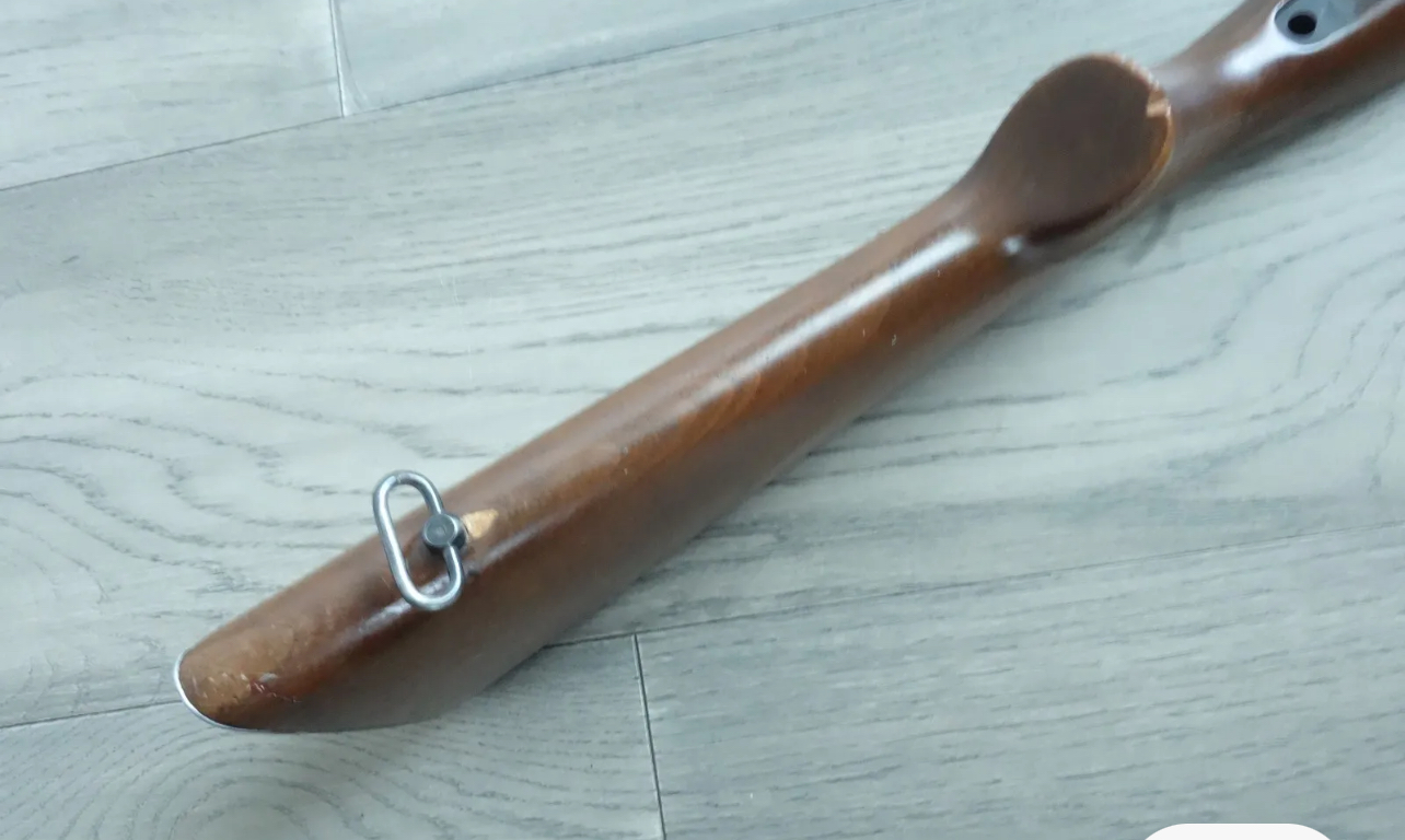

This one is a friend's Remington 721 chambered in 30-06. It's a good shooter, but it shows its age and neglect. I'll repair the bluing, refinish the stock, bed the action and float the barrel. The trigger is horrible! I'm going to try to polish and adjust but, I fear it will need to be replaced. On my Rem 700 I used an adjustable Timney Pro hunter, but on this one I may use their basic non-adjustable 3 lb trigger. It's wearing a 3x9 Vortex but I may replace it with an older Redfield Wide Field 3x9 just to make it period correct.
That a look at the swivel mounts, I've never seen these before. Are they still available? I really don't want to patch one of the holes, if I have to I'll save some of the sanding dust to help feather the color bit...

Sounds like a worthy project. I have seen swivel mounts with two screws but never exactly like that.
Re: Next restoration project
Posted: Sun Apr 21, 2024 4:48 pm
Ha! Those sling bases are from an old Mossberg .22 rifle and use their removable swivels. They were a cool design, kind of ahead of its time. You can still find them on eBay though they are relatively pricey. This ONE is almost $40 and I just saw another one for $85. The bases by themselves come up fairly often but the swivels not so much.

If you don’t feel like repairing holes (actually the easiest way to go) a nice alternative is to inlet a pair if these in. They actually polish and blue rather nicely and they look great on an old rifle and they are everywhere on eBay super cheap.

Whoever mounted that scope, really shouldn’t mount scopes.
Posted: Sun Apr 21, 2024 11:18 pm
I really hadn't looked at it close enough to see the off centered sling mount, I hope it's an optical illusion. The Mauser sling mounts seem to be the best option.

I started the project today. I started by floating the barrel. As was common in the day, the stock had a pressure point at the tip of the forend. The barrel channel had plenty of space in the bottom, but was tight all the way to the receiver. The recoil lug was cut very large, but I handled that problem. I'll start the wood work tomorrow. The receiver and tang seem to fit very well. The LOP for this rifle seems to be 12 1/2 inches, so it will fit Zee or Tom's grandchildren very well, but again I have concerns about grip distance. The trigger guard and mag plate need refinished. The rest of the metal will benefit from brass wool and Oxxpho blue.
The sling swivels are still a consideration. I can find the studs on eBay for the same price as Uncle Mike's Mauser studs. The Mauser stud will be more work but look better, but it's a hunting rifle! I could counter sink a hole in the center of the stud and call it good!
The trigger is adjustable! I brought it from 10 lbs to about three and clean! I'll tinker with it more as I refinish the metal.

Fun project! BTW these are the original sling swivels and if the spirit moves you they can be found on eBay and you can probably sell the ones on the gun to defray the cost.

Now that you're looking closely at the stock, were the sling fixtures centered and straight, or were they messed up? The stock must have been cut down for a kid. I cut my stocks on the short side because of when I hunt I'm usually wearing a lot of layers. It's easier to mount the rifle.

The front sling mount is a little off center, I'm pondering Mauser style mounts because there are two holes in the stock from the Mossberg mounts and hiding the extra holes would be a pain.

I have no problem replacing screws for the correct ones. If they're incorrect or buggered, they're gone. I restore Bubba's rifle, just not repair it. I have a set of Wheeler screwdrivers and an inch pound torque wrench. I also have sets of allen and torx wrenches for the odd ball screws. I can't hot blue but can do a nice job. I still think a Redfield wide field would look great! Maybe an old weaver?
The main reason I'm pondering Mauser style sling bases is, so I can recenter the bases and hide the old screw holes. I could use standard studs, but even if I fill the extra holes and use the stock's saw dust to blend them, they'll still be visible. Since this rifle didn't come with sling studs, either standard or Mauser style will be period correct.
