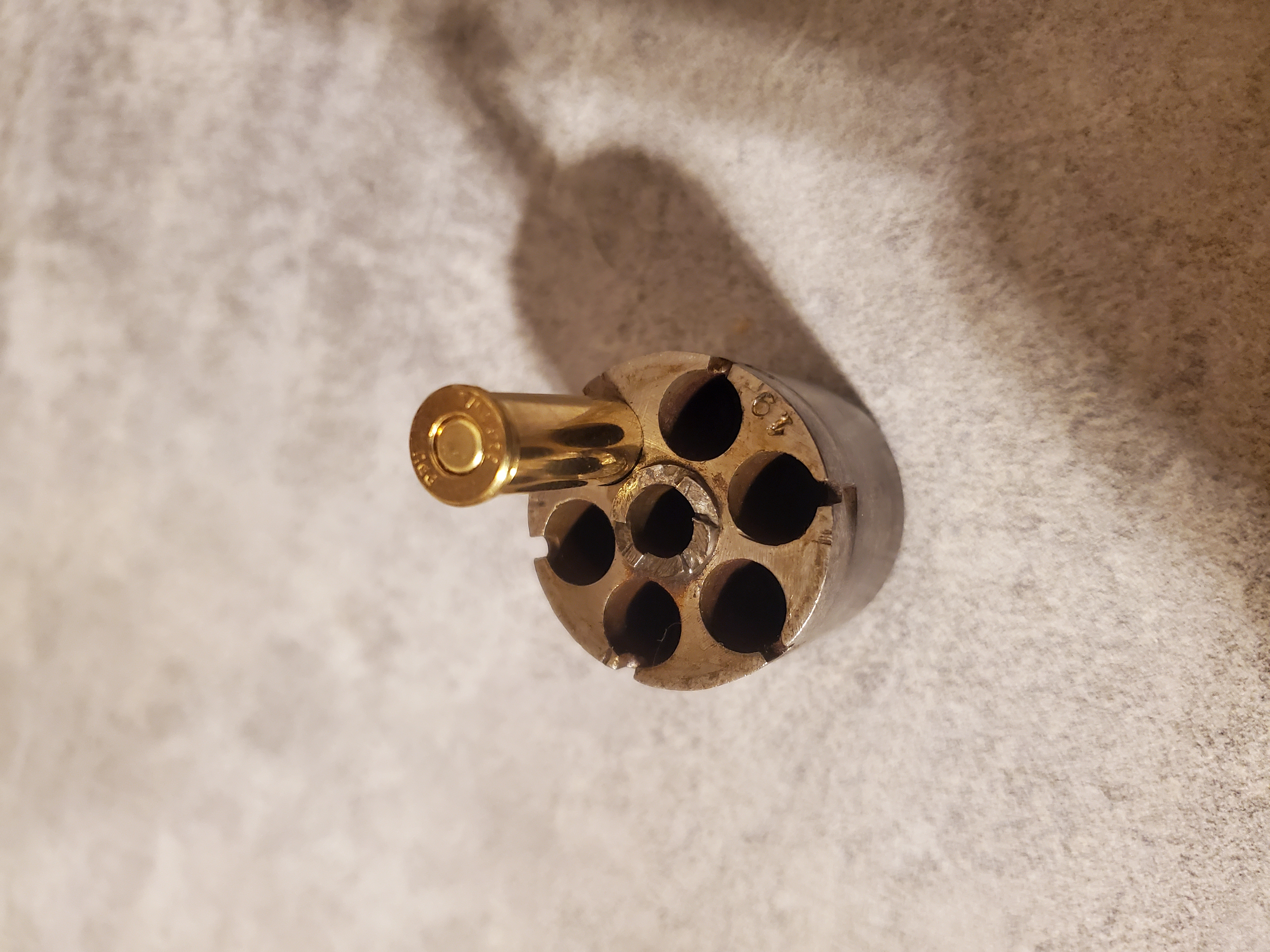

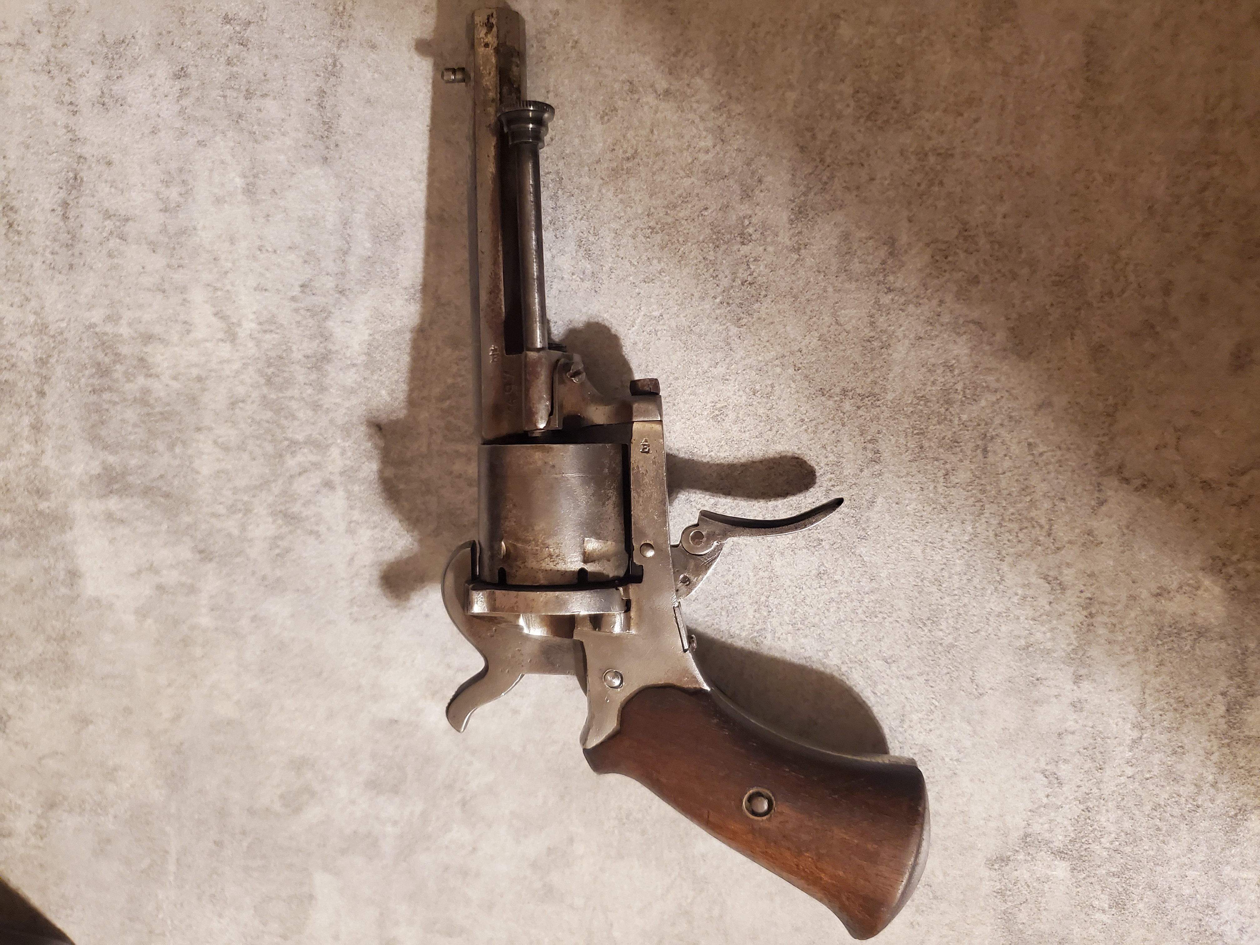

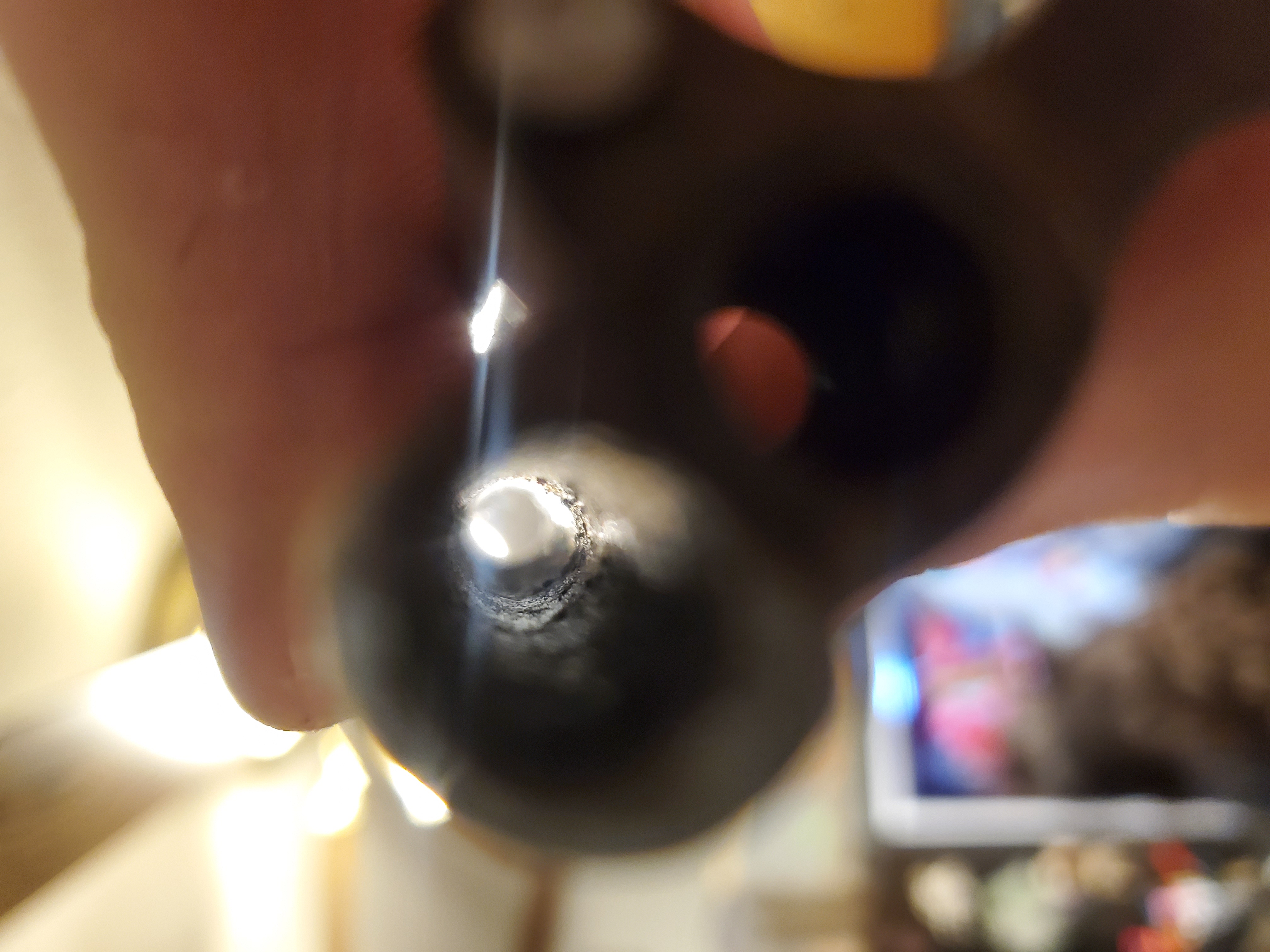

I got this one cheap from gunbroker and it sent straight to my door without my ffl. Apparently pinfires aren't considered firearms by the alphabet people. It's a 7mm pinfire pistol and I couldn't pass it up. The barrel has absolutely zero rifling left in it, but that works out okay because I have plans. I want to make my own ammo for it and itnwould be nice to start out with something that's widely available. There's nothing close thatll fit the cylinder but I think I can ream the chambers to 32 caliber and use a chucking reamer for the barrel and then press a 32 caliber rifling button down the barrel. I have loads of 32acp brass that I can turn the case heads off of, solder the flash hole closed and then pop holes in the sides for a piece of 2mm brass rod that will rest in a percussion cap that's placed in the brass. Fill with black powder and top with a lead bullet, voila.... range time with new pinfire! I'll post updates as it comes along. I also have to tig weld up the hand to extend it and reshape to get it back in timing but that's no biggie. Oh 32S&W shown for comparison.

Will do. I had to order a .300 chucking reamer and the rifling button or else I would have gotten the barrel done today. I could probably make a pretty good return on this gun when I get it done and if I was to sell it with about 25 cartridges that are ready to go, but I think it'll be a keeper.

I never thought about that but looking closer at it leads me to believe that it would be pretty easy to do. Of course I'd make it something in the small-ish caliber like 32s&w or maybe 25acp. If I really wanted to go crazy I could make a conversion cylinder to do it.

I would think the hammer aspect would not work for a CF round. I believe you'd have to re-make the hammer to strike in the middle of the chamber instead of on top of it.

True, but there could be two ways around that. Make a hammer that hits a firing pin through the recoil shield or make a hammer with an anvil thatll strike through the recoil shield. Either one would work. In all honesty I really just want to make this a 32 pinfire and have fun shooting it.
