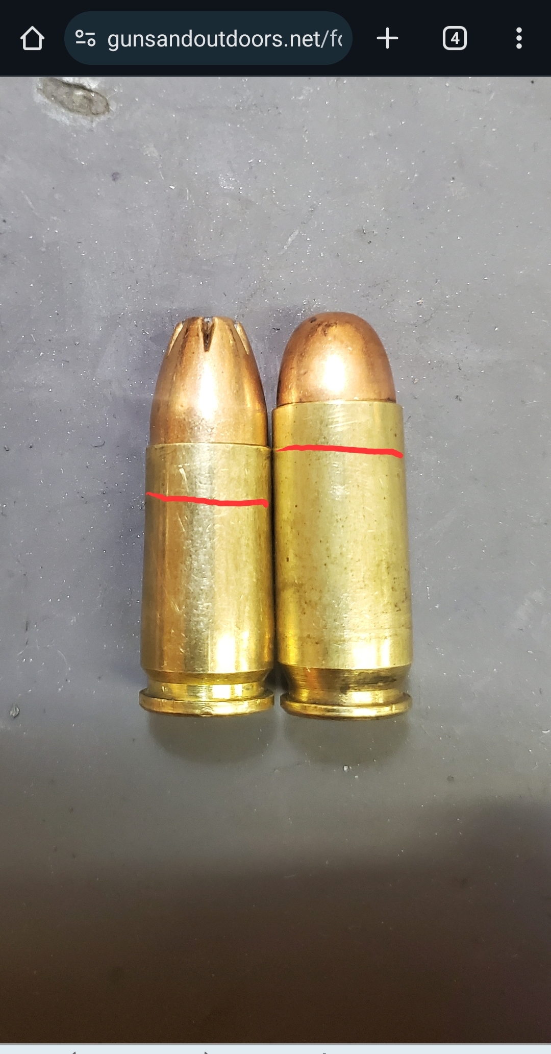

You're grossly overthrowing this thing. The case difference is only at the web, like you said and its negligible, in the thousandths. Plus an extra 3mm long case can hold alot of powder.

Best I could do to show where each bullet ends.

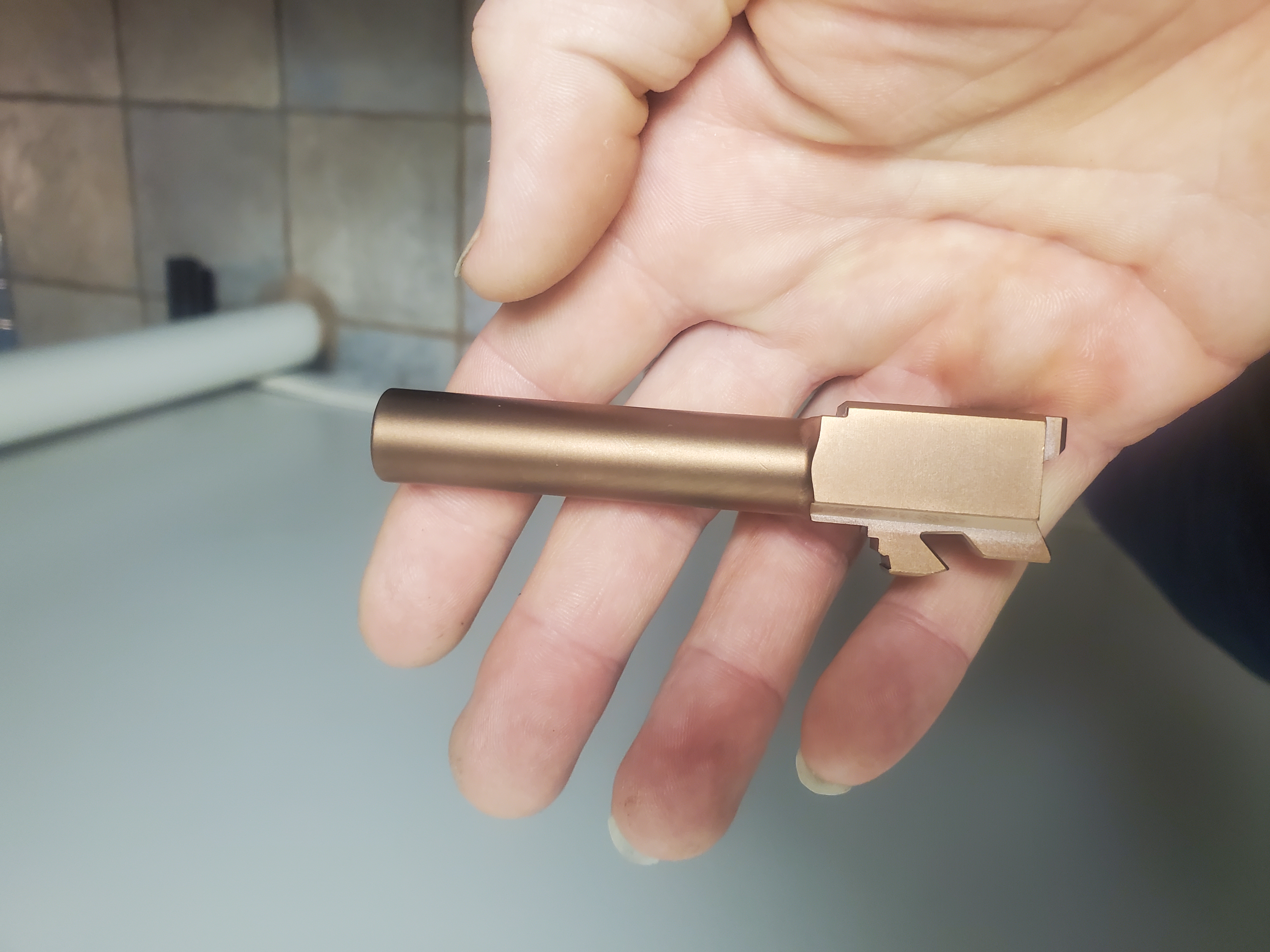

I got my new barrel. Pretty nice for $39 and change. I'll be doing the lathe work tomorrow and probably posting a video of its maiden firing of the new cartridge. If I can get the chronograph to work indoors I'll try to get a velocity or two although the 3 rounds I have loaded aren't much hotter than what I normally load my carry ammo to. Also ordered 100 rounds of brass to be able to experiment with.
Posts: 1340
Re: I made a wildcat.
Today did not go through. Let's just say mistakes were made (partly due to a customer interrupting my lathe time on the barrel.) I had to get a new barrel but thankfully a buddy of mine lives about 10 minutes from AIM Surplus so he picked me up another.
I will not be dissuaded 😅

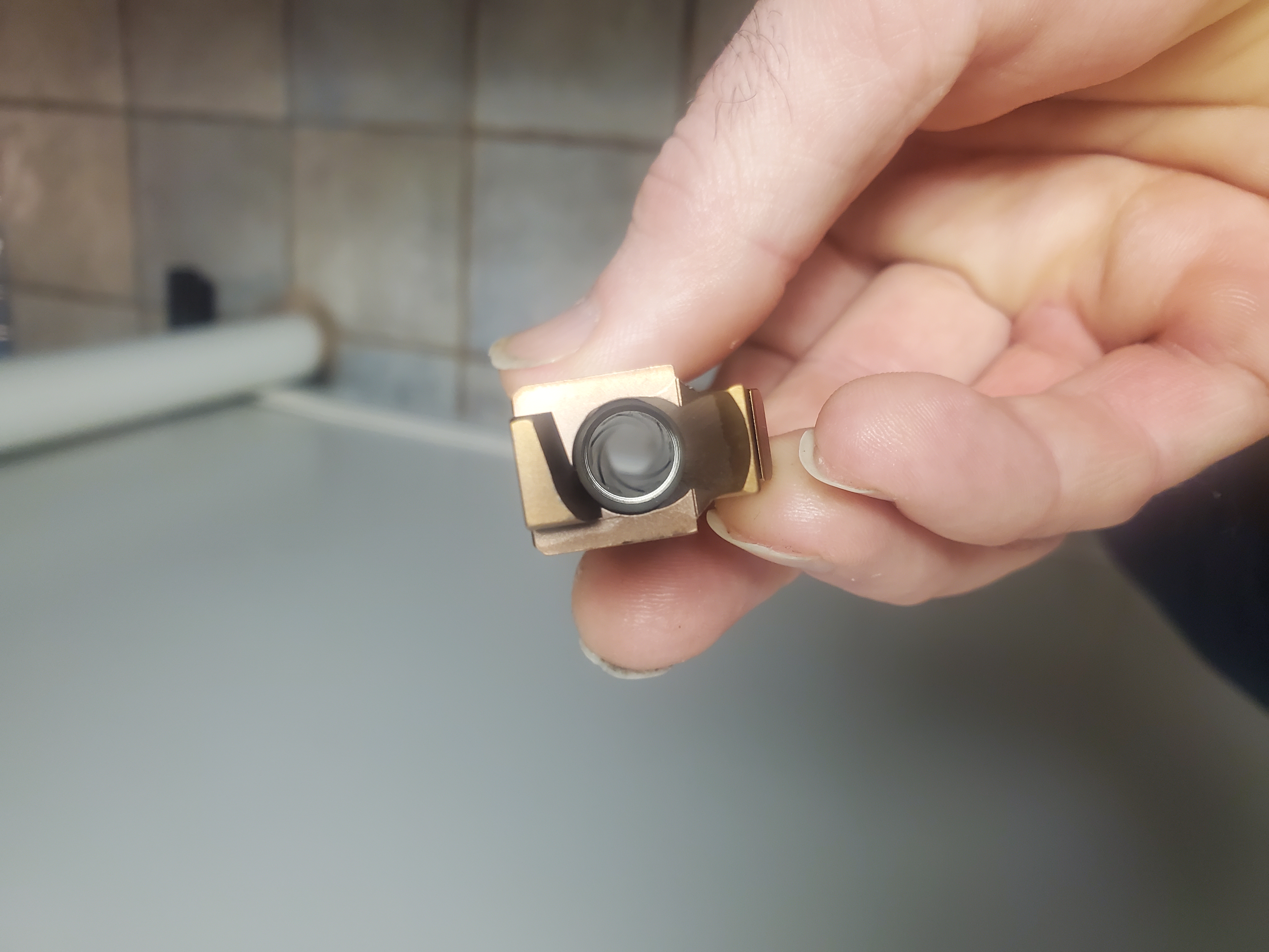

I finally got around to cutting my chamber deeper by renting a 350 legend reamer. First test fire and this thing is promising. Although I'm unable to grab a chronograph number in my shop, the recoil and fireball is substantial 😳. It's also extracting and feeding just fine. It reminds me of shooting a Coonan 1911 in 357 Mag.

4D and Elk Ridge. I prefer Elk Ridge buy they didn't have a 350 Legend reamer. Ive had a few bad experiences with 4D but they have a better selection. I'm actually quite pleased with how well the 350 Legend chamber transitioned into the present 9mm chamber in the aftermarket barrel i bought. The fired brass looks fantastic.
