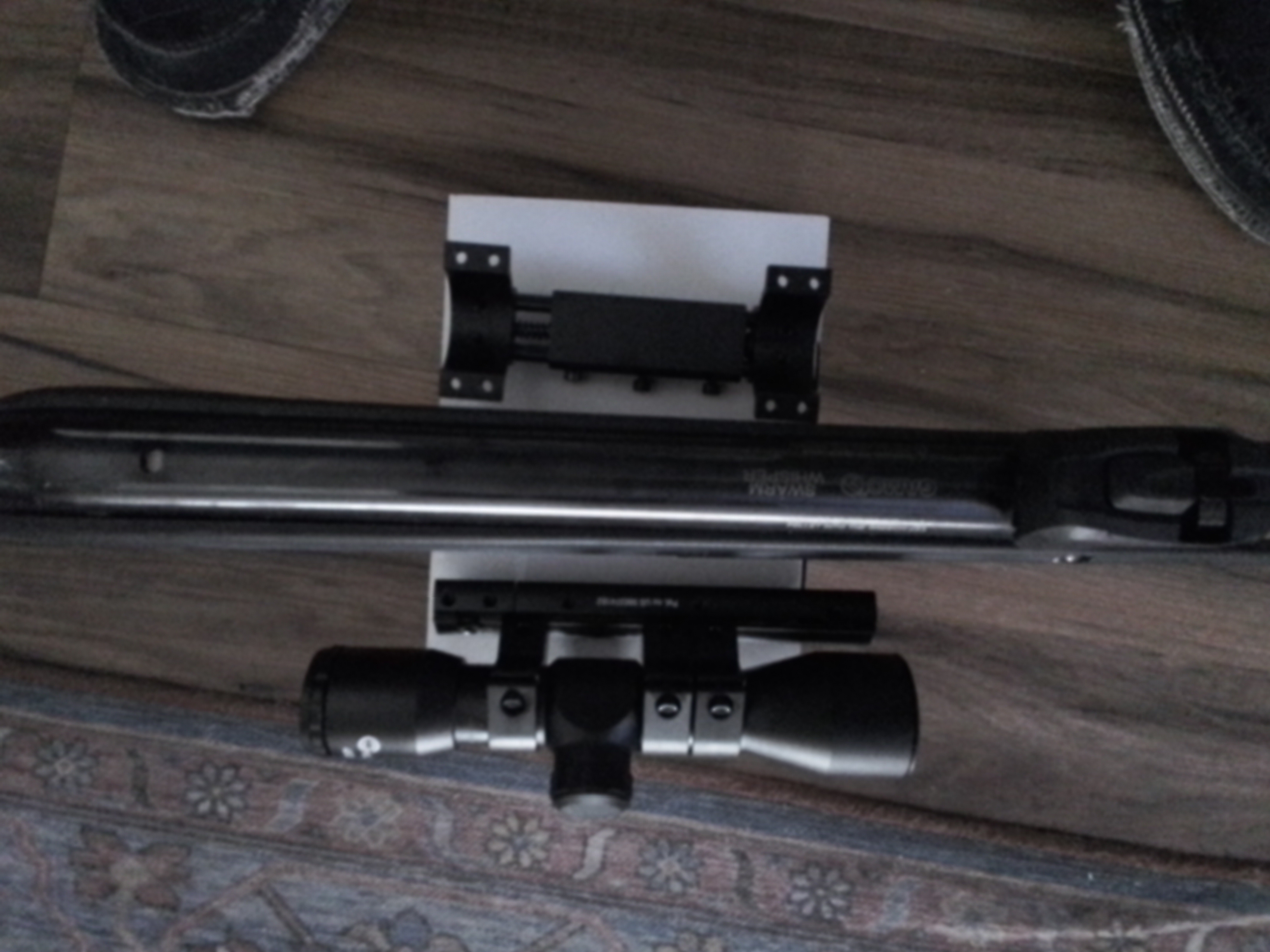

Well I got the pieces together. I began questioning the rail on on the gun. Turns out it is just an aluminum riser. They had to put it there when they added the 10 shot magazine thingy.
I took it and the previous scope off together. The new spring loaded mount is laying next to it. I can see why the mount got iffy reviews. They should have just sent a bag of parts. After cleaning and reassembly it's fairly "stiff". It also has a small pin that engages the hole in the top, rear of the receiver to stop it from sneaking rearward. I'll see how brave the prairie dogs are tomorrow. :D
